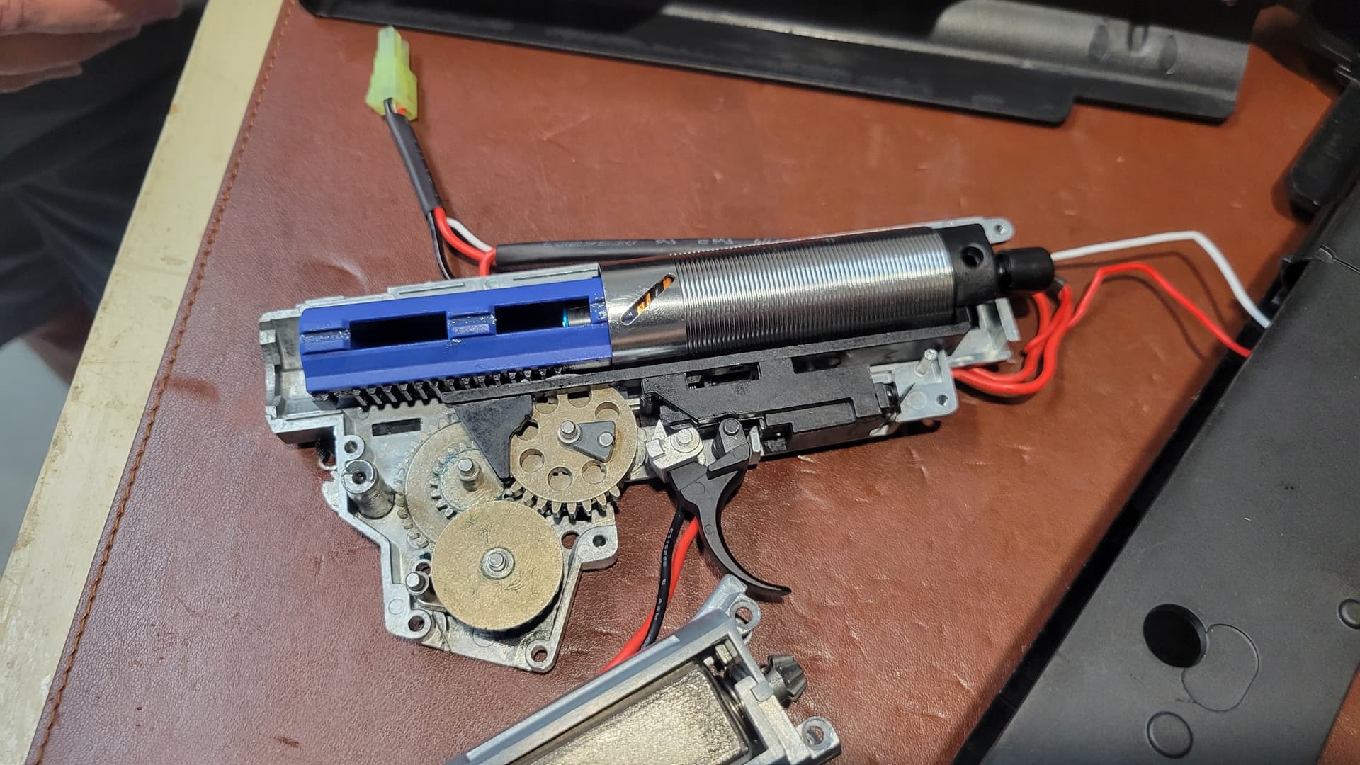

A friend of mine recently purchased one of these and is looking to pull it apart and check airseals etc.
I did find this thread on V3 upgrades which is very useful, from this and some other research the air seal parts and springs for V2 and V3 gearboxes are generally the interchangeable?
At the moment its getting around 260fps, we’re hoping to get closer to 300

Spent about 5 hours on this blaster today and certainly got better at pulling apart V3 gearbox’s, unfortunately that was the only good news as every attempt we made to improve the performance resulted in 140fps.

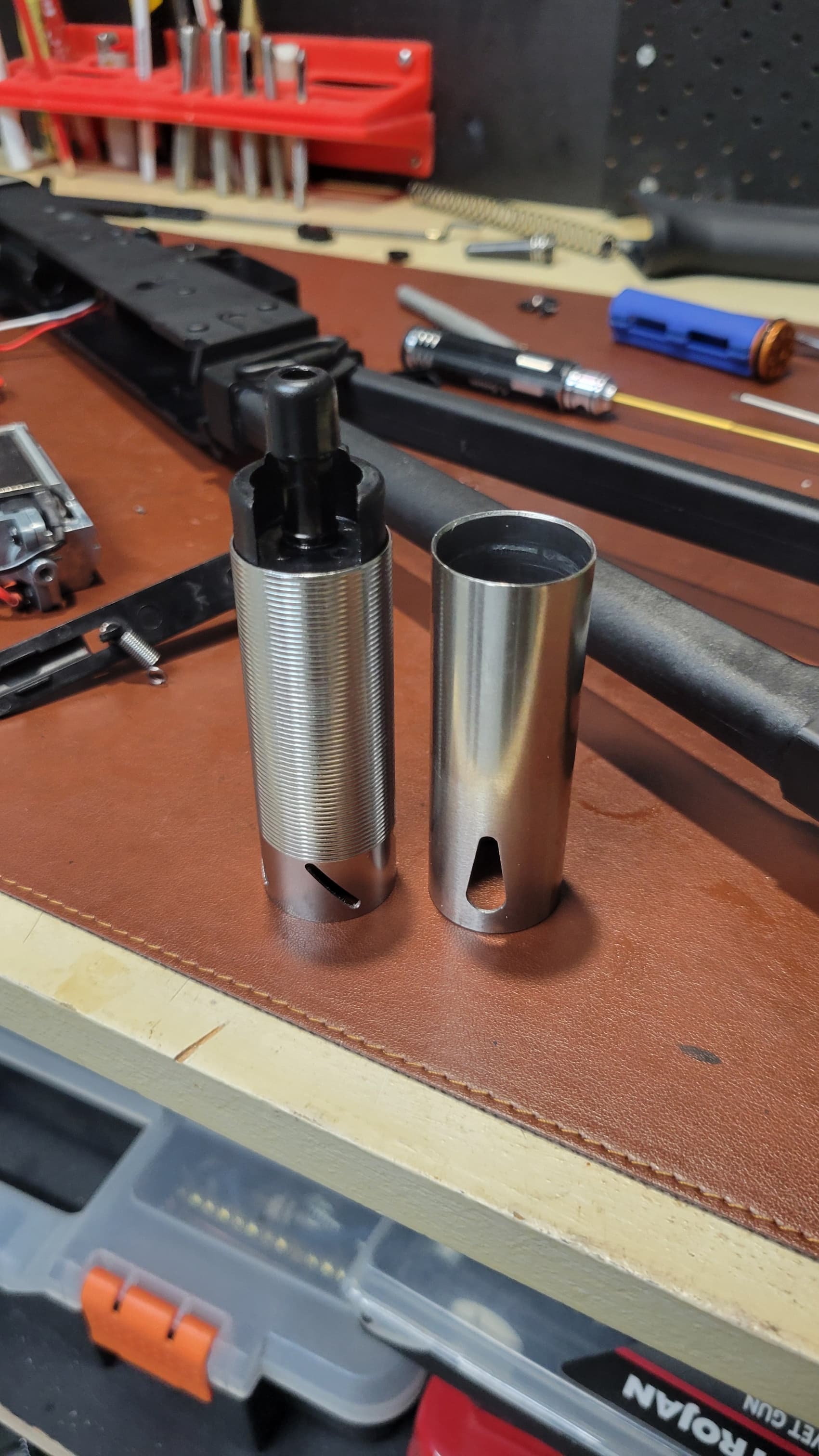

At first we replaced the cylinder with an SHS %80, an SHS piston and a Tienly piston head. Cylinder head, nozzle and spring remained unchanged. We did air seal tests on the bench with and without the nozzle and they were excellent so we proceeded to do the install, final result was 140fps which had us scratching our head.

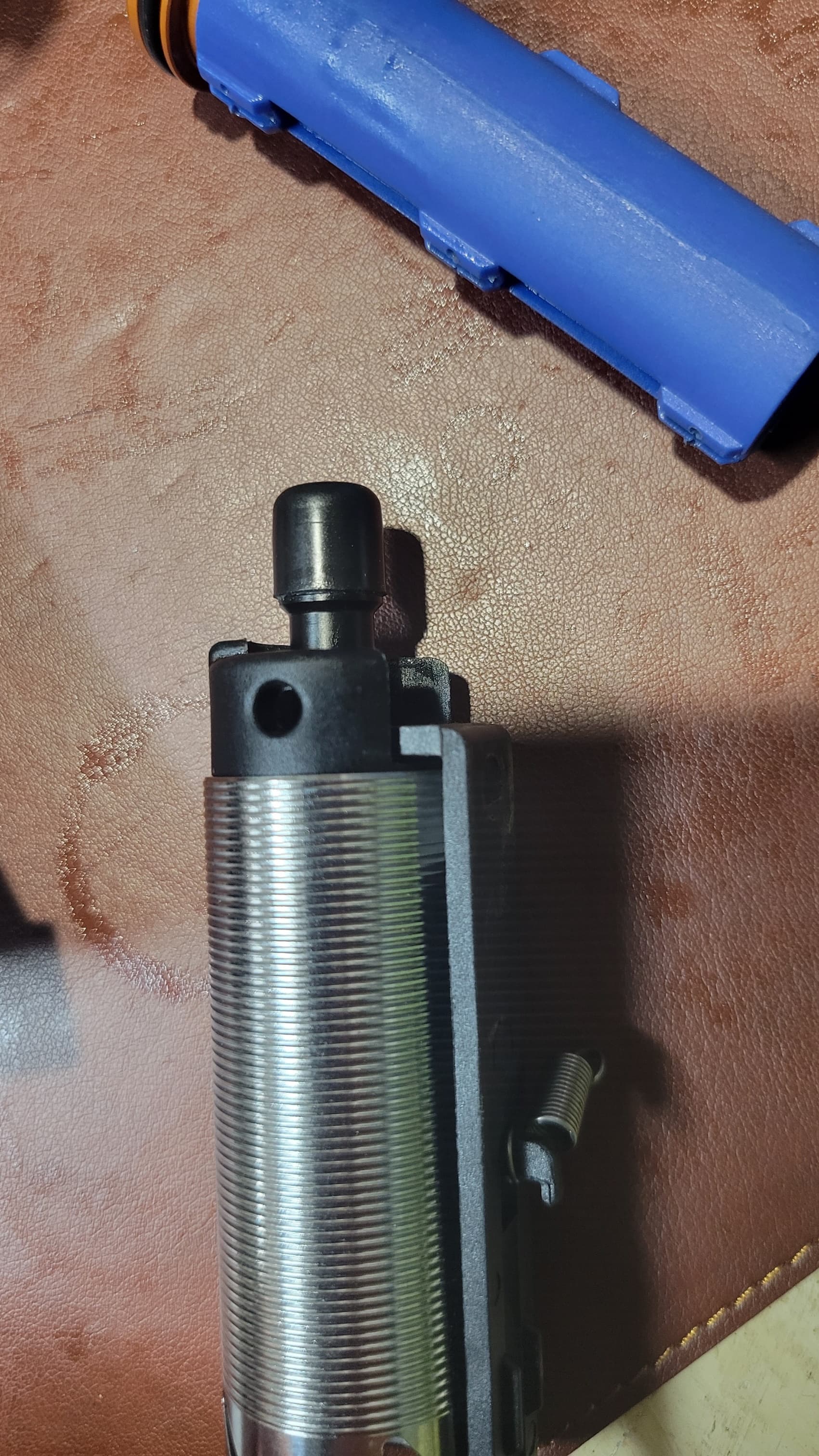

Pulled it apart and tested everything again, air seals were good. We did find one weird thing, when testing the air seal with the tappet plate in place, I felt that the tapped plate was slightly lifting the nozzle away from the face of the cylinder head, causing a an air leak when the piston was pushed in for an air seal test.
So essentially, no tappet plate - air seal was excellent.
Tappet plate in place - air seal was around %50 worse off
Tried sanding the tappet plate to get a sharper 90 degree bend where it interfaces with the cylinder head, also tried sanding down the SHS %80 cylinder so it was the exact same length as the factory cylinder (72mm). Also tried again with the factory cylinder but nothing worked. Its probably something simple I’m sure but we couldn’t get to the bottom of it.
New cylinder on the LHS with original cylinder head and nozzle. It this setup the air seal was excellent
When testing the air seal with the tappet plate in place it was about %50

Check the piston moves freely without the cylinder involved… and remove the sector delayer. It just isn’t needed in my experience.
Maybe make sure the barrel spring has enough tension on the tpiece
Ok ta, barrel and t piece we sort of ran out of time to check. Hopefully that’s the golden ticket
Shooting the 357mag down the side of the house is “frowned upon”
I’ve got one of the “traditional” DB AK47’s and it was punching about 380fps, don’t know if the cylinder is ported as it’s a full length barrel and I’ve never had a reason to open it up, I get weird luck with blasters having near perfect seals ootb.
As Rok pointed out, my head goes to it not sealing in the t-piece properly. While it’s together loop through the mag well and see if you can get the timing to have the nozzle completely closed/forward and see if it’s actually closing fully. That
