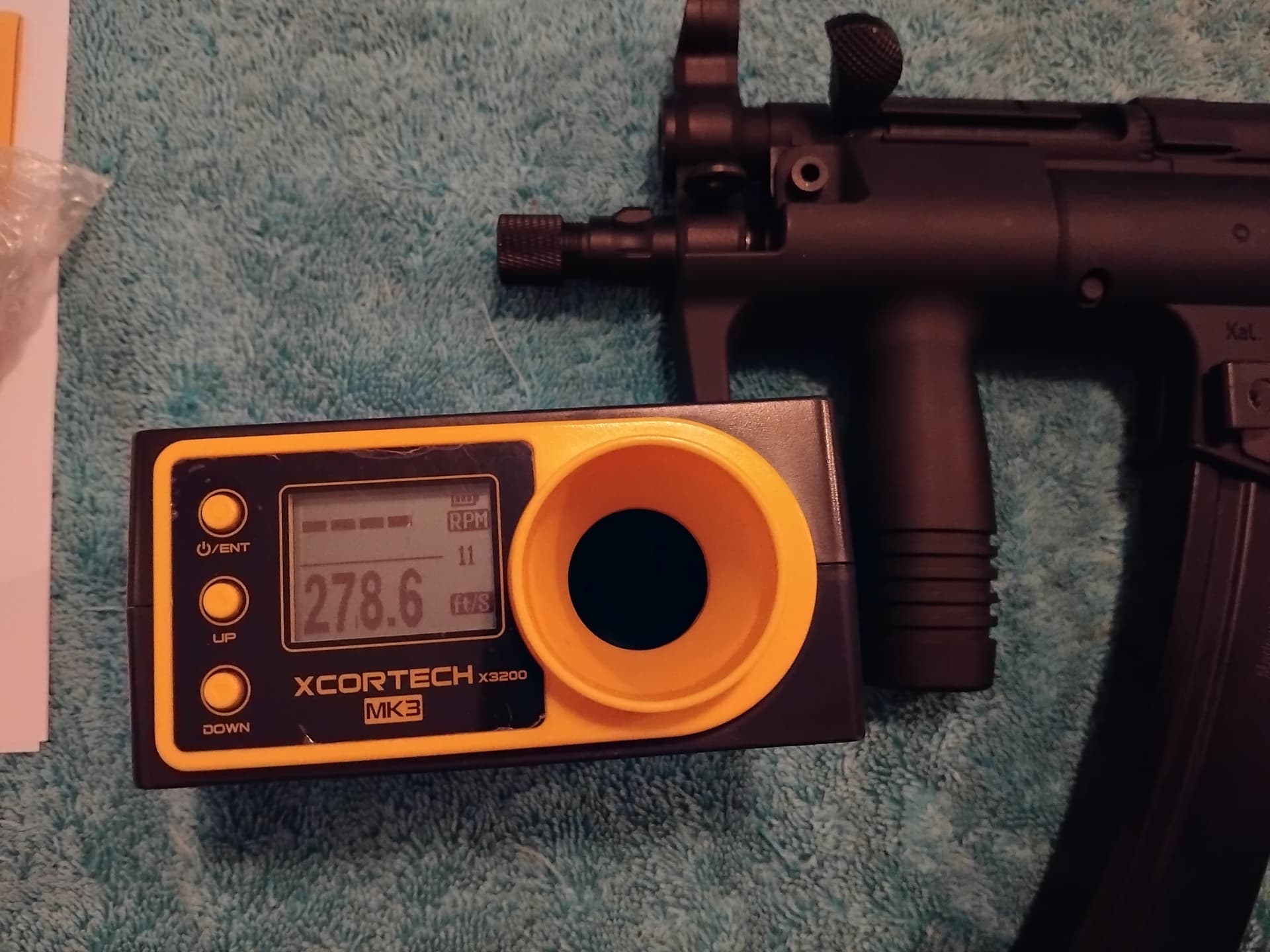

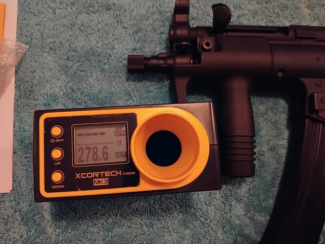

Not wanting to steal Rok’s thunder…but…
Si-jun Mp5k.
Small Package.
Big headaches…for Rok…!!
I wont say too much, he can fill in the details…
But…proofs in the pudding.
A good result, for a small barrel, with a inbuilt hop up.!
Also…candidate for
“Gearbox least deserving of a mosfet upgrade…but mag-prime death made it so…”
Hahaha… I hate that thing!
It has been a while since I wanted to throw a blaster in a bonfire and dance naked around it but this one was close!
Yes it was a headache, the nylon SiJun gearbox I would relate to the HL gearbox (HL ARP9 and Honey Badger) in terms of quality… low!
Stock gears just would not play nice with the optical sensor on the mosfet… eventually ditching the gears for some new ones made it work, but quite an expense spiral was needed just to get mag prime again!
I could have trimmed the blowback nub enough to still contact the mag prime switch but not have blowback, but it would be so thin and flimsy, and still potentially contact the piston; I can’t recommend it.
Good results but man it took some working out to get it there!
Externally these aren’t bad, internally though the gearbox and mounting the entire barrel to it is a poor design choice for those looking to tinker. Disassembling the entire barrel and front end being needed to remove the upper receiver and gearbox is like slavery with extra steps.
I don’t think I have a video on doing this operation as I initially expected it would be a simple bang in a ETU job… but I think I do have a conclusion/post surgery video.
We had hoped to use a brushless motor, but in Sijun form, the base plate has no adjustment and the brushless wouldn’t fit without grinding the base plate… at which point there is no going back and the brushless motor is then not able to be held solidly in place without further measures. So while definitely plausible, it would have been a operation all its own.
It is good for me to get these sort of builds, because I know now the effort required and can hopefully scare off future prospective Sijun MP5k owners before it even makes it to me :rofl:

Cyma makes the full size MP5…and they are quite good…just feel a little “plasticky”.
But good performers…300 fps with just a spring change, reliability and parts available.
JM make the MP5-k…
They can end up pretty good , and good value for the price point.
Just check those factory gearboxes… i remember your gear not being mounted properly… and cream of sumyungai…!! :rofl: :rofl:
The Sijuns have very nice externals…but a bit of a sub par gearbox.
But, that was not to be known, until they were pulled apart.
Cheaper SD model, with a good lazy upgrade , and metal mags…
Can endorse the JM MP5K. Add longer metal barrel, suppressor and M100 spring and 300FPS
Yeah…good bang for the bucks.
Hard to go past the pricepoint / performance curve.
Solid performer.
Yeah… my bad.
It was the JM MP5K i was referring to in the above post… flu head doing it’s thing. :person_shrugging: Haven’t handled a CYMA MP5.
Not a bad little SMG at all once it’s checked over. Mine was missing the bronze bush on the sector gear shaft straight out of the factory, flopped around like s cock in a shirtsleeve, so not the greatest QA on JM’s part.
New sector gear and everything’s sweet.
