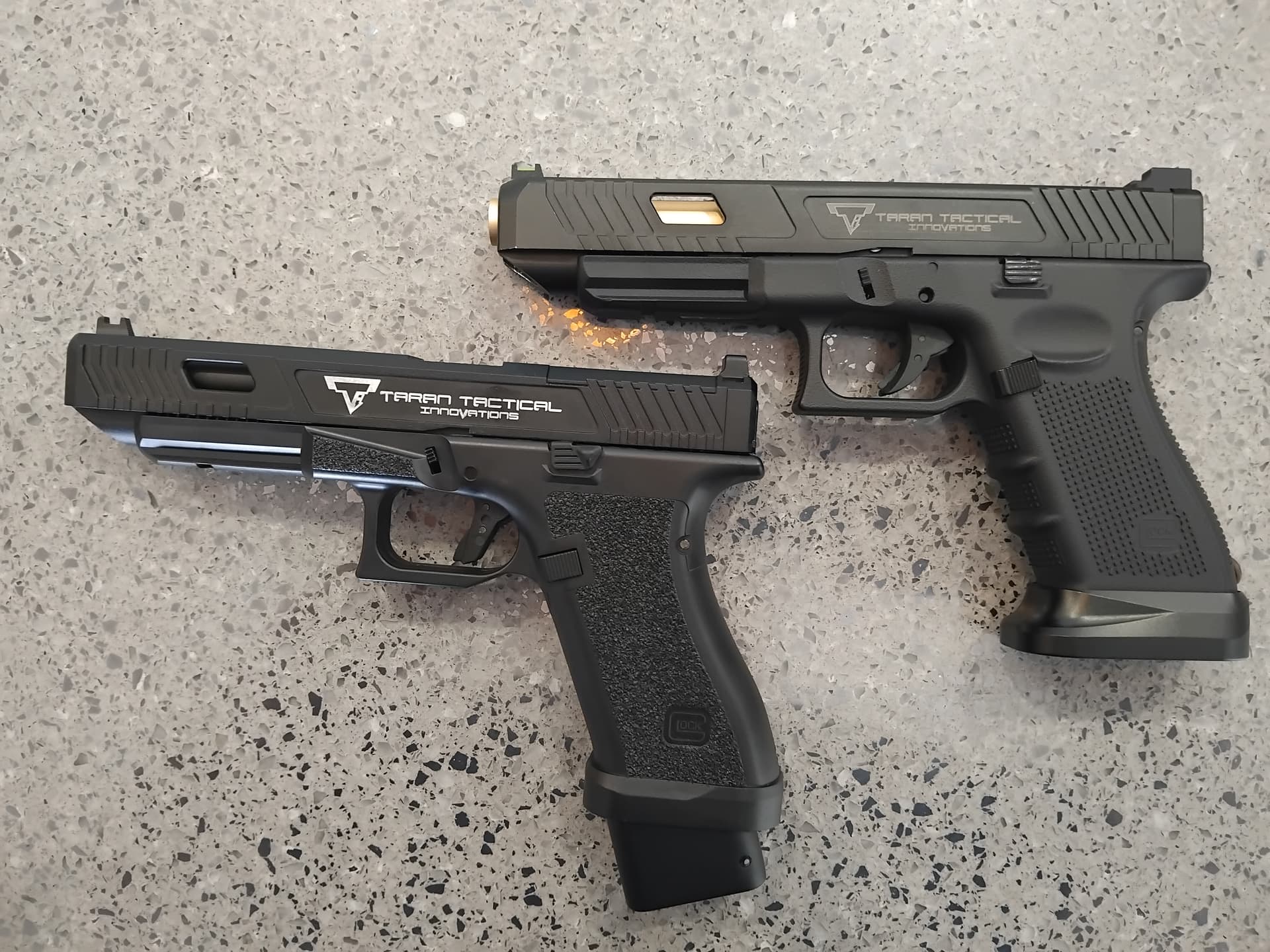

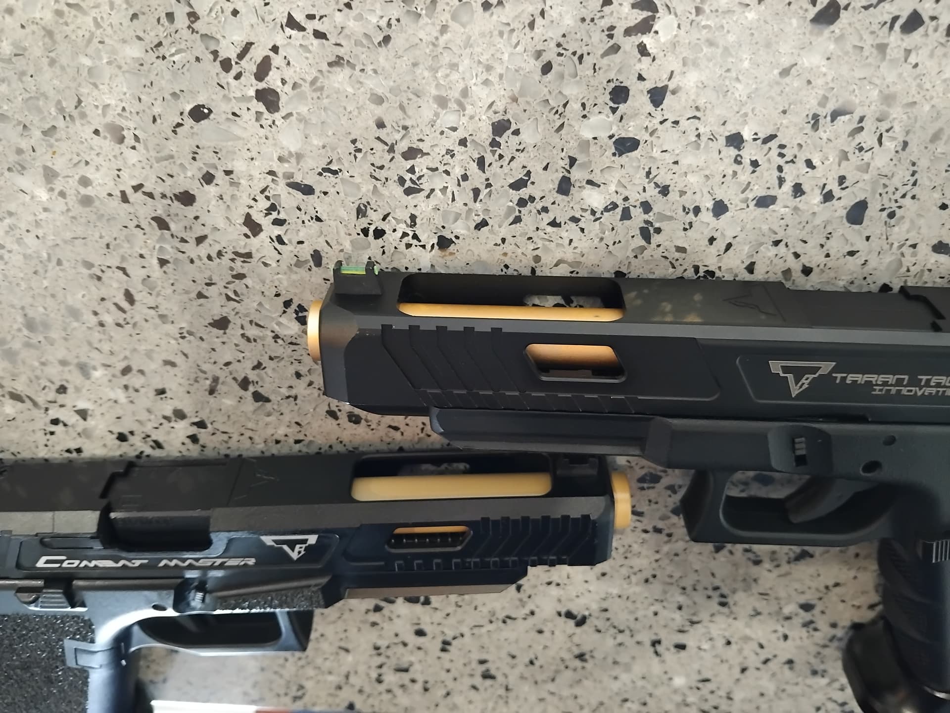

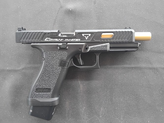

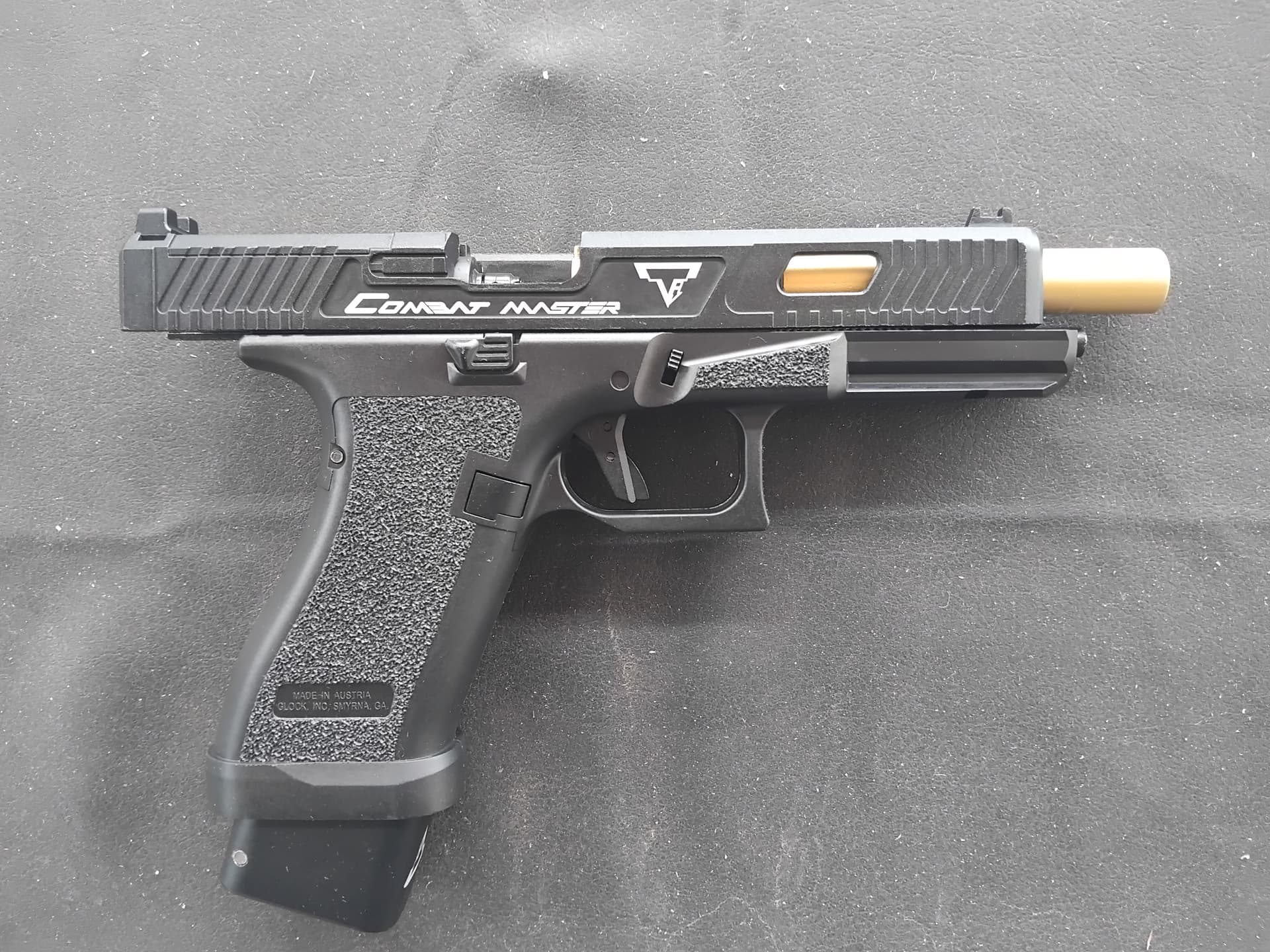

Comparo with tactoys 3dg special…
Outer barrel is good on that one…

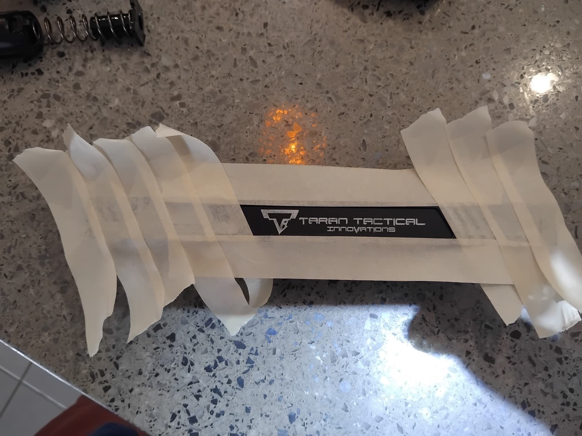

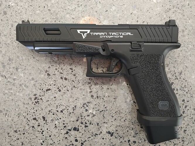

First, sort out the stenciing.
Cover with masking tape, and spray with ts-80 Flat clear…
A couple of quick coats, and it has come up well.
That should preserve the stenciling…

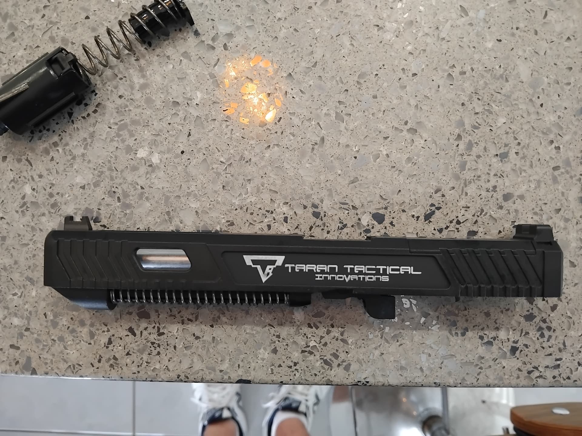

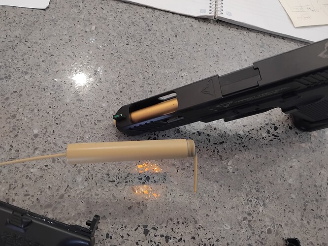

The silver is the inner barrel.

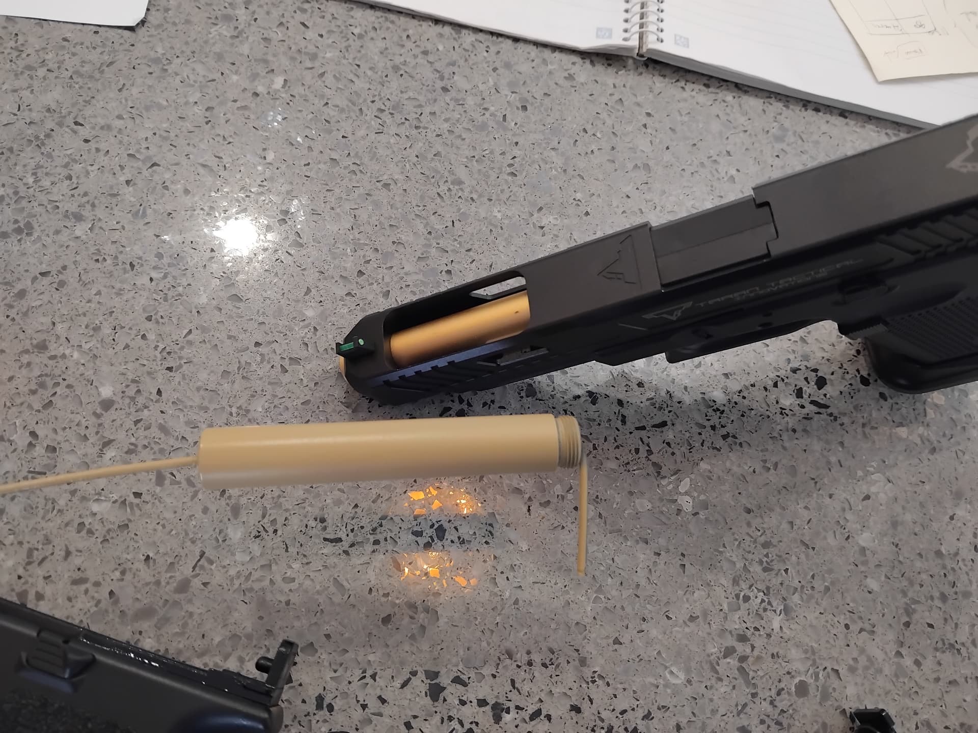

The outer barrel screws right off, for easy removal.
If all else fails, and final finish is crap, i’ll just go for straight silver…

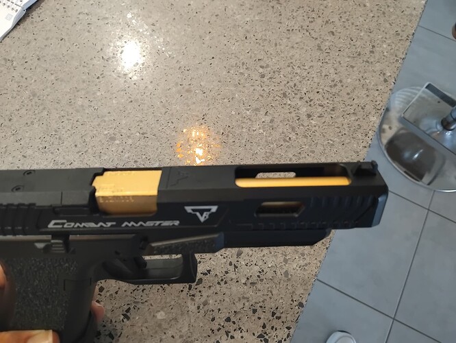

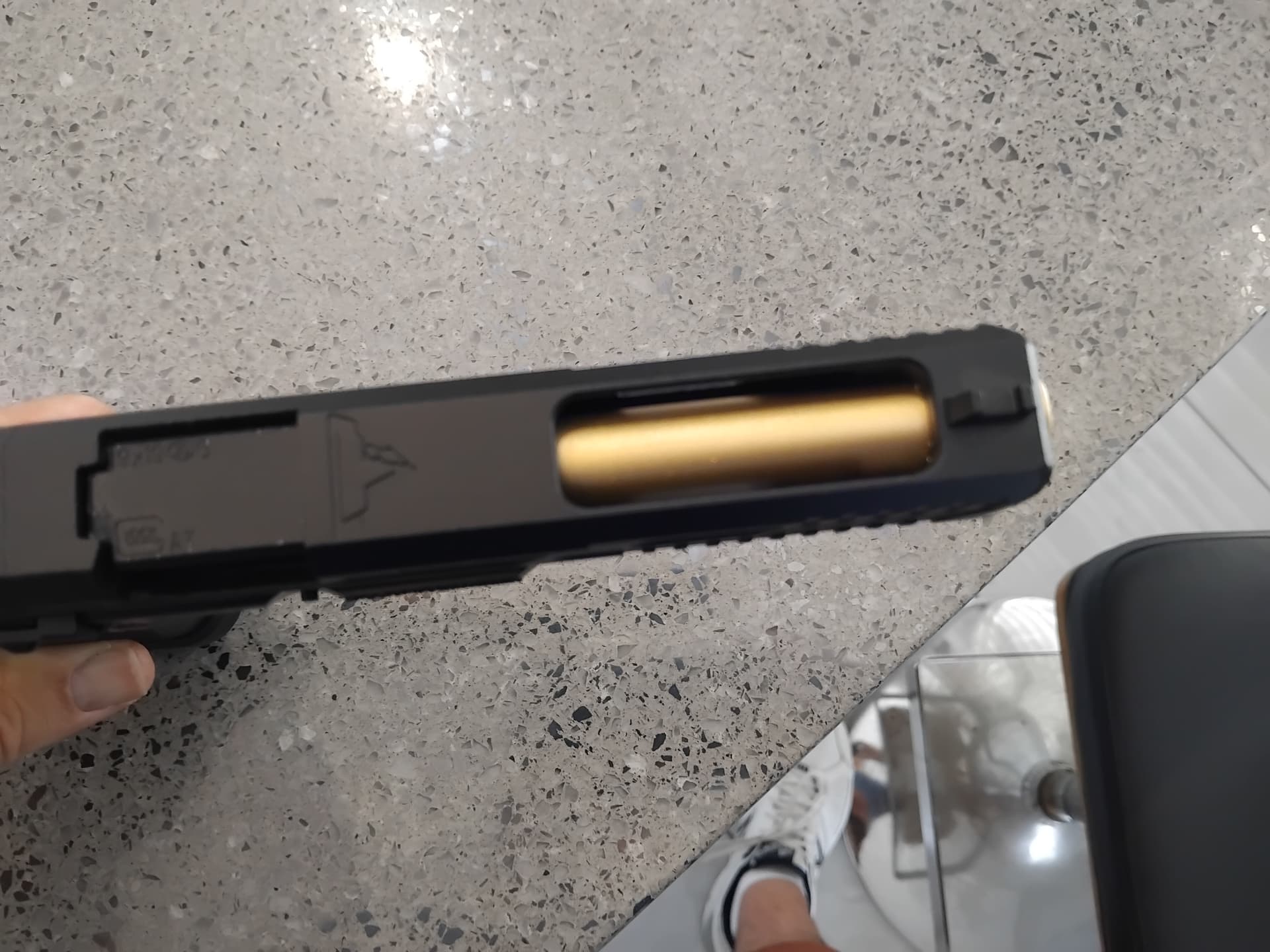

I unscrewed the outer barrel, and gave it a few coats.
The closest rattlecan colour i could find, was Tamiya TS-46 Light Sand.
I left the black on, and gave it a few coats.
Not the best colour match, but the best available.
50 Shades of brass…??!
:rofl: :rofl: :scream:
At the end of the day, its not a primary colour, and also recessed / hidden within the slide.
As long as it looks reasonable, it should be ok.
To try to match the metallic shine, i gave it a top coat of Semi Gloss Clear…
It looks…acceptable…
It certainly looks " Good enough", if you are not comparing the 2, and just look at it in isolation.

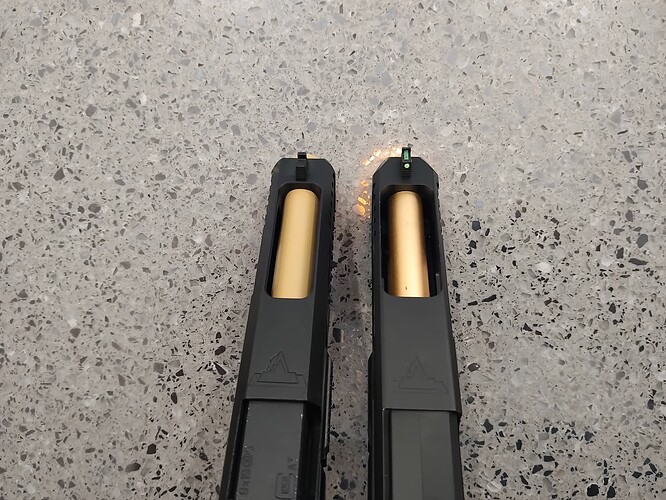

its a tough one…
looking at the taccies in the flesh, its more " brass" than “gold”…
But, Tamiya is cheap, cant hurt to give it a try…
Also…barrel clears the slide…no touching…no marking…

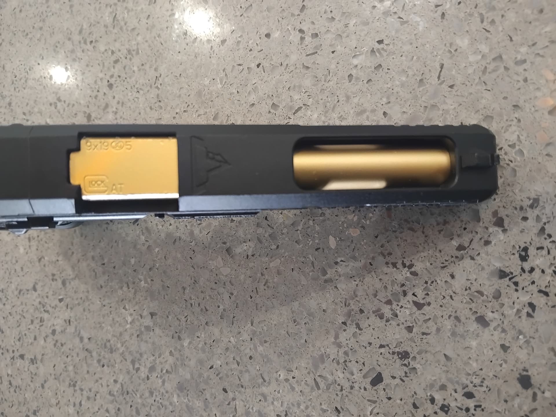

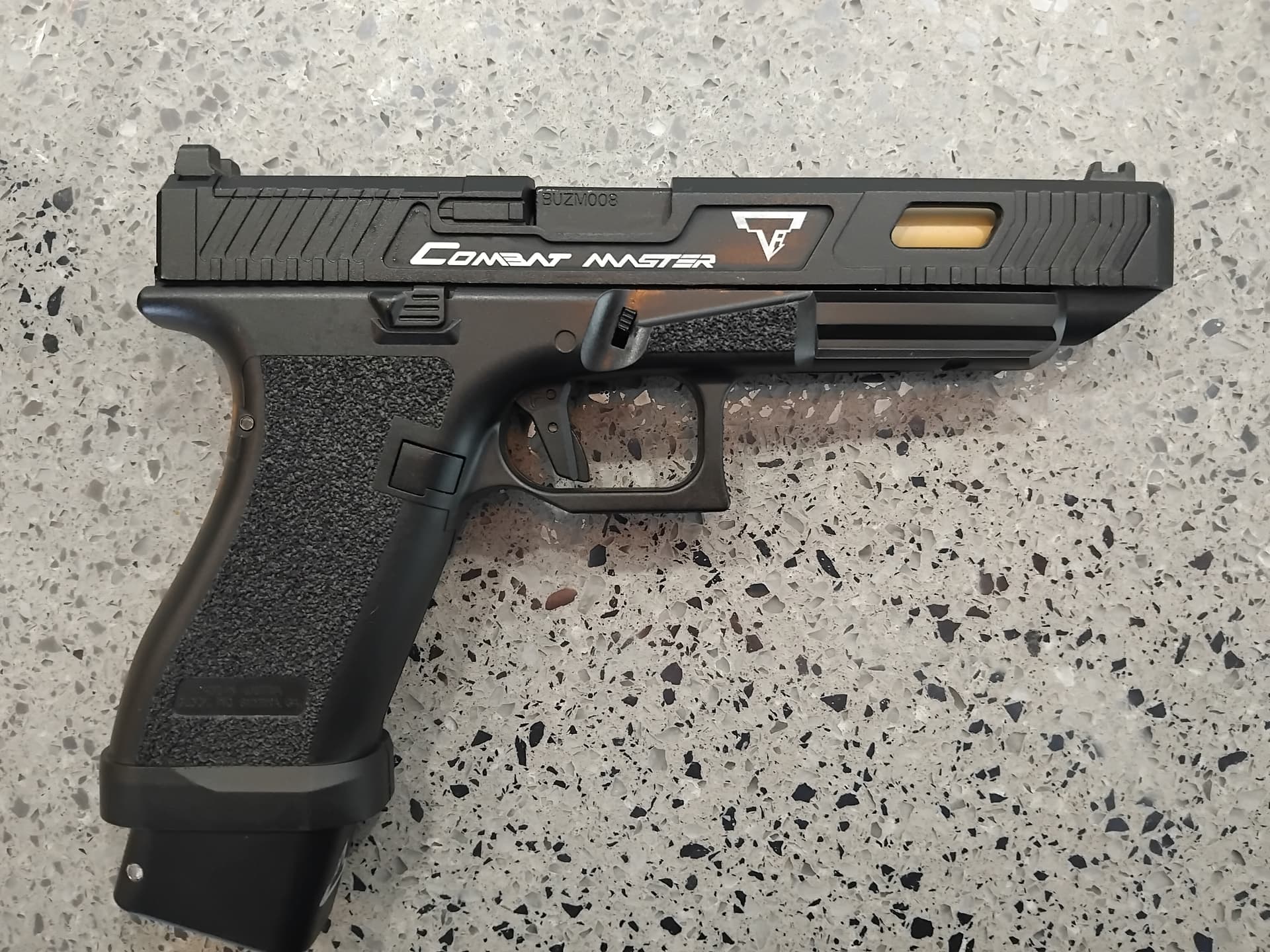

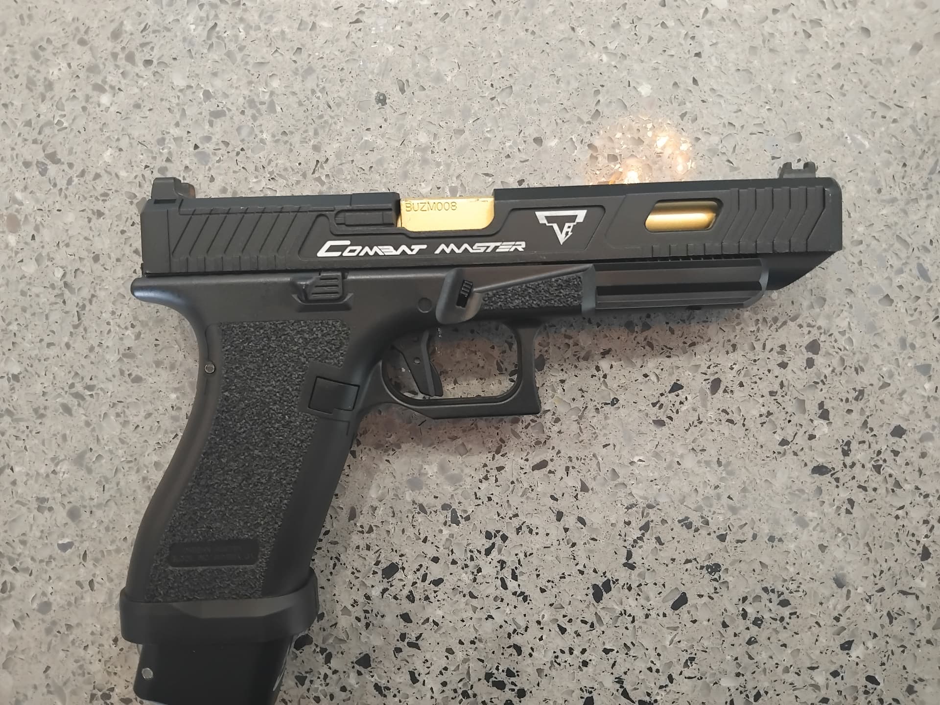

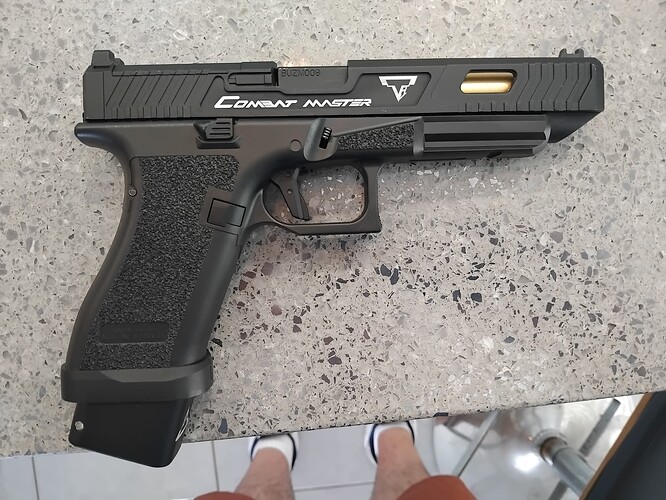

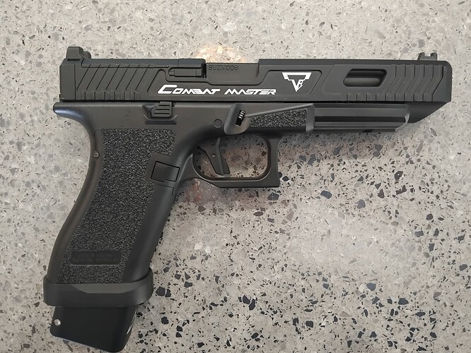

Ok… KELe redone, in Tamiya TS21 Gold, and TS 65 pearl clear ( glossy)
It does look better in gold…the 3DG finish was tarnished brass, and i was trying to replicate that…gold looks better…
All in all, good finish and result.
The pistol performance is woeful… 130 fps and shatters a few gels as well.
But, a cheapy John Wick knock off, that can be easily improved upon…

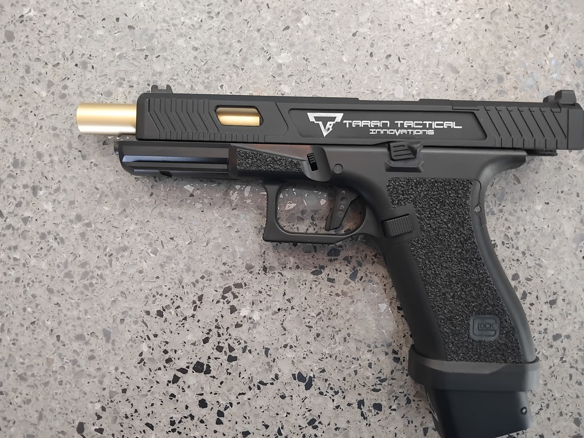

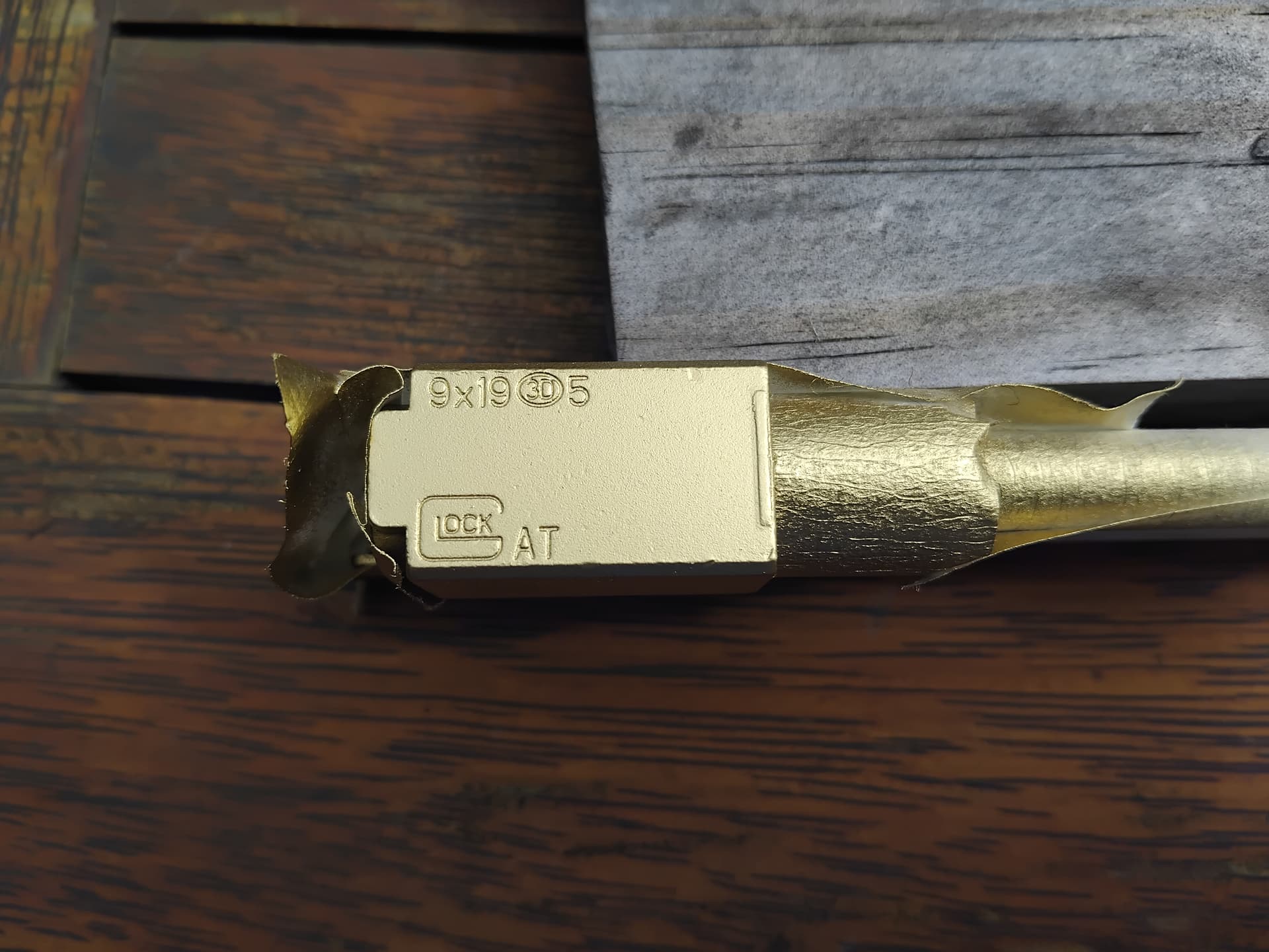

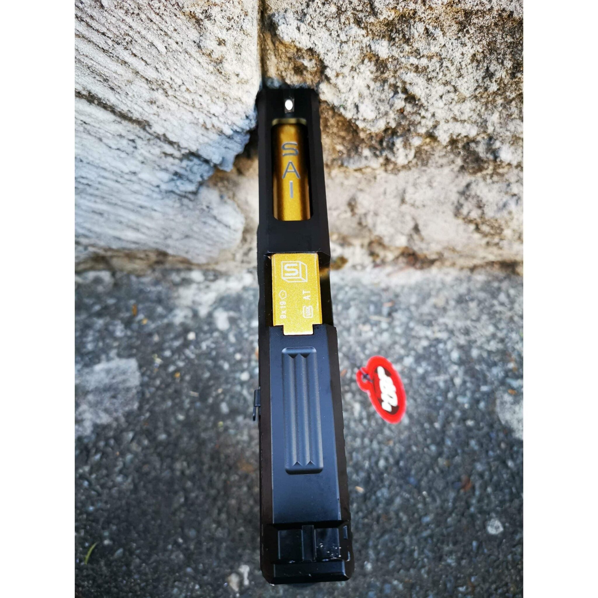

Having got some gold paint left over, and trying to put it to good use,
I decided to go " Full Gold", on the Tti, as per other models…
(reference pic)

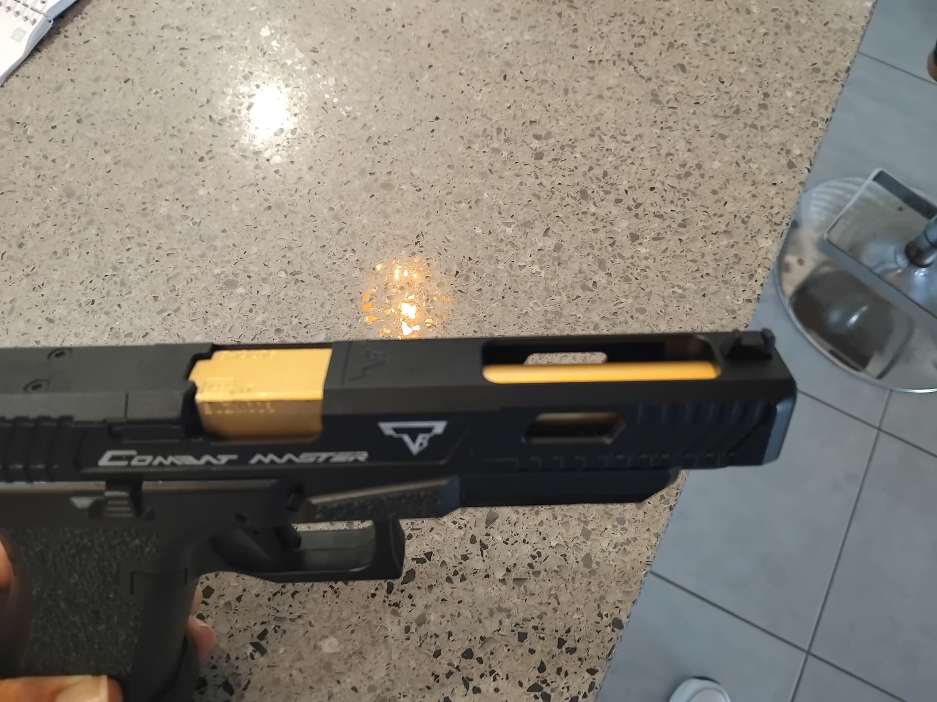

my frame is currently black, around the ejection port.
It is a bit risky, the slide is a bit wobbly, and may contact the painted area, upon racking.
However, the black frame area only has very light scuffing on it, so it should be “Mostly OK”…

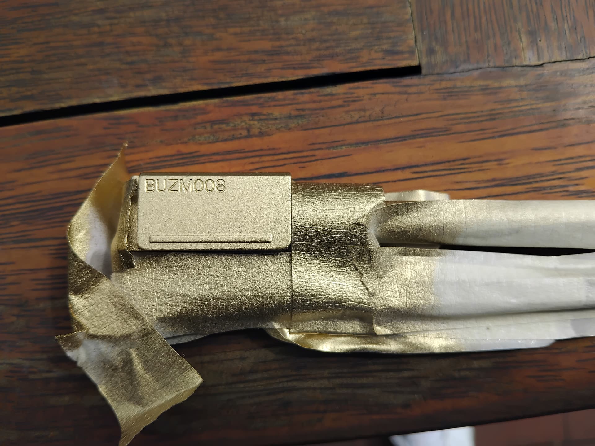

Pulled apart, taped up, and painted…
The gold really does highlight the lettering…it was nearly invisible before, on the black.
Let it dry overnight, coat of clear, and see how it goes…
I did “round 1”.
got it in…but the paint got a bit scuffed, getting it into place.
two opposing springs, and all that…and maybe paint was still a bit soft.
Once its in , it seems to be clear of the slide.
So, pulled its been pulled down again, and another touch up coat.
longer to dry this time…and, ill cover it with masking tape going in.
Hopefully the tape will protect the paint from scuffing going in.
Then remove the tape, once its in place.
It was always going to be a bit risky, in a moving area…lets see how it goes this time…

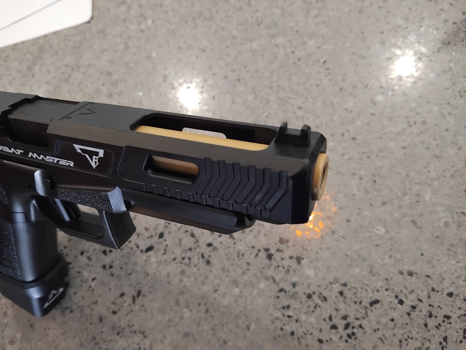

All done.
The secret to getting the block back in, unscathed, is the masking tape cover.
A bit of jiggery pokery required, but no scratching this time…

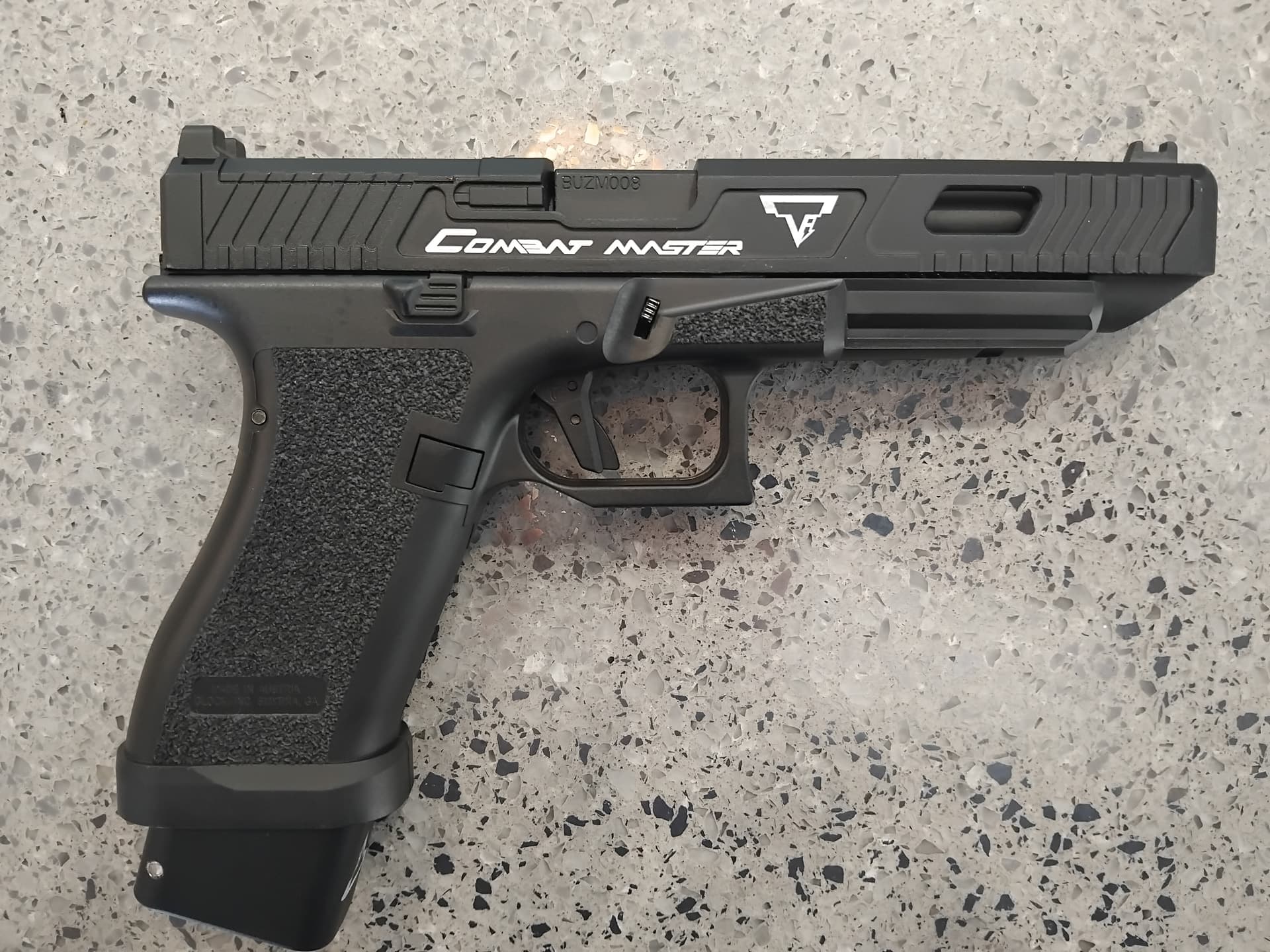

It all came up quite well…
Outside shot is a bit glare-y…
Ive cycled it around 20-30 times.
No signs of contact or wear from the newly painted block, around the ejection port.
The slide doesn’t seem to contact it.
A very slight contact line, on the under side of the outer barrel…
But thats right at the bottom of the barrel, and cant really be seen…
Good result…!!
Good cheap knock off, if John Wick is your thing…!!
