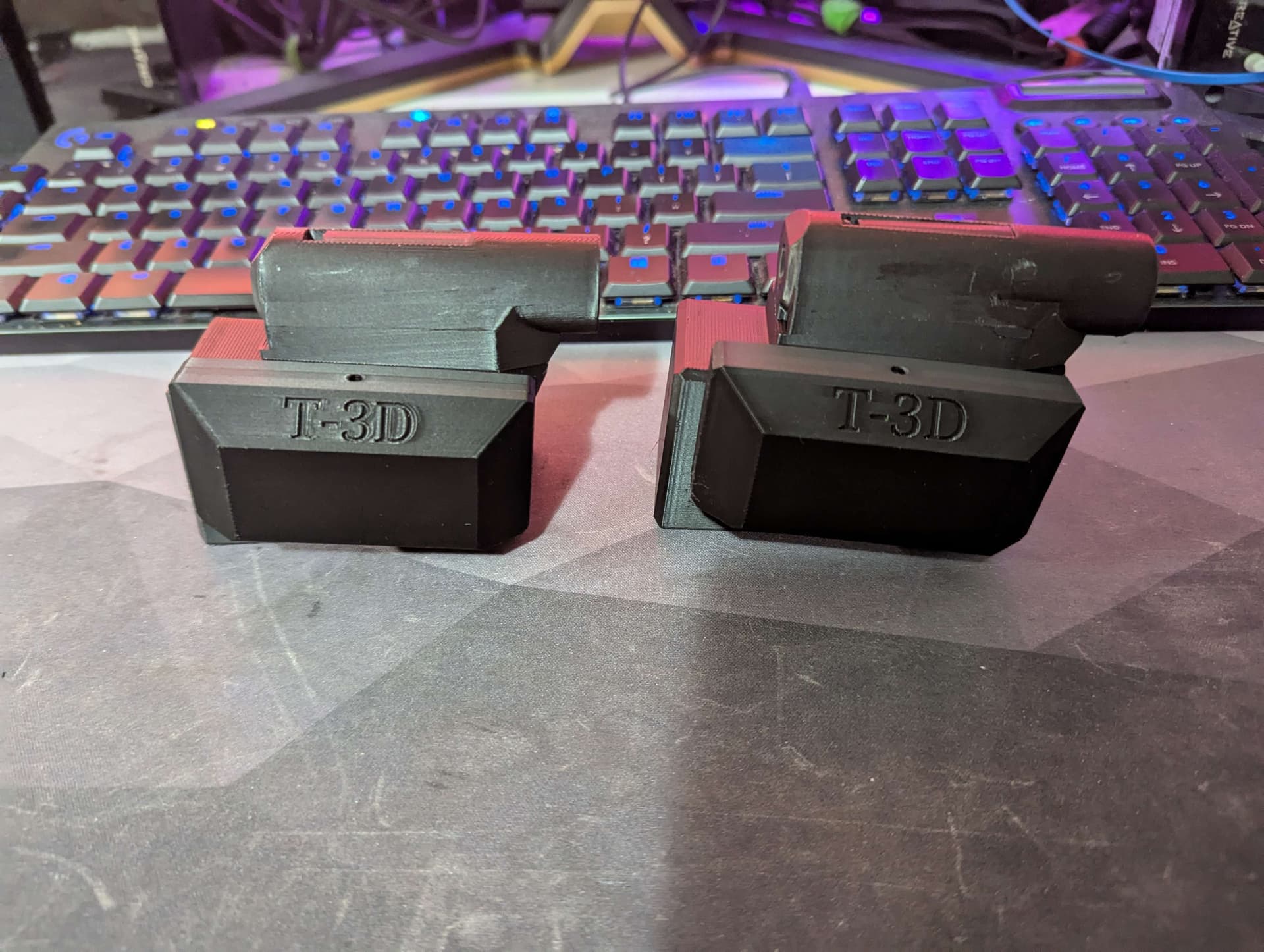

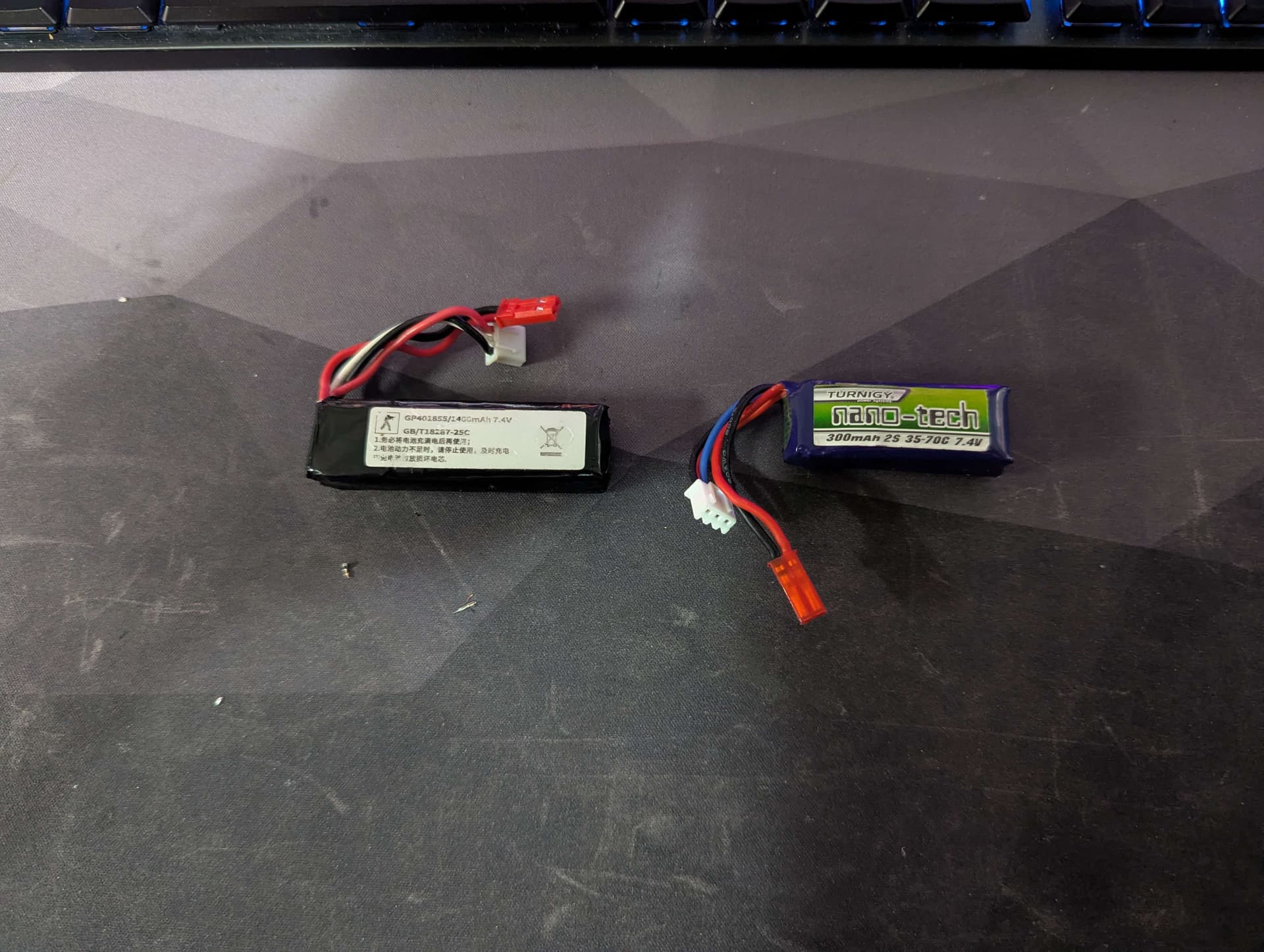

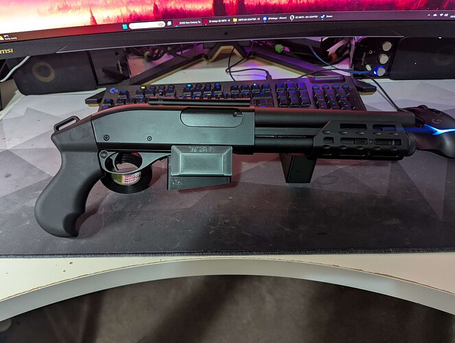

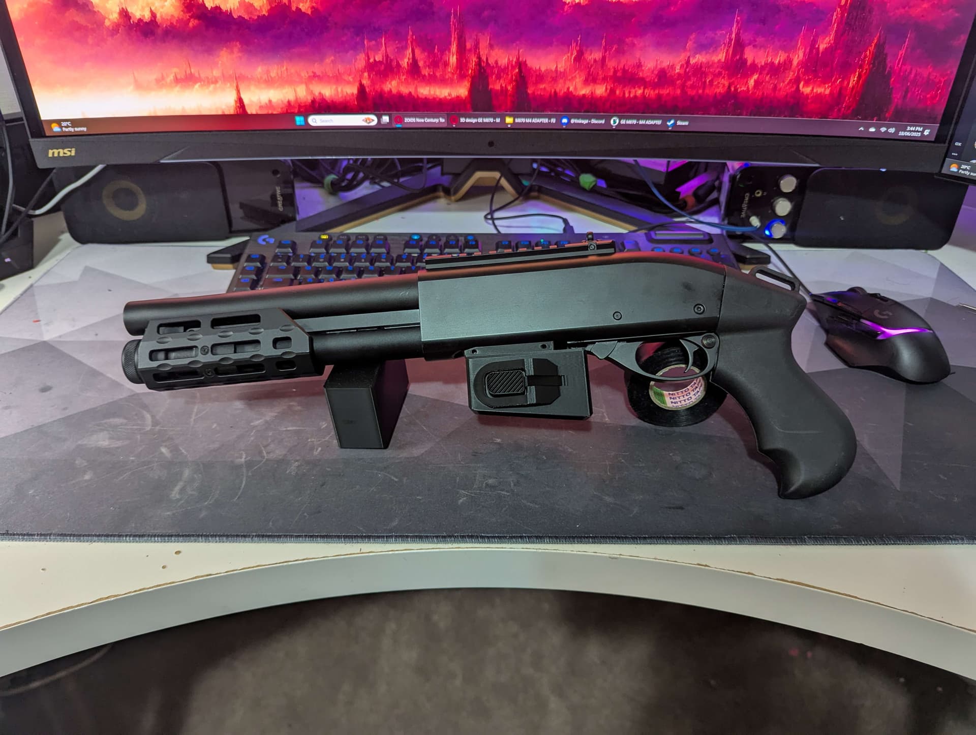

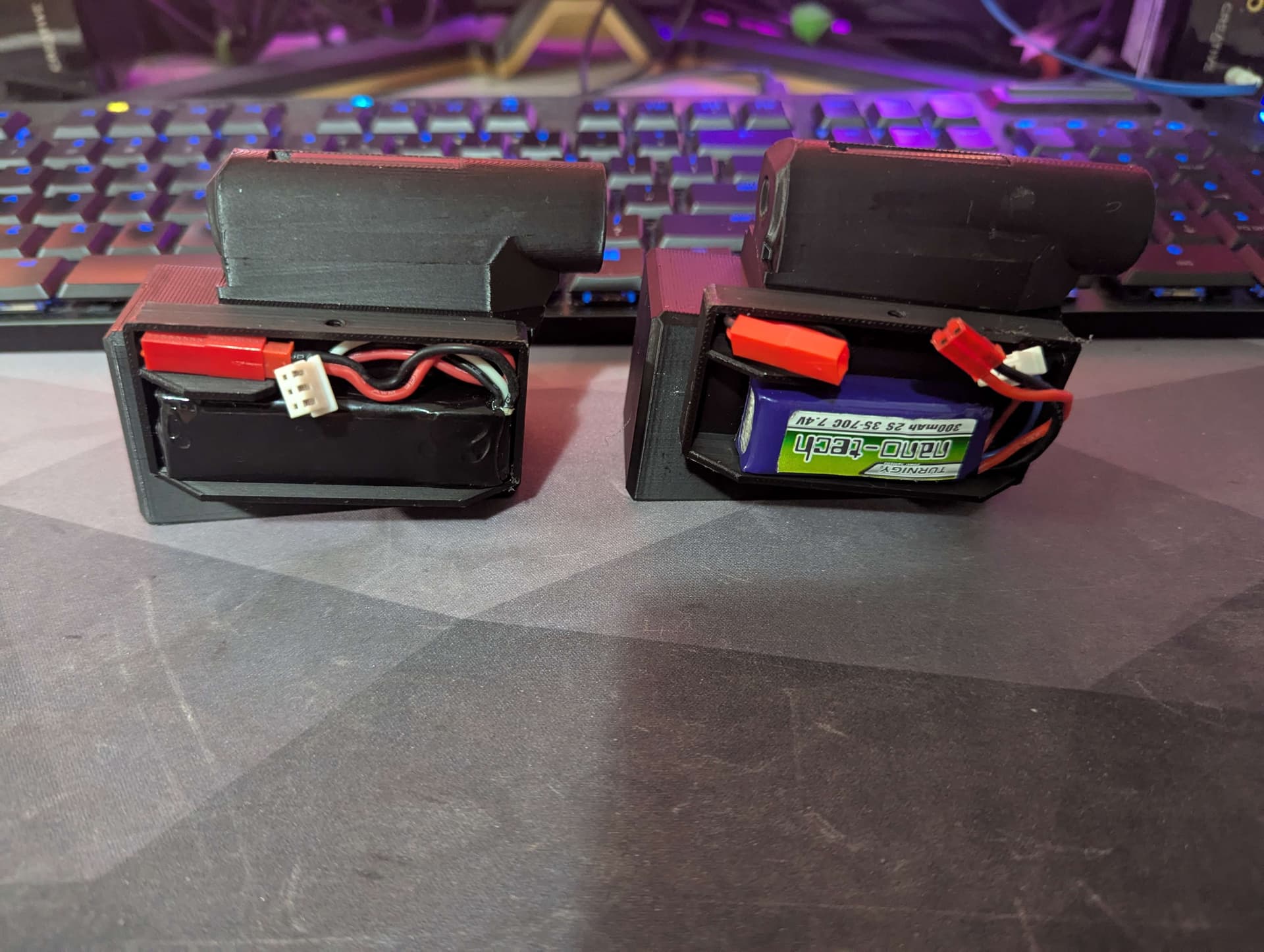

Some more pics, showing the adapter, battery types and placement -

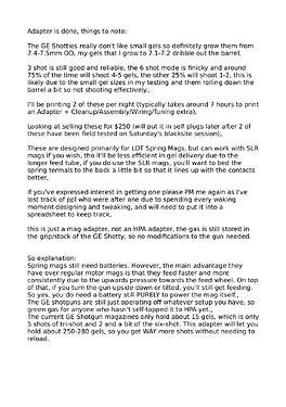

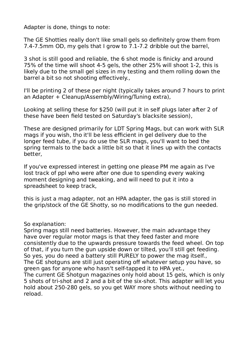

And some info from the person who designed it -
You can say what you like about GSAU, but there are some very smart people on there.
Is that $250 per adaptor? That’s crazy for what it is will the final product be CNC’d aluminium or something? do they chuck the battery in with it? Thou they’re only like $5 anyway…
I know how much time and materials go into prototyping stuff like this but that just feels excessive. Hardware and electronics would only cost like $10 a unit too, and once the model is zeroed in material used would be maybe $5 worth, they must be charging a lot in labour.
I was mentioning it as the basis of an idea that people here might consider into designing and making their own using this concept.
Definitely would be cheaper than buying one of these and be a great little project to play with. :thinking::+1:
It’s great seeing different people’s takes on the same project don’t get me wrong, but seeing ppl asking crazy amounts of money for something (to me at least) just irks me.

100% if it was a CNC aluminium product then he’ll yeah 250 quid is acceptable, 3d printed though you’d have to be nuts to think it’s worth that. Guy said he will be making two a night, so his P1s, $1499 printer and material will pay for itself in around 7-8 adaptors. Nuts.

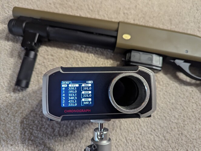

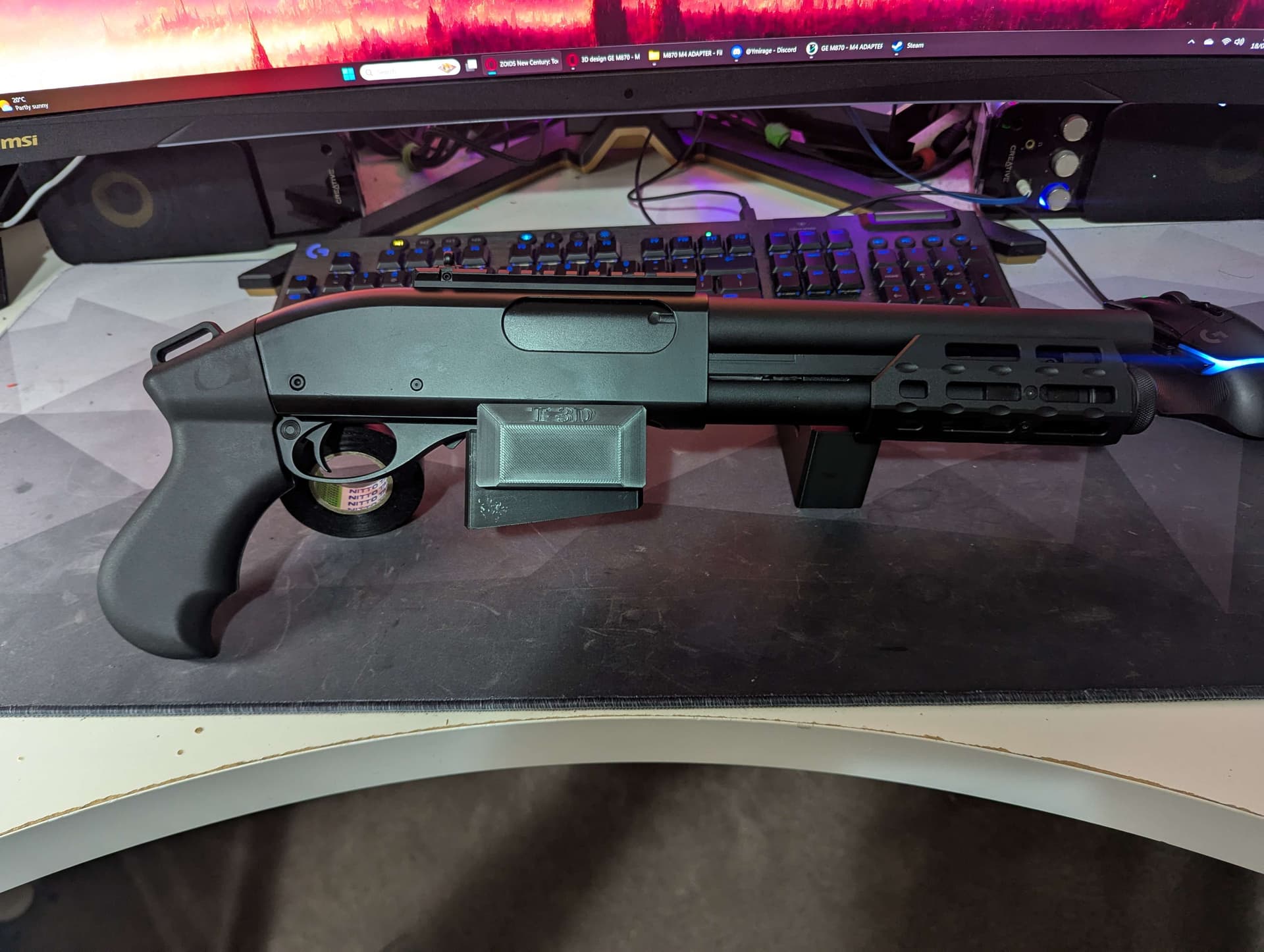

I have had a good bit of fun today with the shorty.

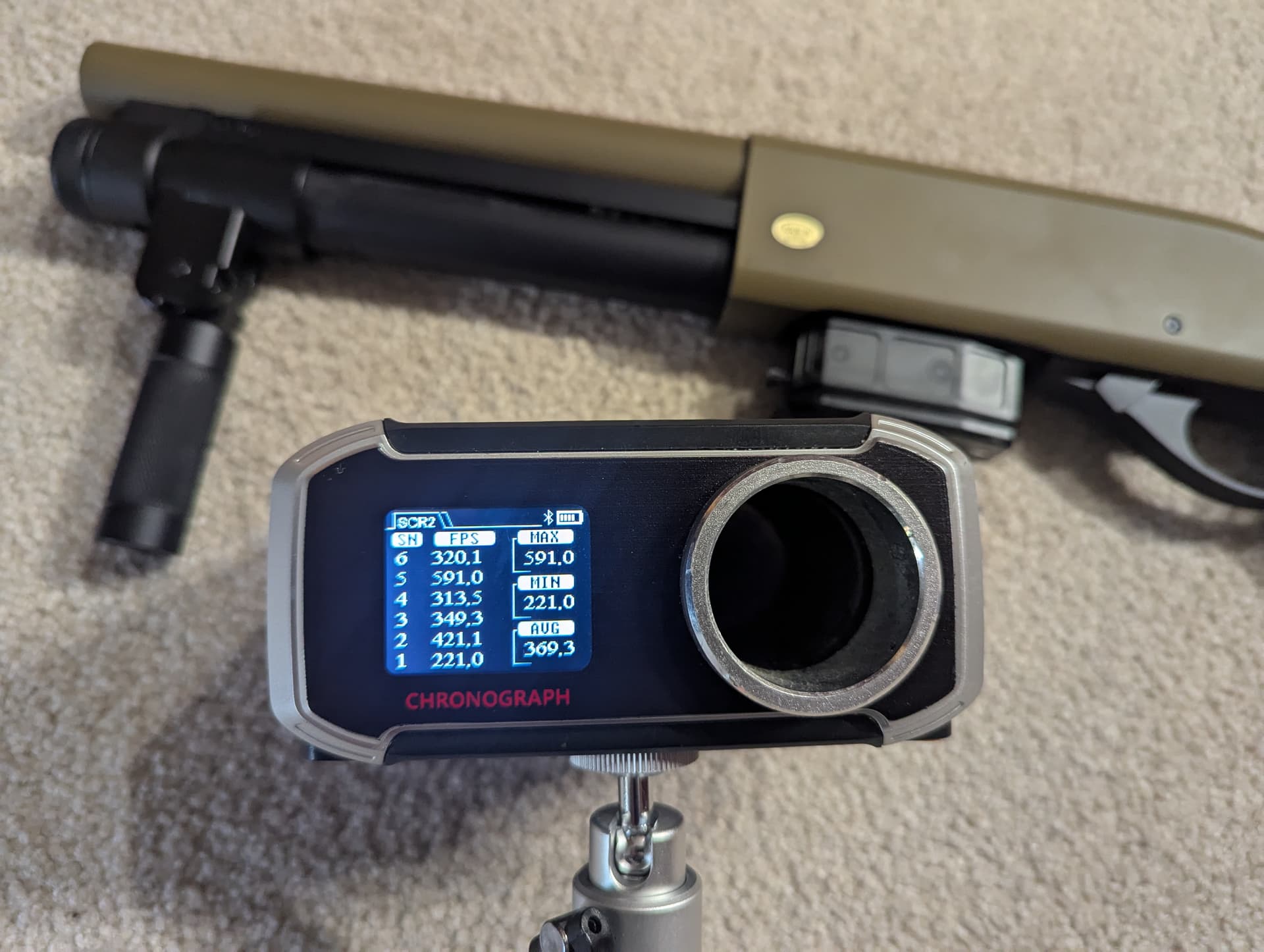

Chrono didn’t like it one bit, multiple gels at once or the gas just couldn’t get a reading from more than one gel per shot… Or an alleged single gel. Might have been reading all 3/6 gels as one… or gas. Even tried standing back a metre and still got some wild readings.
Not all 6 shots were on the 3 gels setting, and all registered as “1” gel/shot.
Can say if you only load a single gel it is pretty wild though, and since it will sometimes only load 2of 3, or 4 of 6, and the mag only holds “15” gels… it is likely the last shot of a mag is gonna be pretty spicy!
They say the mag holds 15 gels… if they are on the smaller side then yes… but the spring is tough enough to launch them out of the mag with a slight bump. Using full size gels that hold on the mag well it’s more like 13 gels.
Fun and satisfying to use, good fun. Pretty gas efficient to as it isn’t cycling anything just launching gels. Taking it for some field time tomorrow to see if it’s fun as a secondary, instead of a pistol. Should make for some laughs at least!
I think I’ve only done one full tanks worth of gas and have gotten probably 20 mags so far and can still get more, thou mine bring that buffer tube version I think holds a fair bit more gas than those in the grip.
Got any idea how it’s powered on and off? Surely it doesn’t feed all the time?
That detail isn’t described, though I would guess it is a “shaker” style actuation. Have not investigated the possibilities but perhaps a momentary switch somehow could also work.

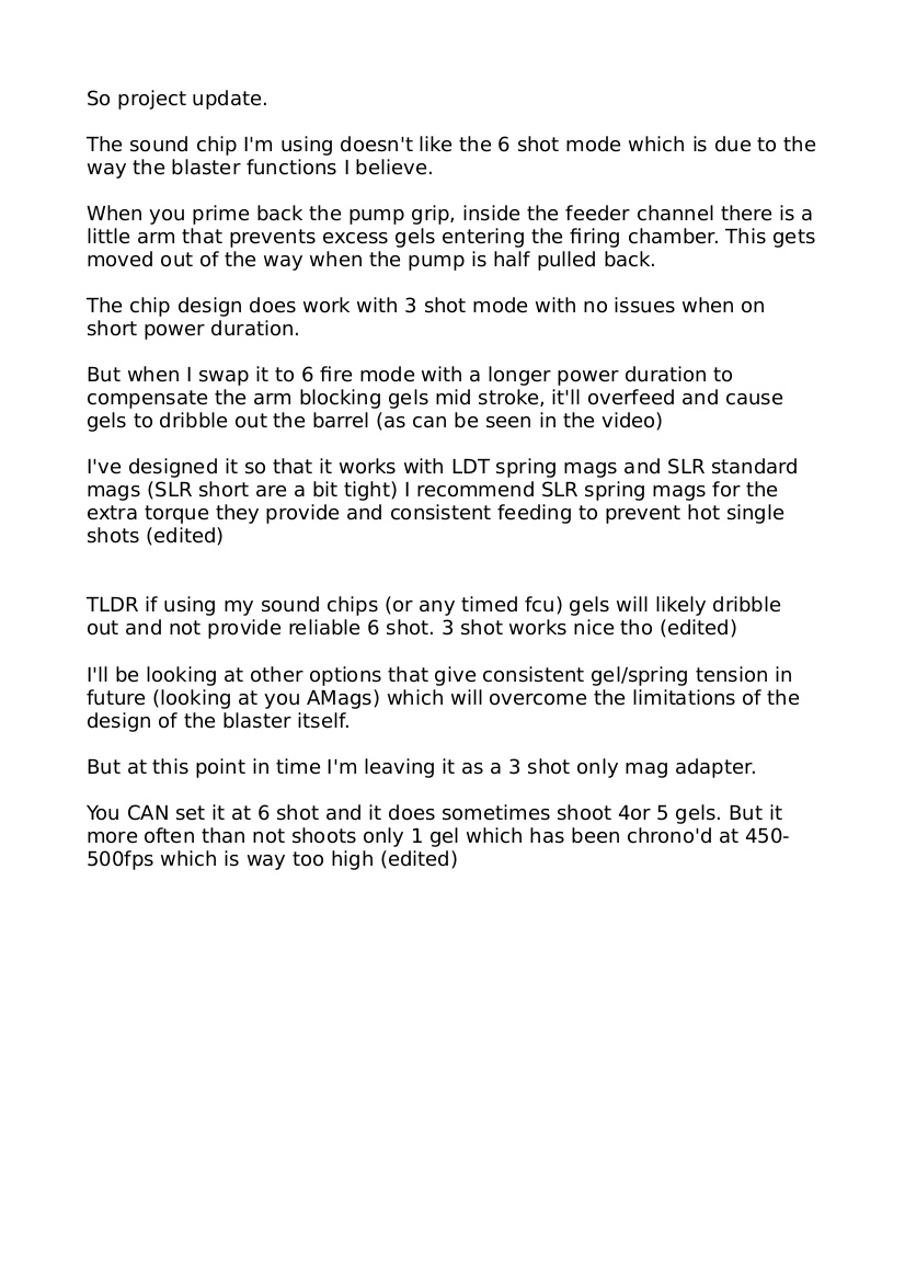

I am guessing the feeding issue he lends to means it is only loading 1-2 gels, which makes the blaster shoot very “hot”. I found loading a single gel would see readings well over 400fps, not just a little over… WELL over!
Using smaller gels that reliably fed well would see 2 of 3 gels roll out of the barrel if pointed down, and smaller gels also had a issue where the spring would overpower the mag stop, sending most of them out of the mag when bumped… I have been using larger gels (7.5-7,6mm) from the oversize sorting! Though that can lead to only loading 1 or 2 instead of 3 occasionally… which means they are hot AF.
Using the 6 gel setting, would more often see it chambering 3-4 gels, and sometimes 5 or 6. That brings the fps down quite a bit, but still when I had the missus shoot me a few times with it, there was 1 or 2 very pokey ones, and a couple of gels bouncing around the room.
For the most part, most shots did fire the amount of gels it was meant too, but limited capacity in the mags, leads to the last shot being a bit lean on the loading.
Now bear in mind, I bought the shortest, lowest fps version, longer ones are alleged to be hotter. It could run lower power gas than the normal 12kg green gas, like 134a… which you can’t buy unless you are a fridgey! That is what the TM version was made to use originally.

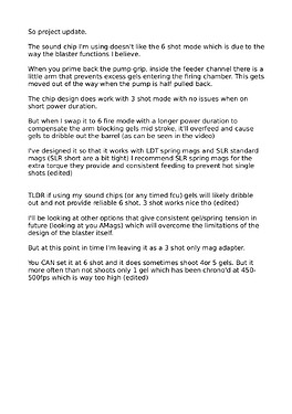

This from early testing -
But, I couldn’t find any more info on what he ended up using.
450-500fps… dwaaaam
