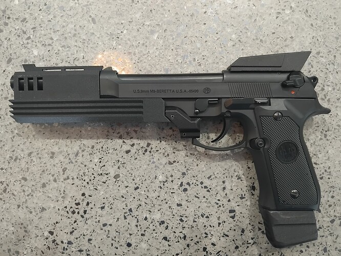

Gotta Getta Retta.! EBB M92..( Or..Dress me up, dress me down.. Robo/Burton is in town...!)
Removed just enough front sight, for the mod rail to fit on…
Its not perfect…
The grips are open at the rear…and the mag extender stops the mag from fitting properly.
Rail is not attached yet…snug fit check only.
enough for now, im buggered…

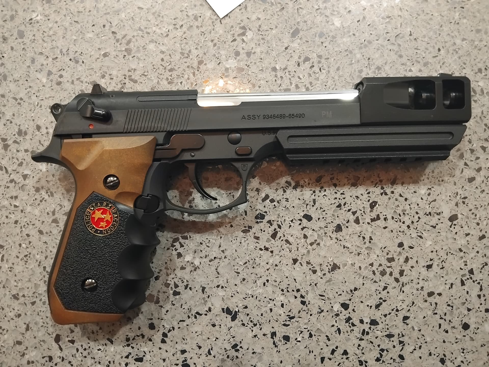

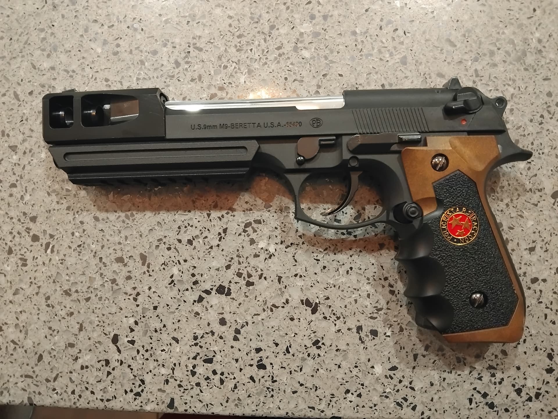

The Burton Burger is finally finished, and what an adventure it was.
Just quietly, im a little proud of myself…when i had my first one done, no way was i going to attempt to drill it out by self…only one available and all that.
Did this all by myself, so pretty happy with that.
Less nerves, when everything is replaceable…

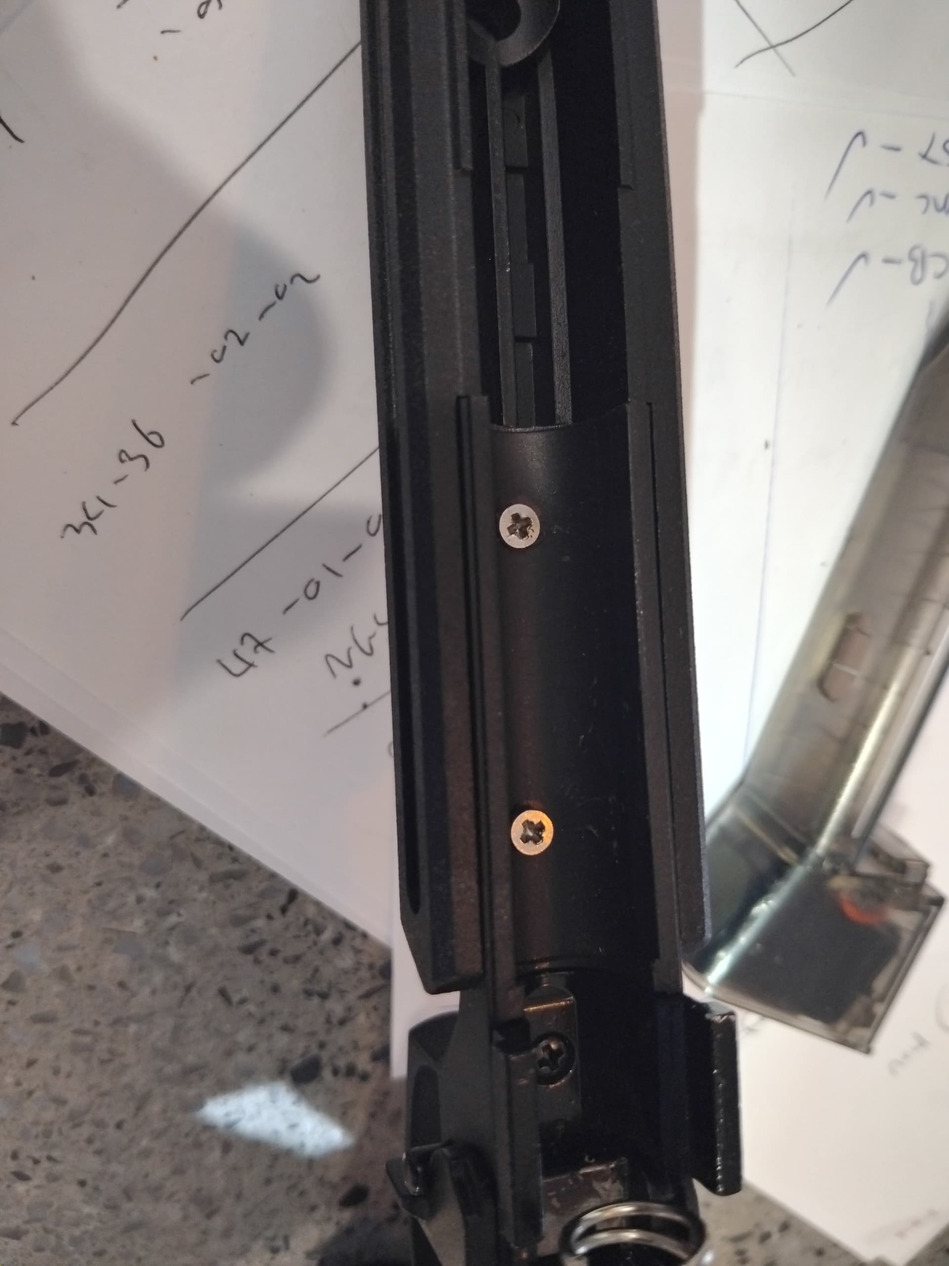

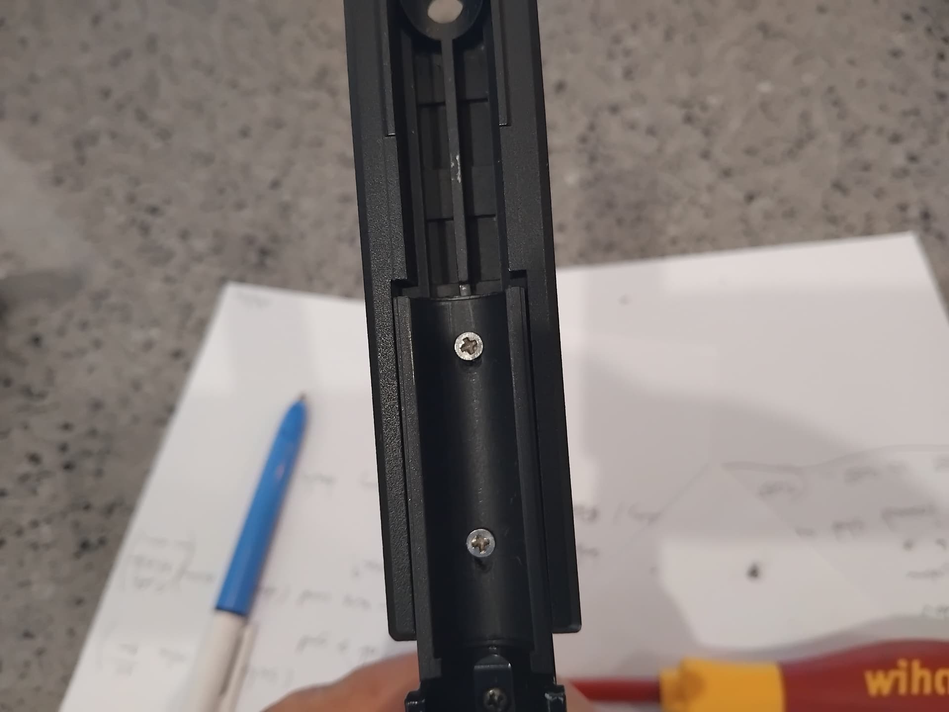

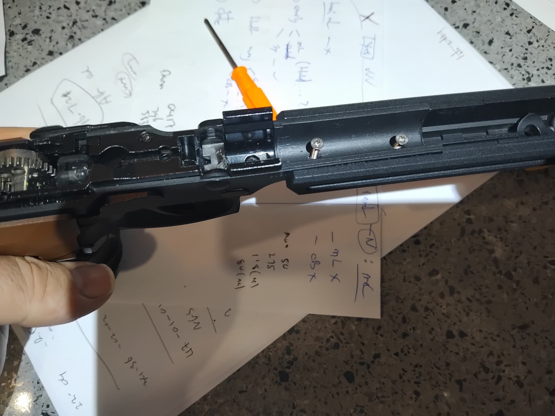

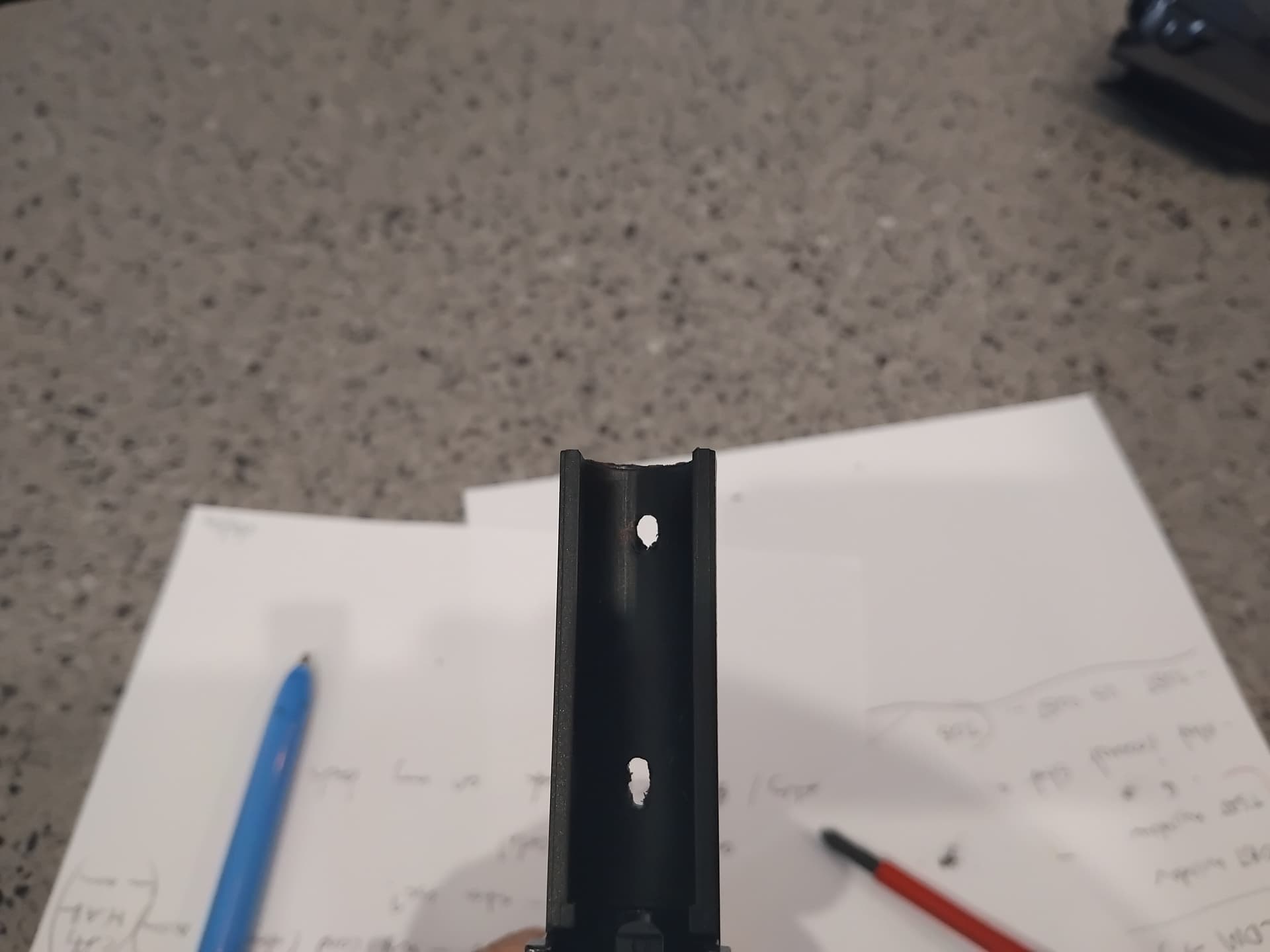

So, i had to get the right screws, cut them to length, and drill through the bottom of the blaster, in the right spot , to get them to fit…
The screws are non-standard 2.5mm … hello northside fasteners.
M3 wasn’t going to fit.

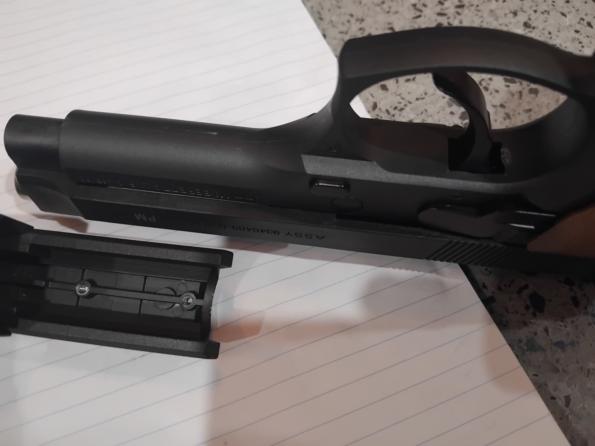

Anyway, the lower rail receives the screws, through the holes in the bottom of the blaster…
The WE TECH M92 has the holes in the blaster pre drilled…have to locate and drill these yourself…

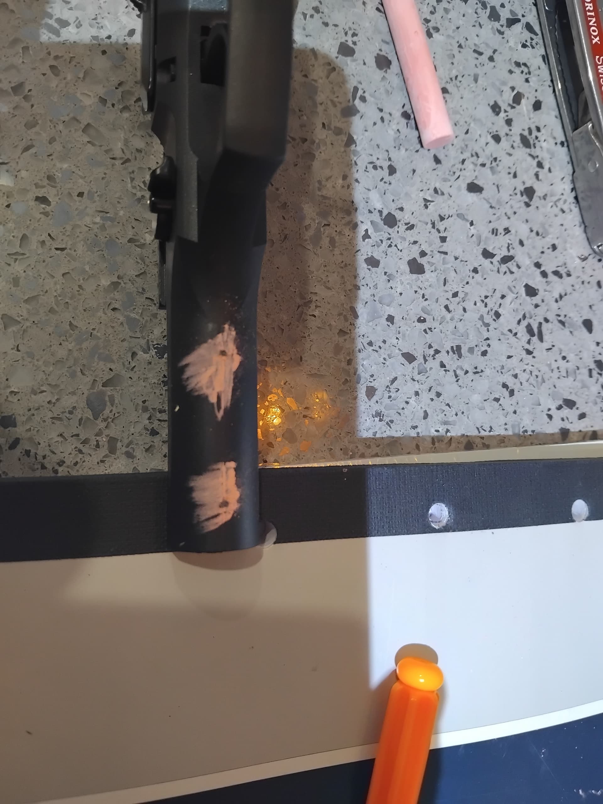

step 1: cut heads off screw, have small amount of thread just protruding, in both holes…to stamp and mark…

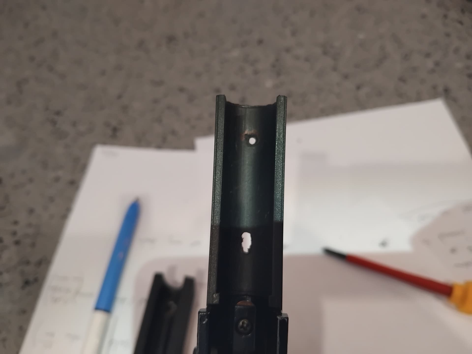

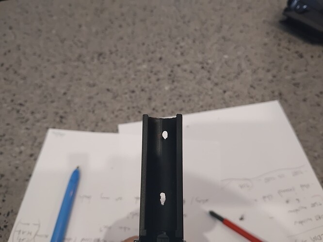

Marked some chalk onto the bottom of the blaster…located, and whacked with a mallet…marks and indentations left behind…enlarge with a holepunch, then drill… ( easy to drill through nylon).
Drill through that…nearly a perfect fit…
front screw screw went perfectly in…rear hole needed a bit of drilling out to get screw aligned properly…
Fits perfectly, right…!?
Nice snug holes, no slop, screw tapped thread onto the nylon on the way through…all fine.?
Right…??

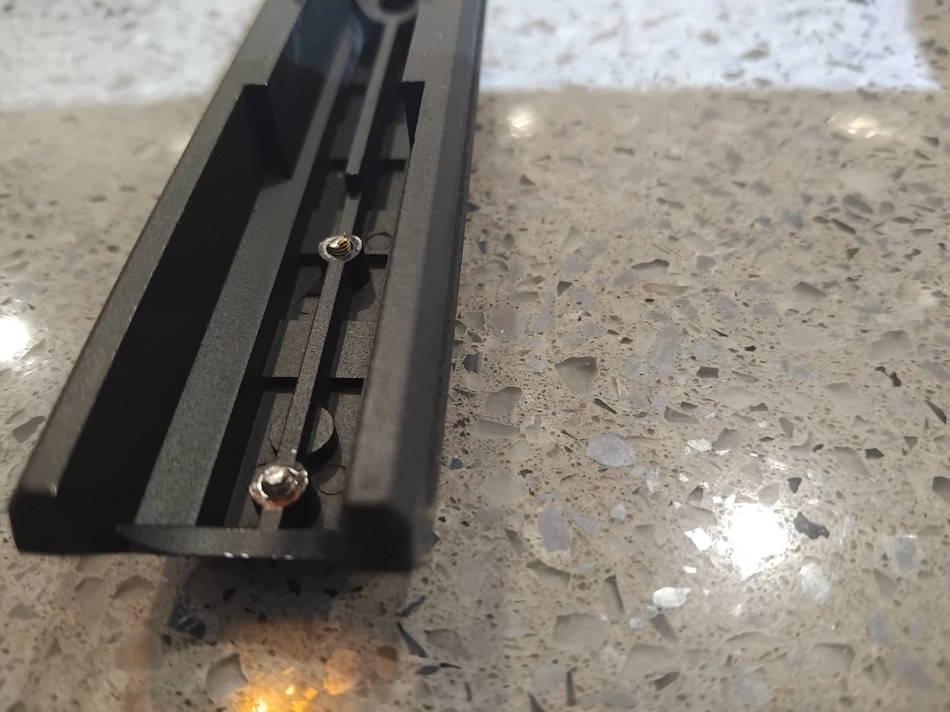

Nope…Murphy dont let you off so easily…

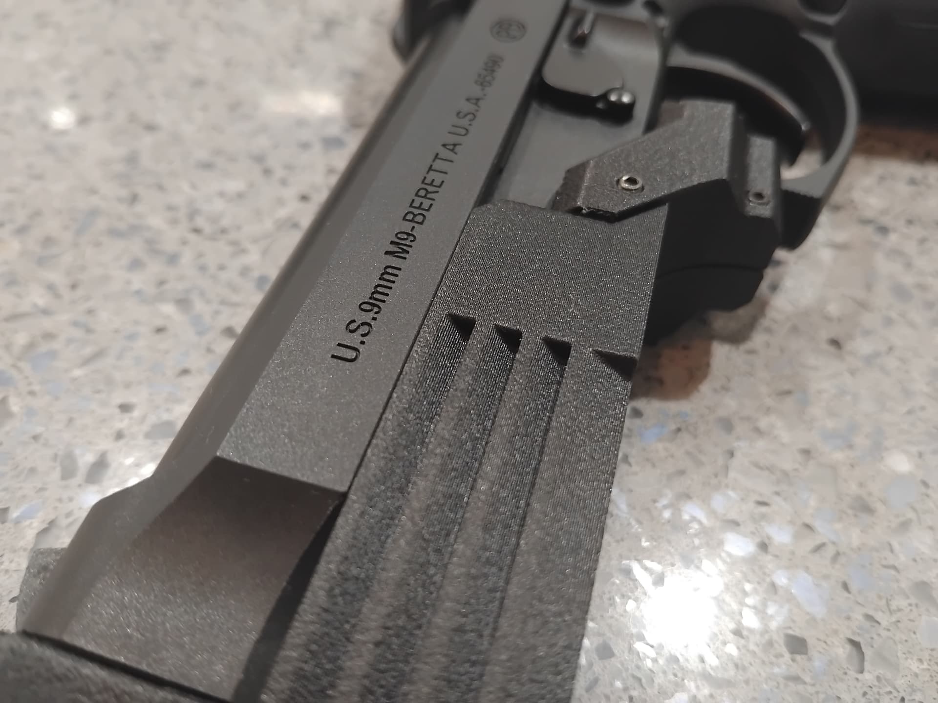

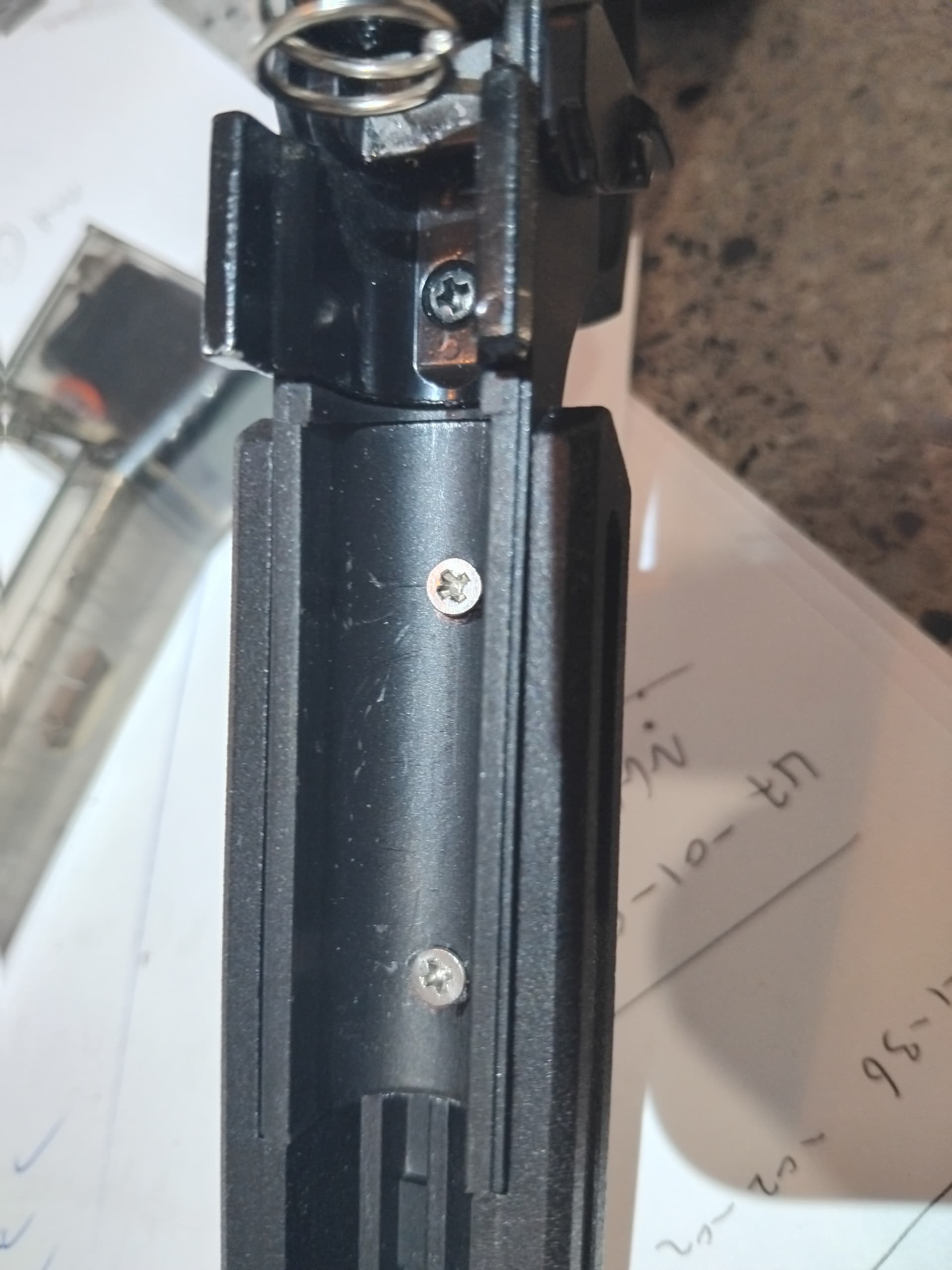

Notice the flush fit, with the rail and the base…no gaps…as intended.
However, what is a perfect fit for the WE tech…is not what is required here…
When i put it back together… i npticed the moderator had some resistance aligning. I had to push the slide back to get the moderator holes to align for the bolt.
When i fired…it cycles…but gels were coming out at about 80 fps…
WTF.?.?
I removed the moderator, and it performed properly…
The moderator was putting some backward pressure on the slide, and screwing things up.
The whole rail system, had to move forward about 2mm, to get pressure off the slide…
easiest way… enlarge holes in nylon blaster…move them forward, so rail can move forward…
That perfect threaded hole, was wasted…
This was delicate drilling, so i used my dental unit…high speed handpiece…
rear hole done…
Bye Bye nice front hole…front hole done…
Now the rail fits in a more forward position…
Note the gap at the front, between rail and blaster slot…
Anyway, it all went back together properly…nothing catches / no interference…
Cycles properly and perfoms well now…

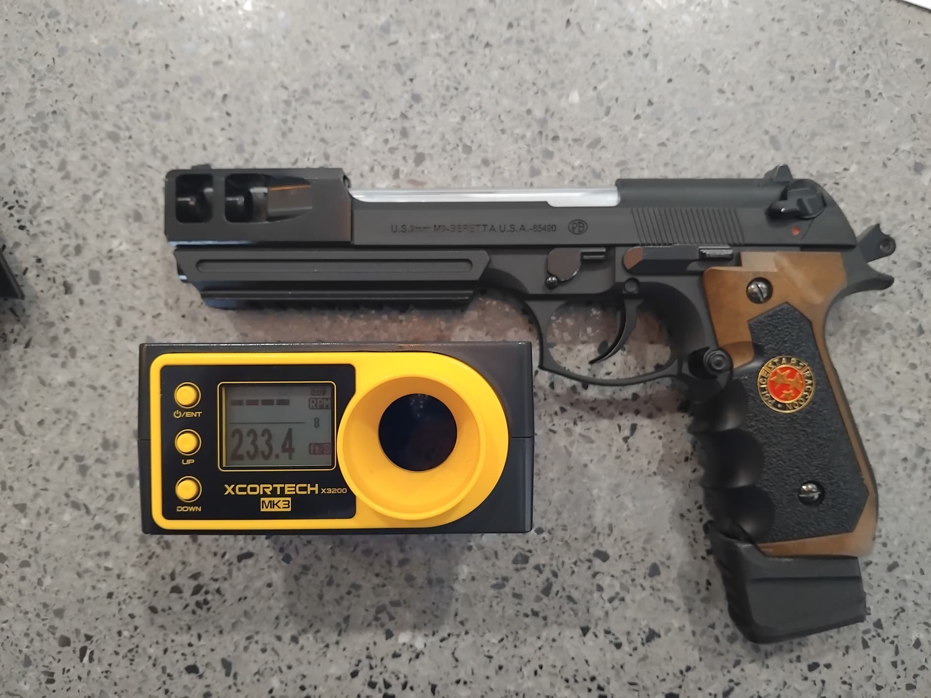

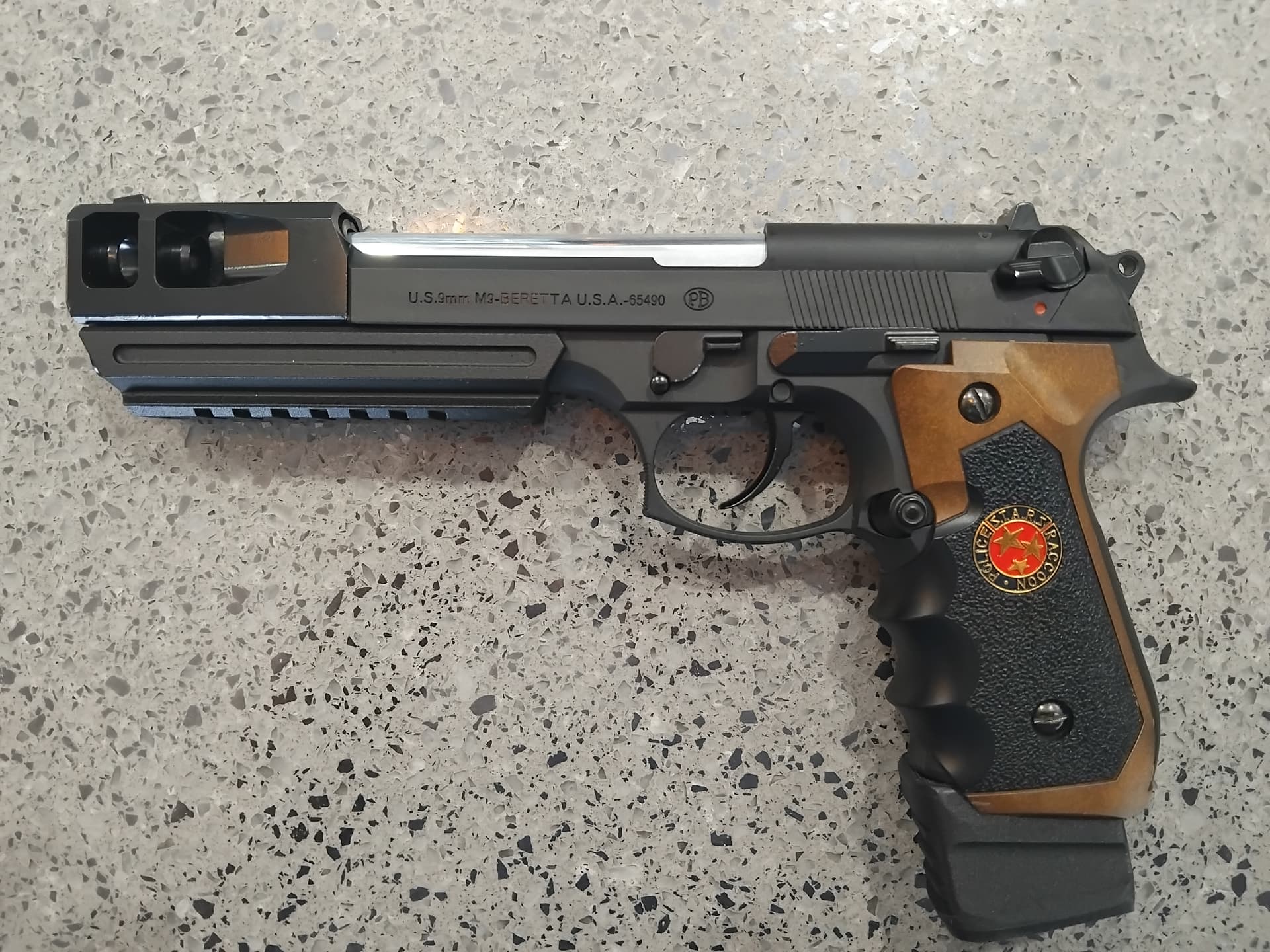

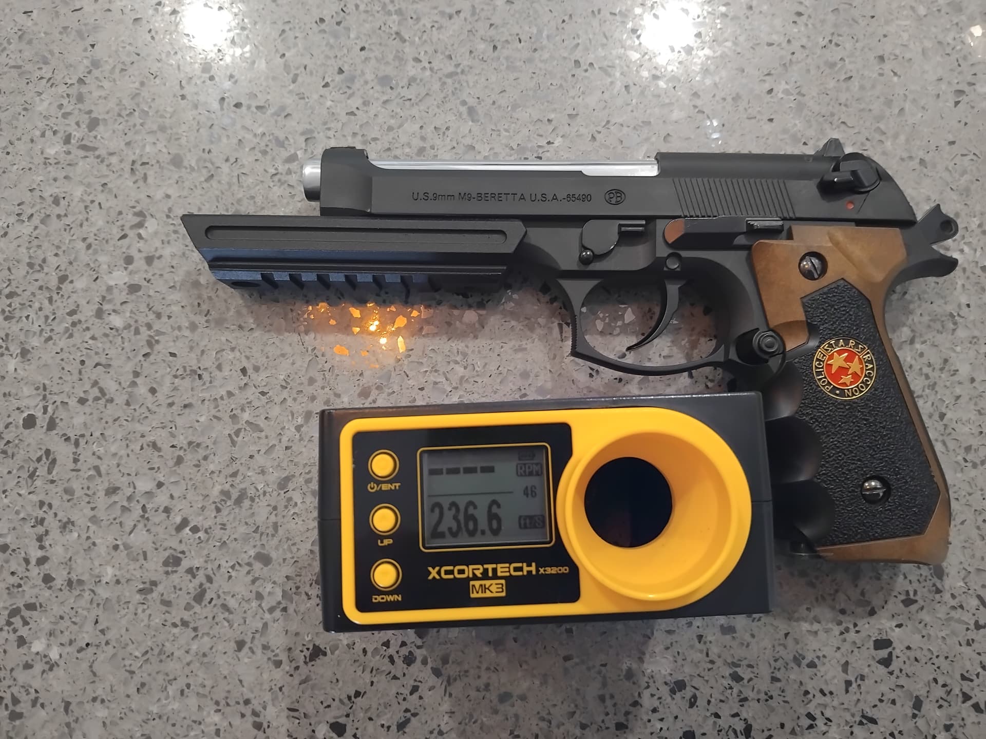

Using ihobby blues, it fires pretty well.
Using the upgraded spring, it sits in the 220-230 range…pretty good.!
It does have some feeding issues at times, due to internal congestion in the triangular top of the magazine…
“There can be only one” … gel at the top.
if it jams, sometimes a 2nd pull of the trigger clears it.
If not , pull the mag out, and assist the gel to the top, by a push on the spring.

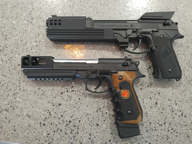

So… in review… EBB M92…
Come get some…!!
Not perfect, but good value for money, and good performance for a EBB.
Feeding might be sorted with better gels / controlled growth…
I’ll let someone else research that.
They are great little pistols, cant go wrong for the $$.
The kits allow dress up functionality, and increase appeal.

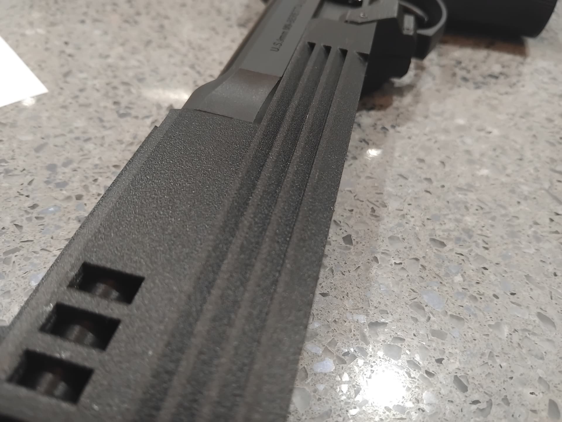

here are some good close up pics of the blasters.
You can use these images as promo pics, for the EBB’s listing when they arrive, if you like…

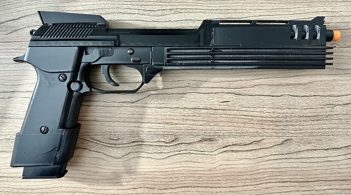

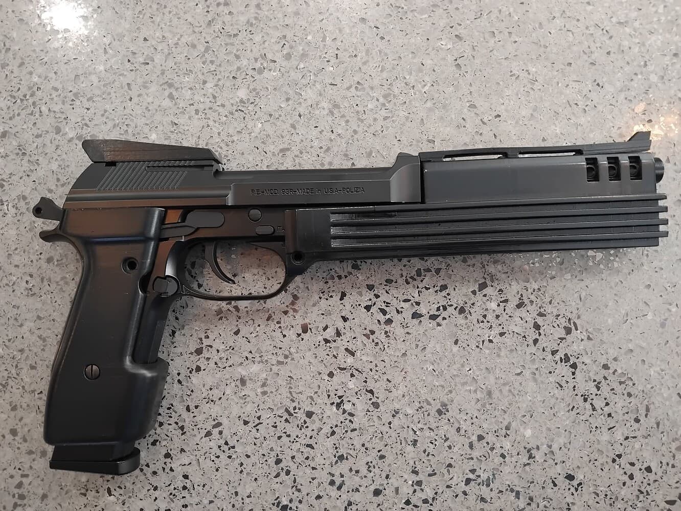

Thinking of sanding and painting the 3d printed Robo kit…
to get rid of the plasticy 3d print look…
Now what shade of black, and which combo of clear coat.?.?
Black is Back…!!
Coming soon, to a kit near you…!!
:rofl: :laughing: :rofl:
Robo does like it smooth…
That orange tip tho
:nauseated_face::nauseated_face::nauseated_face::nauseated_face::nauseated_face::nauseated_face::nauseated_face::nauseated_face::nauseated_face::nauseated_face::nauseated_face:
actually, the whole front looks like itssnapped off, and been araldited back on…
