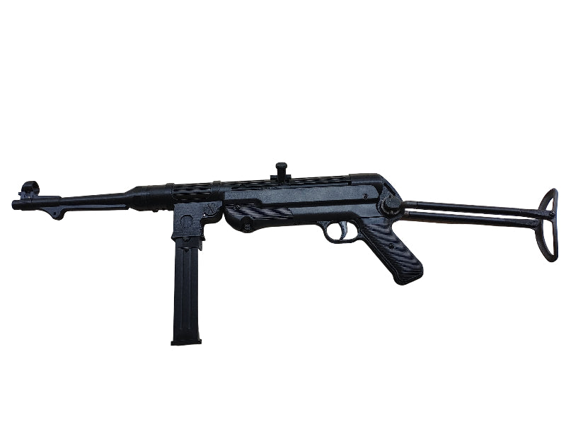

That piece above needs to sit 3.2mm farther out of the stock to fit. If the factory had drilled a neat hole it’d be easy to sweat it where it should be with a bit of silver solder… but noooooo…
It’s like a cock in a shirt sleeve of course. :roll_eyes:
It looks but my eyes are dog shit these days like the diameter is incorrect. You get me
You got to remember it is a toy and not made the same dimensions. I can give you the dimensions, think I already have but it is just not the same.
Lucky being mild steel it should be easy to work with instead of pot metal crap that turns in to my paddock when you look at it sideways.
I know a guy @BME get him to fix it :wink:
Done. Stock on… no wobble. Would be hard to remove as we discussed. But done.
Ended up using the original tee block, filed it to fit the slot in the receiver,cut off the short pin and drilled through the back, pressed in a longer pin to locate the block further out, paint and done.
Broke far too much of a sweat doing that, BME. :hot_face:

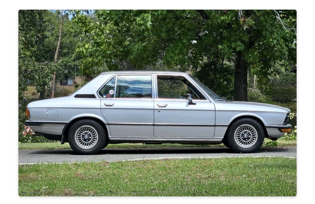

I drove one of these Beemers back in the last century… 528i
Smoked many a Commodore in that little beastie.
