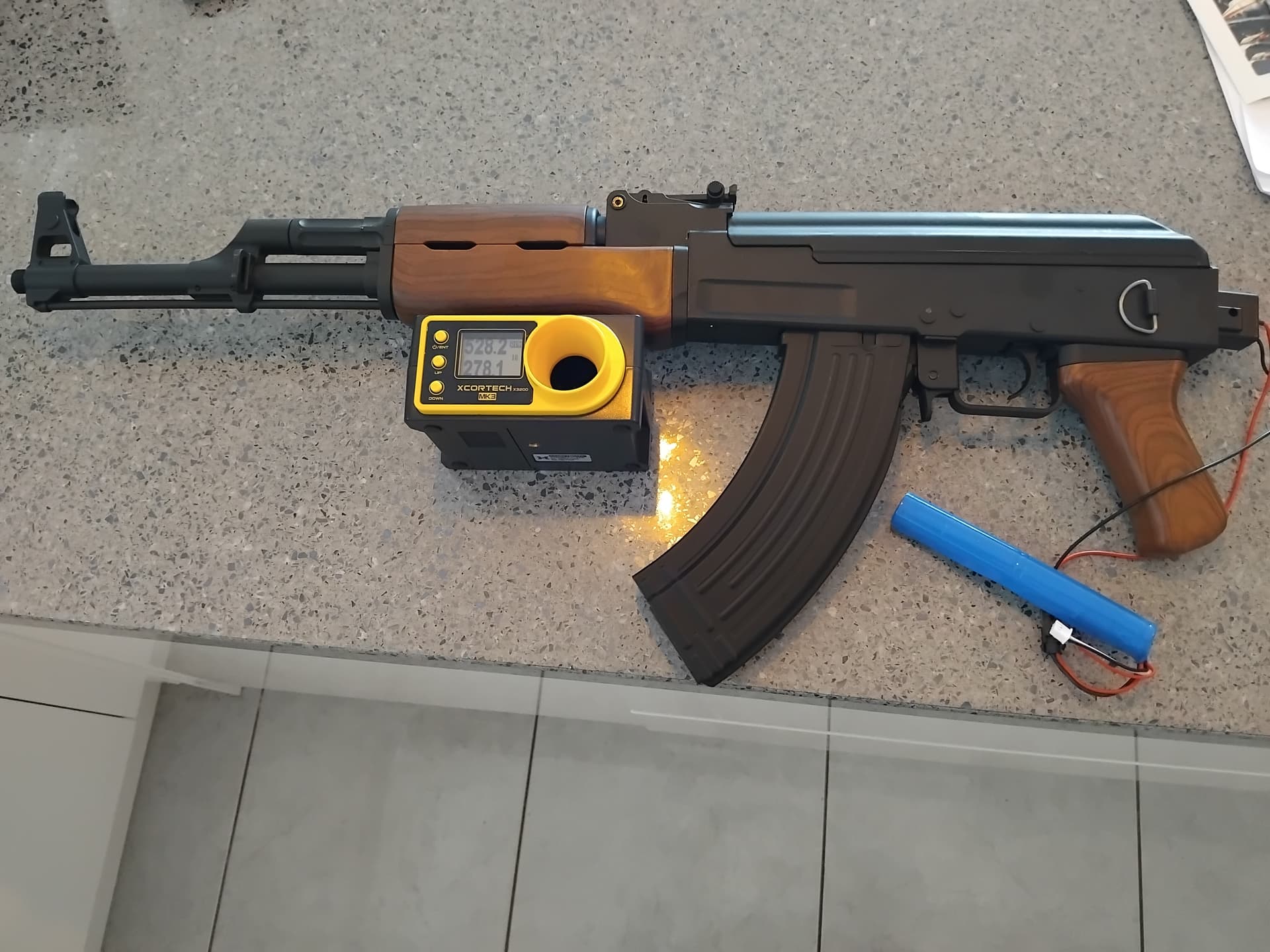

Ok, im a bit short on the Ak-47 front, and was curious, so i got the JM Ak47.
For $150, its a cheapy, and worth a quick look…
First impressions…
Its light.
Very light.
I know AK’s are supposed to be heavy, and robust, but this all nylon construction feels very light.
Good for lugging around, on a game day.
I think the forward shell would benefit from having some ‘no more gaps’ added to it, for some extra weight.
The rear stock is heavier, and has a decent battery slot, for the included long 7.4v battery.

The nylon does look a bit shiny and plasticy…a bit of scuffing and wear would help take the sheen off it, and make it look a bit more like metal.
Sights are adjustable for elevation.
The wood is …"OK’…the hanke thompson had better quality faux wood.
the trigger is plastic as well. As you’d expect, for a $150 blaster.
Gearbox and gears are nylon, and the barrel is plastic as well.

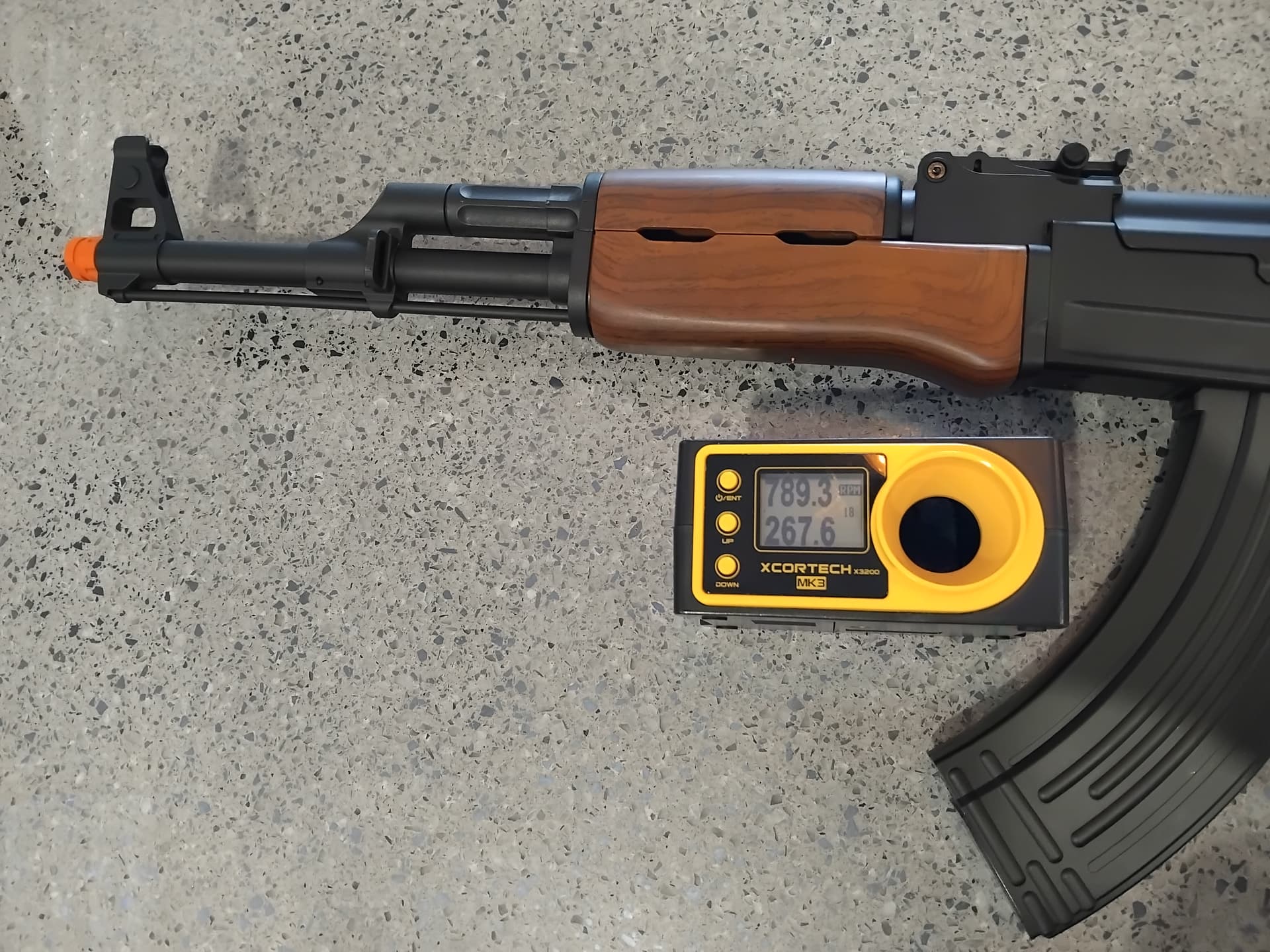

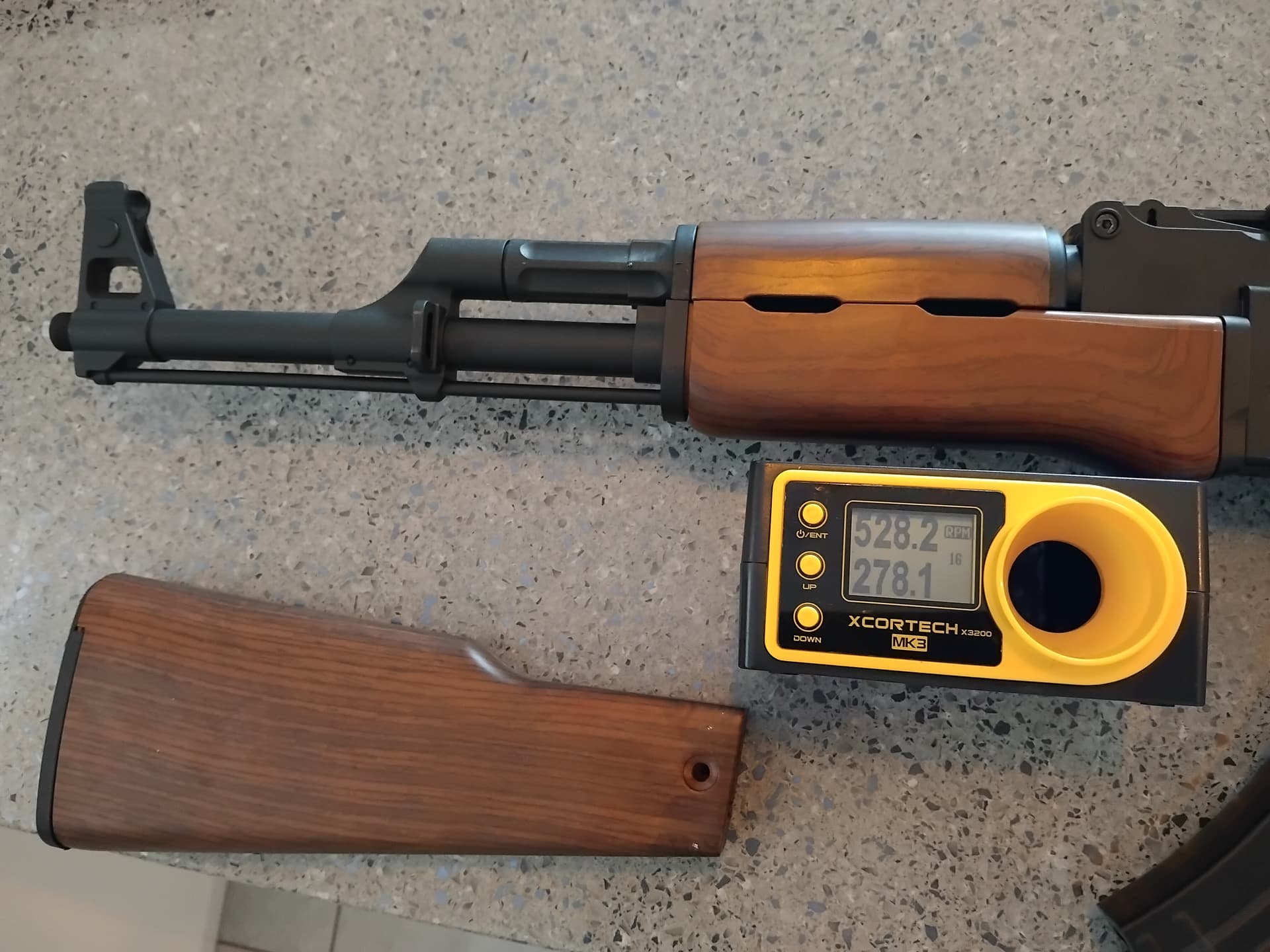

Stock performance, and accuracy, is surprisingly good…
Using xforce pinkies, it acheived the previous results.
Ihobby blue packet fared a little better.

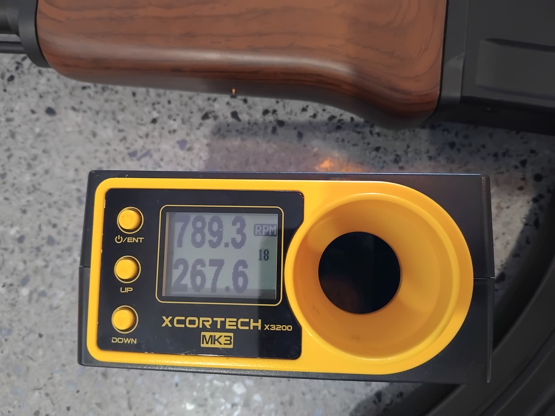

With the pinks, i saw a range between 255-290 fps.
Lateral spread was pretty good too… i’m almost tempted to leave it all alone.
Upgrading to a M95 would only result in minor gains…and the stock accuracy is certainly acceptable over 20m.

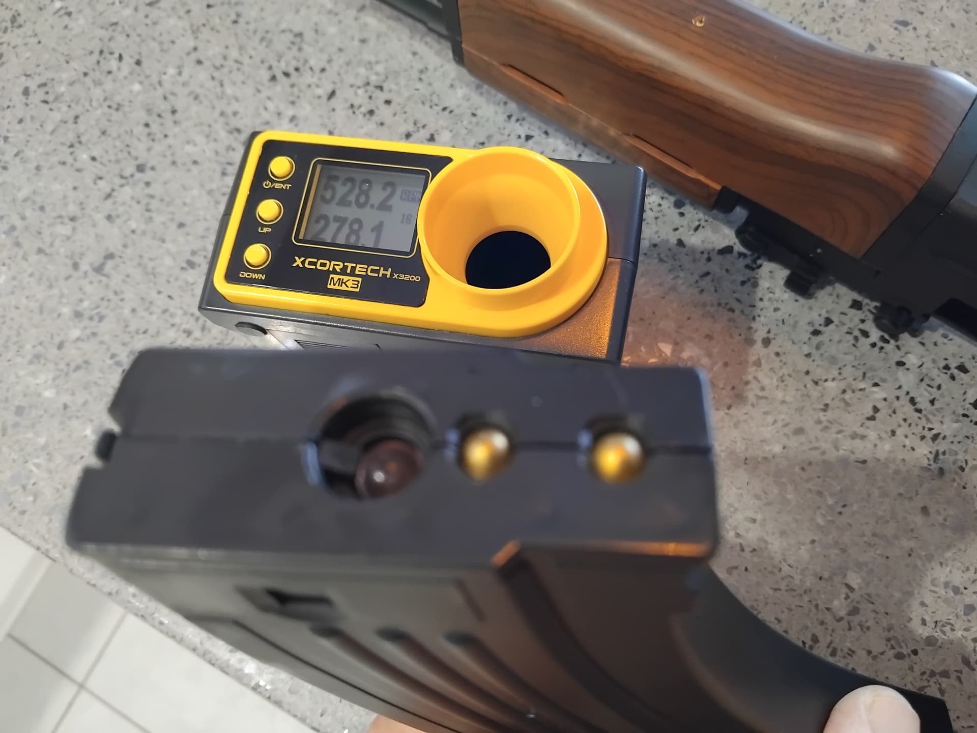

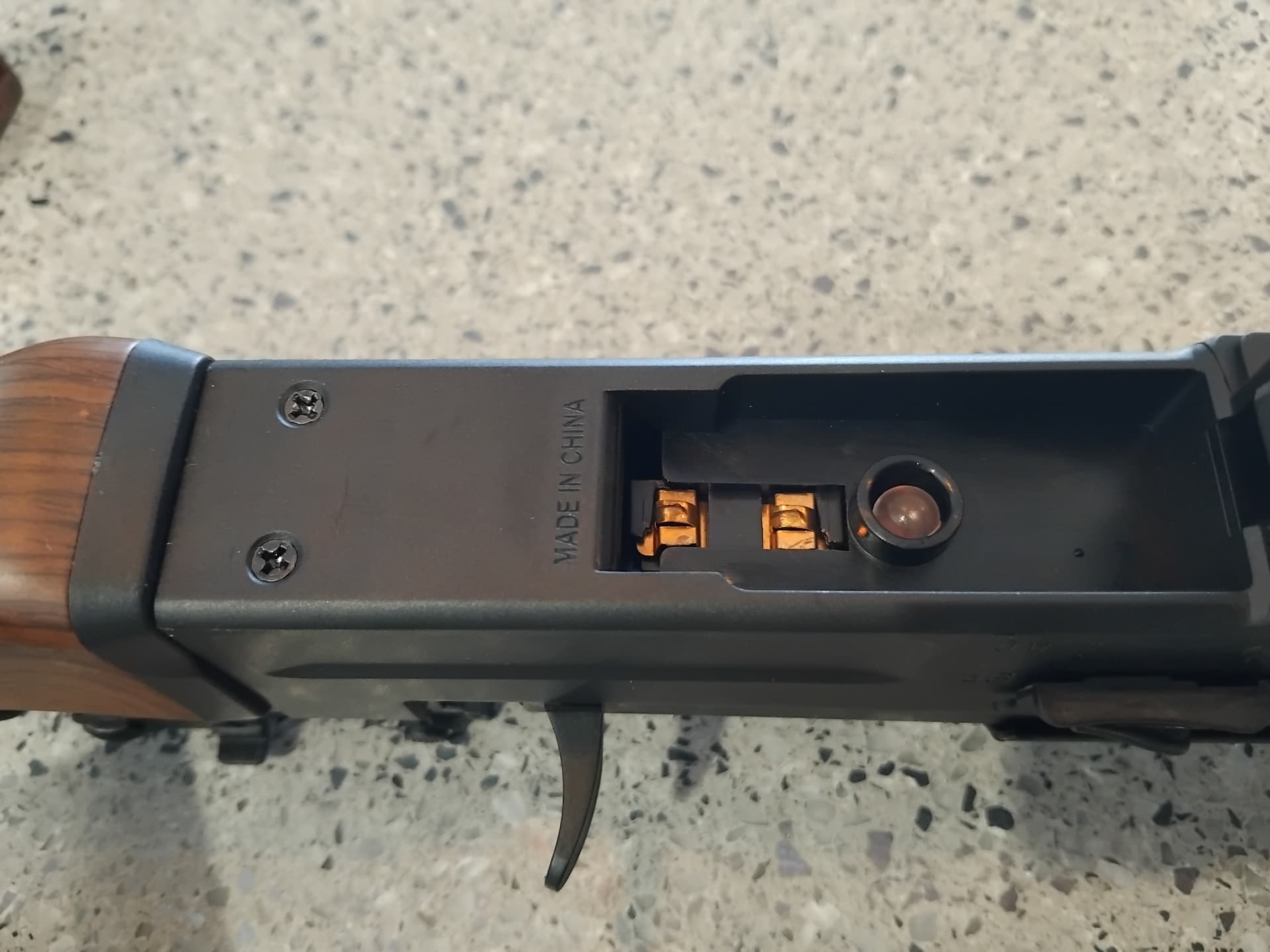

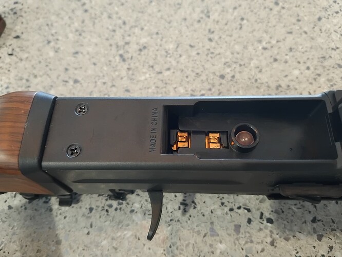

Magwell has recessed terminals.
Mag terminals are short.

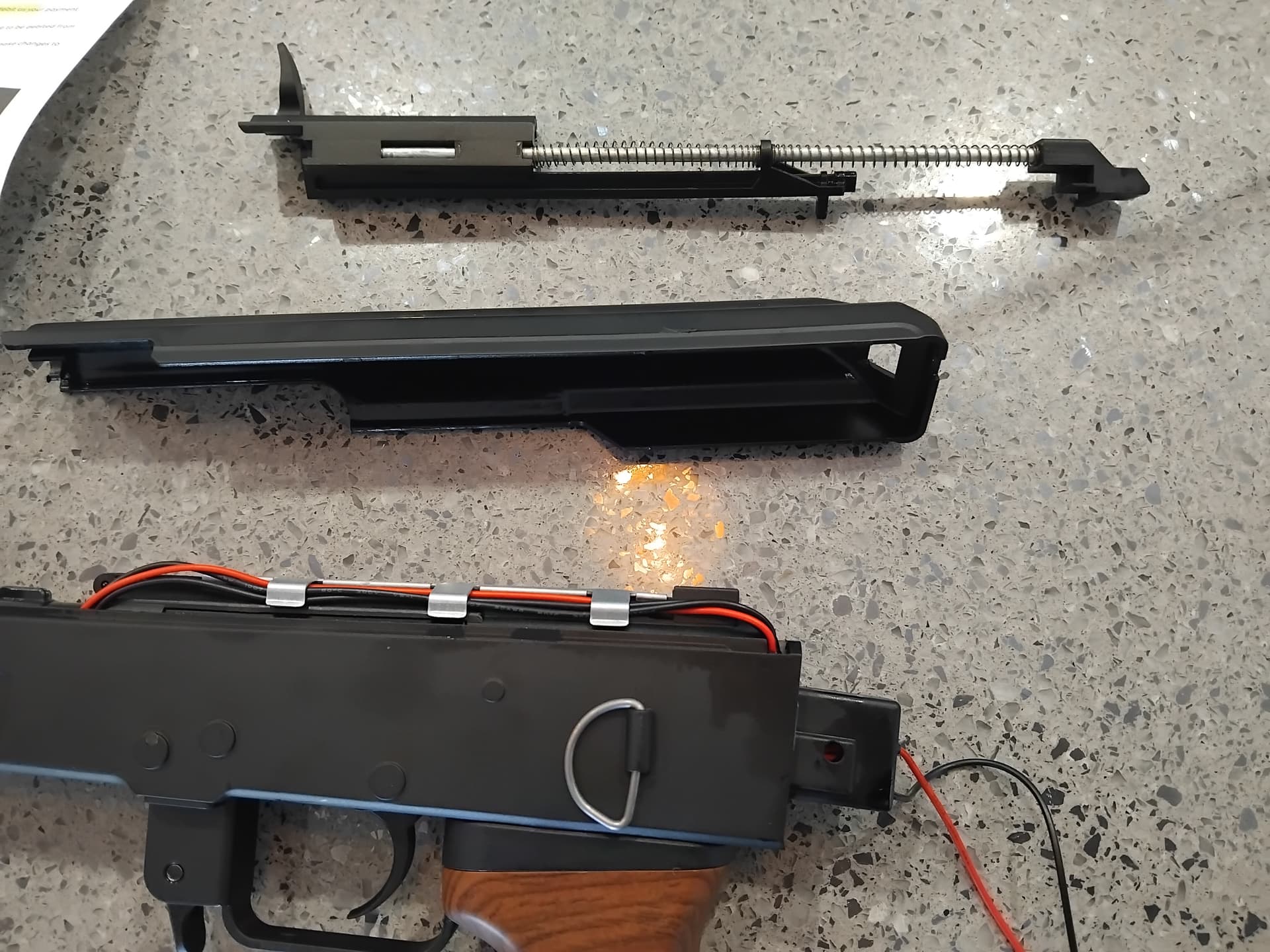

The rear cover comes off normally, and the rear assembly literally falls out.
Cut off the downward protruding tab, to remove the blowback.
Just leave a small amount of the tab, to locate it in the groove, and hold it in place.

It feeds better, on xforce pinkies, rather than the ihobby’s…at slightly less fps.
R/min has increased as well, with blowback disabled.

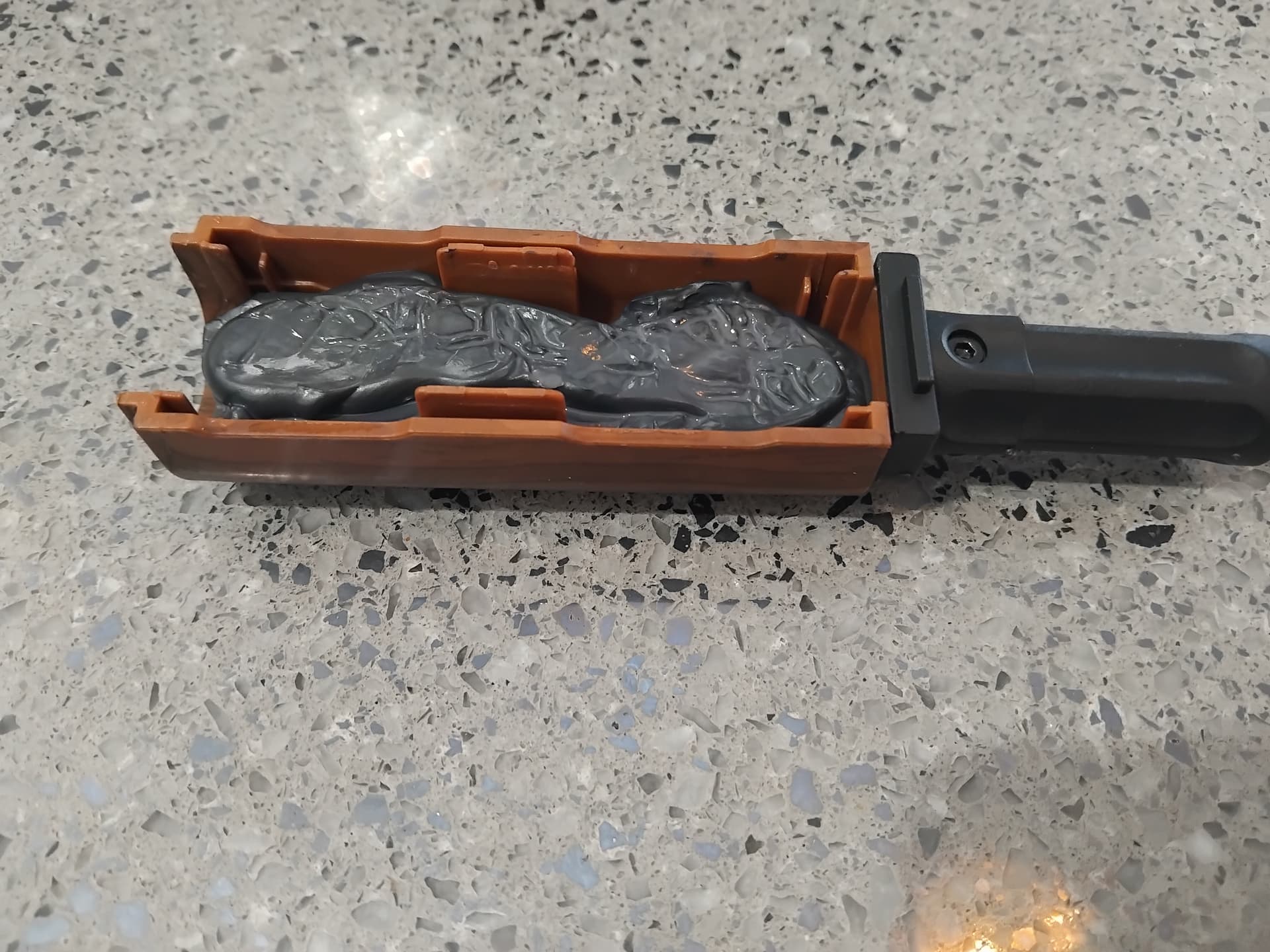

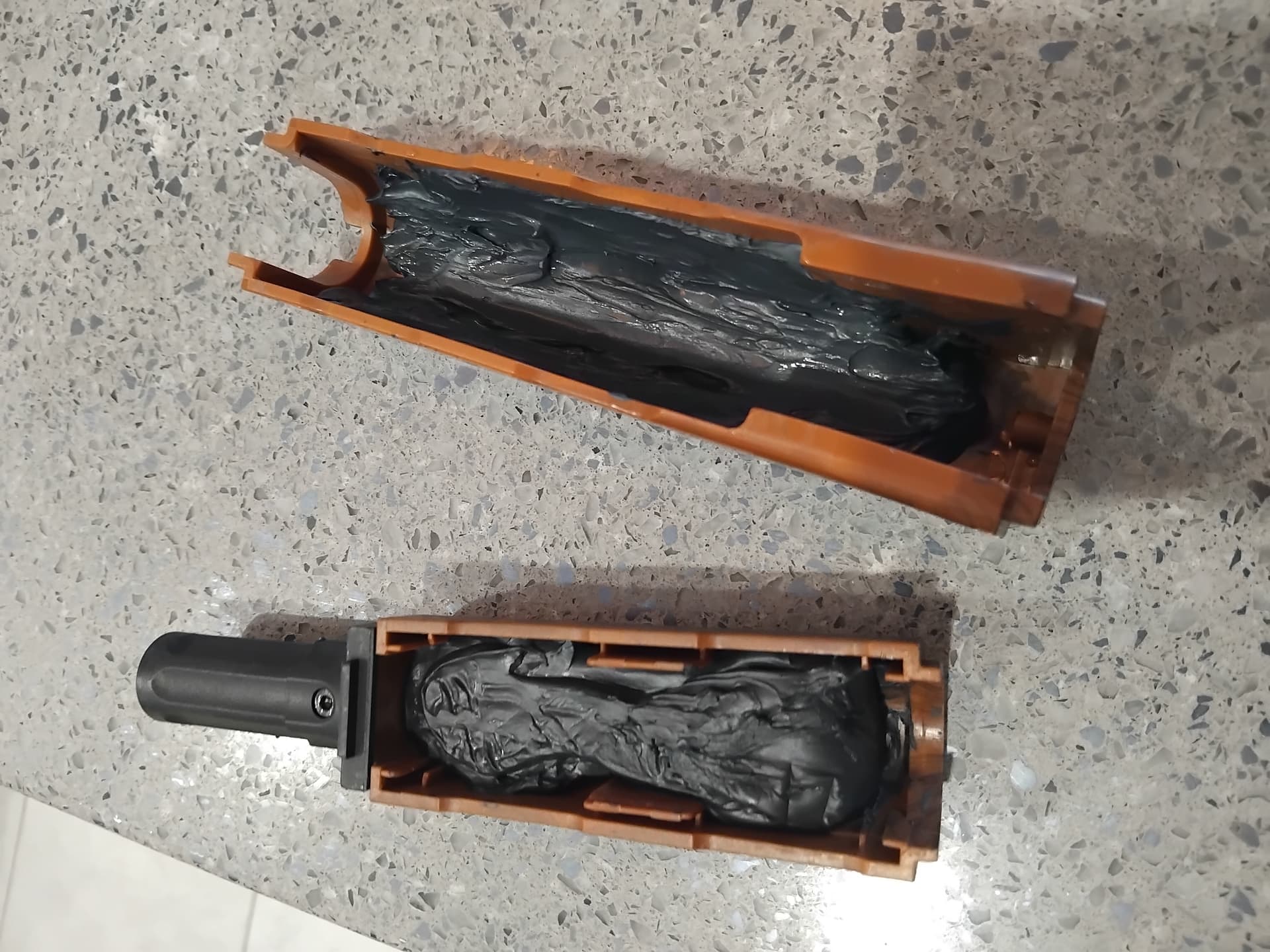

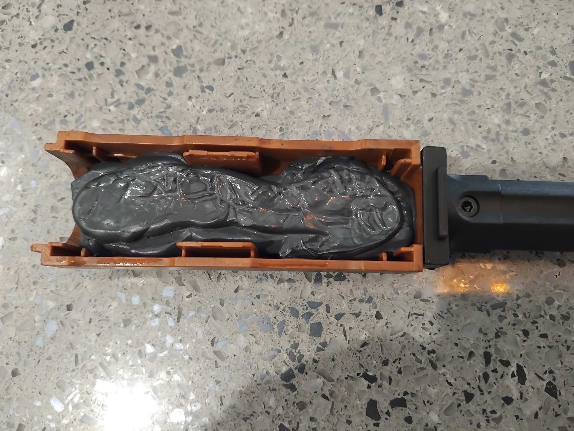

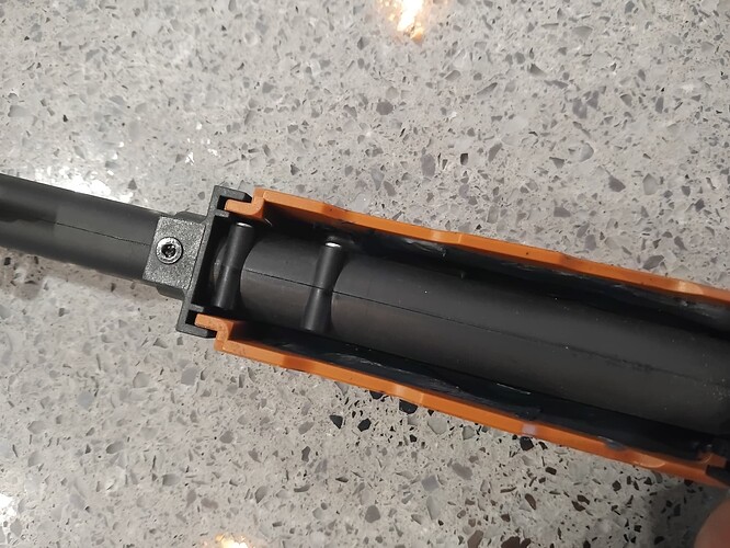

I did fill the upper part, of the front handguard, with no more gaps.
Kept it clear of the rear, so it wont interfere with it going on/off.
The weight it adds is noticeable, and feels better already.
That will take ages to dry, so its sitting upside down and no more firing tonight…

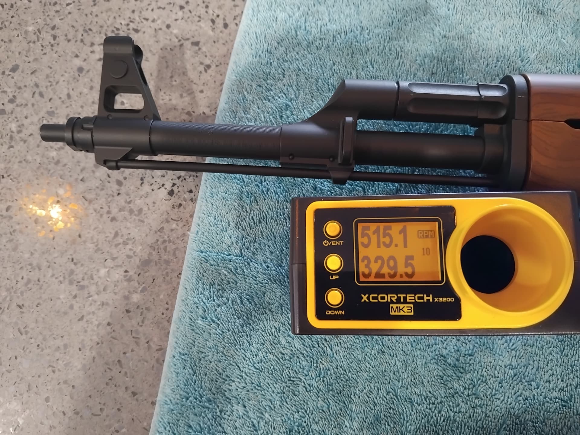

Just put in the new M95 spring, and did a metal barrel swap.
The metal barrel was cut a little longer than anticipated.

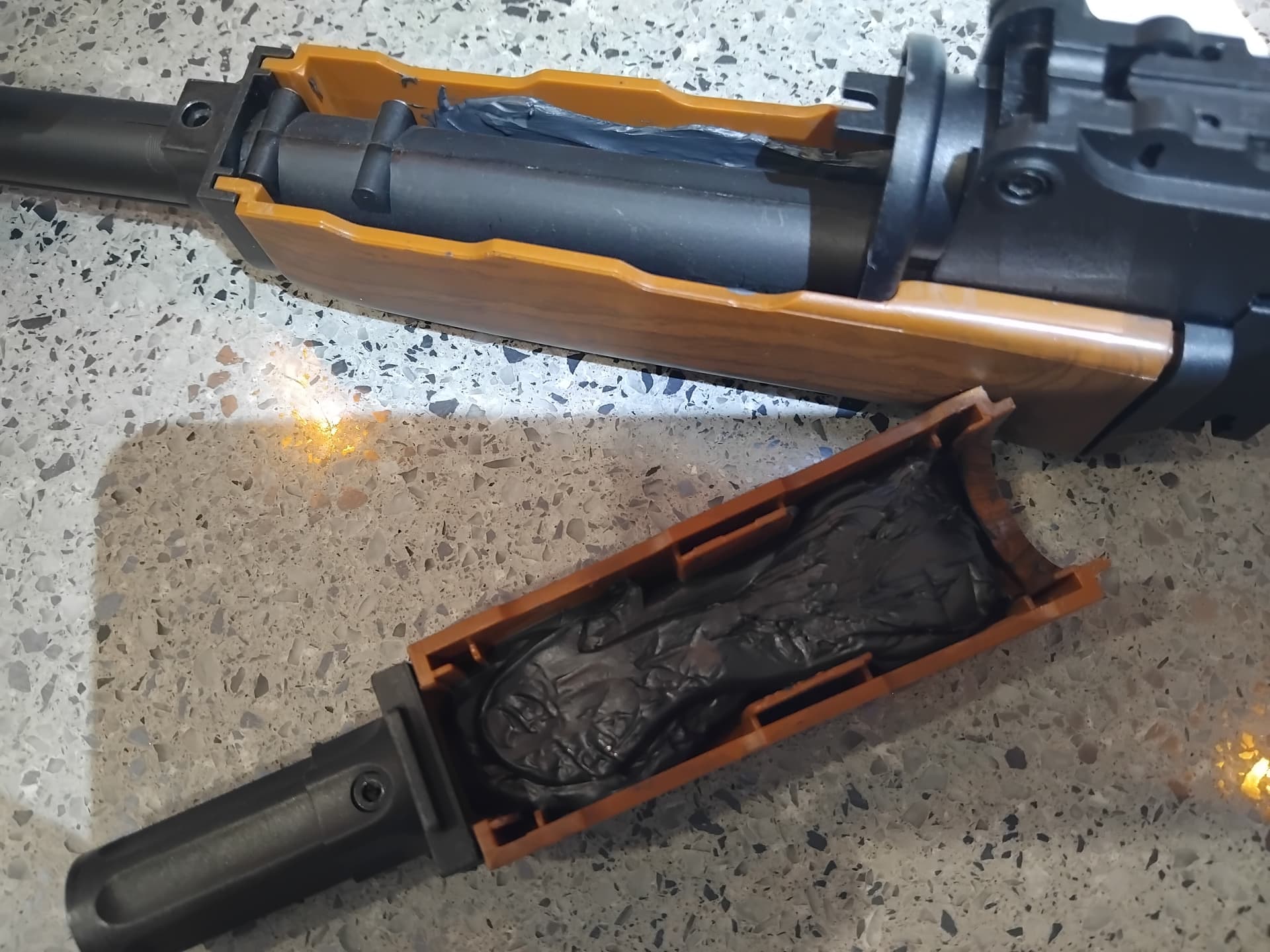

While it was apart, i removed the lower wooden foregrip, and added some no more gaps in there.
remove this allen key, and the assembly comes apart.
Add Selleys, to the bottom and sides…check for touch free fitting…
It feels So much better now…a bit of weight, and not hollow and plasticy.
Not real wood feels, but better…

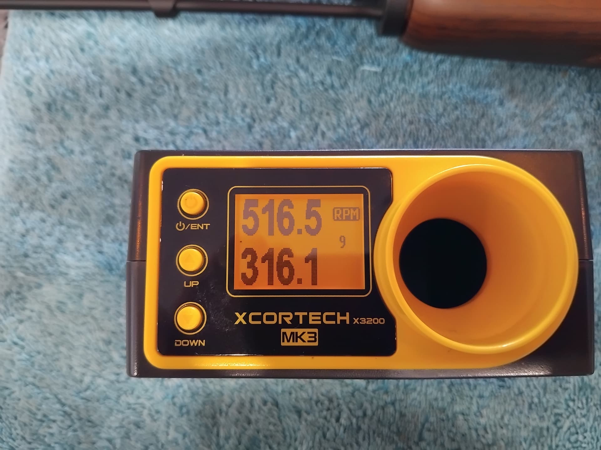

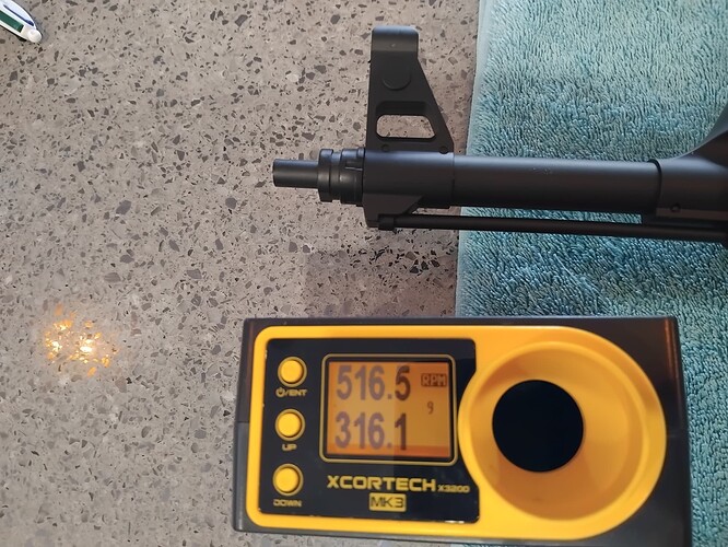

Anyway, performance wise.
Original o-ring…M95 spring, metal barrel…
Pretty good, from a M95…!!
The longer barrel helps.!
Solid 315 fps blaster.
Accuracy is still pretty good.
You get the occasional hook shot, with higher fps, but most are fairly straight.
Damp Xforce pinkies feed flawlessly so far.
All in all, a decent budget blaster for the price, made better with a few minor upgrades.

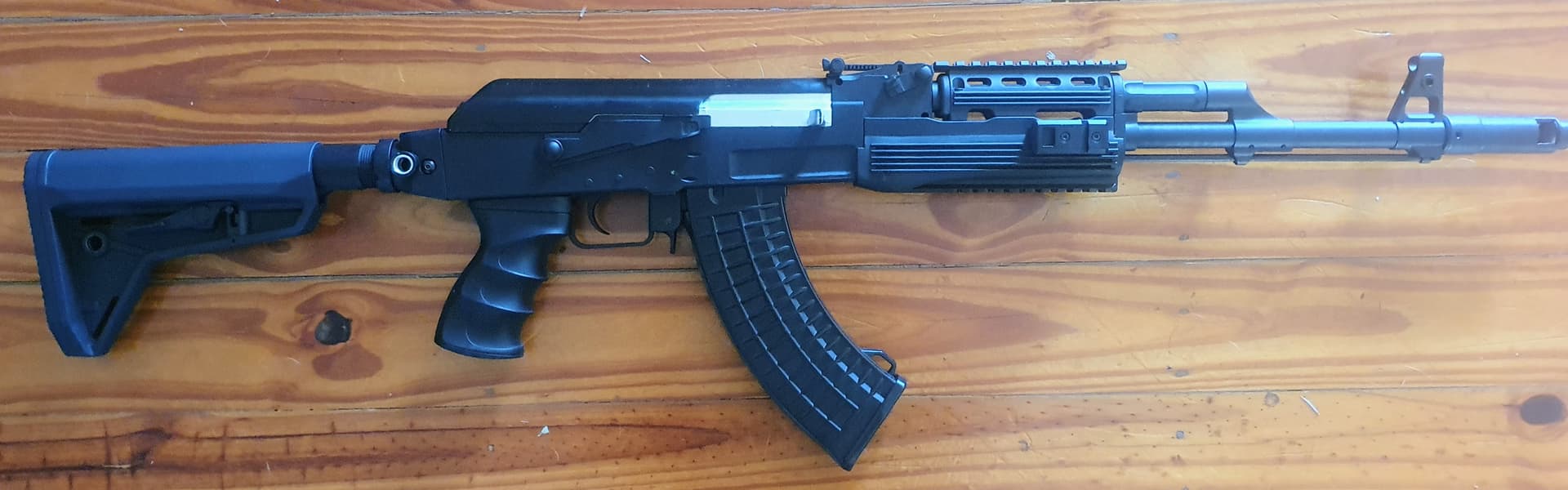

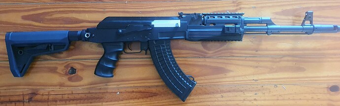

The J11 is 95% done and dusted… ready to hit Eastern Europe and take on a couple of attack drones.
One of the differences between the AK J11 with buffer tube and the solid stock variety seems to be the rear wiring.
The tactical J11s run wires out of the back into the rear cap the buffer tube screws into… to facilitate teardown they use a JST connector in that, then wires that run to the battery plug as a separate lead, so two connectors between battery and motor… never a good practice. :roll_eyes:
Dremelled out the routing slot in the rear cap big enough to clear an XT30 connector and hardwired straight to the battery plug… muy bueno, much betterer.
Also gutted out the appalling DK hopup to accommodate a decent 13mm Rizer, very accurate little (big) blaster now… and cheap.
Think I’ll spring for a J12 gearbox and transplant all the upgrade parts into it… would solve the terminal spring carnage which I can’t be arsed expending any brain power on right now… might even throw in a metal gearset. :man_shrugging:
The stock’s not standard JM fitment, BTW… one of mine, but better looking on an AK than the M4 stock, imho.
