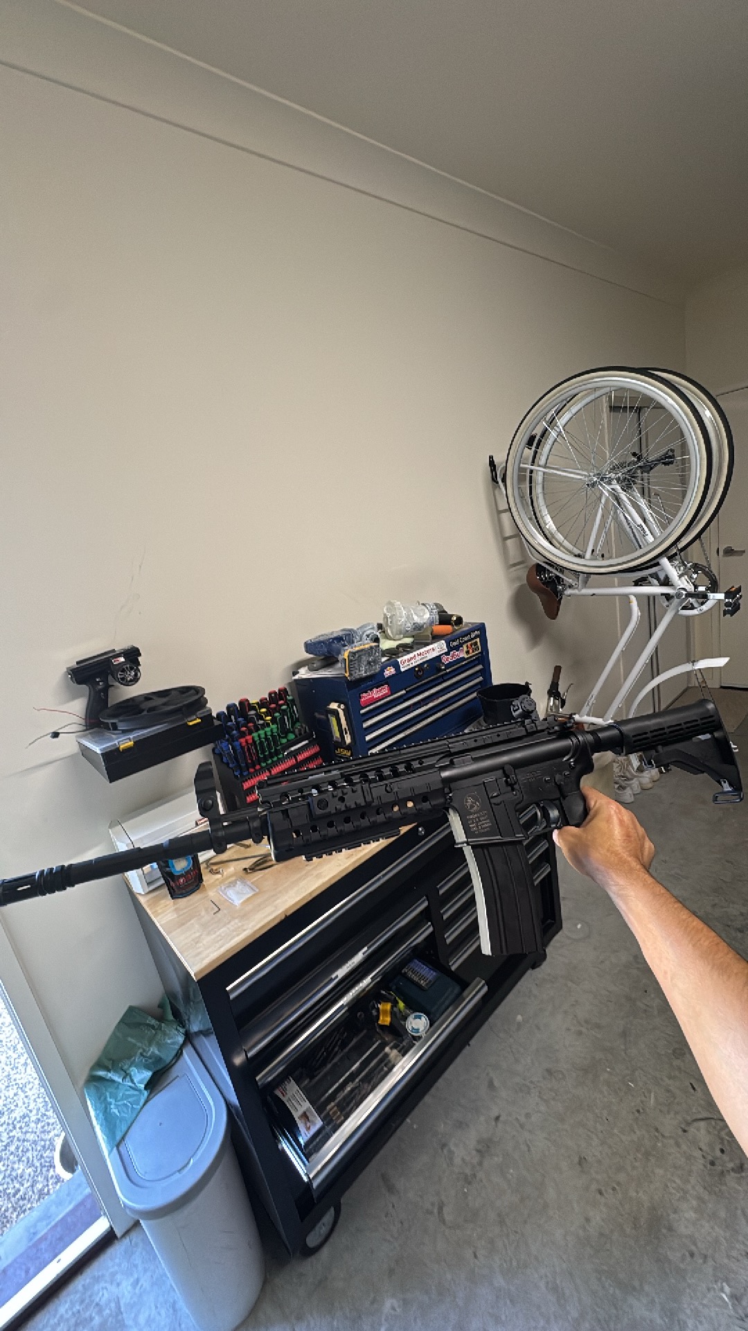

I after some help with a double bell m4ss (metal), Apparently there is no aftermarket nozzle with an oring for better sealing, I have tried the apache head/nozzle but its a confetti cannon.
Had anyone been able to find a nozzle that will fit this blaster?
I did… it’s a bit of a pain… and is two nozzles into one.
Ldt nozzle, with a jin Ming tip with a little trimmed off the back of the rubber tip to get the correct length.
You will also need something to fill the space between the nozzle and tip and there is a fair diameter difference. I used heatshrink.
You’d think there would be an aftermarket nozzle for these things by now, they are common, and their nozzles are commonly shit sealing.
Thanks mate ill look into it, I know its strange that it hasn’t been made yet, spoken to a few techs and they have all said there is nothing
Did it perform any better after?
It did, since the stock one was quite leaky having a seal did improve the fps consistency a lot.

I wasn’t given an option for nozzle size, however it’s roughly 1.5mm to long for my standard t-piece, I did think of buying the upgrade TP but as a beginner its a rabbit hole i dont want to go down incase I spend hundreds and It still smashed gels.
I did notice the apache nozzle is a-lot thinner then my standard TP, leaving roughly a 1.5mm gap around, my guess is the nozzle it hitting the gels awkwardly and breaking them.
I thought of possibly grinding the Apache nozzle down 2mm and attaching my stock rubber on the end
