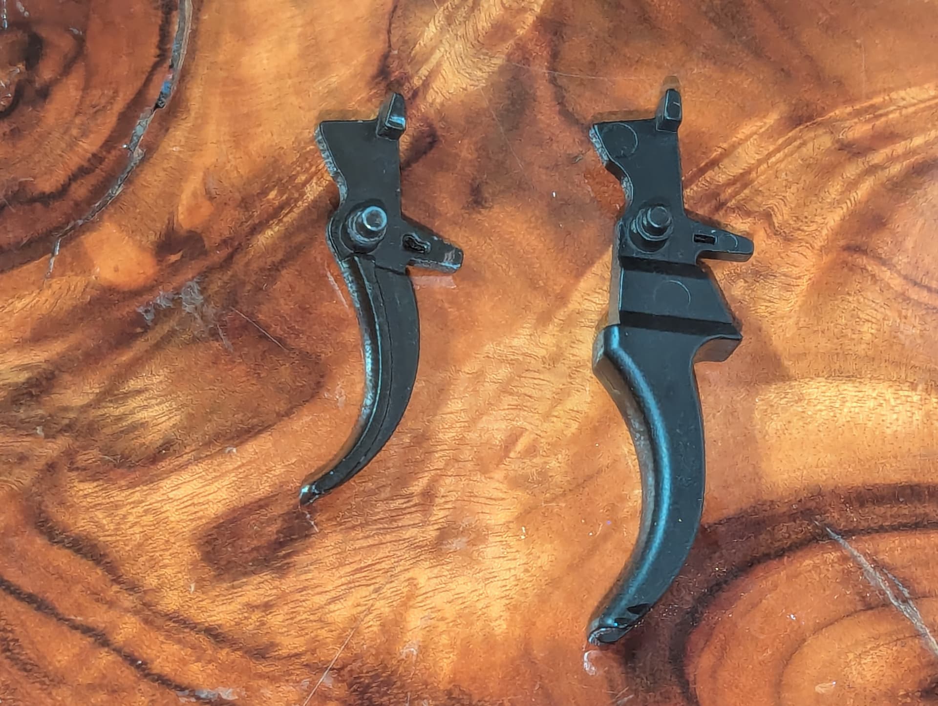

Mp5 trigger is different to a normal M4 trigger.
Yes I have a couple spare.
The only other difference is the selector plates are different.

I don’t have a terminal plate and selector plate spare… but I reckon I could obtain them, probably with terminal springs! I do have a metal trigger and spare metal charging handle.

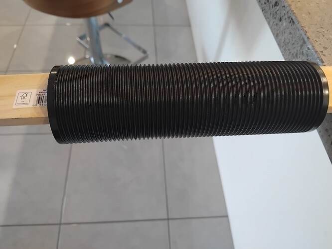

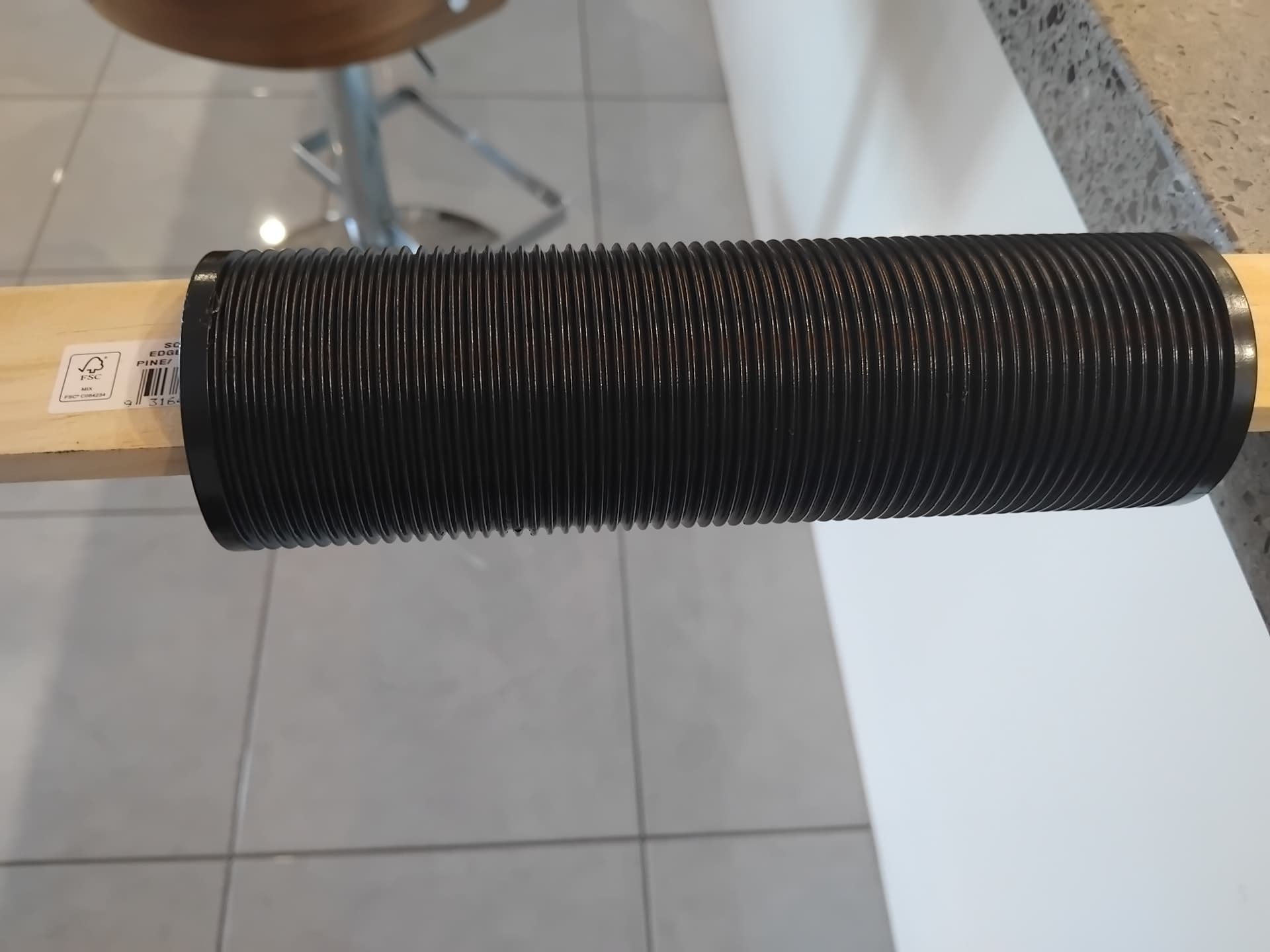

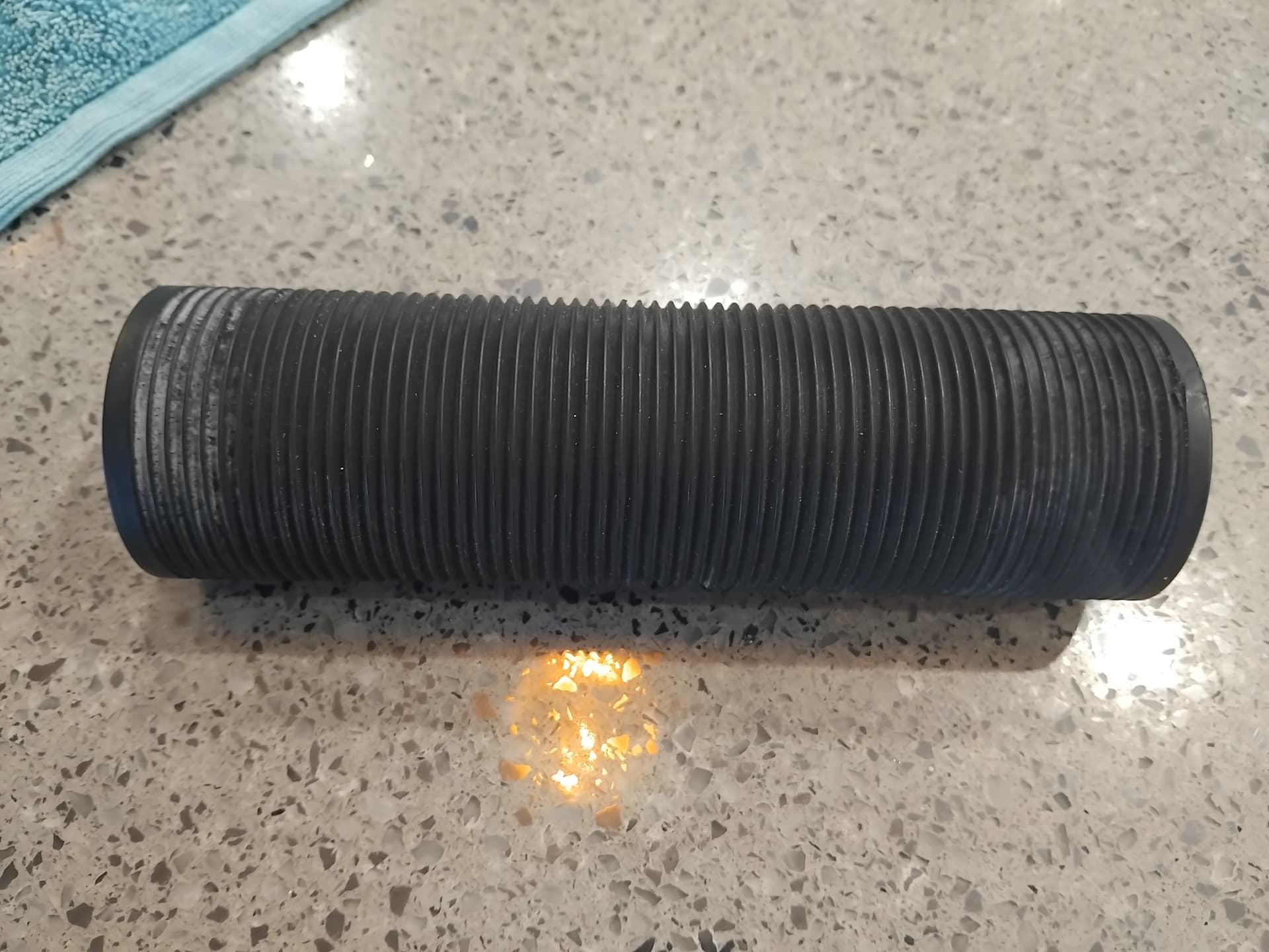

Cleaning up the can, on the parted SD.
It was showing its age… old, dirty, sticky ( giggigty) some outer layer of plastic slightly peeling off, with age.
After a wash, with just soapy water…
It discoloured quite quickly, with little provocation.

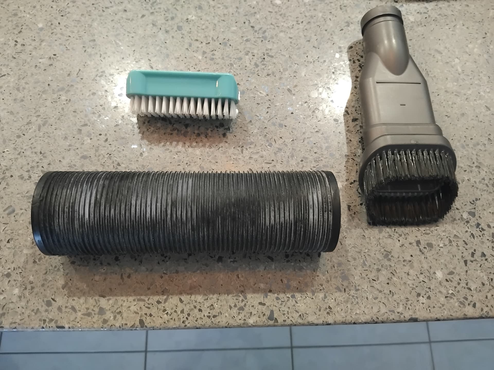

Time to go the whole hog…
Light spray with isopropyl alcohol, scrub with the short brush.
rinse and repeat.
Wash down with soapy water, then long rinse down under running water.
Let it dry.
Final dust down, to remove fine particles, with the soft vaccum attachment.
Finally 2 good coats of Dymark black.
Thanks to @Friendly_Fire for the reccommend on these, its awesome.
Let it dry, and some semi gloss lacquer.
Looks the goods…and the paint is sure to stick well, to sticky plastic…!!
Never have to worry about “tacky touch” again…!!
That is an amazing difference! Lookin’ good!
That rubbery plastic…its scary how quickly it discolours…when exposed to any chemical.
Thankfully, painting restores it,
Dymark goes on well…it doesn’t spit and splatter blobs, like rustoleum does at times.
The semi gloss lacquer dulls the sheen…makes it look Not ‘brand new, just out of the factory…’
