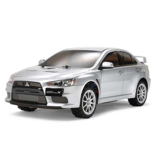

I was an old 70’s/80’s Celica fan myself.
Classic cars the same as the Mitsi. :sunglasses:
This one.
Tbh I never understood why the car body is just a polycarbonate shell. Kinda felt like it should be built like a real car haha
That makes it easier to paint or replace and are very light weight and flexible…to a certain point!
My era cars,…

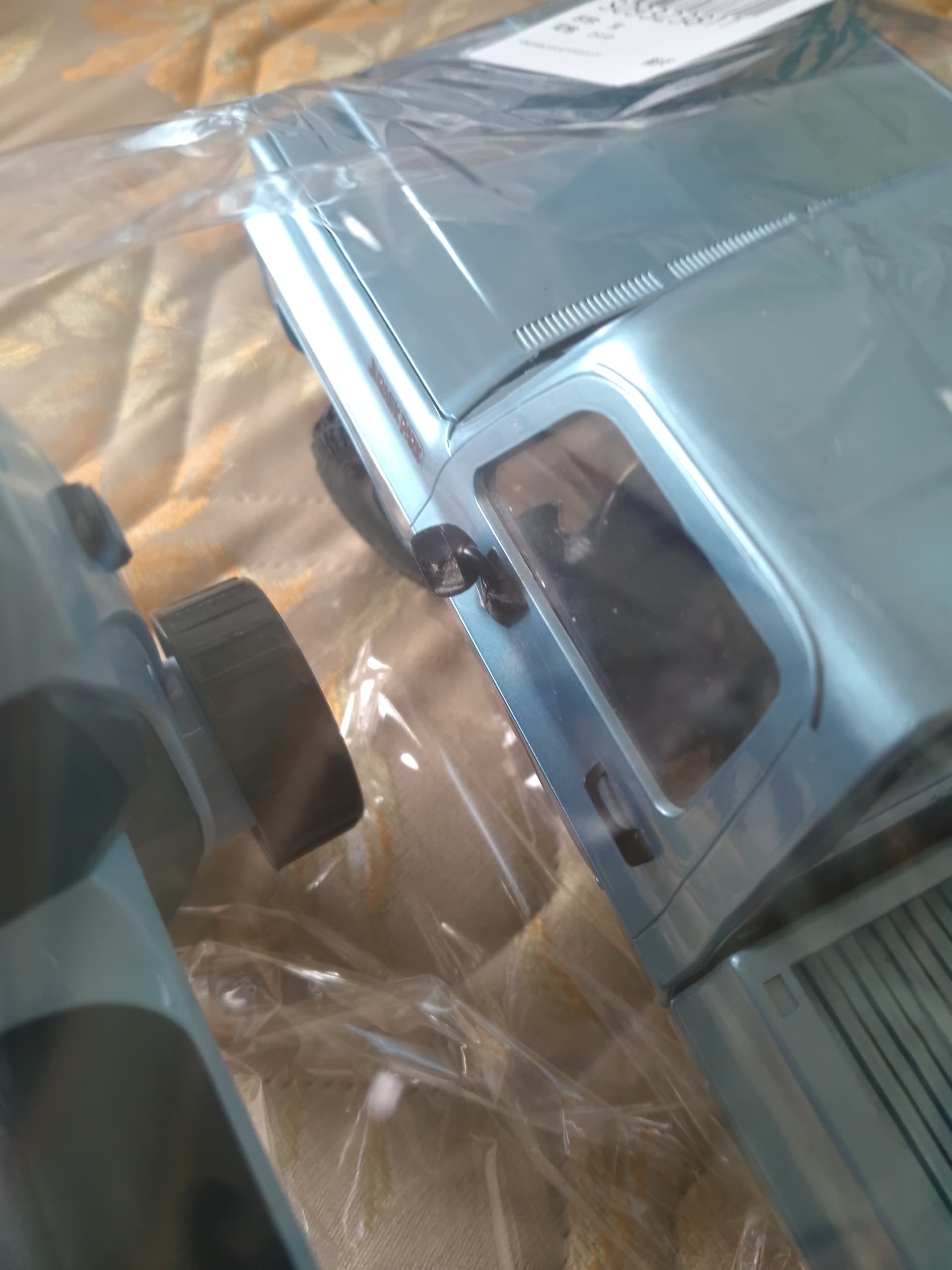

Got the FMS GLACIER, but STILL not what I was expecting.
This is the second attempt to get one of these models now.

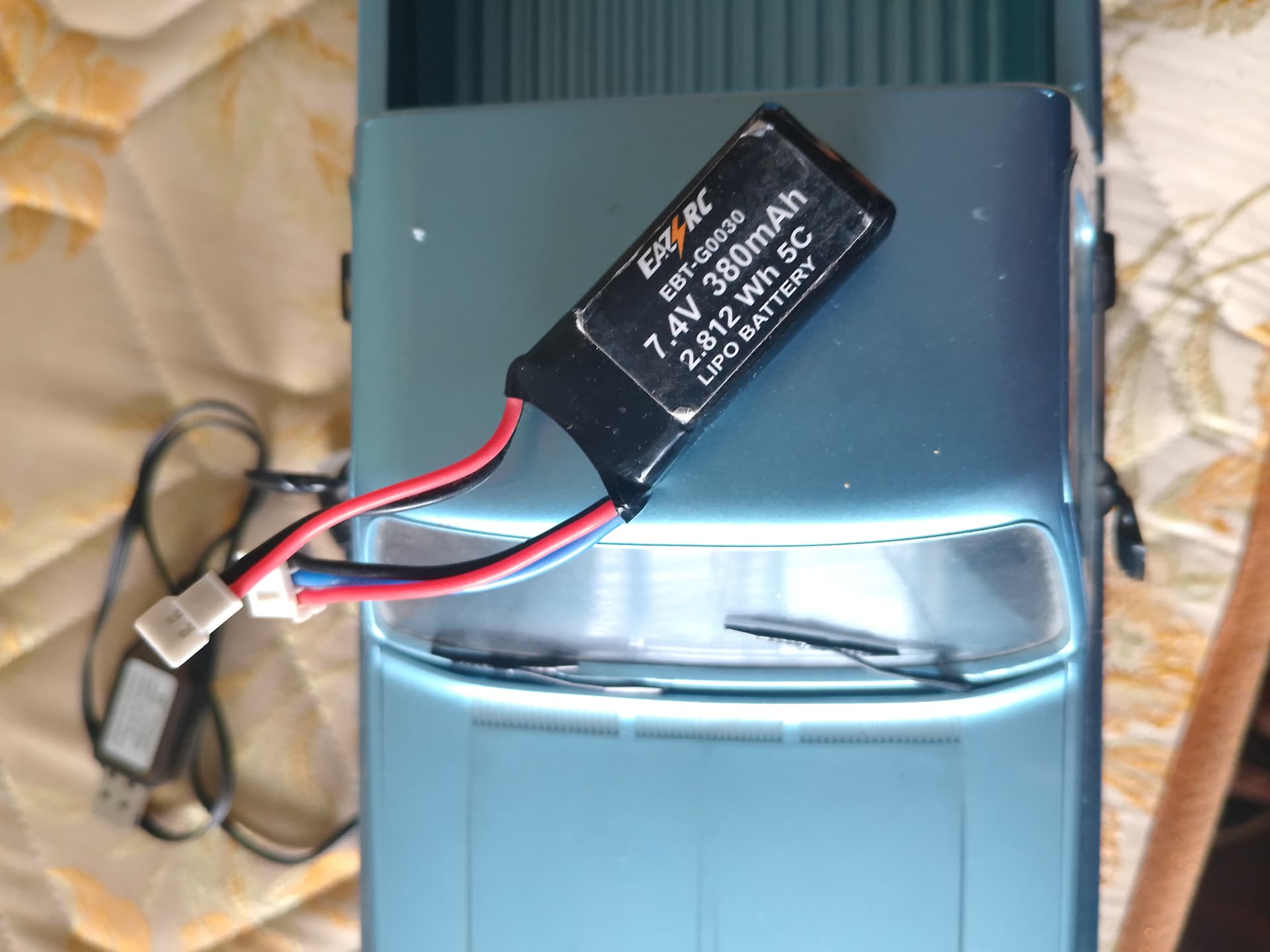

I paid NEW price, but received a second hand product. :face_exhaling:
Still has sand/mud underneath it, parts/missing or broken and writing on the TX and sidewalls of the tyres, along with the crappy stickers and worn out old battery.
First hint something wasn’t right was when it turned up in a smaller bubble wrapped package, not in a large box.
Took pics before I unwrapped for evidence of condition as packed/received.
Have contacted the seller and they answered immediately and are working on a refund or replacement, as is obviously a third party seller of the company who has sent this.
I got no issues buying second hand products, at the appropriate price point and exactly as shown in the advertising pics… but this was the NEW price point and obviously everything was advertised as NEW in the first place.
Probably just get my refund and keep this thing to pull apart and do my Monster Truck conversion anyway. :thinking:
