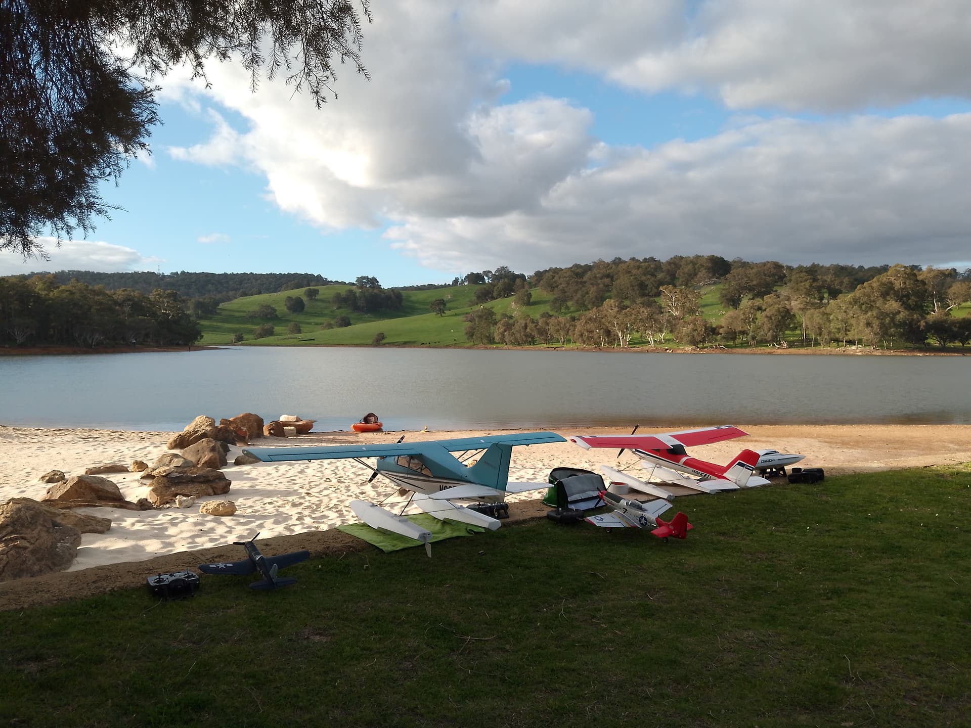

You certainly love your float planes, Doc! ![]()
Can see why though⌠tons of fun. Iâd need a flotilla of tug boats to retrieve all the parts that flew off when I augered into the lake. ![]()
Oh man I had to look didnât I. That Husky looks awesome and $340 delivered, must resist ![]()
I think it was the red dirt in the picture that caught your eye more than the Plane itself, as it looks like home! ![]()

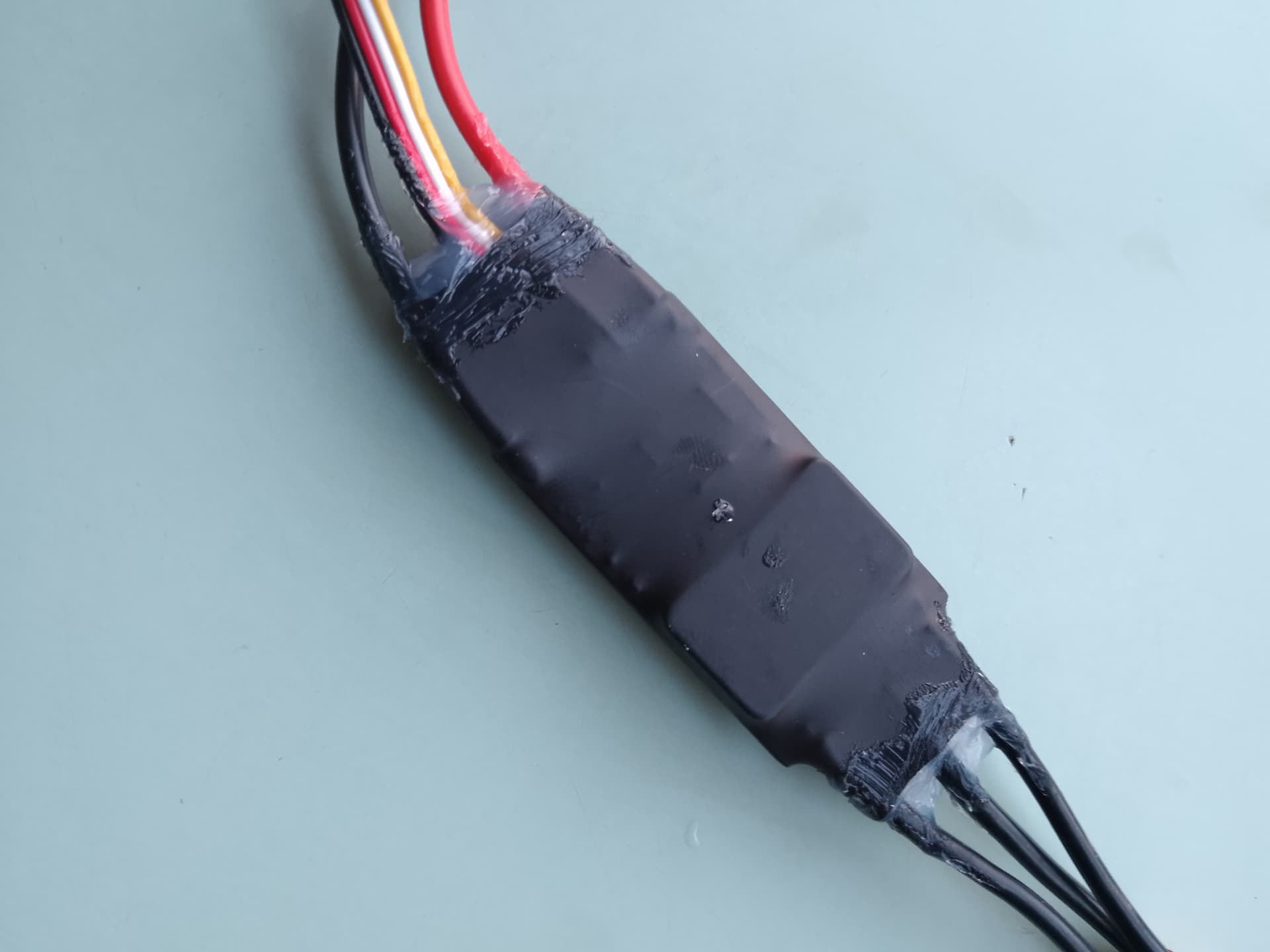

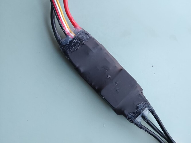

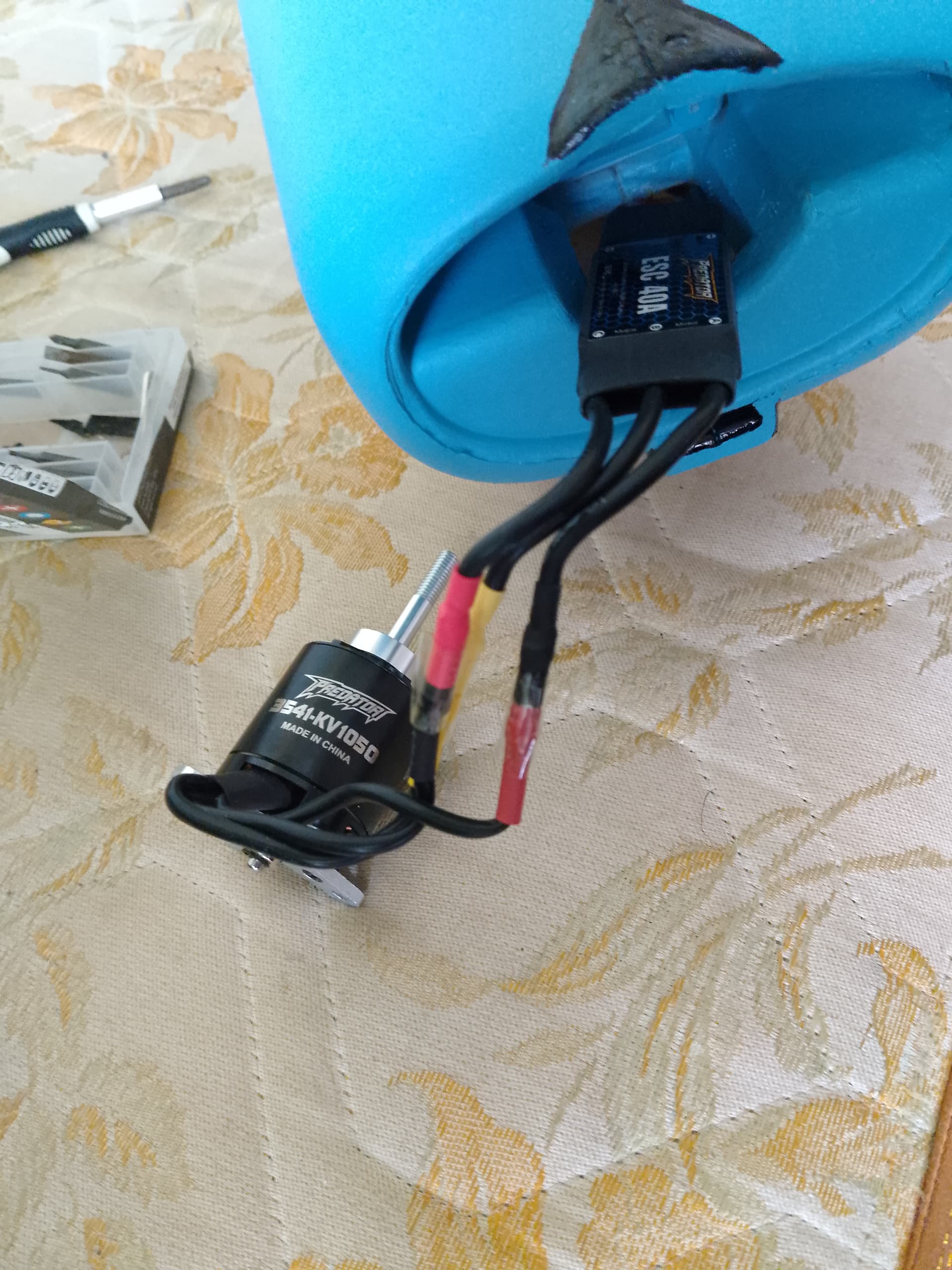

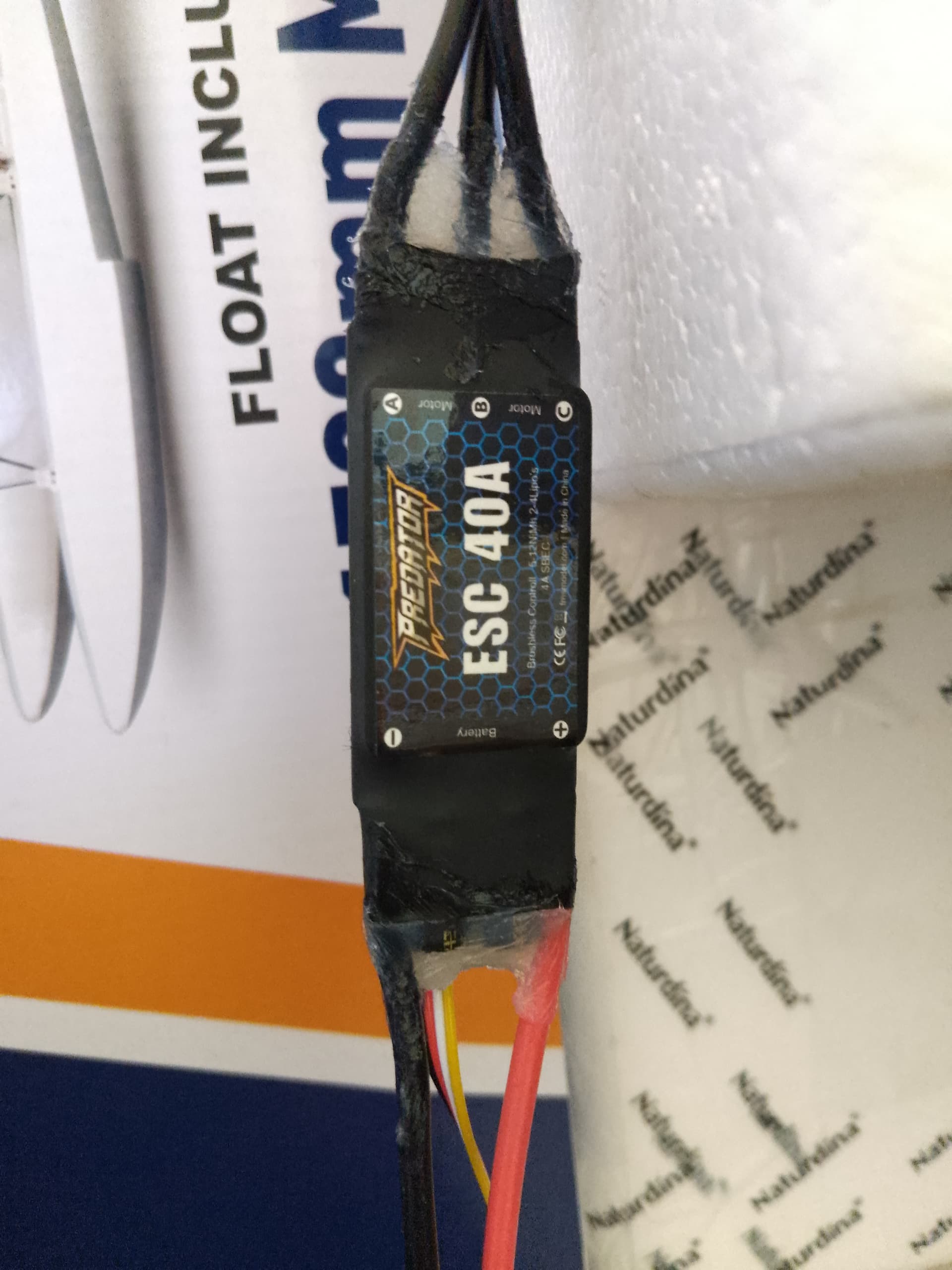

Still waiting on my other waterproof Receivers to arrive, so in the meantimeâŚ
stole a bit of my housemates Fish Tank Silastic! ![]()
Was a bitch to get it all out and gonna be even more fun getting all the wiring back in.

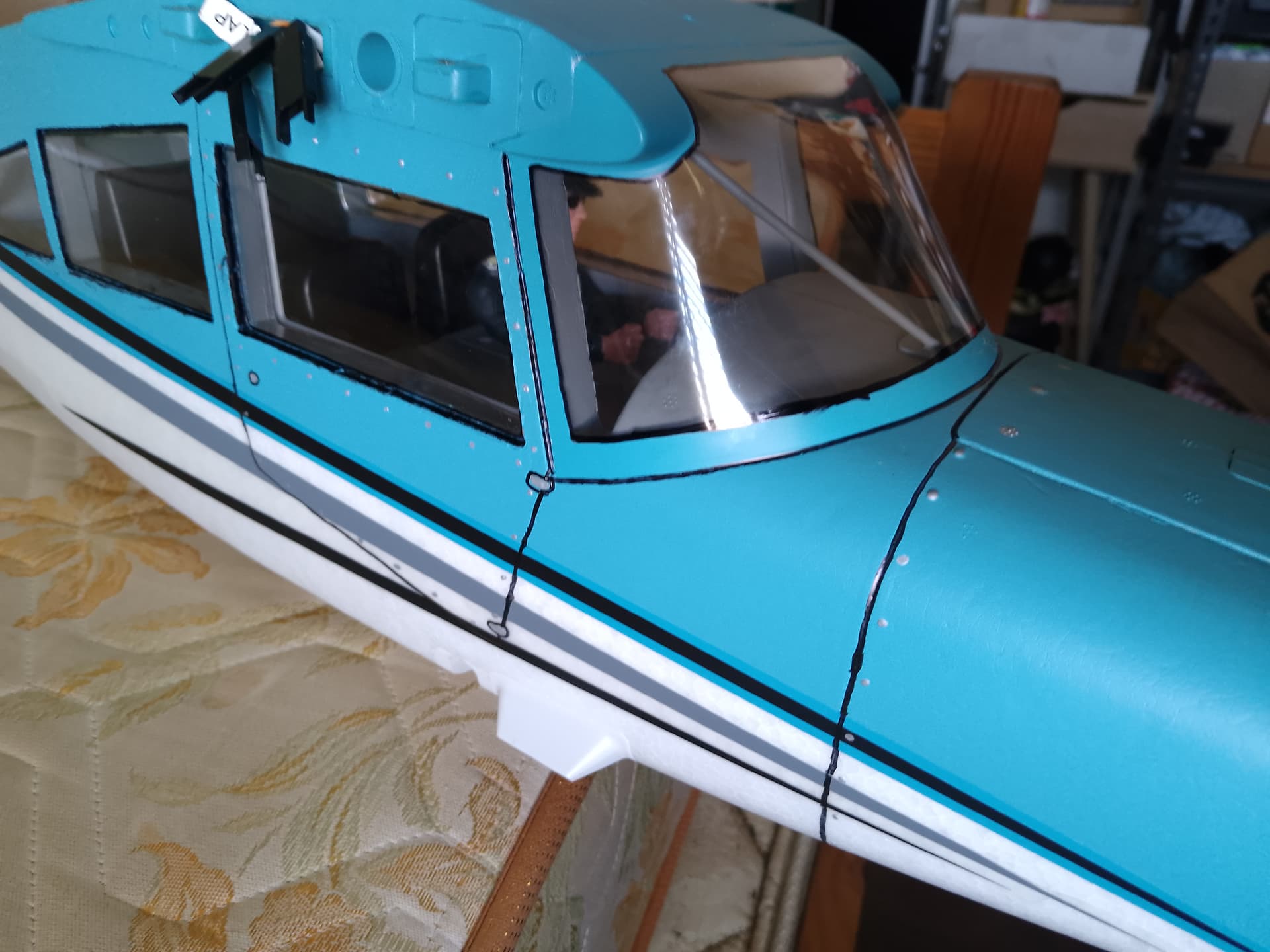

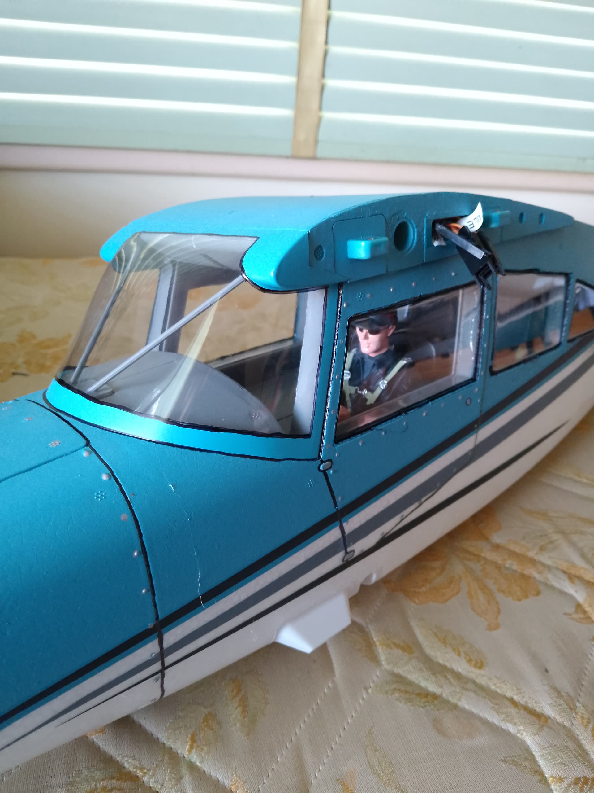

Forgot to mention that I got bored last night and got out the Paintbrush and model paints to add some details to the windows, doors and fuselage panel lines/rivets to break up all that Baby Blue paintwork!
I found it to be a bit bland out of the box.
Nice day out, and the âwaterproofâ ESC worked a treat!

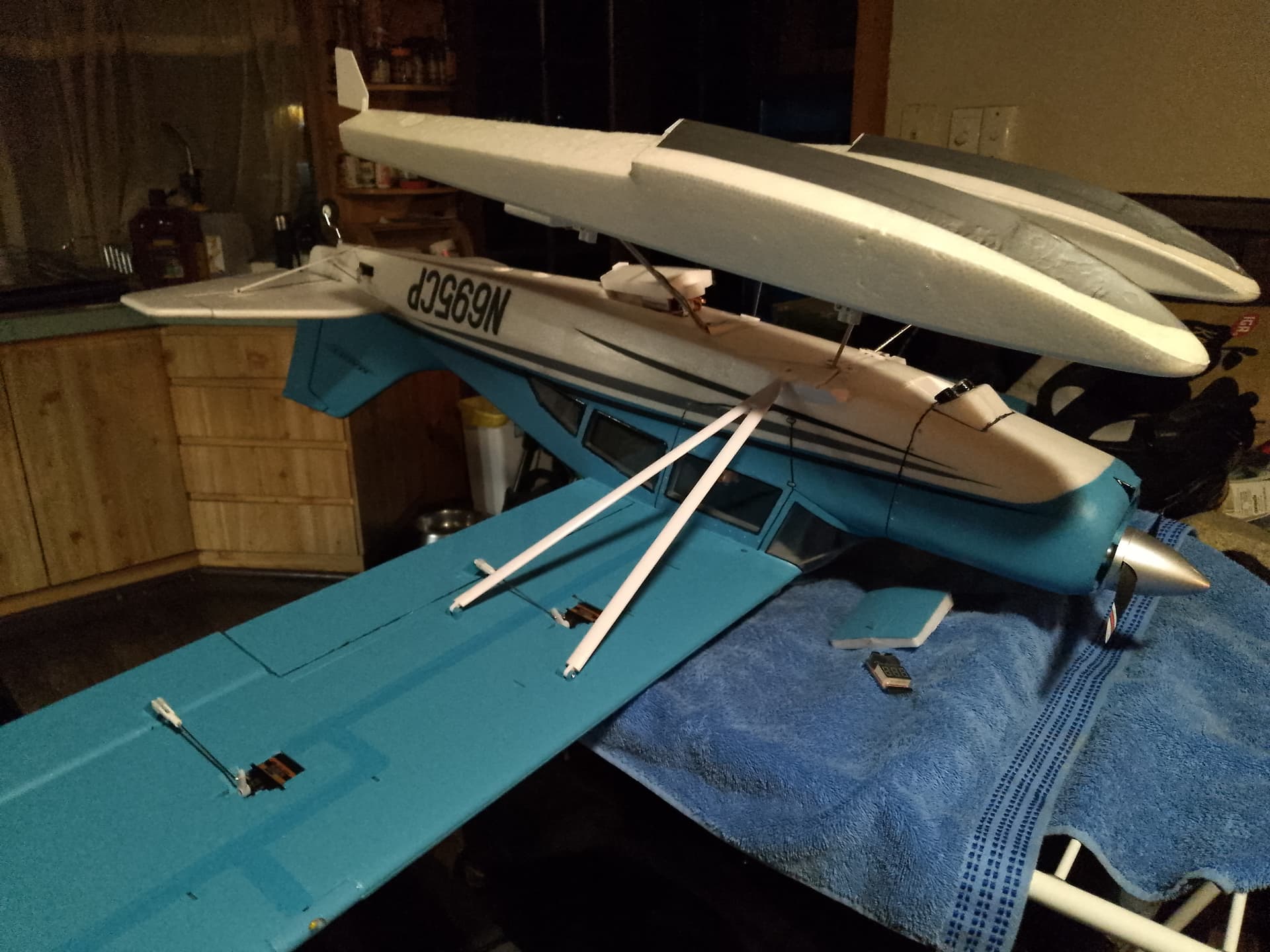

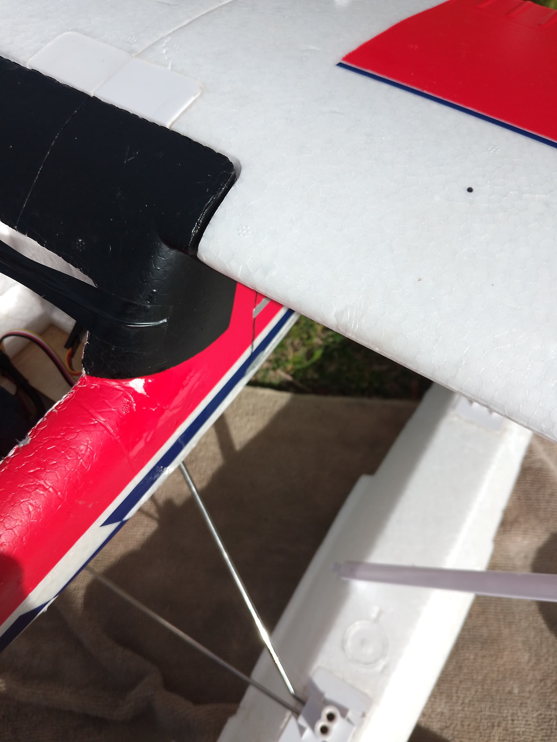

Fkn strut failed on the RANGER again, this time tearing the fuselage connection brackets.
The MAULE took a fair bit of configuring the TX/RX and having to reverse some channels along with remounting the Reflex V3 Gyro, as it was operating back to front!
I fly with the Gyro off anyway, but it was doing some weird shit with the wind stabilisers, so had to sort that out.
It flies like a School Bus, really nice, but can definitely feel that extra size for sure.
The old RANGER felt like a Ferrari when swapping between the two all day! ![]()

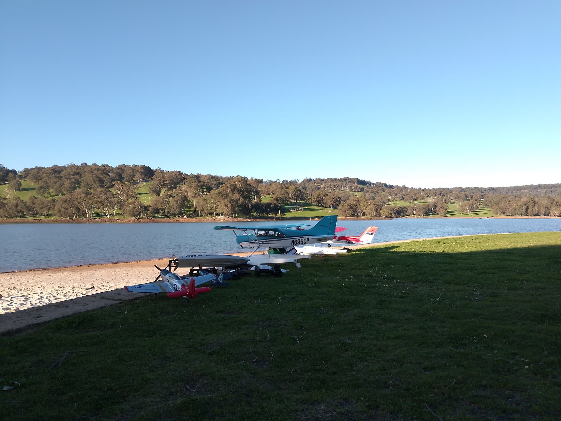

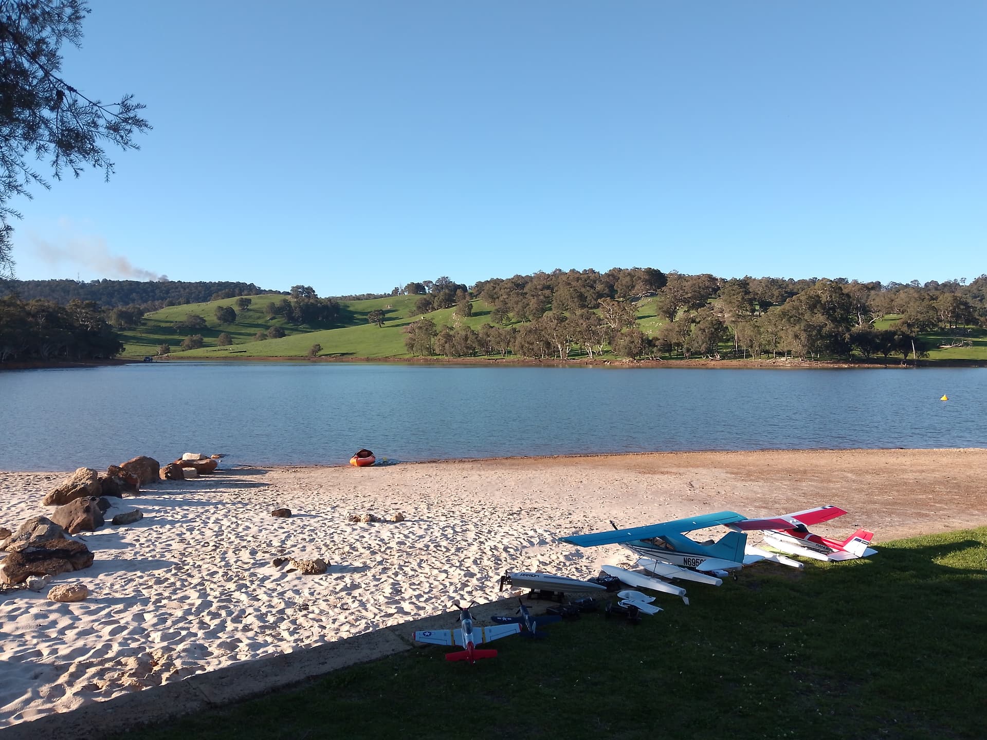

Was an awesome âWintersâ day out today!![]()
, but made the mistake of taking the RANGER out for âone last flightâ after the sun had gone down, and as the running joke goes, itâs. ALWAYS that âone last runâ when everything turns to Custard no matter if itâs an Airplane, Boat or Vehicle⌠something bad is bound to happen! ![]()
Havenât had the time or money to get to the big smoke to buy additional rechargeable batteries for my remote controllers, and just running well used EVEREADY Black batteries in everything EXCEPT my Airplane Controllers, as itâs not so critical if surface vehicles lose signal.
But today was running my ONLY set of rechargeable batteries in both the RANGER and the MAULE all day, swapping out into each TX for every flight on them both.

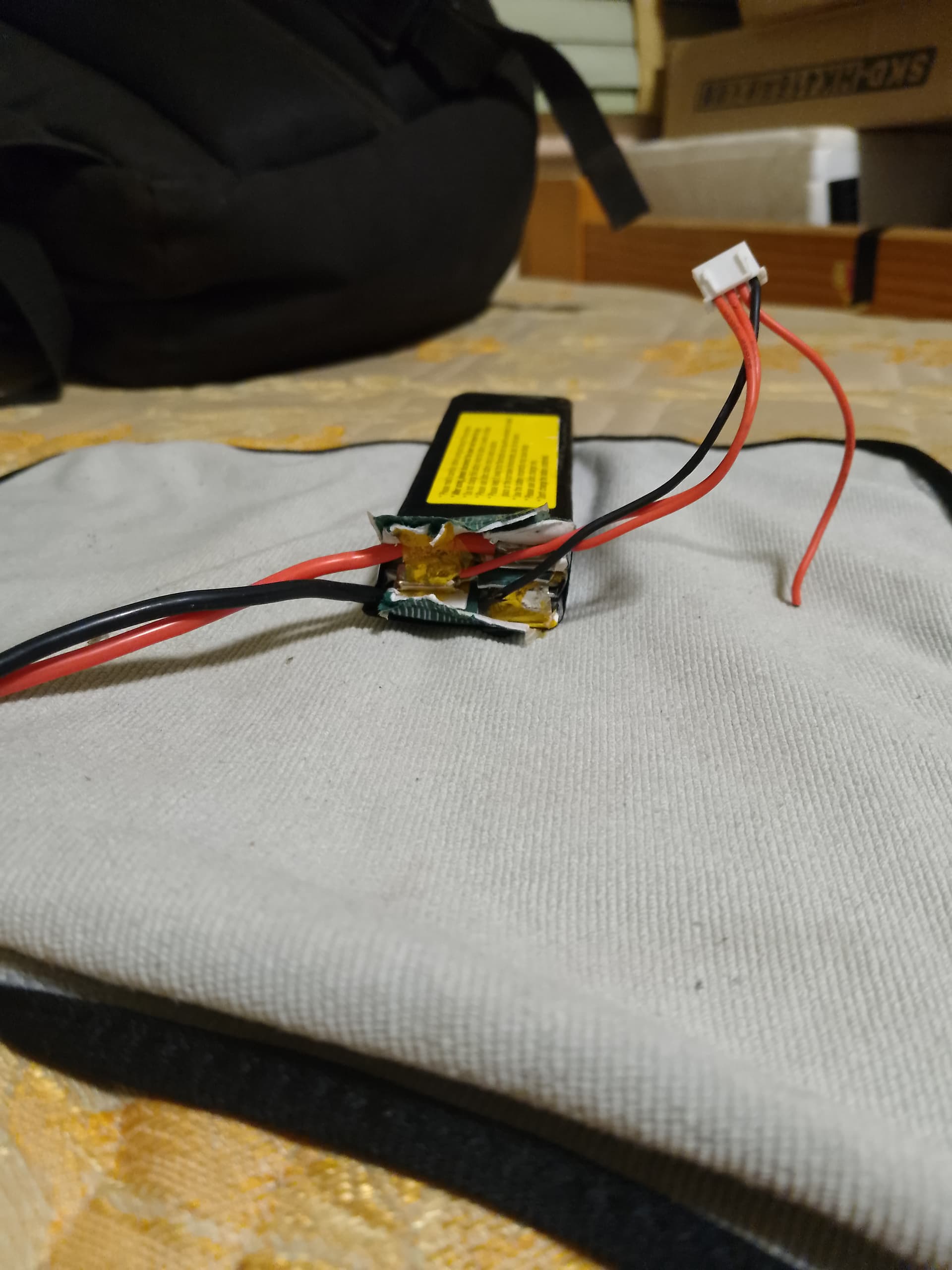

Just to add some more work, tore out one of the balance lead cables on one of the battery packs whilst running on 6S in the Speedboat.
More fiddly little work to repair. ![]()
And I might have accidentally shorted out a couple of cells using my pocket knife to cut open the pack⌠but only briefly let some sparks out!![]()

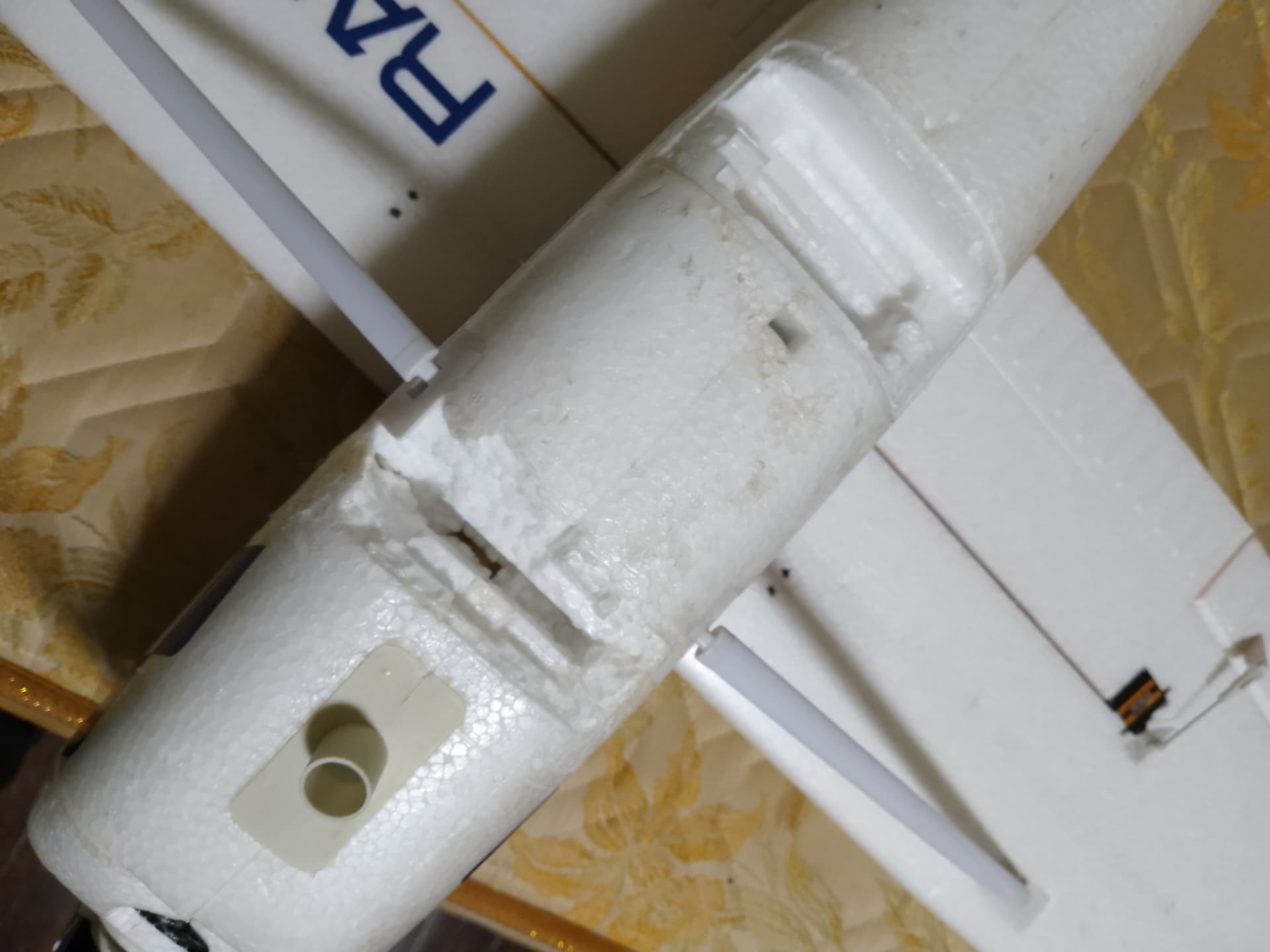

So⌠hope you buckle yourself in for another Docs Mods rant on whatâs happening with the FMS RANGER.

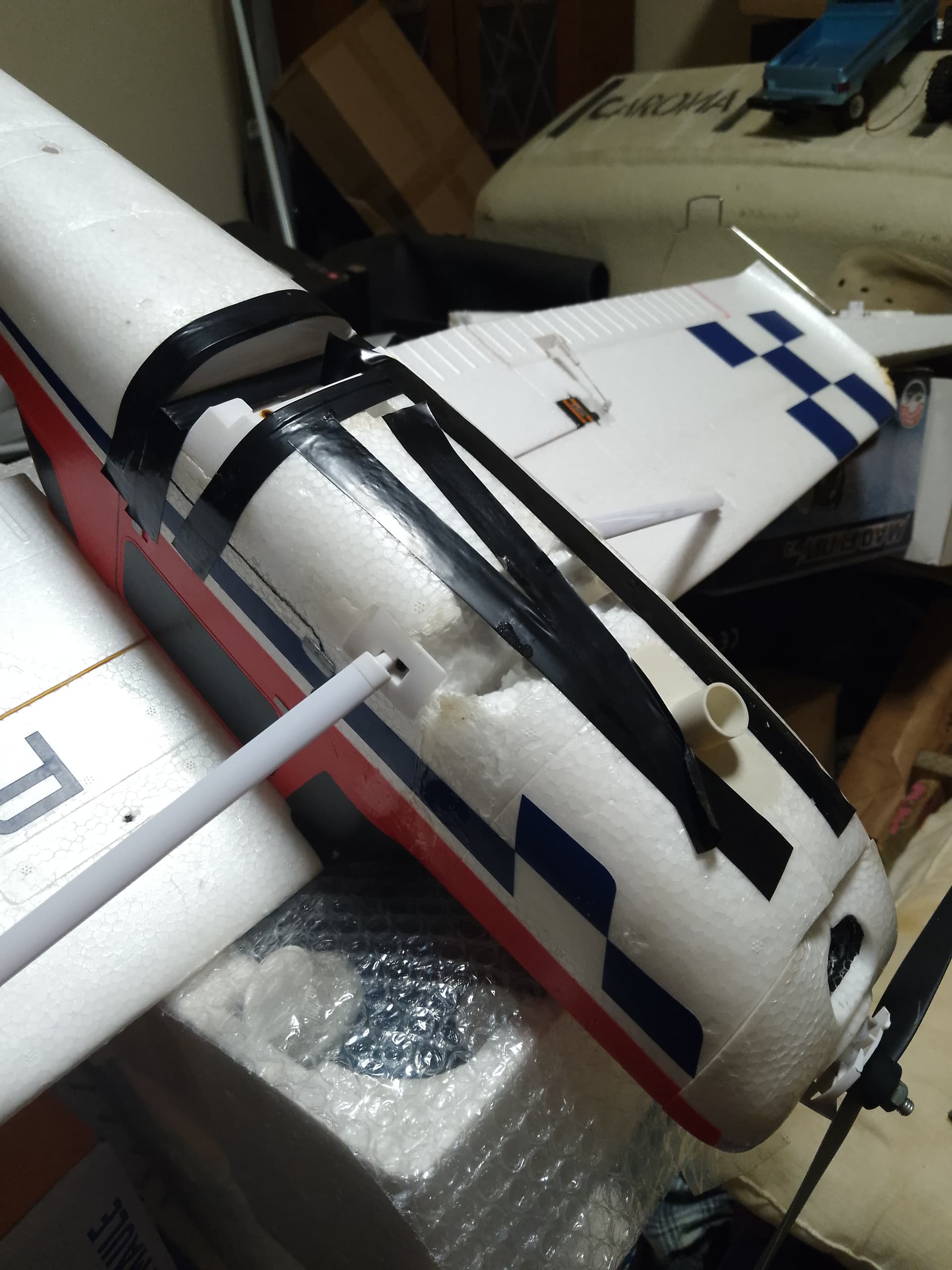

I already promised to give updates on the Air Crash Investigation from yesterday, and am happy to say that I have come to the realisation that all is not as bad as it seems! ![]()

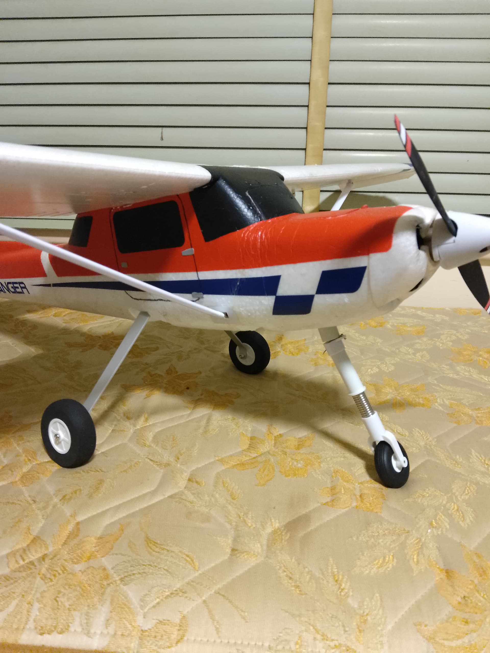

Yeah, itâs fkd as a Float Plane, but had the epiphany that it was designed as a land based Aircraft to begin with!
So despite losing the forward float fuselage panel, I went back to finding the original factory supplied box to get hold of the original land based landing gear. ![]()
I may have lost the whole front fuselage bracket for the Floats, but thatâs irrelevant to being able to refit the original land based front Tricycle Wheel steering gear and being able to attach the main landing gear to the one fuselage bracket that I have left!
Itâs really funny that all of these Aircraft that I have are land based Aircraft out of the box, but my own personal use is to make them perform as Waterborne Aircraft off of Floats and NEVER flew them off the ground on their original landing gear from day one! ![]()
Am going to actually attach the ground
gear to the destroyed FMâS RANGER simply to be able to keep flying it regardless of the place that Iâm flying. ![]()
Truth is that crashing ground Aircraft into the water is no different to noseplanting them into the ground.

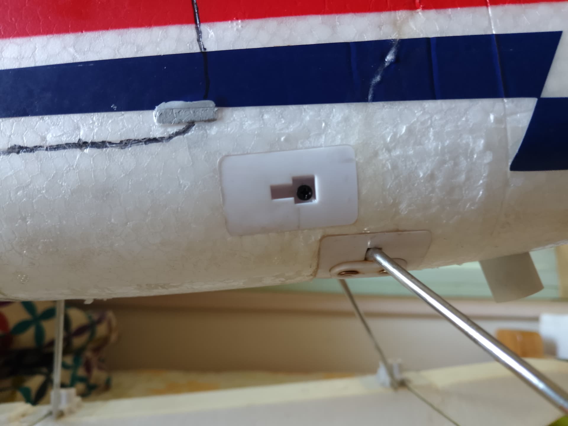

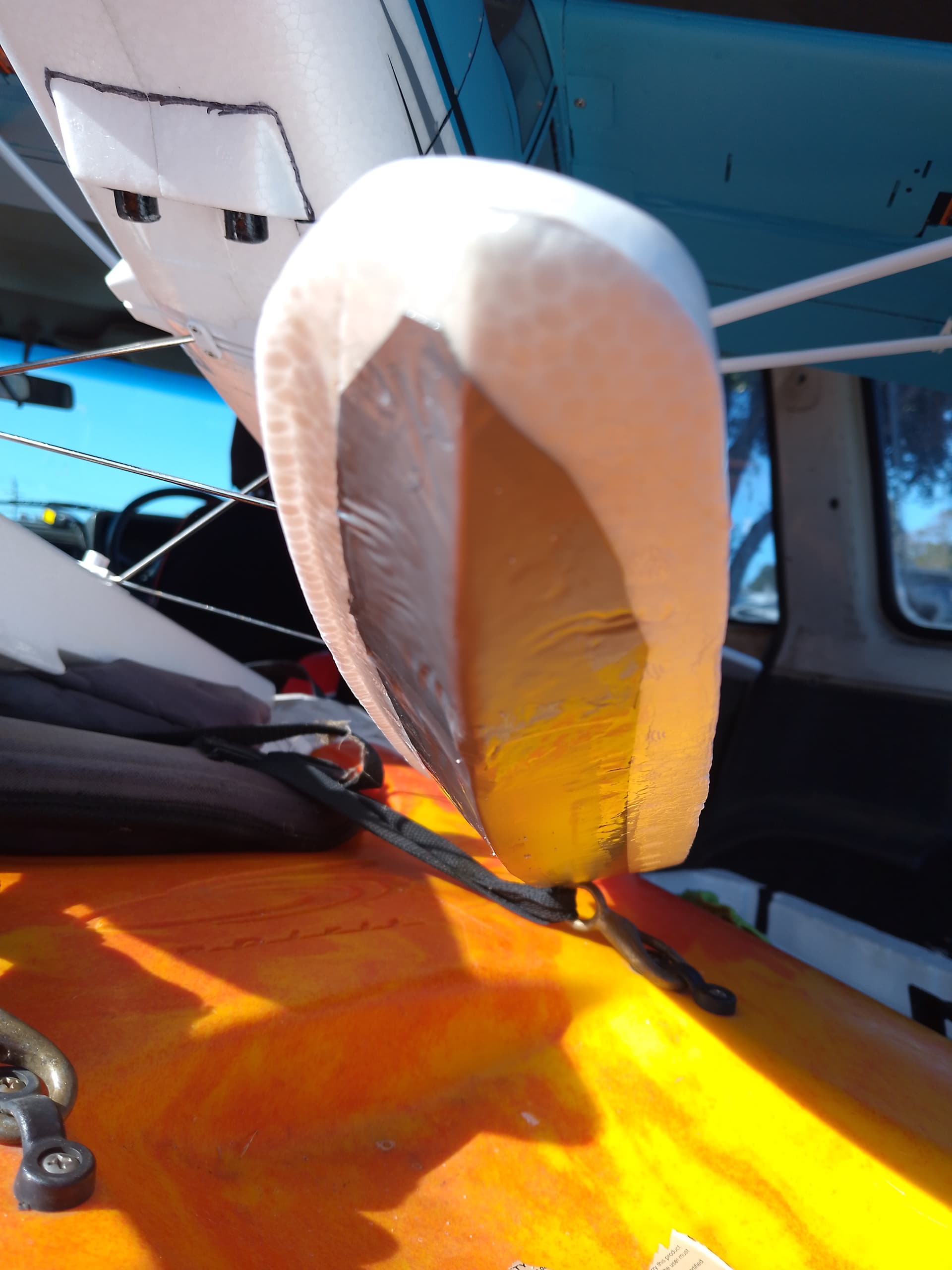

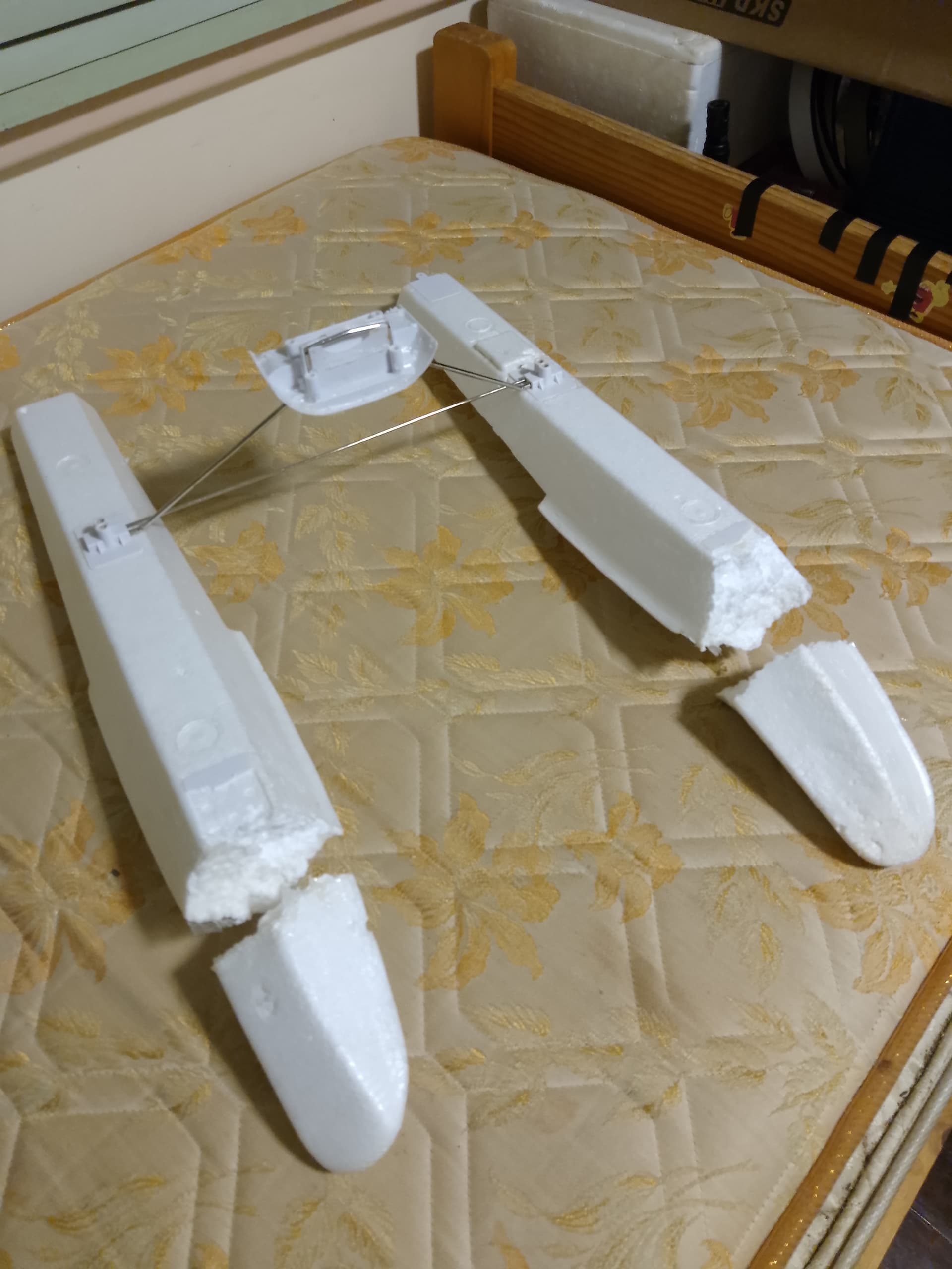

Damage report:
Both floats US, but were already glued together and fixed 3 times prior to this incident, hence why I LOVE EPP Foam over Balsa Wood any day of the week! ![]()
The already damaged and reglued stainless front float frame mounts are at the bottom of the Weir.

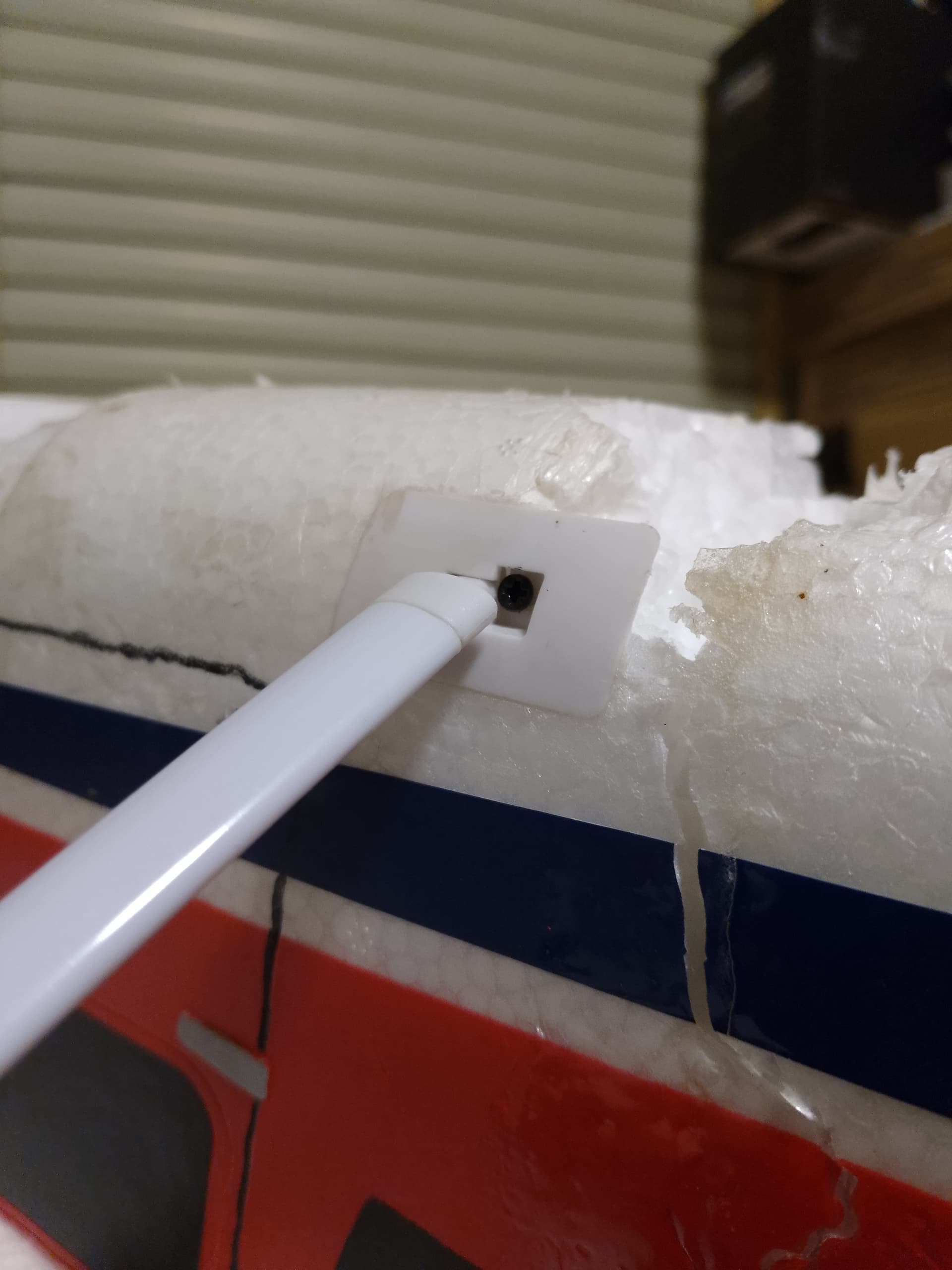

My modification of adding locking screws in from of the wing struts worked a treat, and am an idiot from NOT taking the advice from the people reviewing this Airplane and pointing out the need to lock in the wing struts to avoid the many crashes that I experienced from day one from the wing struts dislodging and causing major accidents. ![]()

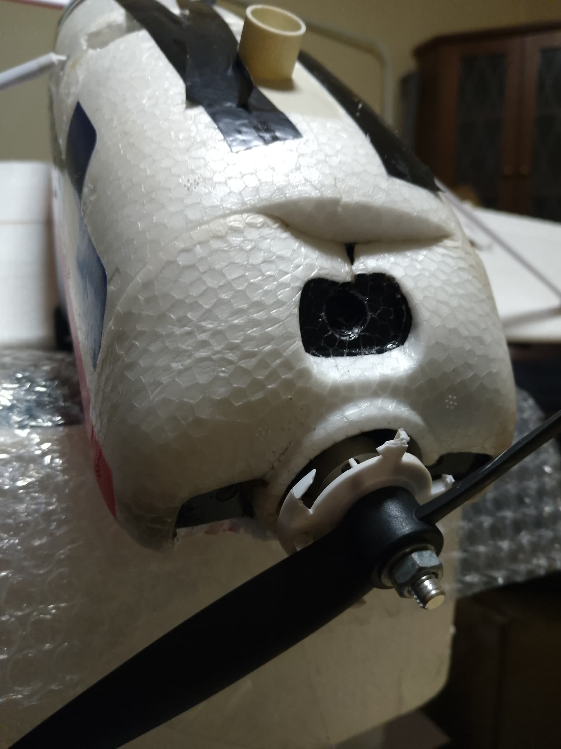

The motor/nosecone/propeller got hammered, but already have parts to overcome this pretty irrelevant issue.

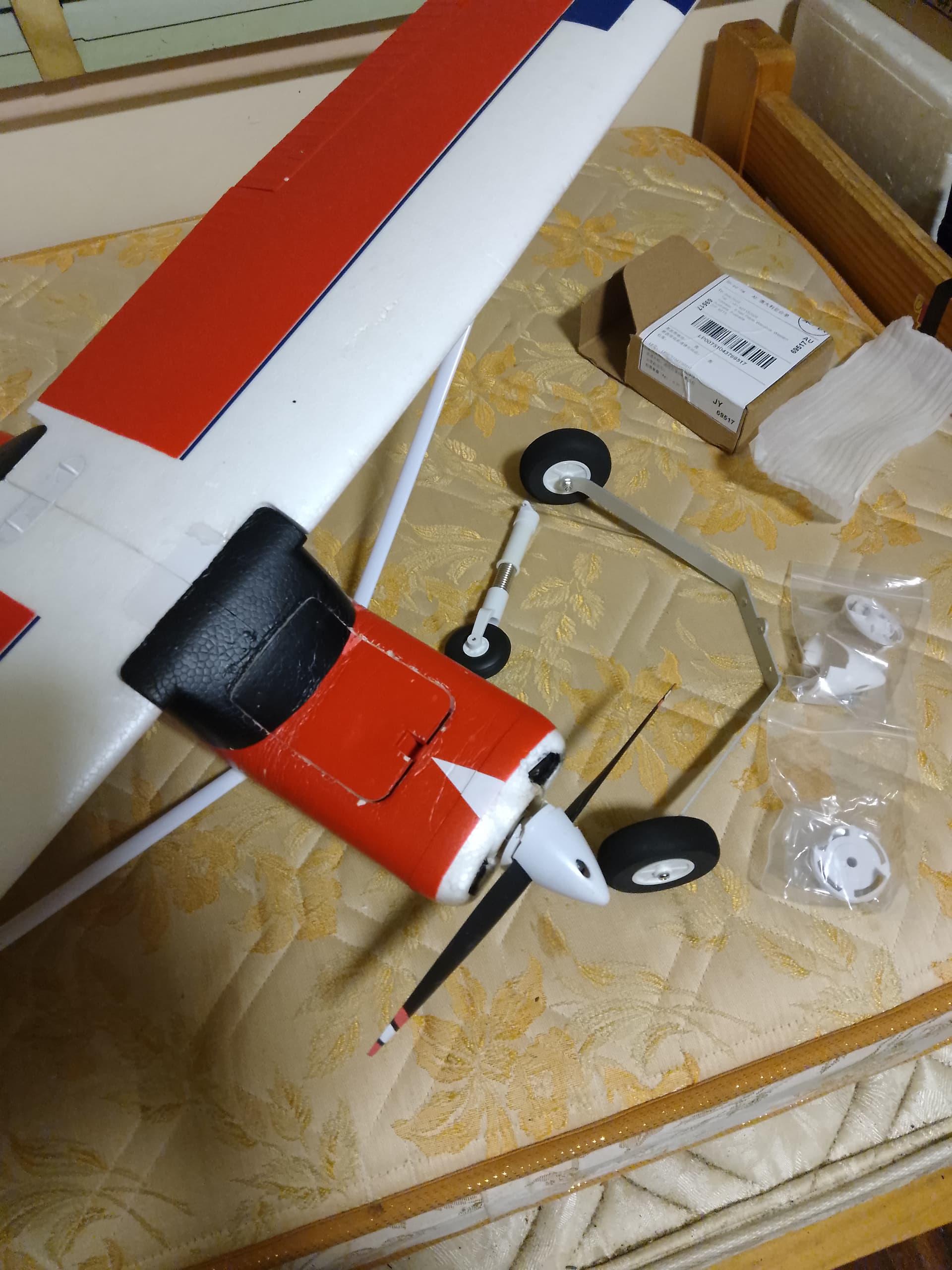

Iâm getting all confused here, but only trying to show that the original main landing gear set and steerable tricycle front wheel mechanism is easily able to be reinstalled.

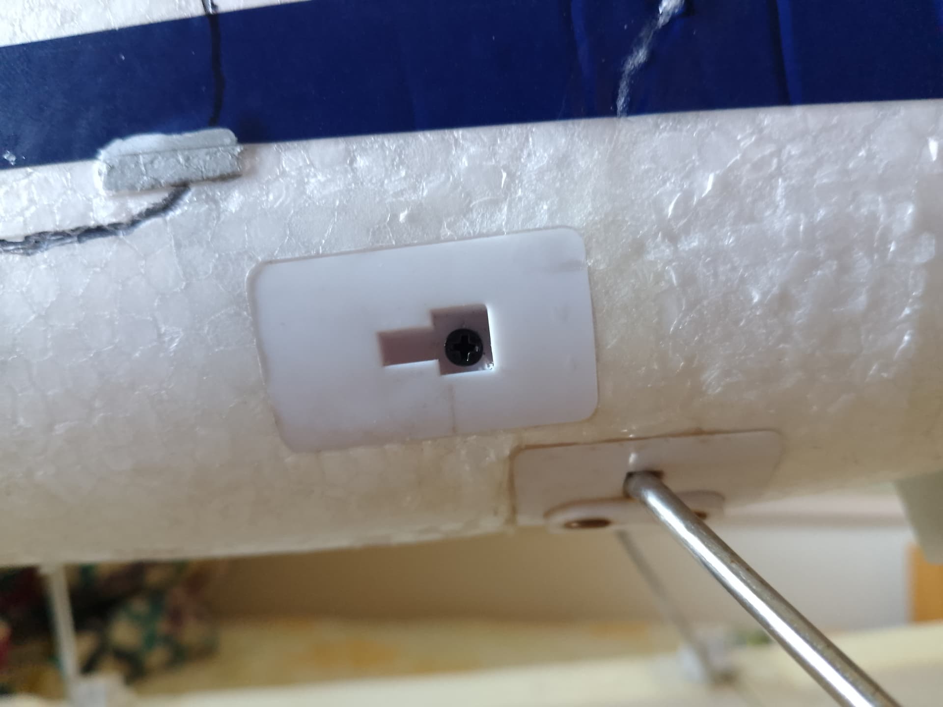

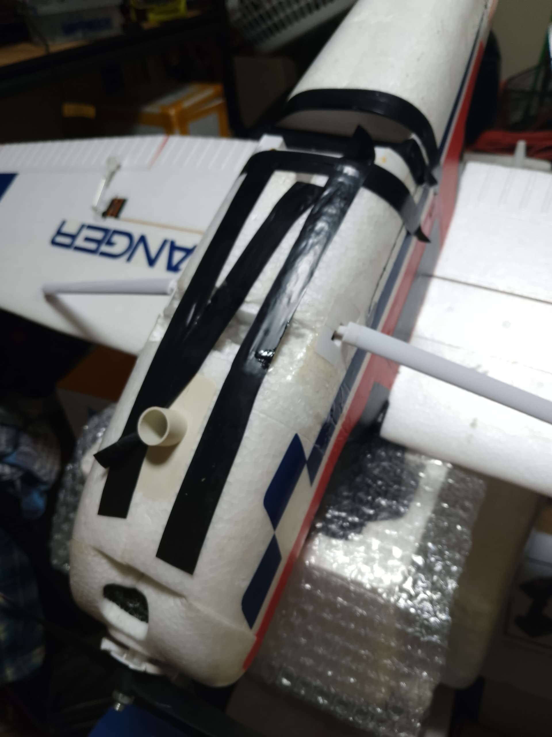

So just another day glueing shit back together in preparation for moving onto the next stage of flights. ![]()
These bits will allow me to attach the original landing gear for ground takeoffs and landings âŚ
Still need to disassemble the motor cowling and straighten it outâŚ
But again, how easy are these EPP Foam planes to repair compared with the old Wooden Airplanes! ![]()

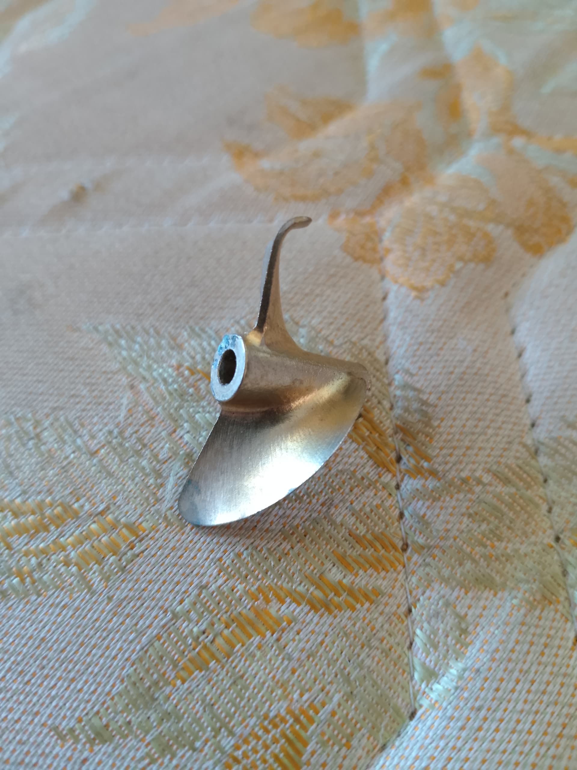

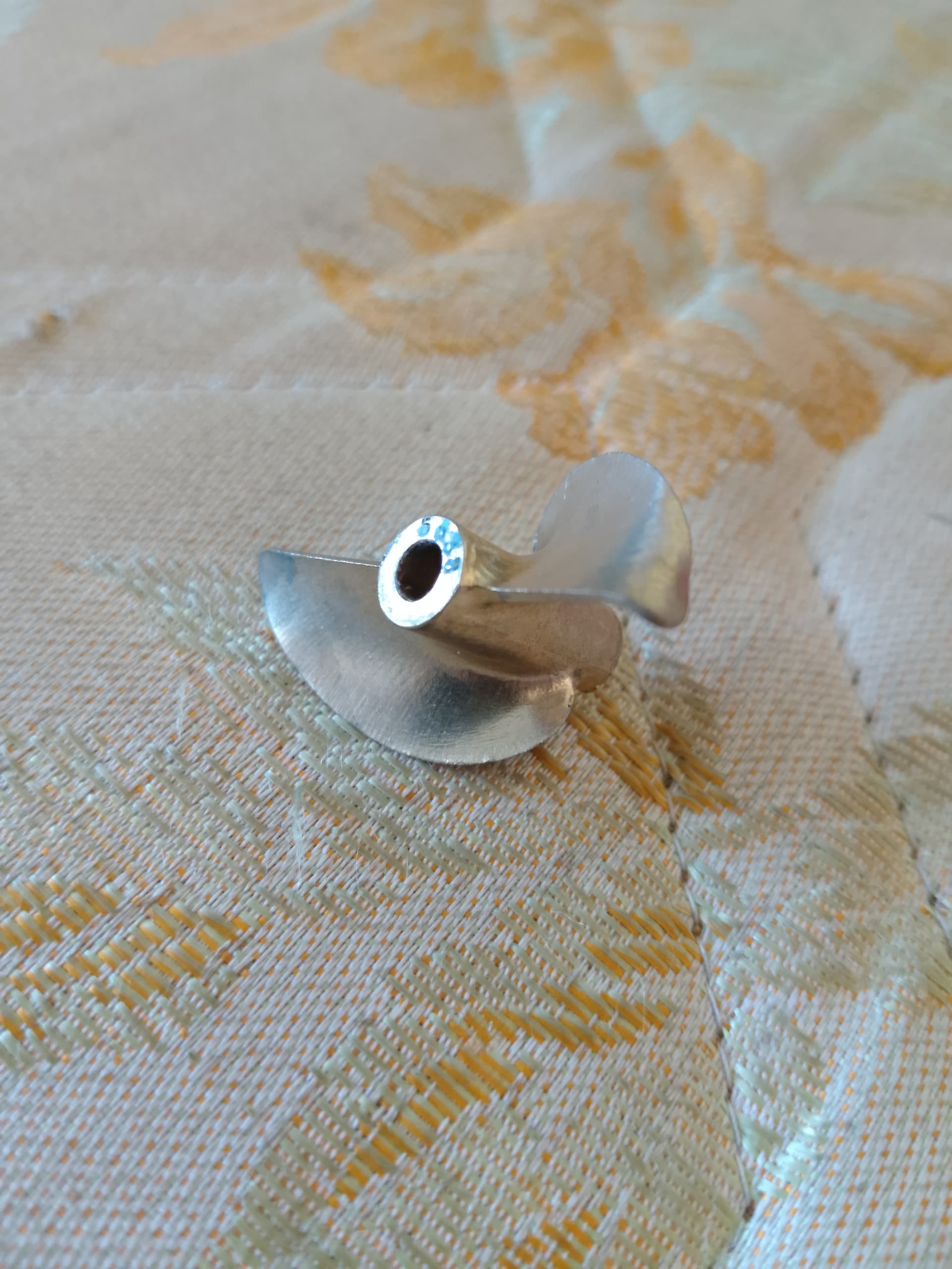

Bent a new prop after striking something in the water the other dayâŚ
Then the floats on the brand new MAULE have been taking a beating with floating debris/sticks and honky nuts, so added some NITTO Tape to try help protect them,
Unfortunately yesterday, after fitting a new Prop, I sunk the Speedboat after hitting something at high speed and lost the water sealing Hull Hatch completely flooding the Hull and sinking it, but it has foam flotation in the Bow and was able to paddle out to recover it.

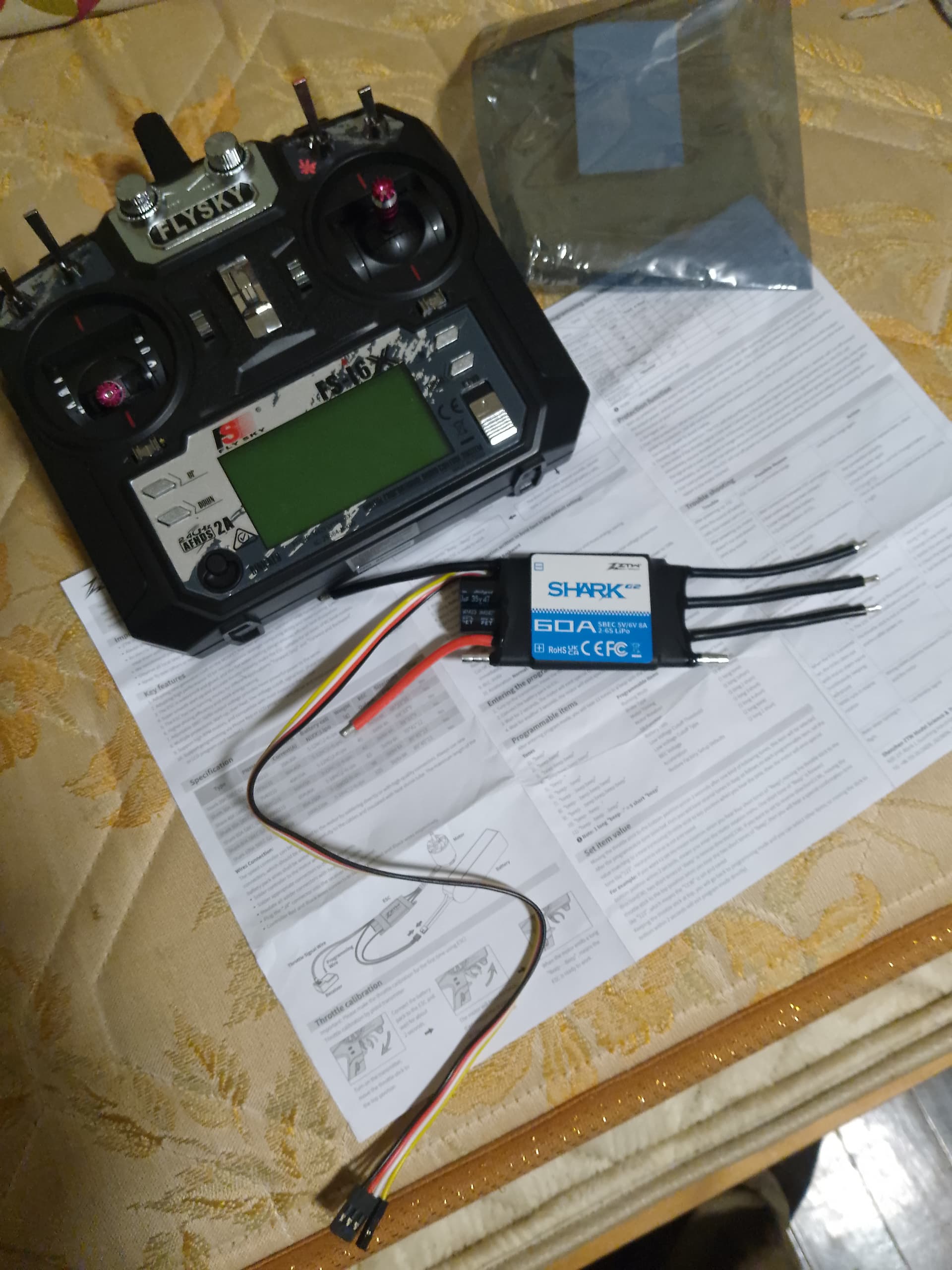

Doesnât matter, as my aftermarket waterproof Speedboat ESCâs arrived the other week for me to replace it with.
These will also being fitted to my 3 other Airplaneâs Iâm still waiting for delivery, that I will be converting to Floatplanes as well.

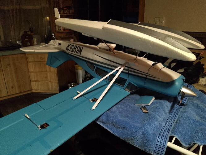

I already have the RED 1220mm FMS RANGER that I converted to Floats and has been hammered into oblivion that I was looking to repair, but was going to cost more money to replace the damaged Floats/Parts than it was to simply order a brand new one in YELLOW and keep the old beaten up/glued together RED one as purely a land operated Aircraft on the original landing gear that Iâve currently refitted to it. ![]()
(Pic prior to fully installing the nose wheel)

In the meantime have brought the MAULE inside in front of the heater and
it upside down with all the Hatches open to try and dry everything out.![]()

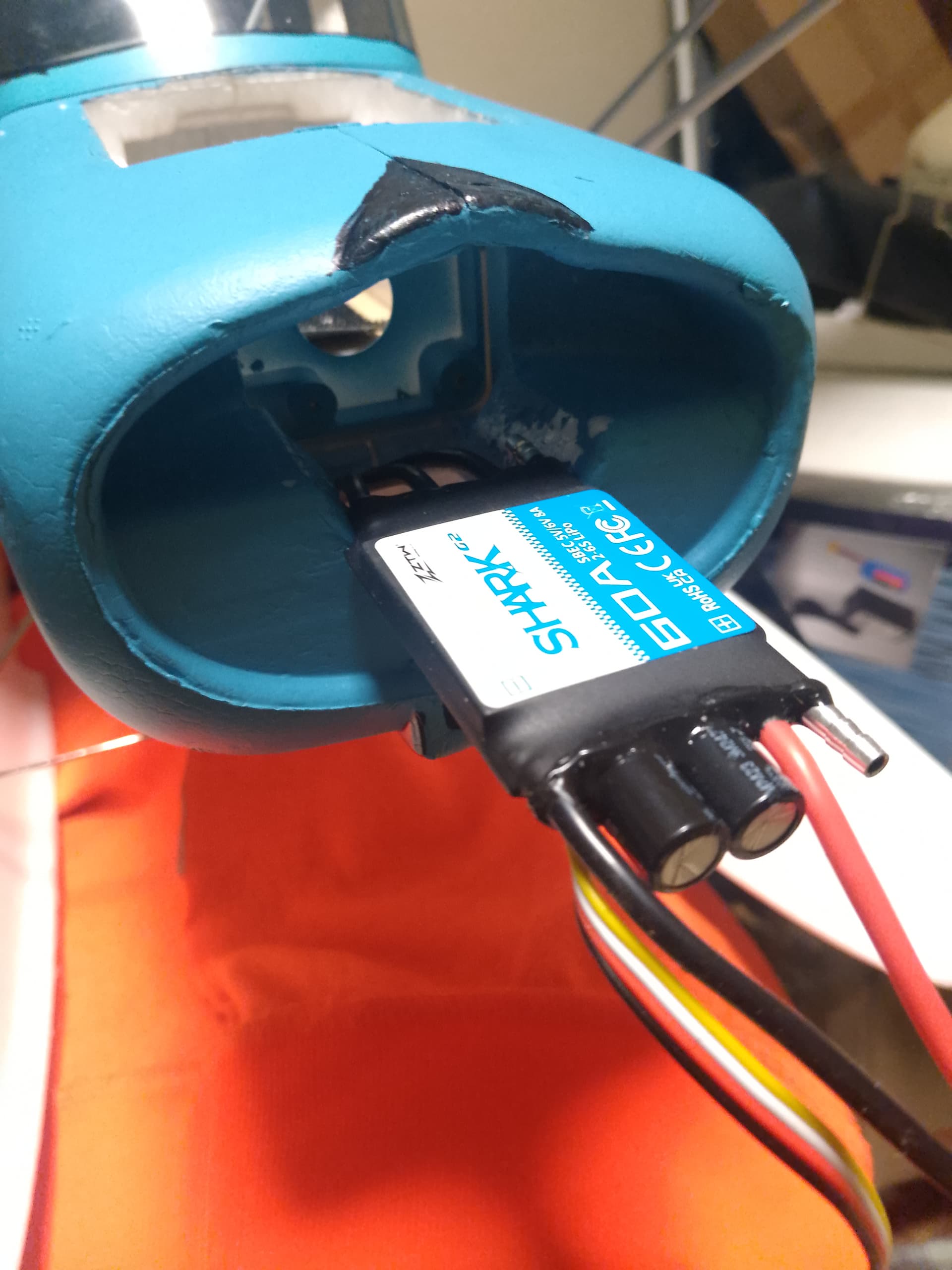

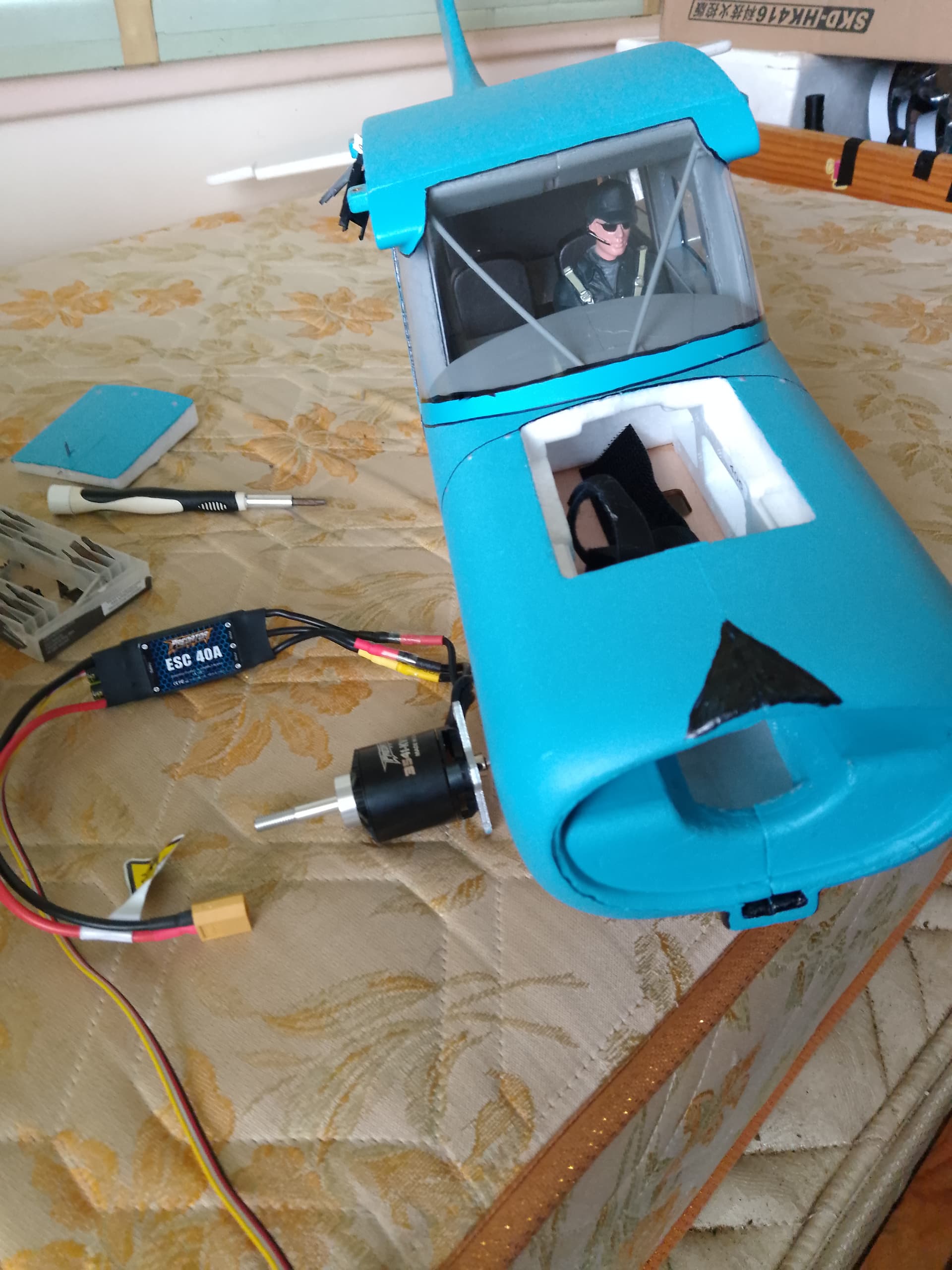

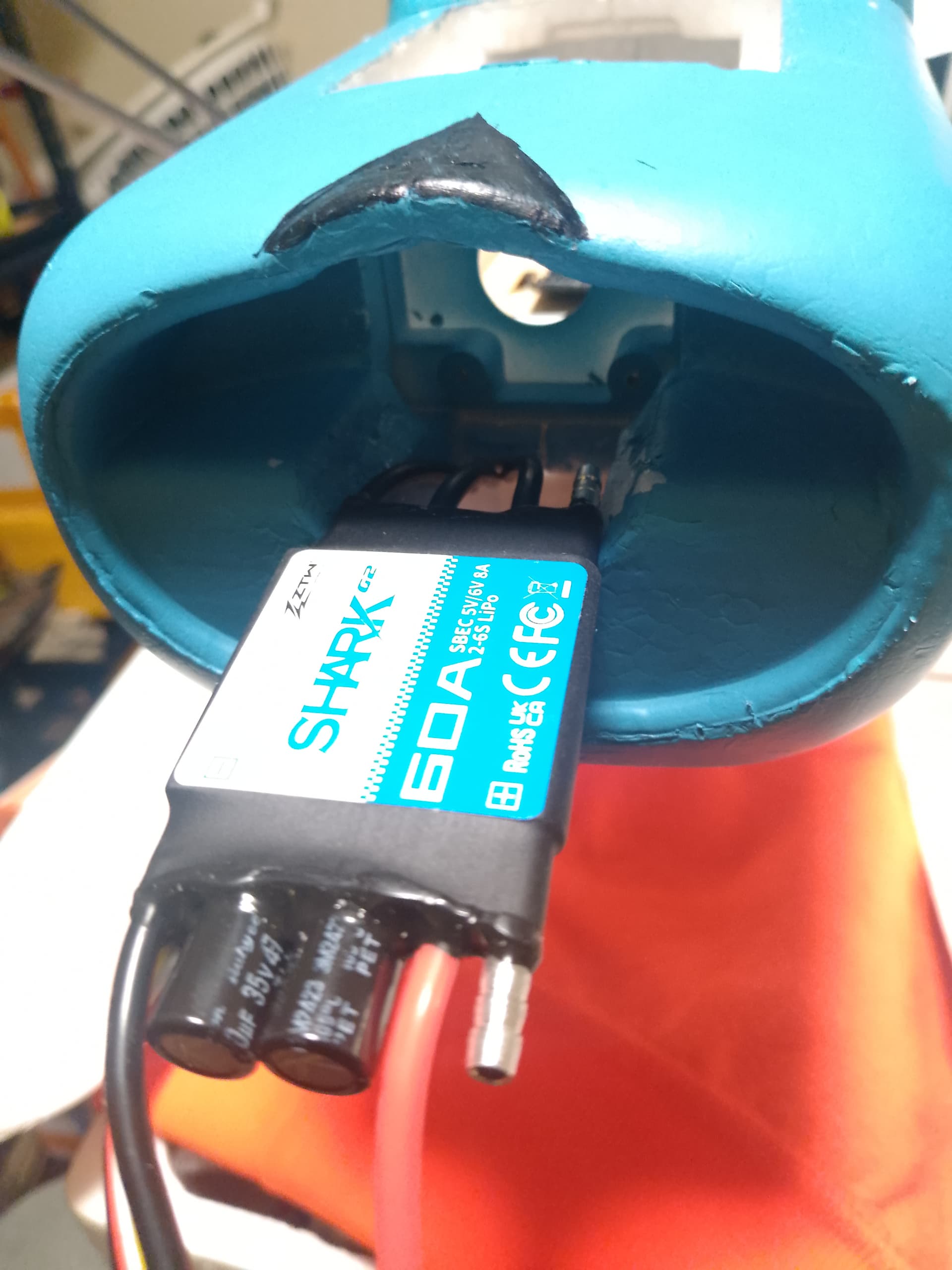

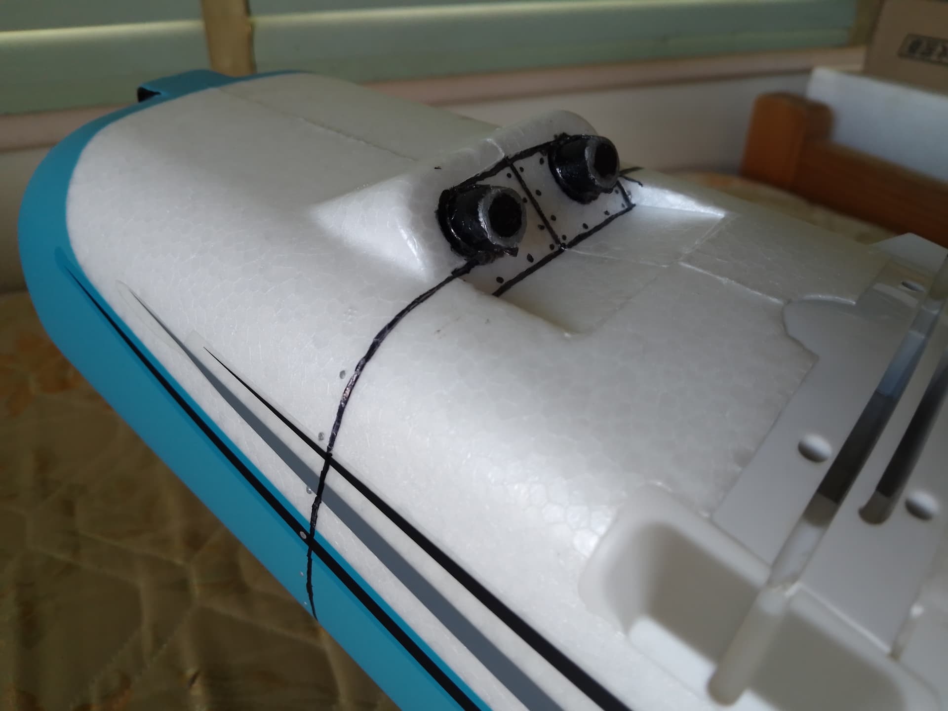

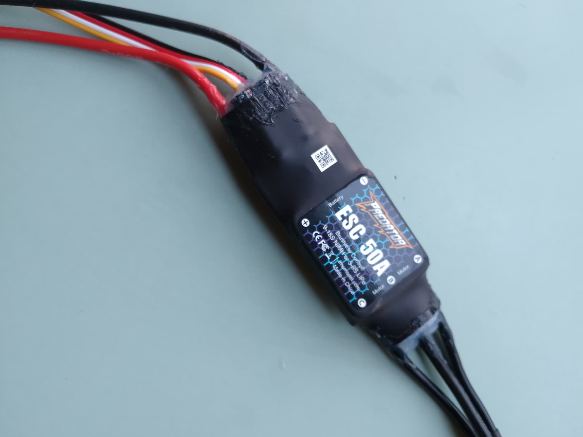

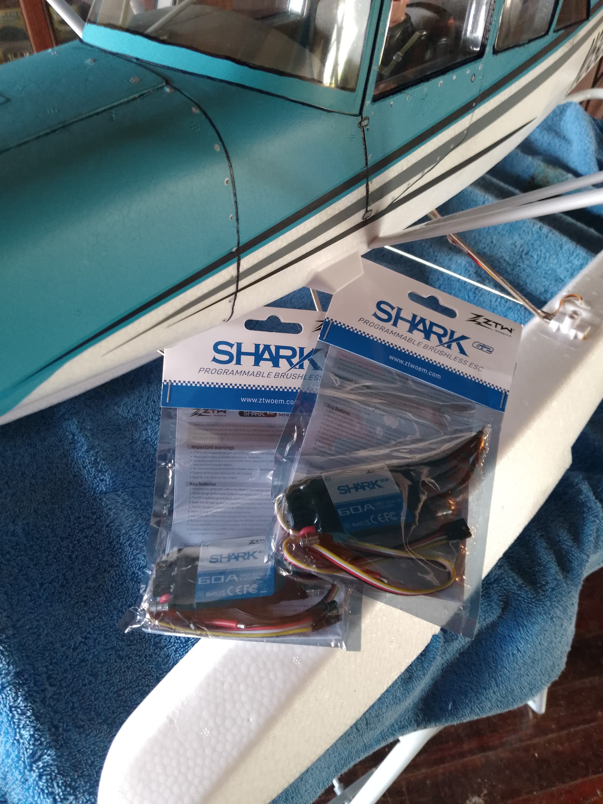

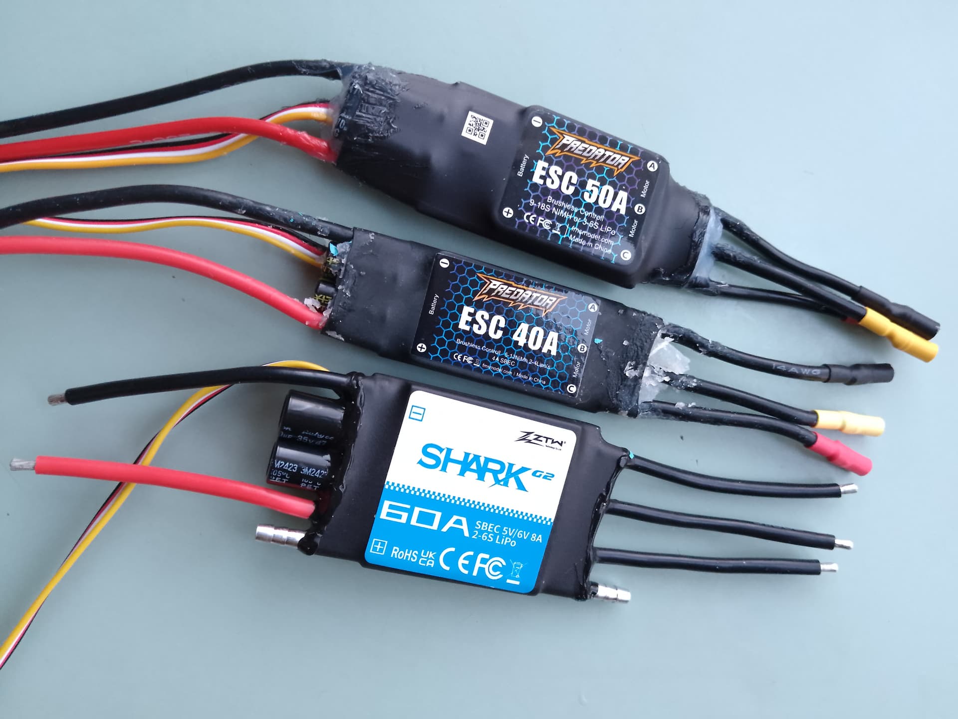

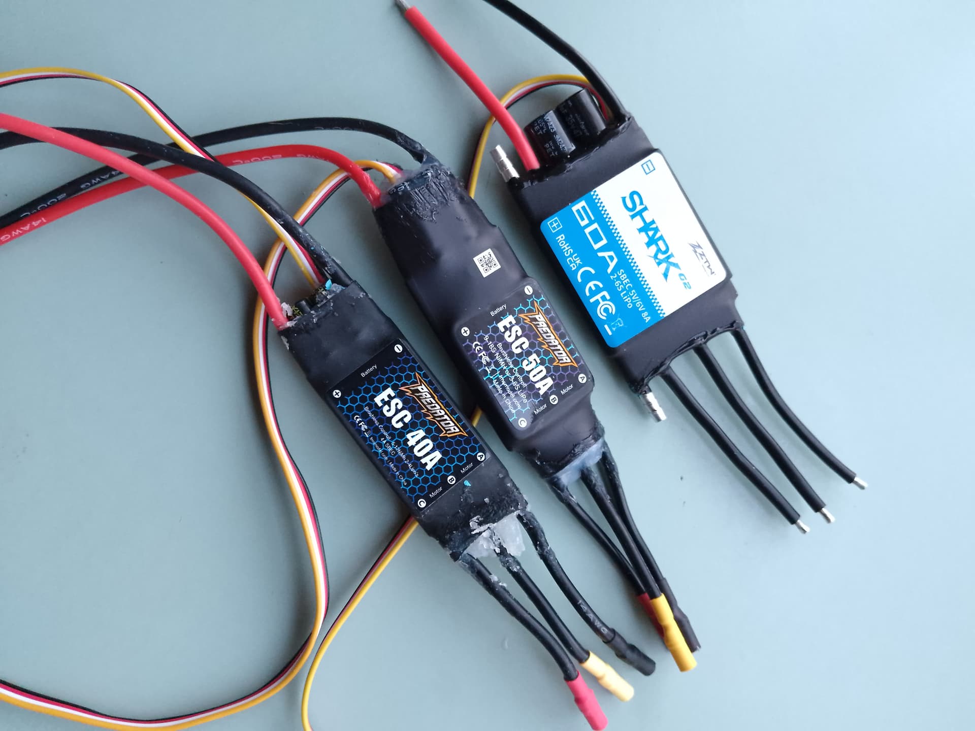

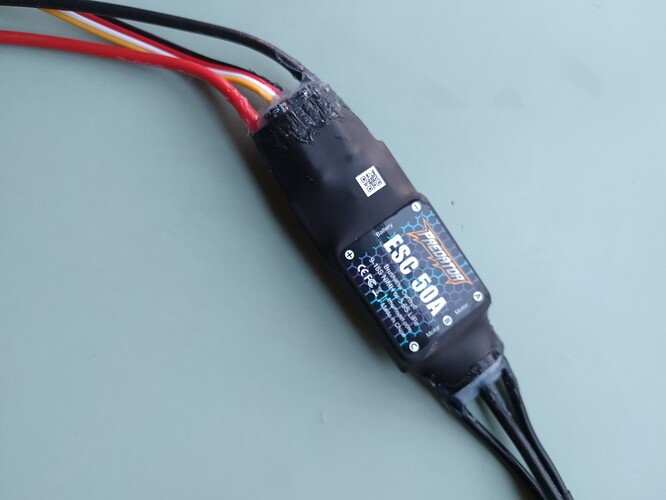

So⌠being a bit "creativeâ with the electronics I currently have available to get the MAULE back into the air.

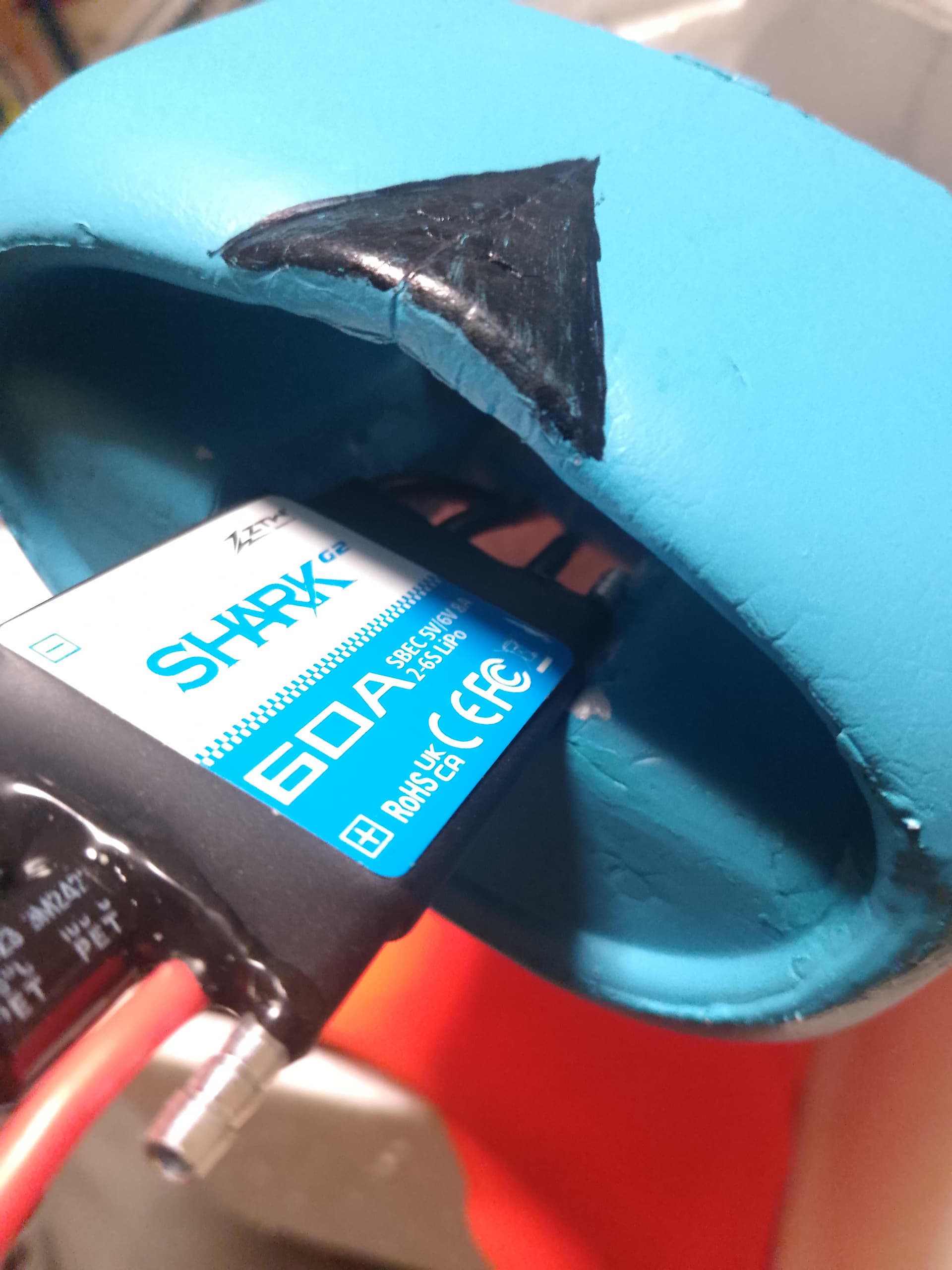

Yes, I do have my 60A ZTW ESCâs on hand, but would require a LOT of modifications to be able to install them because of their much larger size. ![]()
So have decided to to install a backyard âwaterproofedâ upgraded FMS 50A ESC in place of the 40A factory unit that failed through water egress.
Actually âSealedâ with fresh Roof and Gutter Silicone rather than the old crumbling âFish Tankâ Silicone that I applied to the 40A ESC that failed from the outset.
It might not look much , but thereâs very little room to modify these Aircraft beyond their original designs.
Itâs pretty obvious in these pics that the higher Amperage ESCâs take up a lot more space than the OOTB units, so have taken the easy path fitting the FMS 3-6S 50A ESC as a direct replacement for the original 2-4S 40A ESC.
The added bonus is that the BEC outputs 8A at 5-6V which is insane power, compared to the original 40A ESC providing 4A at 5V. ![]()
Iâm NOT giving up on a way to be able to install these fully waterproof Speedboat ZTW SHARK ESCâs, because they are absolutely mind-blowing in their performance, but thereâs simply zero room to be able to fit them through the normal ESC mouldings within the Fuselage when compared to the original 40A ESC pictured above.![]()
And itâs not just cutting out space in the Nosecone, thereâs a secondary bulkhead to be navigated below the battery tray in the fuselage to locate the larger ESC as well. ![]()
Have the plan in place to feed the ESC through the bottom Hatch in the rear of the fuselage, but it will be almost impossible to attach the motor wires due to the restrictions of the inner bulkhead allowing access to the plugs. Will still give it a good hard go despite the facts that Iâve already calculated, just to prove that nothing is impossible with the right mindset and patience. ![]()
