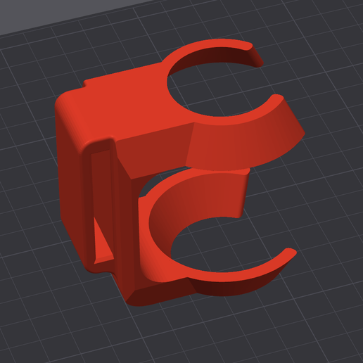

Do you think the current version would be of production level? like not needing anymore major alterations.
I think your assessment of the bottom clamp is spot on. It did fall out on me once last time, and some bushes knocked it out of the holder on another run. It could have just been a rough day though. I was planning to test it a bit more before confirming anything, but I wasn’t in a rush since you’re out of the printing game for a while. ![]()
Getting as much play time with it can only be beneficial, any observations on how it came loose, like it getting caught or working itself out will only give more information for improvements.
Apart from that how’s the rest of it holding up, nothing’s bending too much or showing signs of breaking?
Fell out once while running on bitumen, I can only assume the jolt of the footsteps was enough to pop it out. I should do some further testing at home, don’t really need to be at a field to test that one. The second time I was brushing past some bushes so I would say the slideway’s force popped it out.
Can confirm the rest of it is very solid, the back plate part of it is excellent and the top clamp I think is spot on.
It’s taking much longer than anticipated to find a place and get my printer set up so I figured I’d just post as is.
I believe there isn’t really any more work to be done with this design so I’m happy to set it free upon the world to empower the use of such devices ![]()
I am charging a couple of dollars for the design but wont be able to print them myself for a while yet.
Any additional feedback or constructive criticism is always welcome and I can update the design if necassary.
