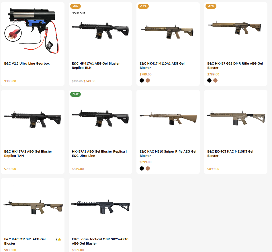

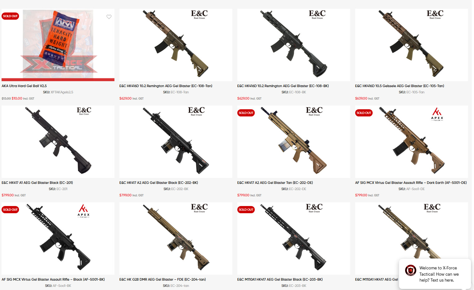

Certainly some options out there, CT seem to have the snappier prices
They are some nice look gats

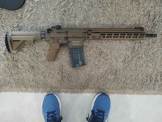

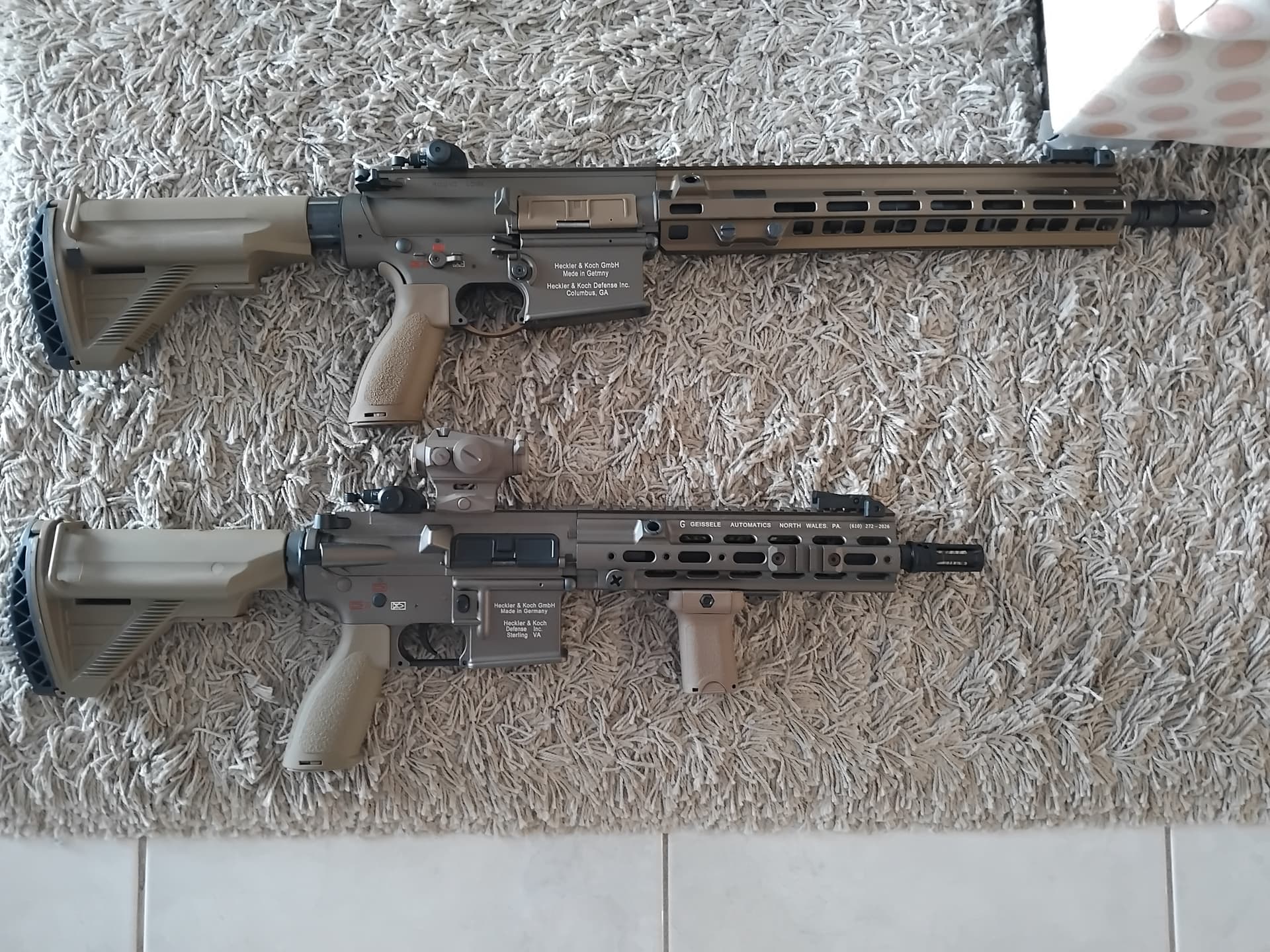

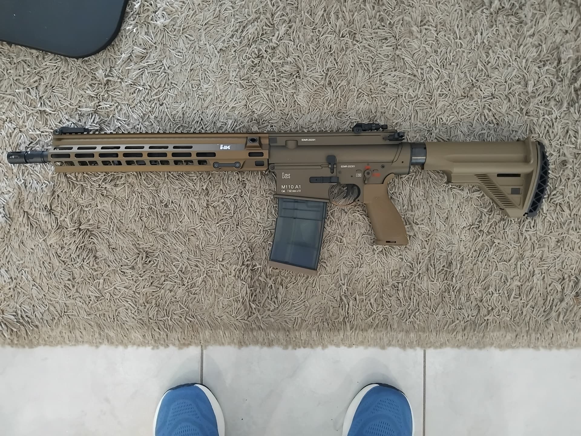

Didn’t take long…
V2.5, is Alive…!!
Even though it looks dark in the photos…the mag is a little light.
A quick coating of tamiya smoke, to just darken it a bit, while keeping some translucency…
“That’s not a long Barrel…THIS is a long Barrel…!!”
Yeah, Yeah… i know the G38 looks different…
But, it hurts my eyes to look at it…!!!
And he wonders why I call him money bags
:moneybag::moneybag::moneybag::moneybag:

Just teasing. Looks awesome :sunglasses:
Aircon money saved…!!
Two coats of smoke on the mag…
Let it dry, and then some initial performance tests…

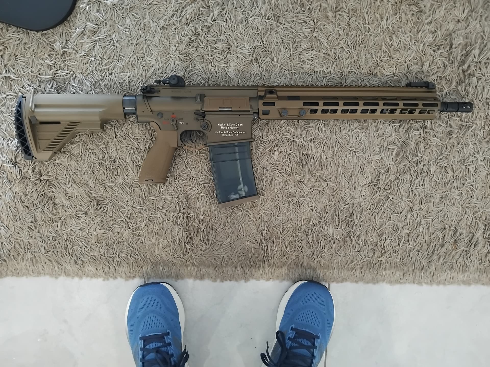

Some test firing, using older gels.
320-330 fps OOTB. Nothing super special, initially.
Range is fairly standard, for that fps. No hopup on it, as yet.
To be honest, i was kinda expecting this OOTB.
I remember the tech saying, it had received a fair bit of work.
I don’t know if he put a longer barrel in, to increase VE…
If that tech happens to be reading this, please feel free to PM me , to discuss what was done…
Anyway, no surprises for the starting point.
I’ll try some different gels.
Lets see how it ends up…
This is all a bit of an experiment, in what can be done, with these gearboxes…
According to my scales…
With batt and a mag, wt is 3.7 kg.
That’s in line with the advertised figures…
