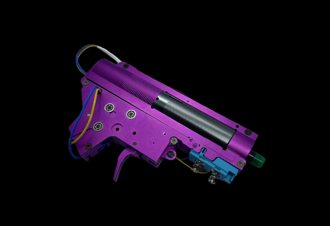

V3 gearbox
V3 comes in purple or silver

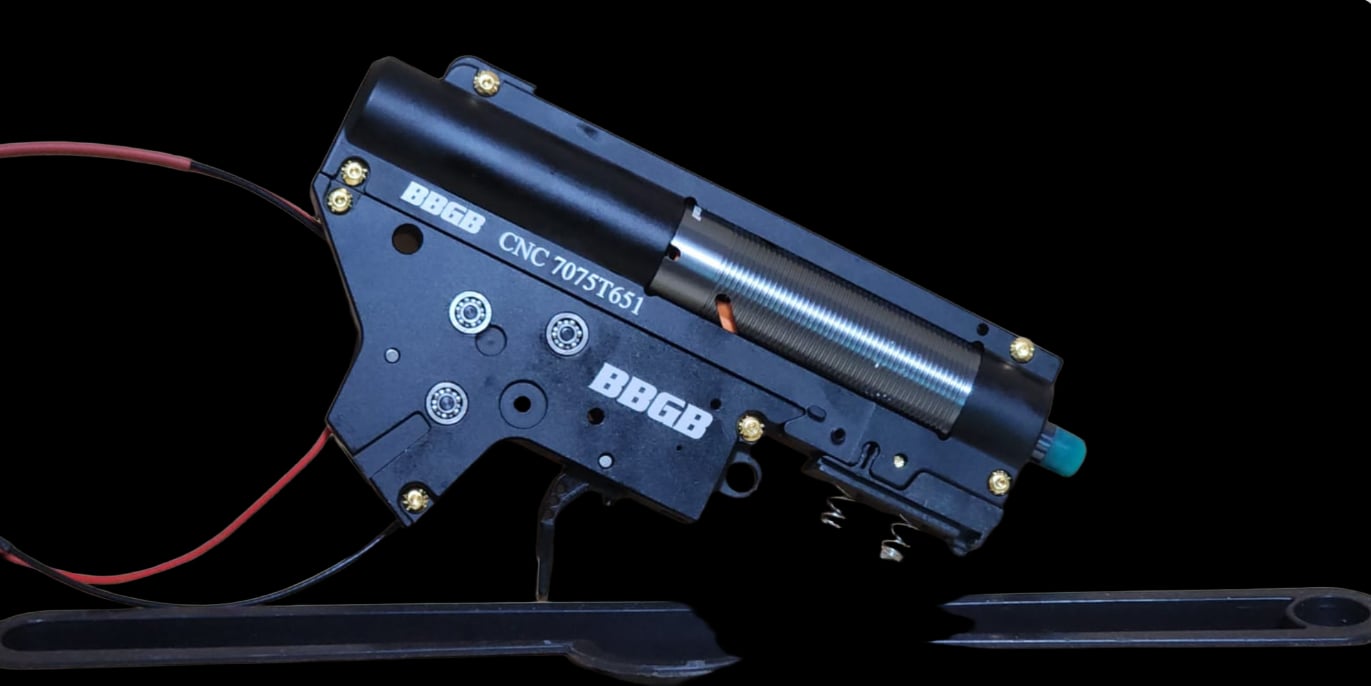

And heres an alternative v2.5 gearbox (I believe)
You can get the v2.5 in black and oil slick colours, oil slick is right up there in price tho
Not sure about the legitimacy of these, but there you are
I believe they are their different versions of a V2 gearbox. Bloody misleading. :roll_eyes:
