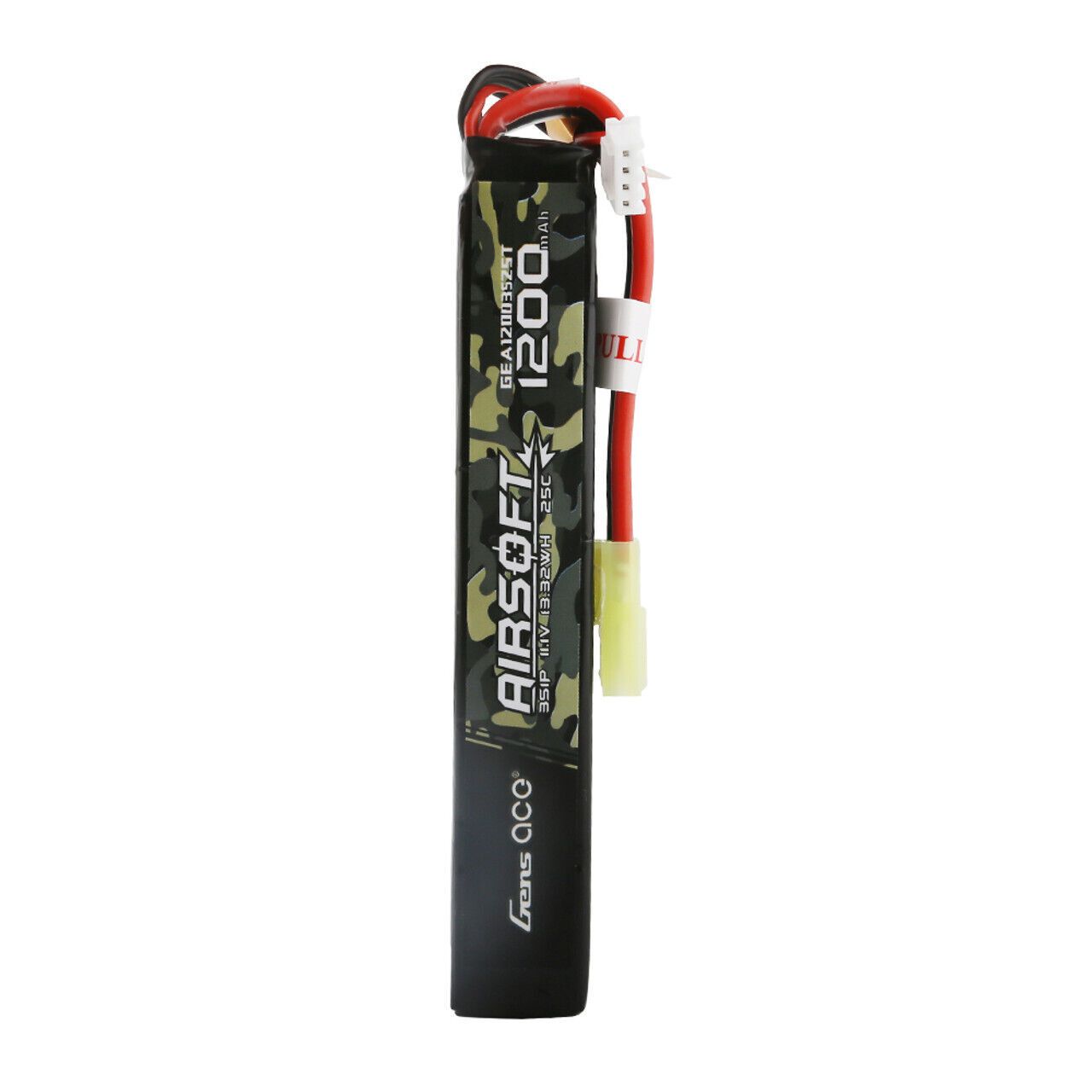

Looks like the label on the battery has changed but I believe this is the same one
Haven’t taken it apart to check contacts, that’s still outside my wheelhouse
Yeah I wouldn’t recommend digging around inside LiPo batteries!
Too risky for even this highly experienced electrical nerd.
Bin and Buy new would definitely be my advice. :+1:
to be clear I mean the trigger contacts in the gearbox

I’d be going with these at the moment. Been using them for years and they are still going.
Turnigy nano-tech 1200mAh 3S 25-50C Lipo AIRSOFT Pack
They have a range at the moment and you can see the price. Check the specs down below for the physical dimensions of the battery to fit your needs.
Turnigy batteries are good and the price isn’t bad either. Ran a heap for years too!
Fairly sure they have these at my local field. The SLR Ion battery compartment it pretty small but I’ll give one a test next time I’m there.
How are they selling them for less than $5? Even at full price that’s kinda triggering the “too good to be true” flag
Likely what they cost to make and have an abundance of them. The postage is $20, I just ordered 4 for $40. Still good price.
bit too long for the stock :cry:
Can you measure the space you have?
These are 30mm shorter than the one I linked too above. Also 2s or 3s?
Turnigy nano-tech 1000mAh 3S 20-40C Lipo AIRSOFT Pack
