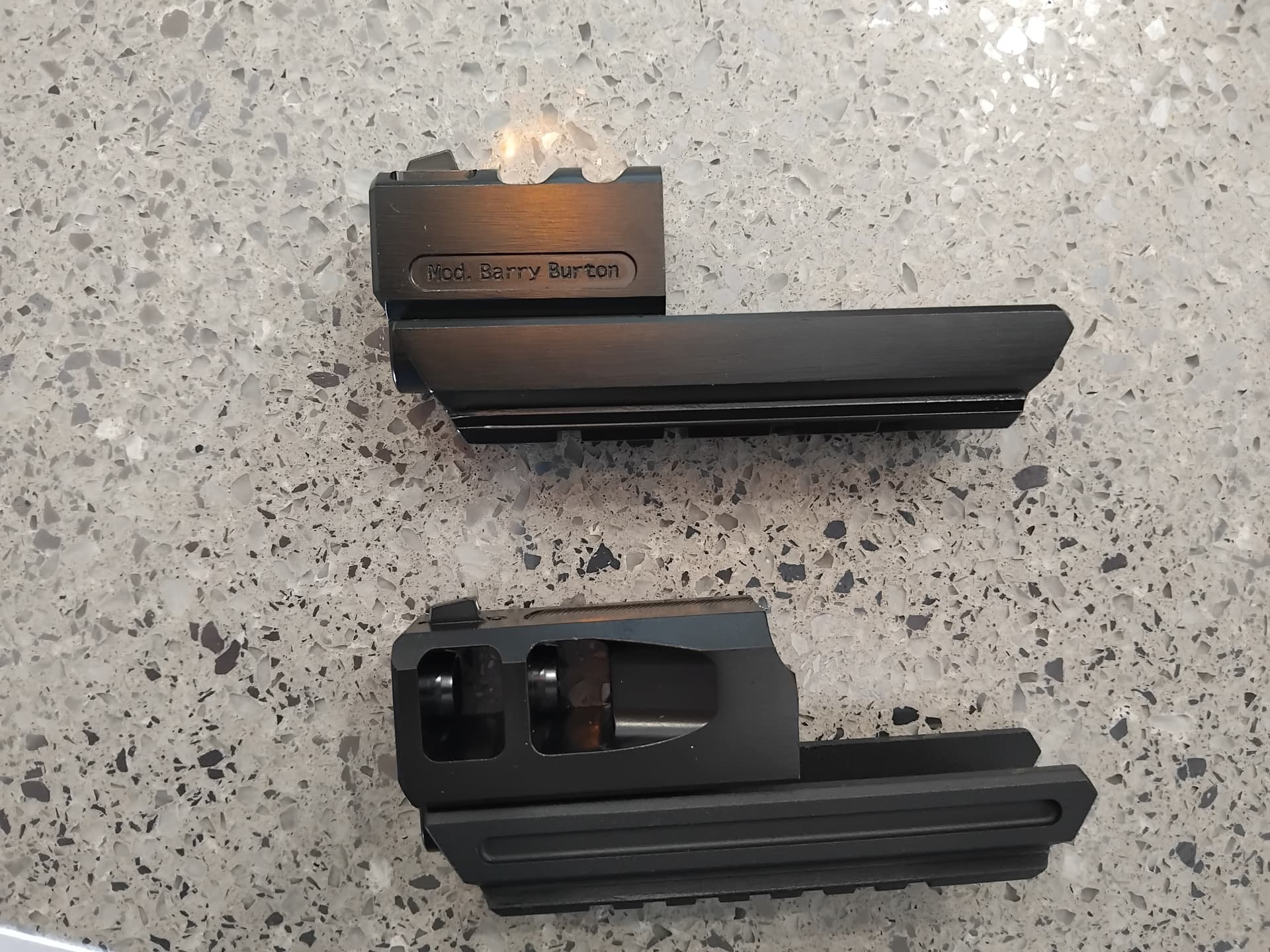

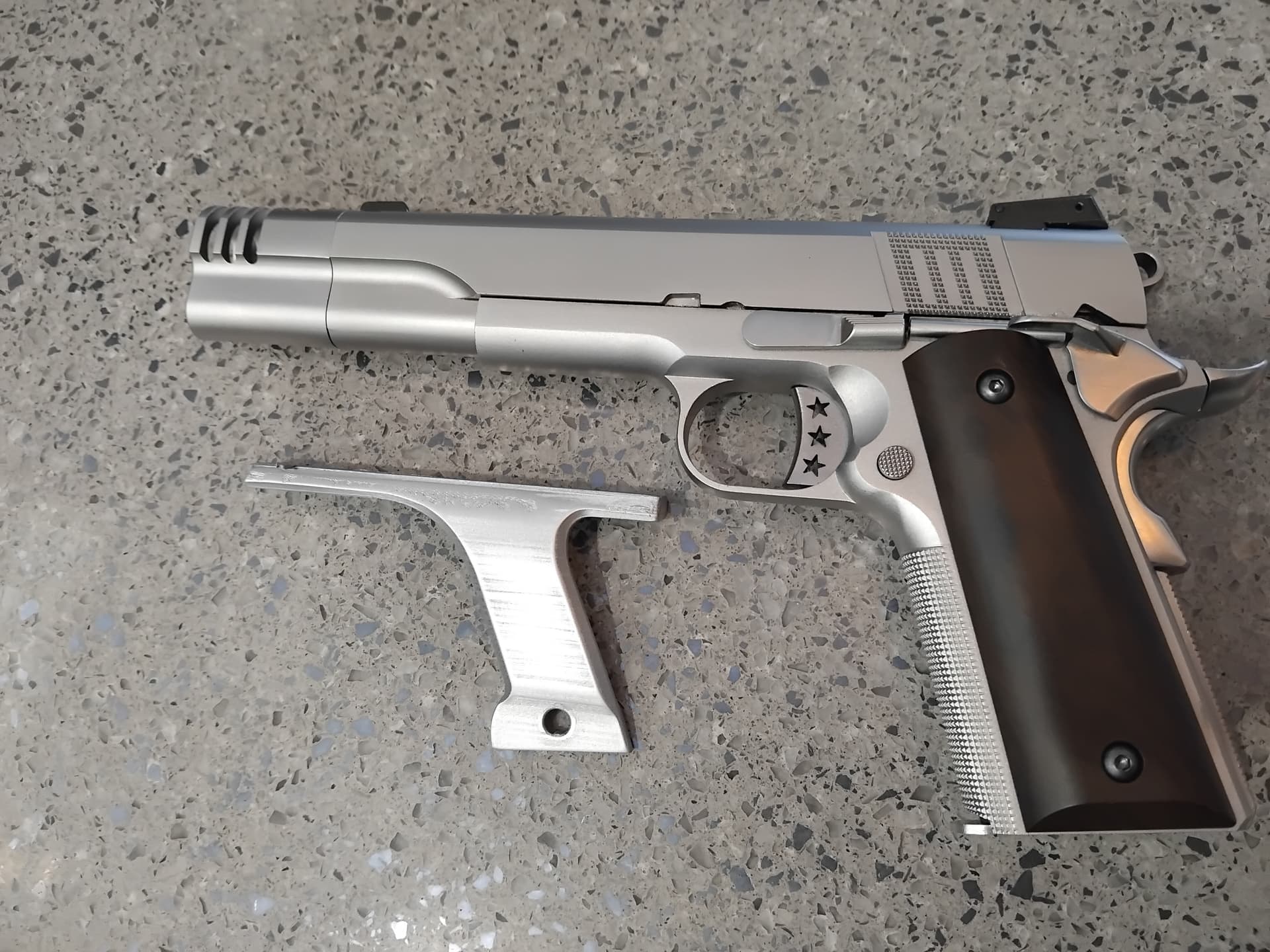

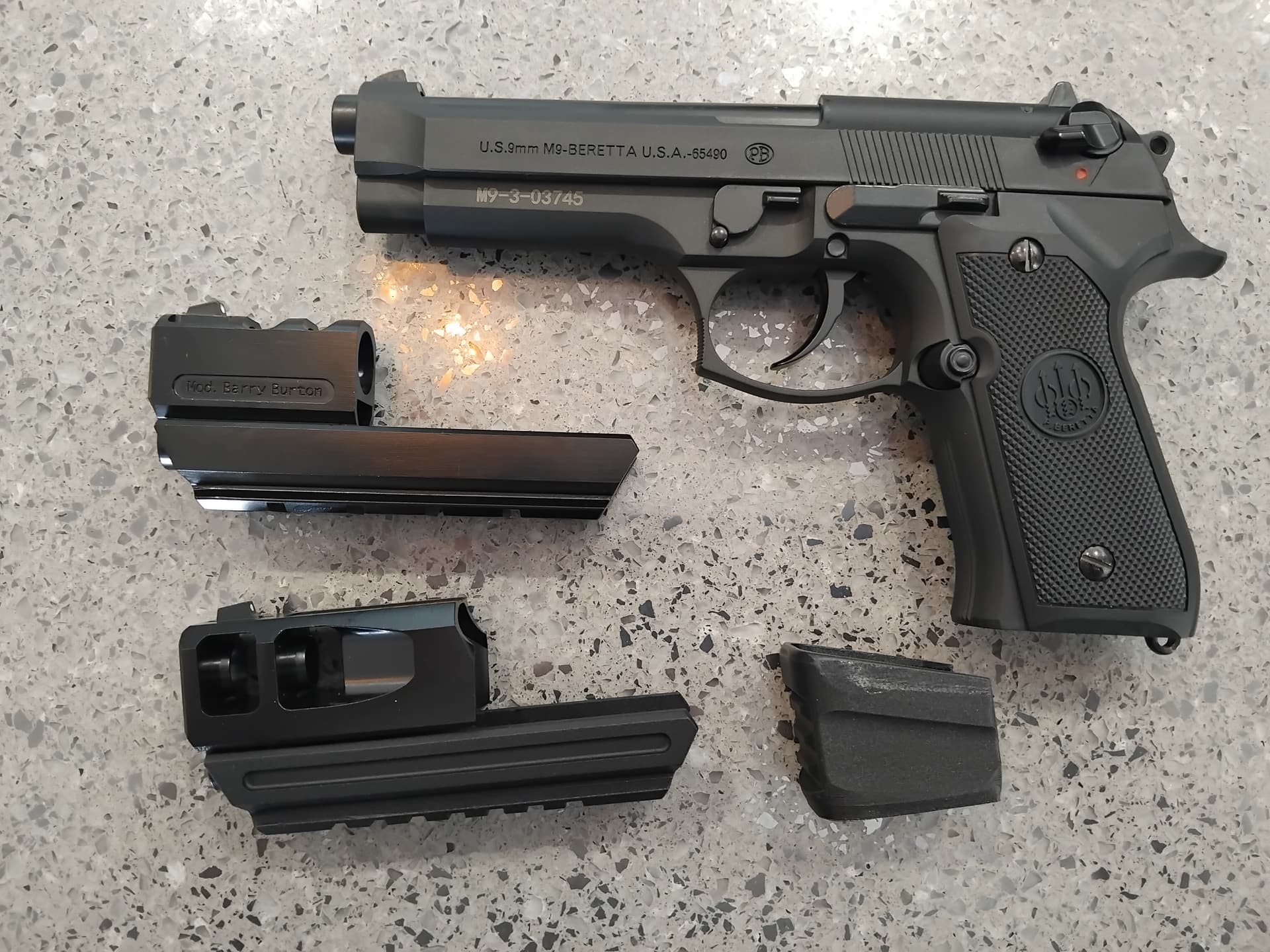

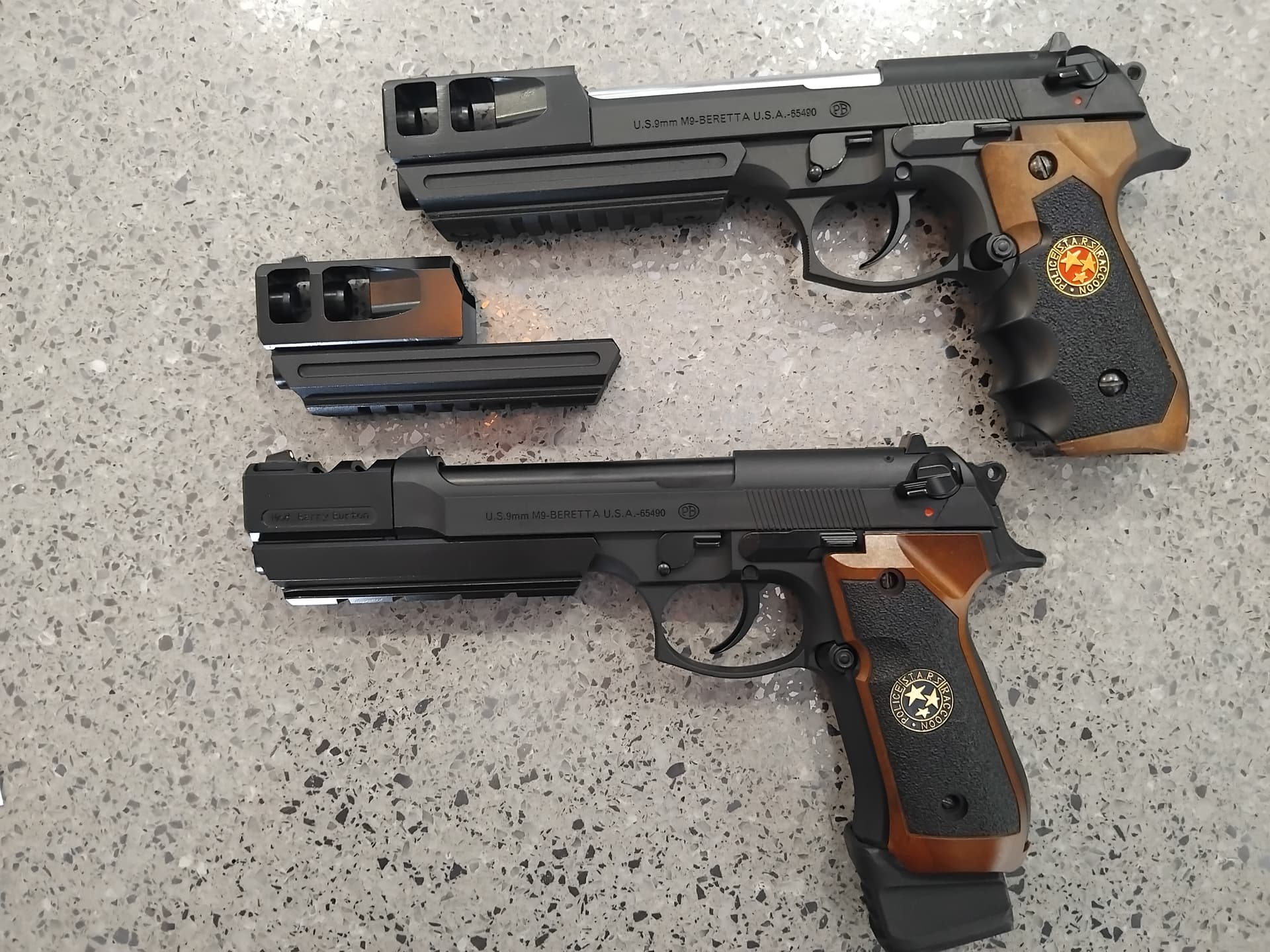

Gen1 Burton bits arrived ( and another set of gen 2 bits)…
I have my elec gen 2 burton…time to make a gen 1 burton as well…
Quick mock up, and comparo with gen 2
Gen1 hasn’t been drilled out yet / barrel needs polishing…
Gen 1 is a much sleeker look, than gen 2…
Dare i brave FB marketplace, and try to get some good coin, for my unique , one of a kind , gen2 burton.?.?

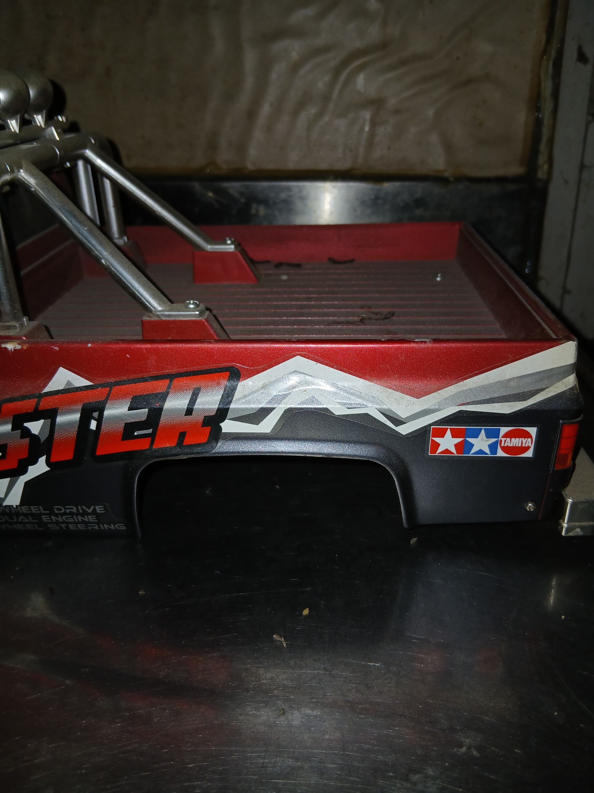

Tamiya silver or gunmetal would completely cover that dark plastic without a primer.
I’ve gone straight onto black plastic and metal… onto black with light primer too… couldn’t see any difference in the end result, same colour.
I reckon it’d look schmick in gunmetal… slight blueish tinge to it. :person_shrugging:
That’s what I love about Tamiya lacquers. :blush::+1:
hmmm…
might have to give it a try…
paint some dowel up first…
After the sanding…its a bit rough…
This is Tamiya TS-38 gunmetal grey on my cloddy. See what you think :man_shrugging:
Looks good.
A bit of trial and error, me thinks…
Thankfully, tamiya is cheap, so I can try a few different shades…
I taped it off to get the 2 tone going on I was after, modified the stickers to cover the join. About 6 coats I did to get depth, then applied stickers then I put 8 coats of clear TS-13 all over the stickers and everything for protection being a dirt bashing buggy it gets a bump and scrape here and there. It’s holding up well. Did that 10 years ago. :+1:

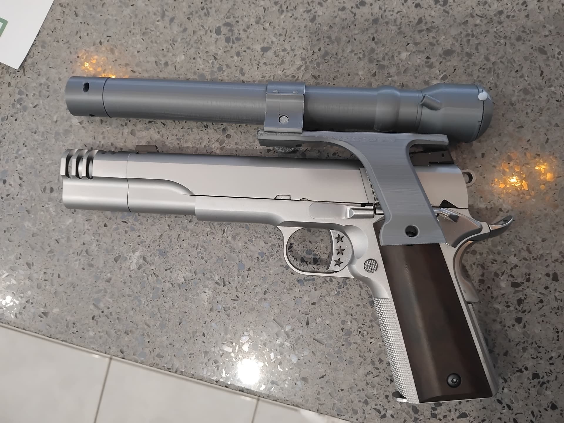

I’ll go for a close a match, as the base pistol as possible…
Might have to go to mr toys, whip it out, and check all the colours…!!

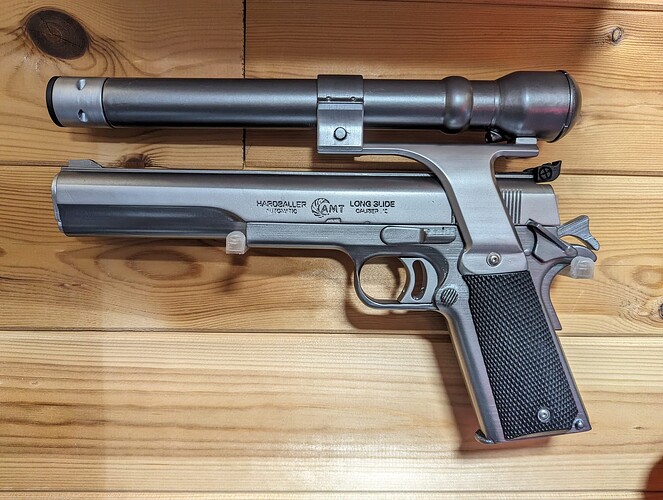

Tamiya TS-17 Gloss Aluminum will do the job since the gun should be sliver in the movie
Depending on how deep the layer lines re give it a light sanding first, I usually use like 240 or 120 depending on how much needs to come off, then a coat of filler primer and another light sand just to get any last crevasses.
I you’re using paint like Rust-Oleum, that bonds to PLA just fine so doesn’t actually need a primer.
Looking at the image the slide and laser body look pretty decent so shouldn’t need that much, going perpendicular to the layers will take more off then just ease off the pressure to get a smoother finish.
That mount looks bad though on the top part, can see where the printer got some made wobbles or extrusion problems, can tell that was the bottom side too with excess brim, that can just be cut off with a blade.
I would use ABS or PETG instead of PLA. PLA and that scope is likely to look like a banana if you accidentally leave it in the sun on a warm day.
i didnt print it…
just got it, as a kit from ebay…
no choice in the materials, unless i contact the maker, and ask for a special run.
this is a cheapy.
I’ll treat it as a test run, and see how i go…
Ok…
did a bit of sanding on the mount, and used the last of my avail TS-17…
It came up ok, but was a bit " light and shiny" looking.
I let it dry for awhile, and put on a light coat of ‘Tamiya Smoke’ …
Thats looking better…
A bit darker, aged look and not so shiny and new…
Those lines are still there though… what can you do, to get the laser looking better.?
The lines could do with a bit more sanding but there’s not much you can do about those chunky bits on the top, you could in use some modelers putty and fill them in and sand back but the marks might not be deep enough for that.

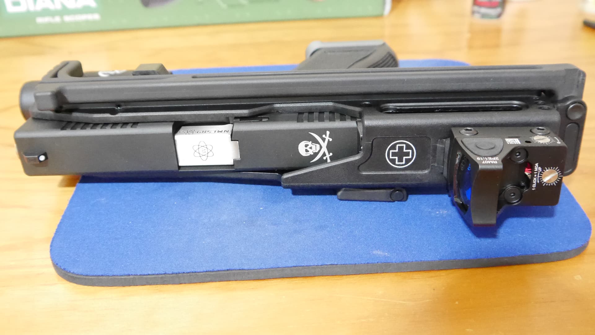

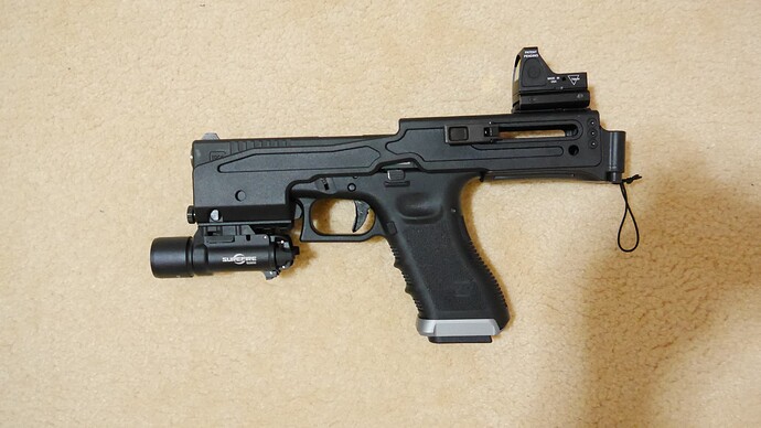

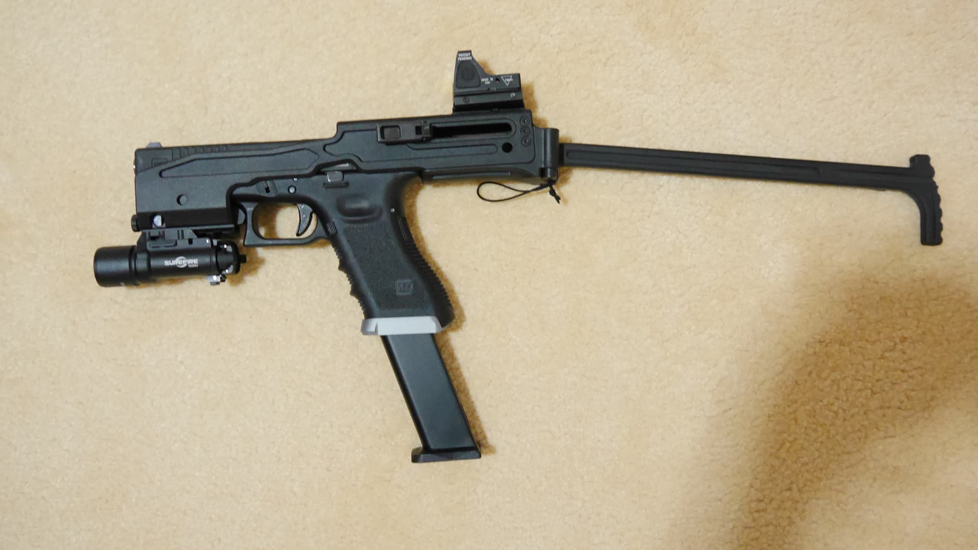

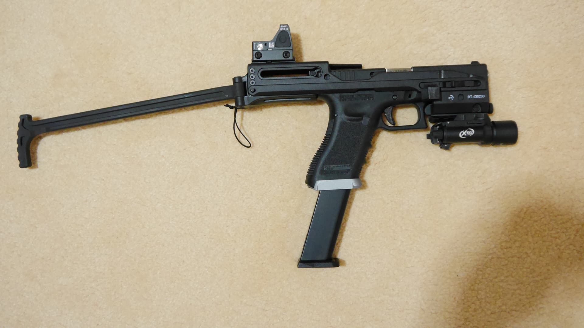

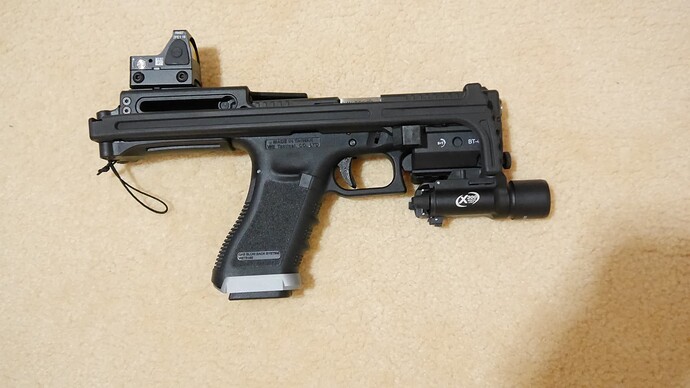

My USW G17 conversion kit
Normal G17
with the kit become a carbine
folded stock, short mag
unfolded, long mag
link to the product

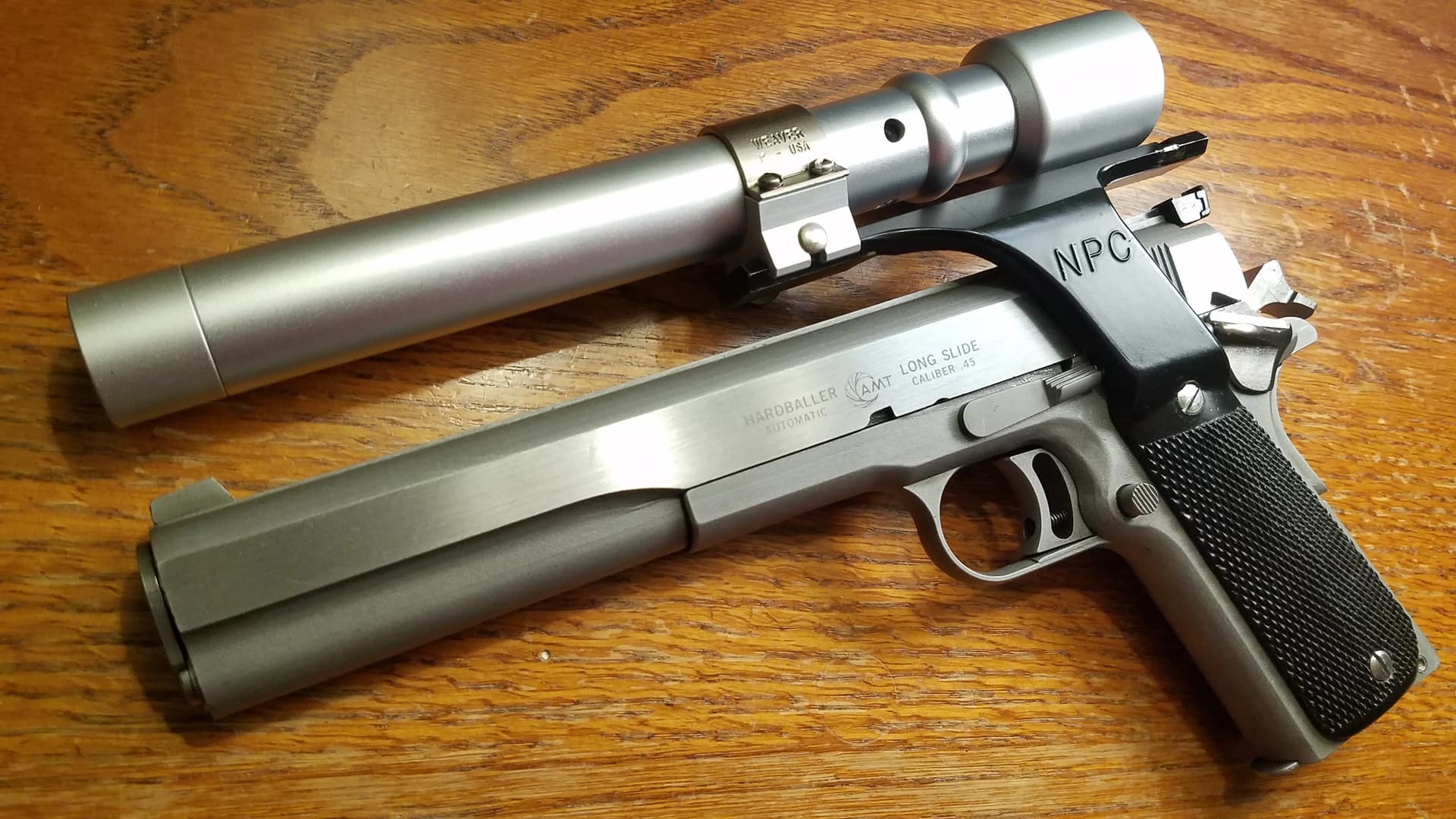

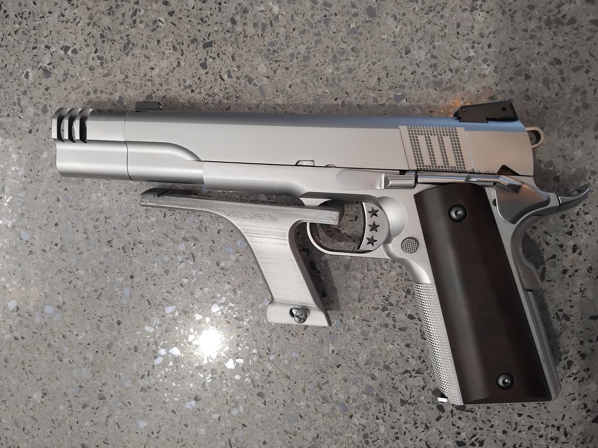

Ok… Arnie Update…
I sanded the mount plate, to get rid of the lines.
Pretty aggressive…marks on upper already, it’ll never be pristine, so practise time…
120 … 400 wet/dry , then 600, then 1200.
It came up pretty good.

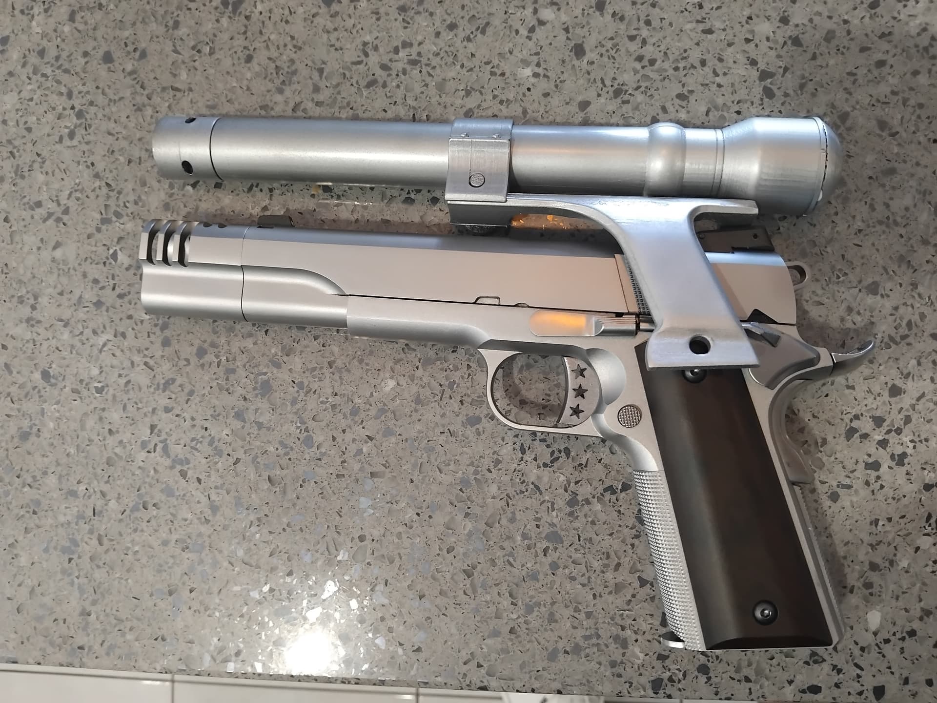

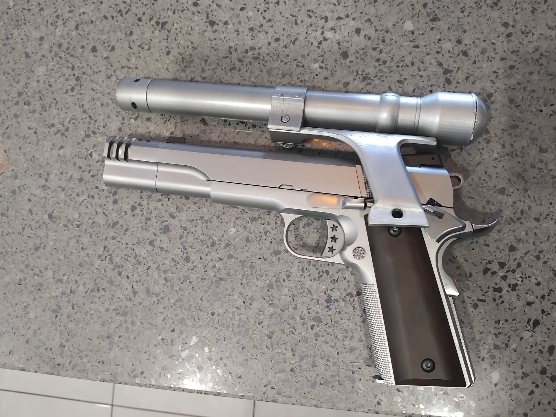

Same technique on the body of the fake laser .
That came up mostly smooth, with a few deep scratches.
Painted up with TS-17 Silver, and a light coat of smoke.
This is only a mock up.
Will need to take the rear sight off, to get it to fit properly.
Fettling reqd, to align properly and glue in.
Colour is a reasonable/ acceptable match.
maybe a touch more smoke, to darken it slightly…
50 shades of silver…
Hi Ho silver away…!!! ( when smoke does its thing!!)
Laser is a little loose in the mount, maybe some masking tape on the inside to firm it up. ( Giggitty!!)
Then, see how it attaches over the factory mount.
The kit includes a cut down set of grips, if you want to lose the top 1/3 of the left grips.
Let the paint dry, then glue it up…
