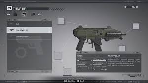

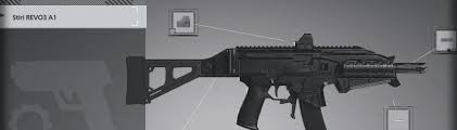

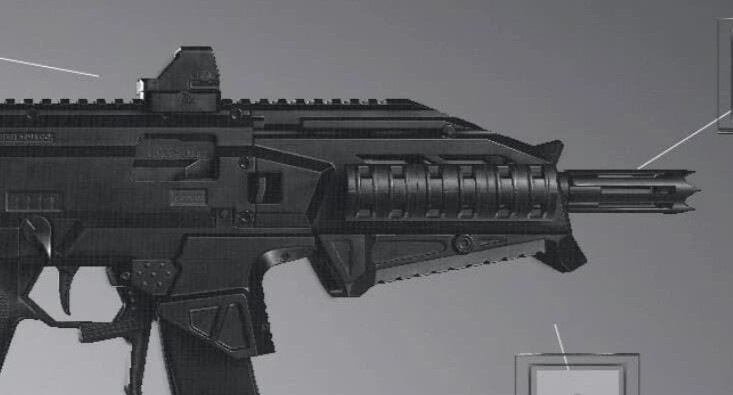

you upgrade it in the game, red dot, stock, etc etc
Hmmmmm…ambitious much.??

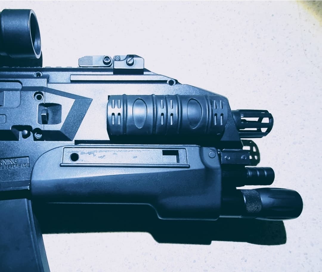

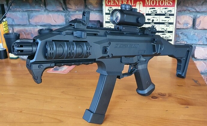

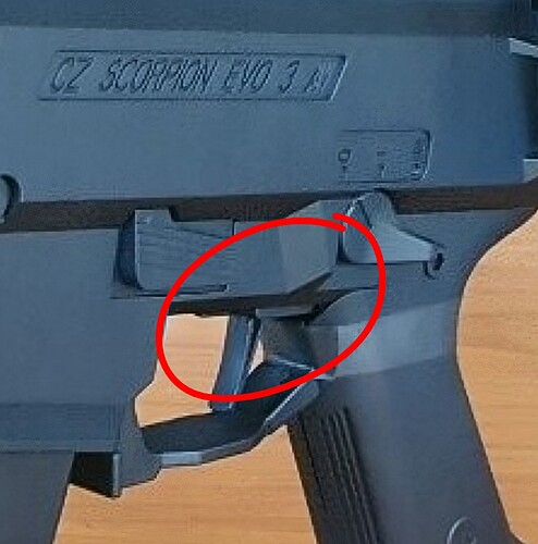

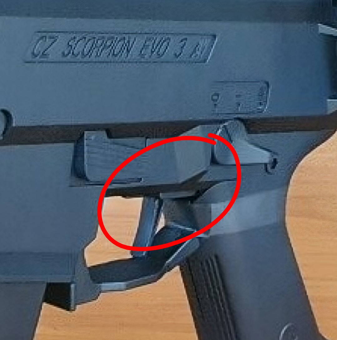

The problem you’re going to have with fitting an ACR box or any box with fire select is figuring out how to engage a select lever… why I went Gen 8 cos I’m a lazy bastard. :wink: The proprietry Le Hui box is early Gen and doesn’t use a selector plate to shift firing options.
Lots of shell clearing required and the bottom of the box ends up hanging out into the trigger guard area which means custom trigger. A shortened metal Gen 8 does the trick.
You will lose some screws on the clamshell, especially around the grip area, I just used cloth tape wrapped around it to secure it, worked fine.
No functional safety either… so I wired an on/off switch to the stock block so I don’t accidentally take someones eye out with it. :grin:

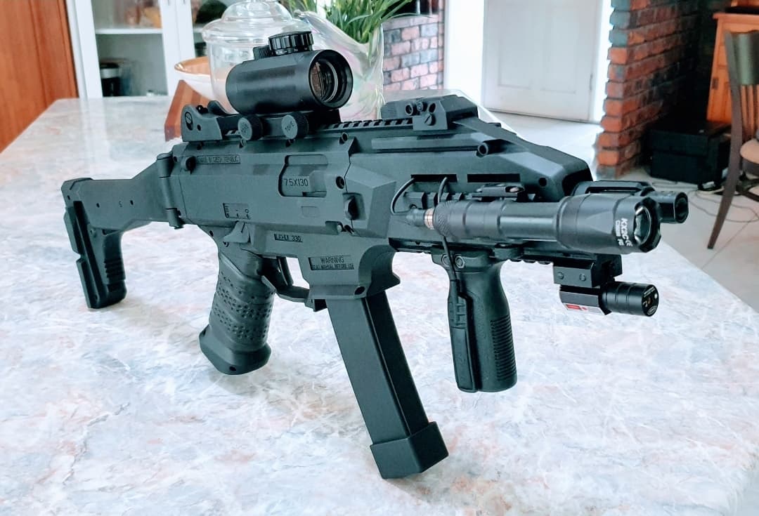

But it was worth all that, I’m a huge CZ fanboy and the snappy trigger with a red Chi Hai is mint, forward wire it and run a big 3S lipo in the front and you’ll shit your jammies when you pull the trigger. :rofl:

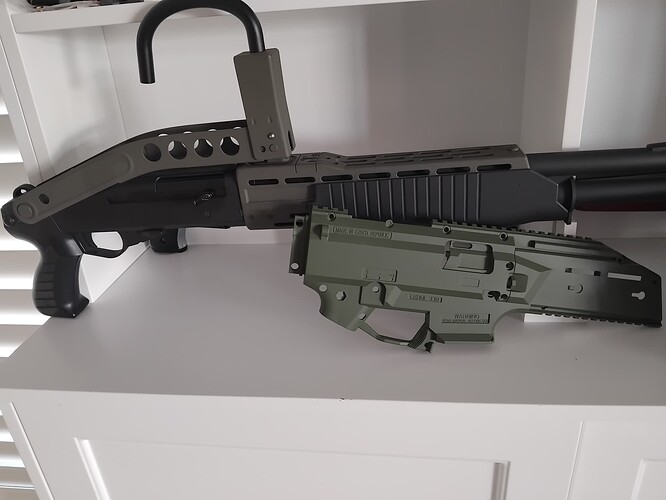

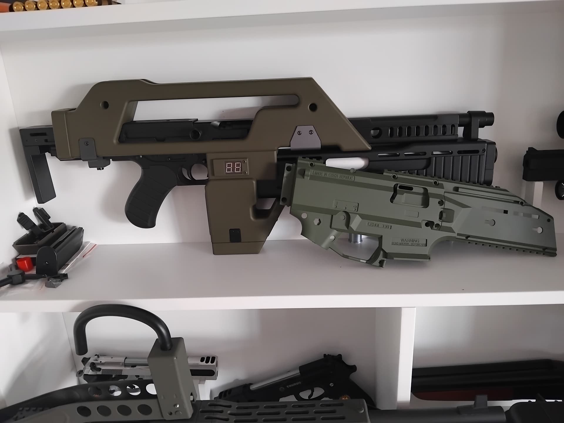

I mean, really… get the paint right and it’s just dead sexy… three different configs, the bottom pic showing the modified MP5 handguard that houses the big mofo lipo.

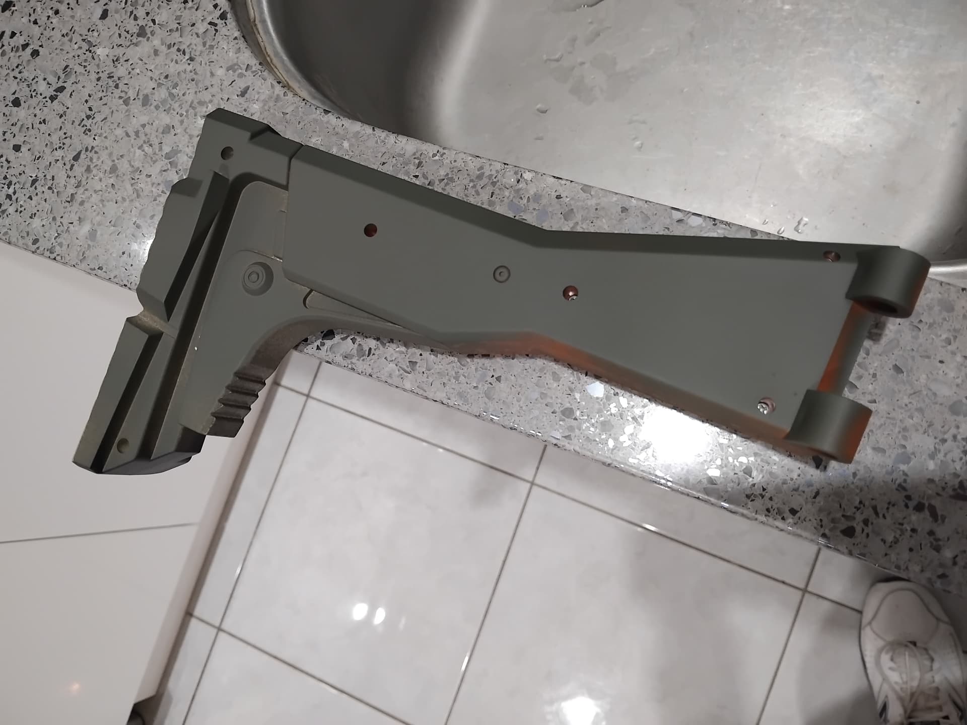

If i want the swivel stock to fit, i’ll have to destroy one…
it looks like you cant buy them seperately anymore… have to look 2nd hand.

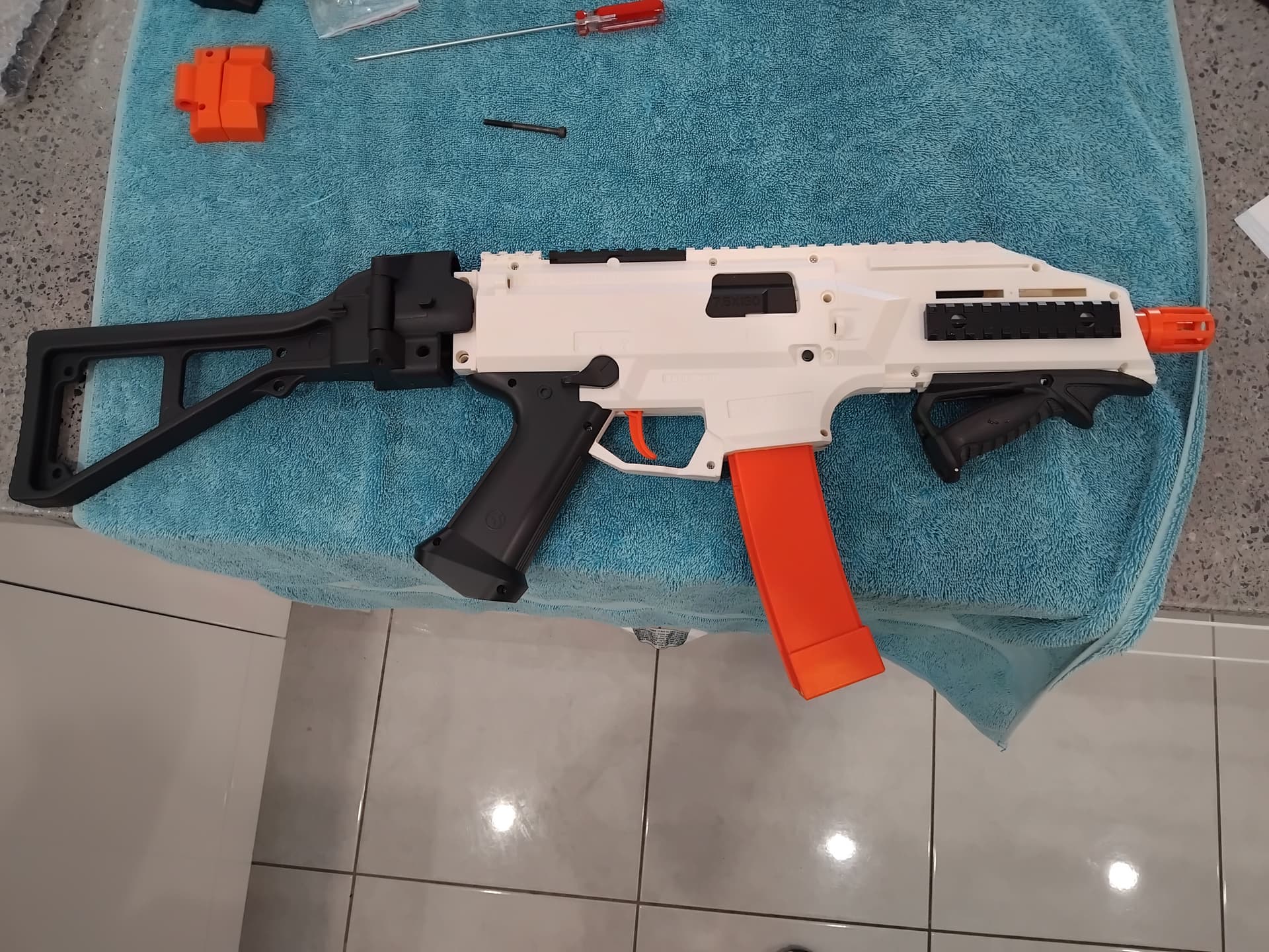

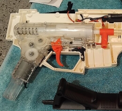

progress…

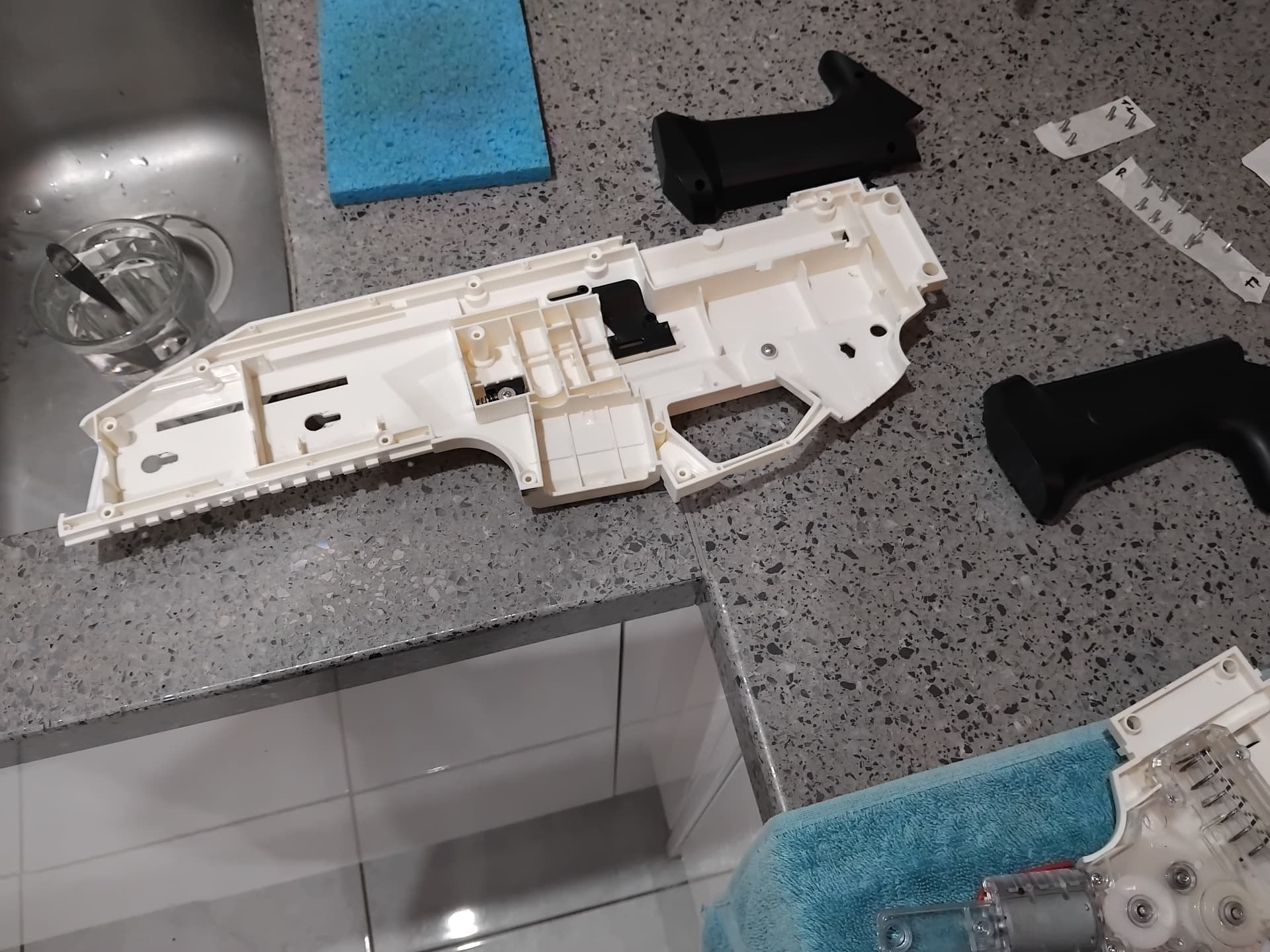

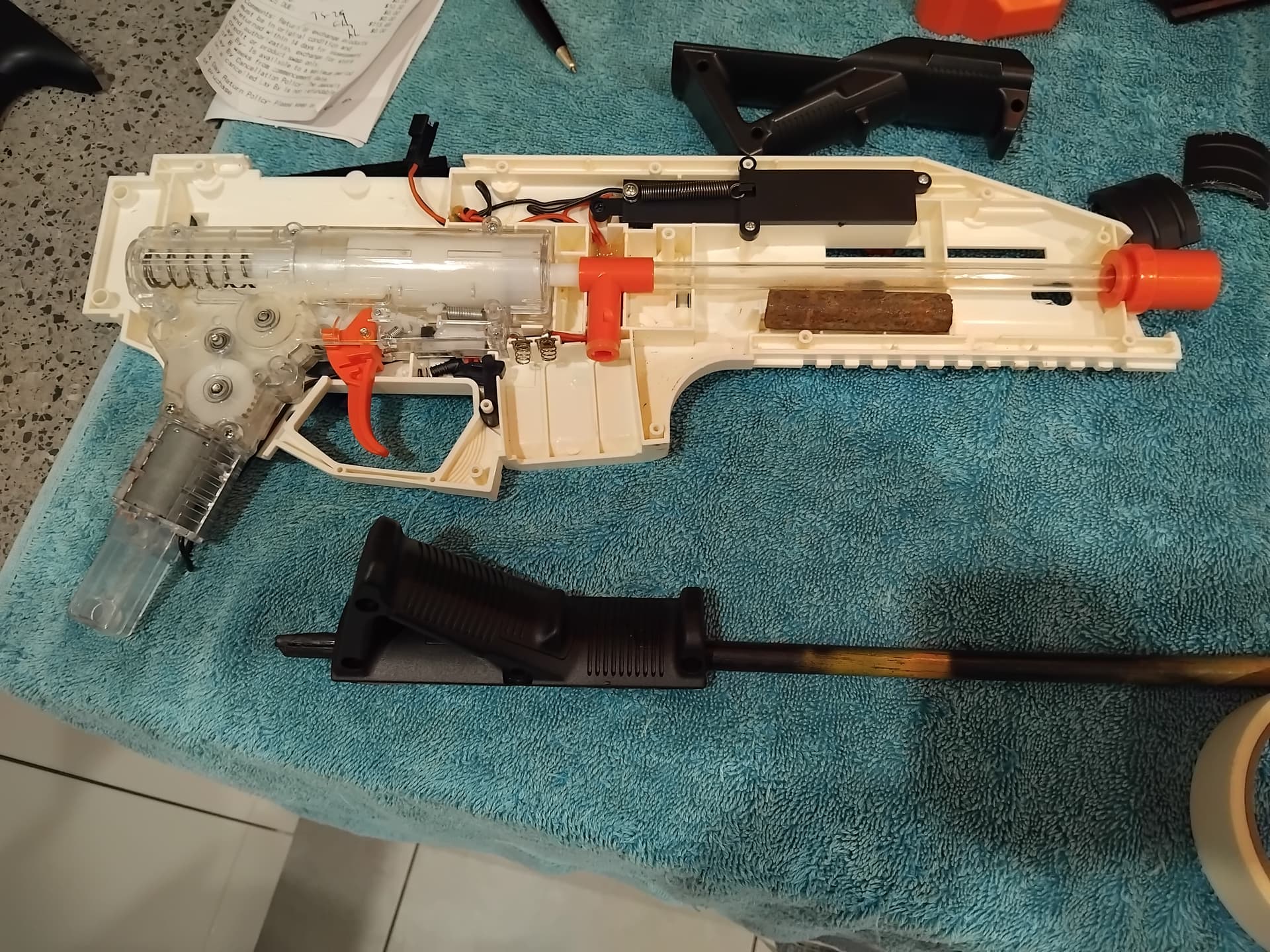

Pulled apart.
That is one janky gaerbox…as you’d expect , on a $100 blaster…!!
@Friendly_Fire …which spring did you use as un upgrade.?
I would’nt go M100… Did you use M90 or M95.??

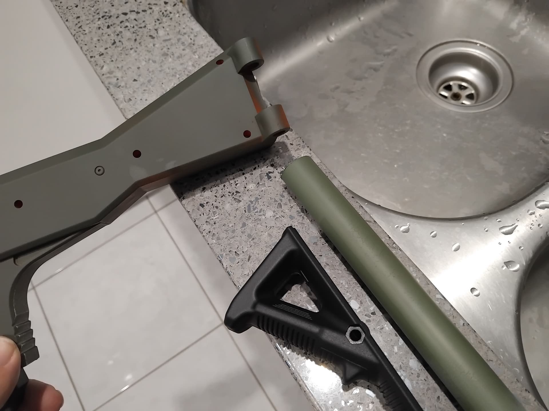

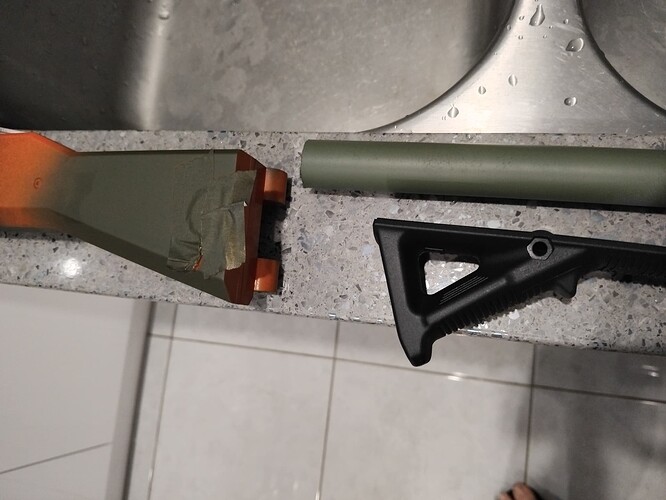

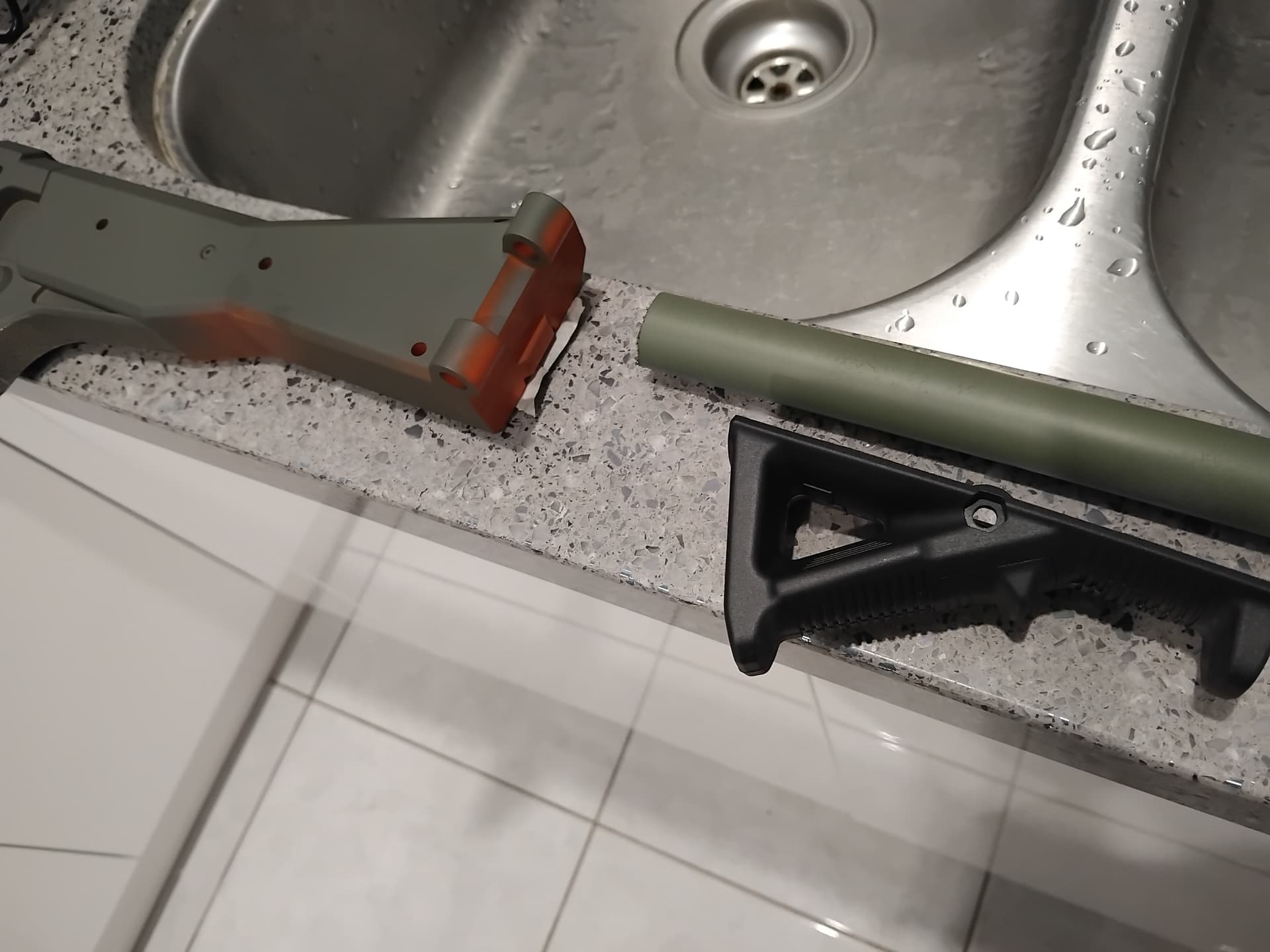

Shells pulled apart, washed and primed.
So…greens…
The pvc pipe is in NATO green.
the other is rustoleum camo / Tamiya equivalent.
Hmmm…not really sure…
Rustoleum is a ‘browner’ green, NATO is a ‘greener’ green.
The pics of the game blaster, are sort of inbetween the two…but greenish.

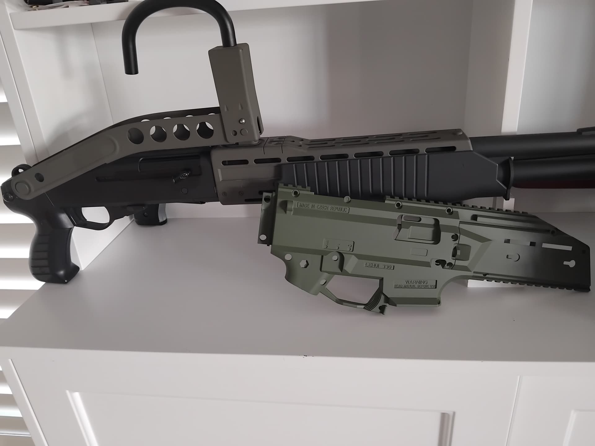

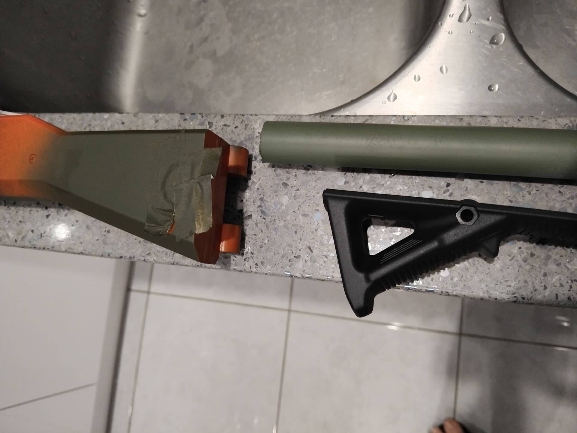

Went for NATO green, as a trial.
Everythings painted up, and drying.
A few hours in th sun, and its touch dry…comparo time…
NATO vs PR…
definitely a lighter green…
NATO VS RUSTOLEUM CAMO GREEN
It really makes the other greens, look brown…
Still, its quite a pronounced green in the game, so…
If i was going to change it, this is the colour i’d go for.
Still, i’ll let it dry overnight, then put some Matte Clear Coat on.
This will darken the green, and make it a bit less shiny.
The semi gloss black switches, should get it popping…

M90 on the upgrade spring.
That stock gearbox produced 280FPS with an o ring and spring change. Not too shabby for an early gen offering. :+1:
no quick change access port at the rear , either…
whole gearbox apart, to get to the spring…
SPROING…!!

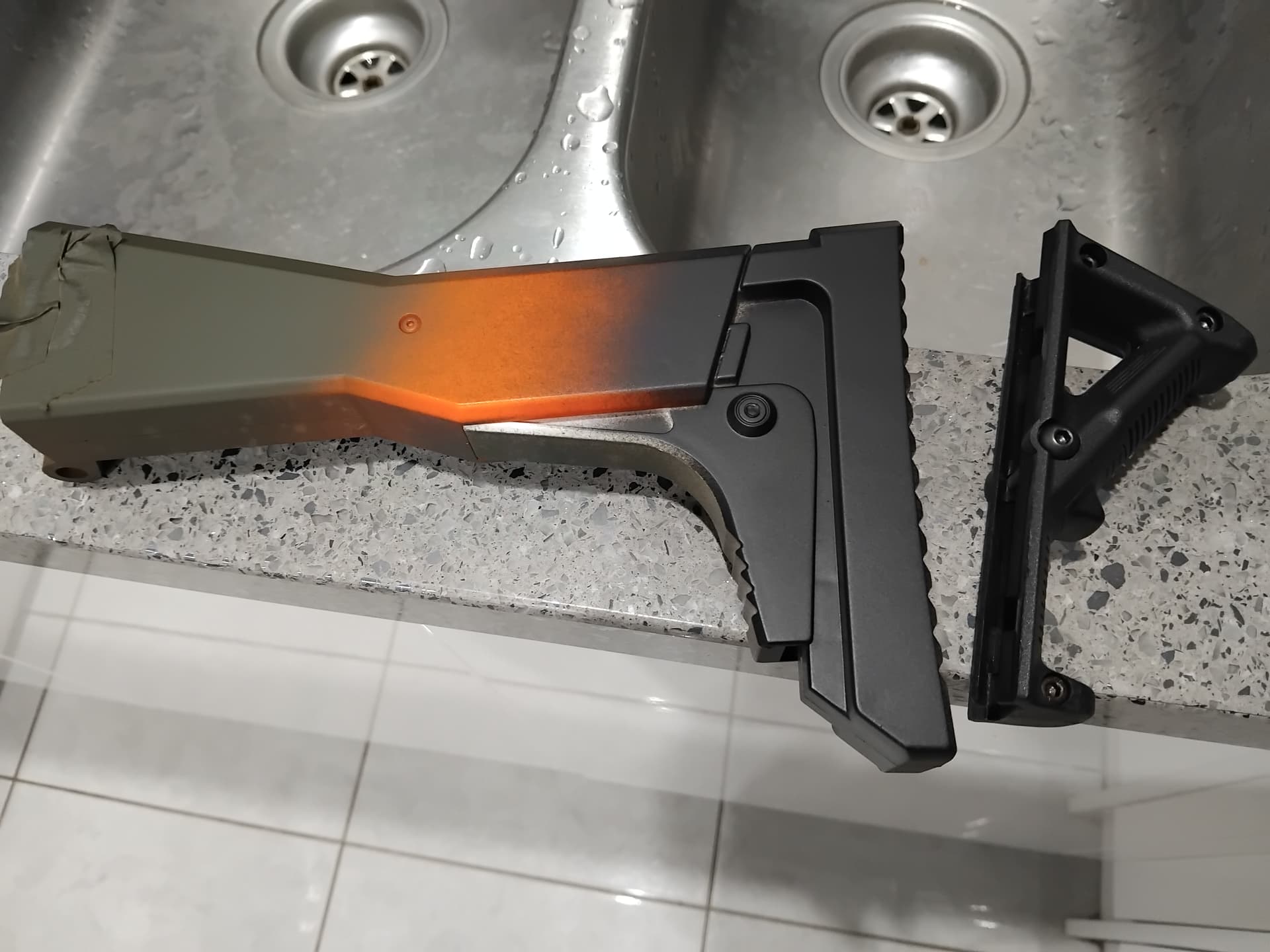

I’m not looking forward to massacring that mp5 stock…
Maiphuts grinder will make an appearance…!

Have you opened up the gearbox already?
If you haven’t, I’d advise against it… getting it closed up’s a bit tricky… things you’d need to know.
@shadow187 recently worked on the same gearbox and found it fun… :rofl: Look familiar?
Screenshot_20260515_131632_Chrome
Which blaster was that, Shadow?
