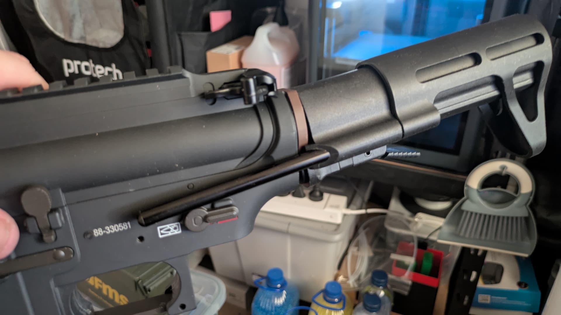

Woke up the printers, made a rifle to bullpup conversion kit
used wood scres to test fitment, need to order heat set inserts eventualy.
Do love having a #D printer, especially in this hobby.

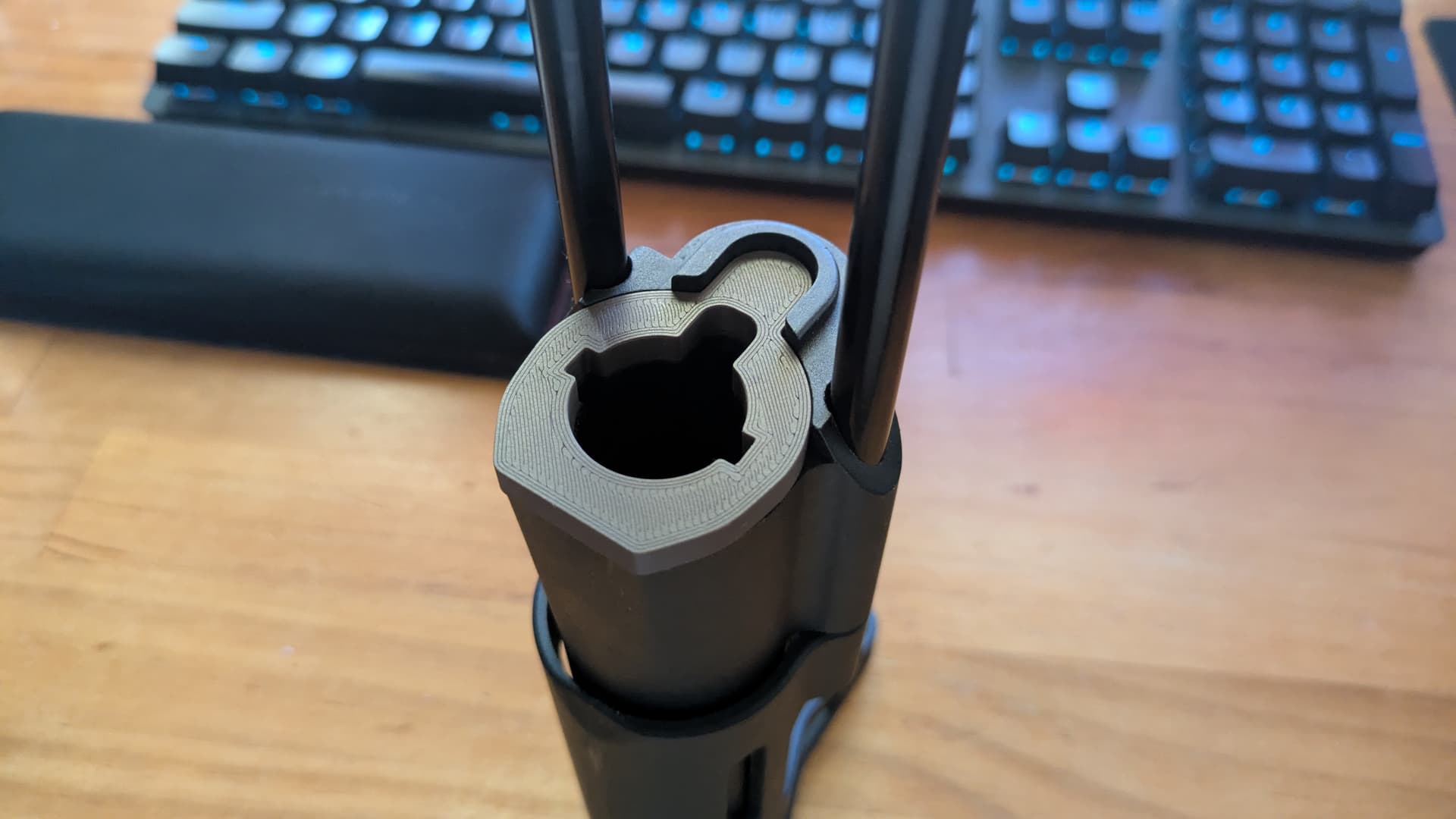

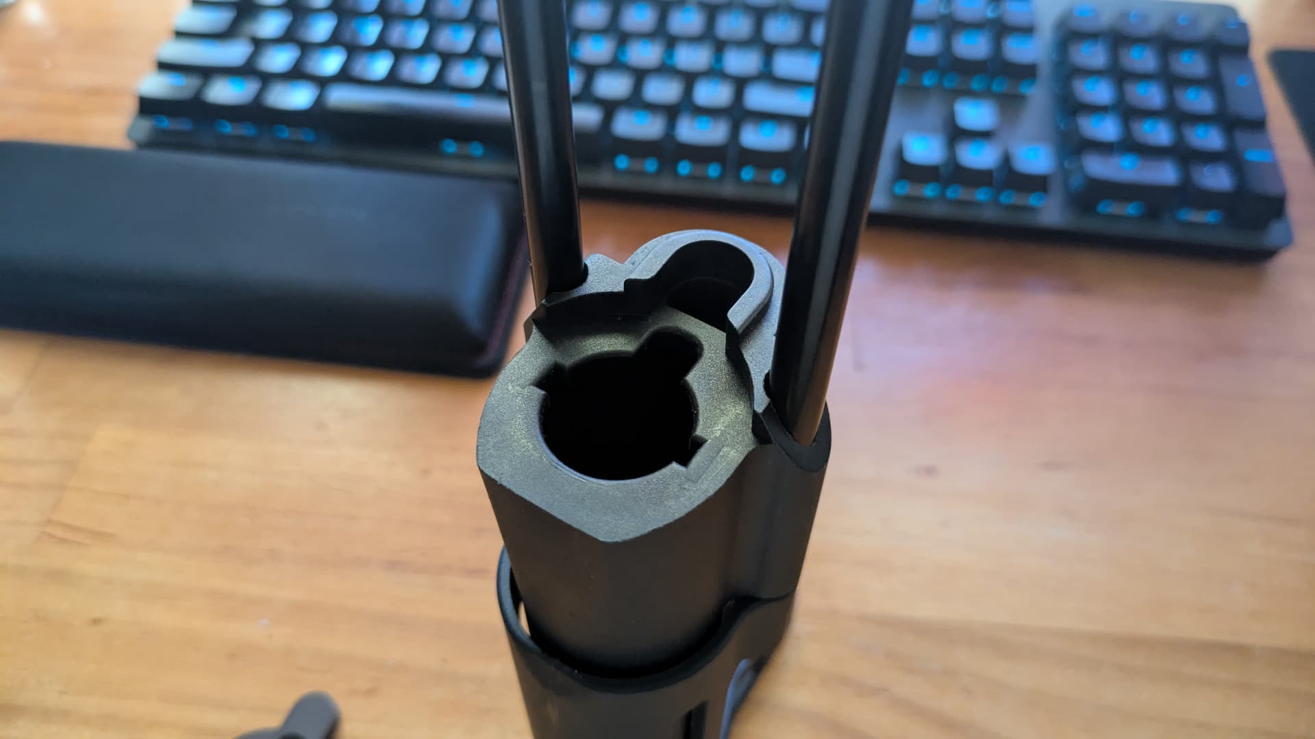

Was missing the plate on a CQC stock, problem solvered, took less than an hour and it’s a 99% match to the profile.
Shame I didn’t fully check the blaster I wanted to put it on in that it doesn’t fit anyway…
I’ve done the same thing for that stock!
And also discovered that the receiver needs a little scalloping to fit it!
