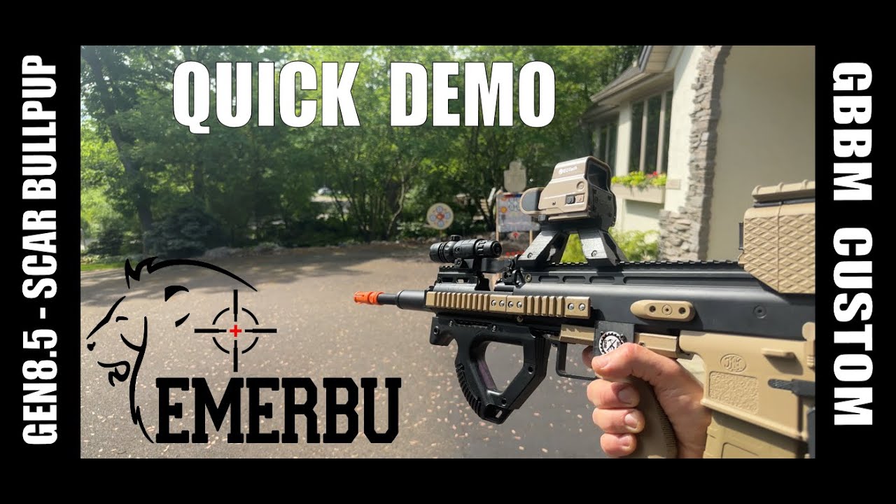

Then there’s this guy in the states that built a bullpup SCAR… ![]()
