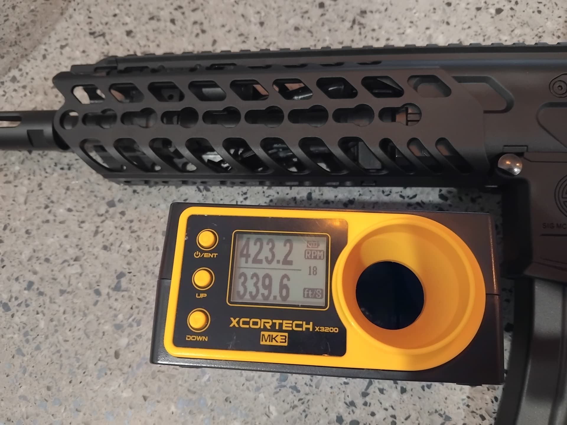

Can i have a build, that DOESN’T do 340 fps.?.?!
:crazy_face: :crazy_face: :smiley:

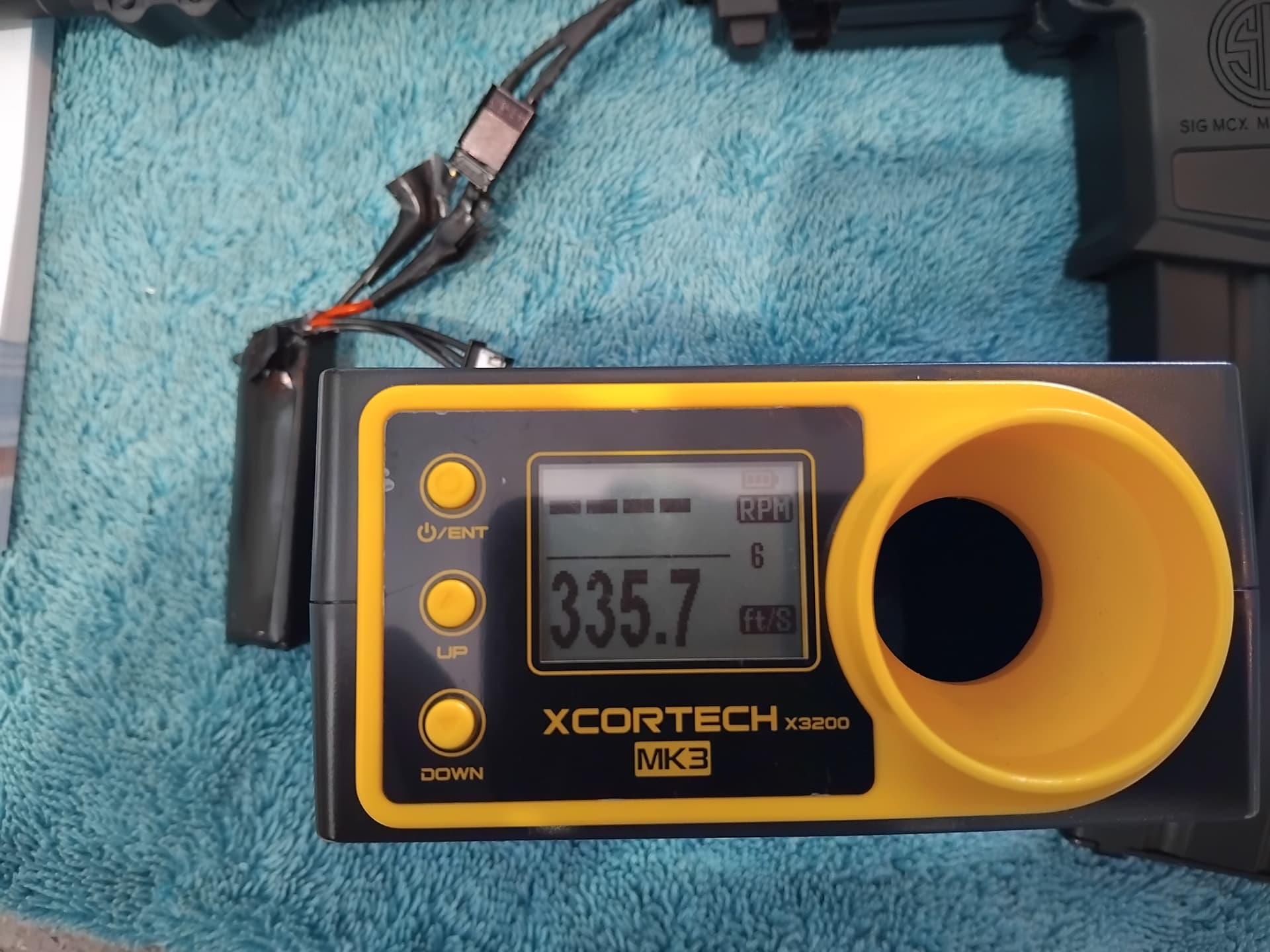

335 fps, out of a short barreled
M95…it must have great seals…!!
Cycles much more comfortably, too…
what a surprise…!!
Solid performer.!
Of course, it has the high fps innacuracy.
it did 260-270 stock out of its puny spring…i may try a M90 to see what it does.

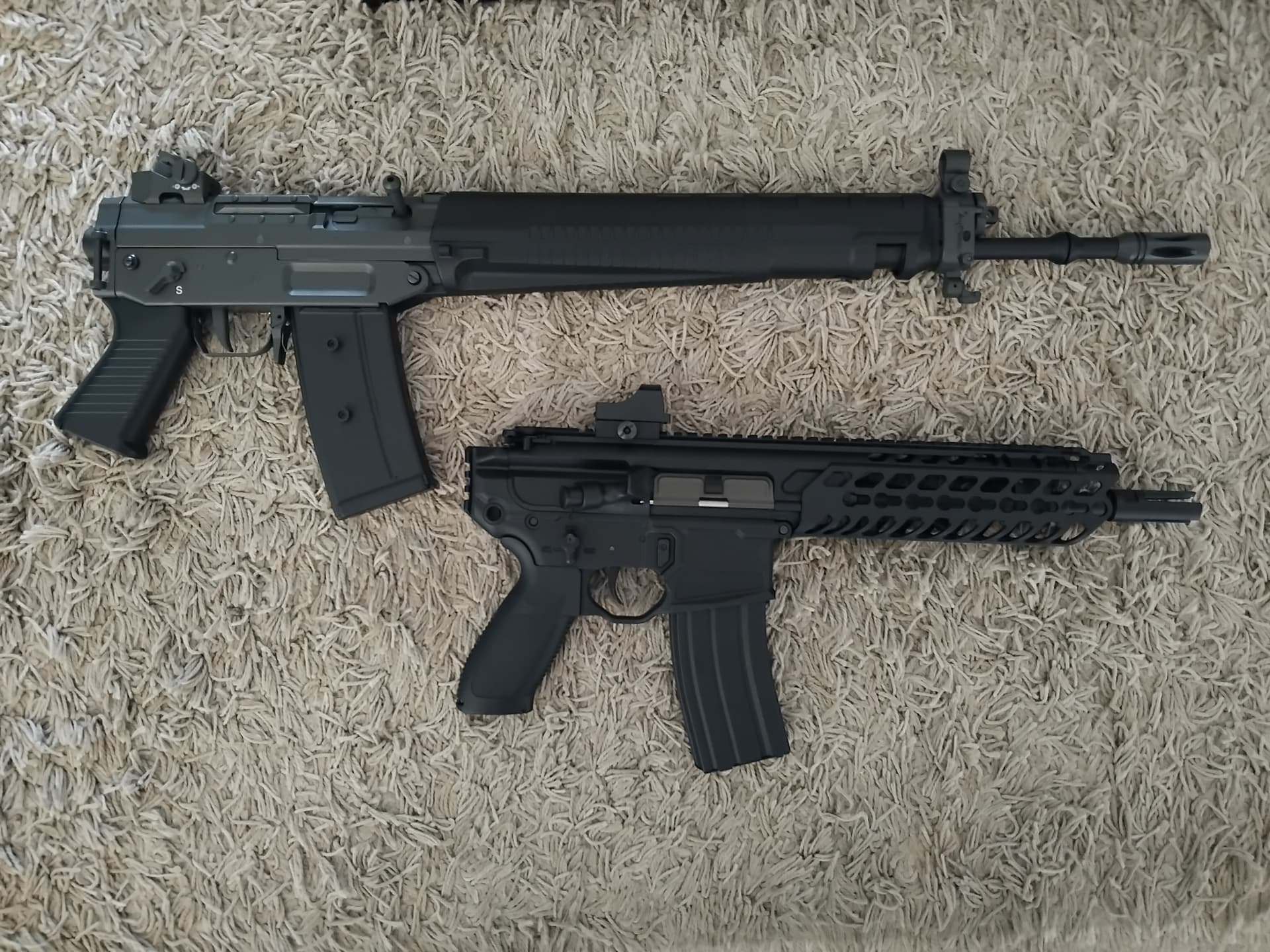

Also, trying the Full Nekkid look…

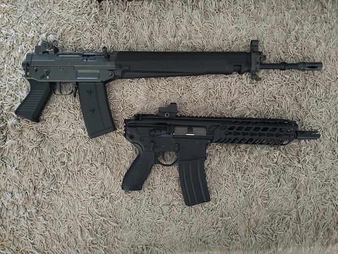

Very compact like this…just compare it to the 550…
Makes it look like a pistol…!! :rofl: :rofl:

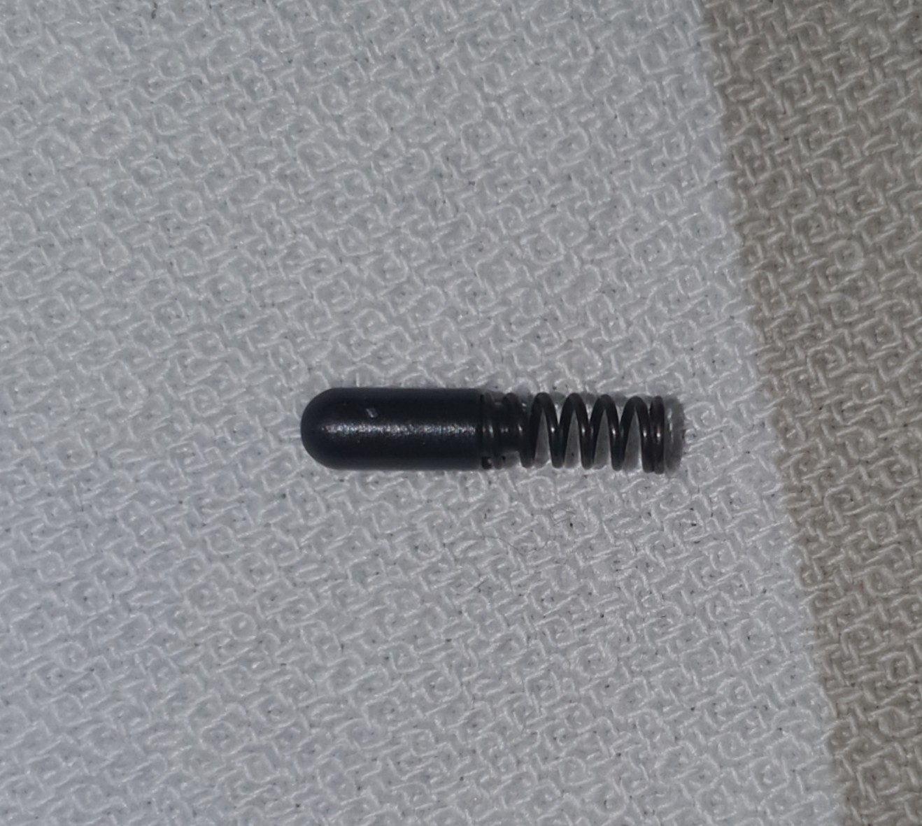

Except for that one detent pin and spring… :rofl::rofl:

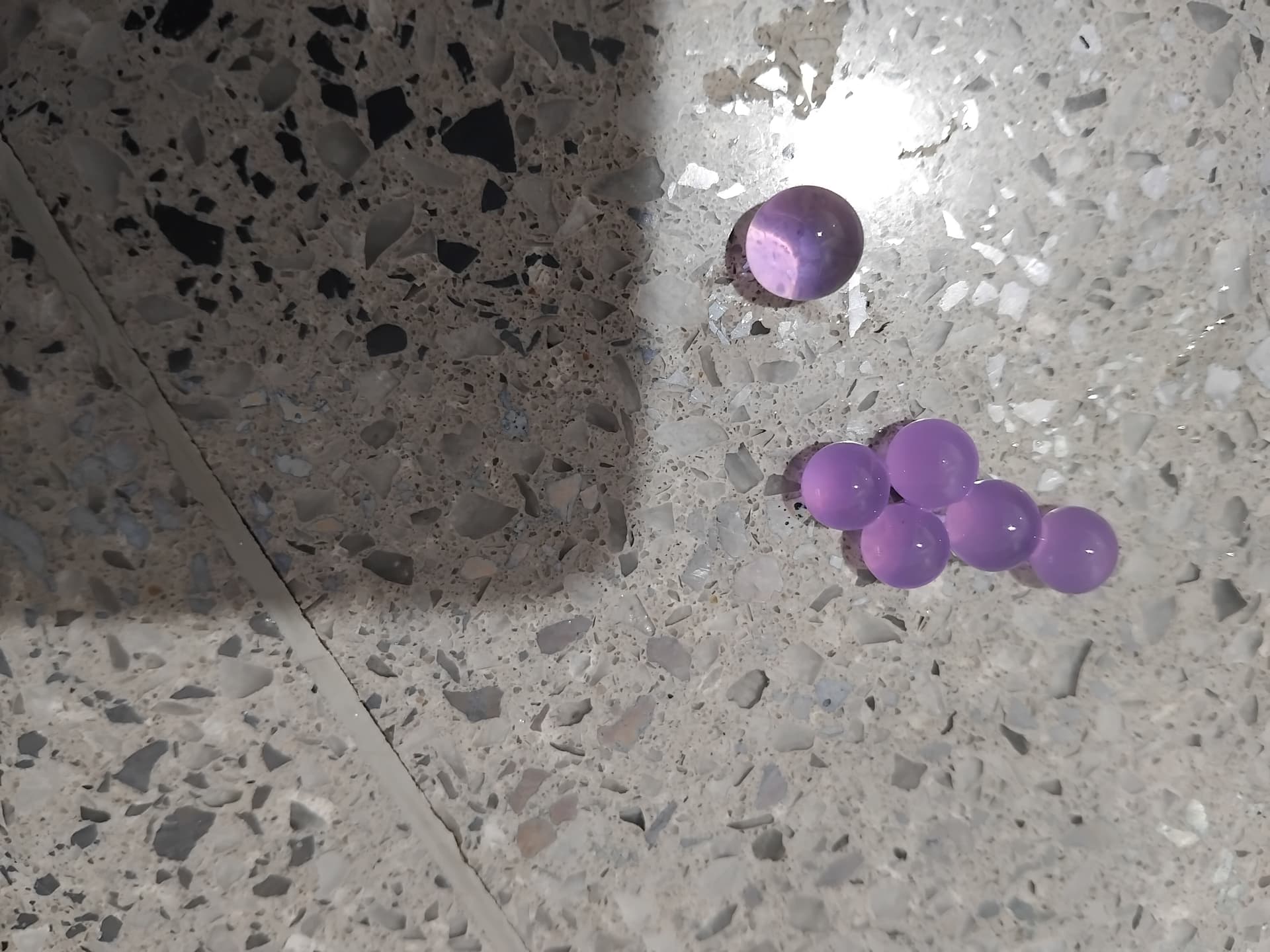

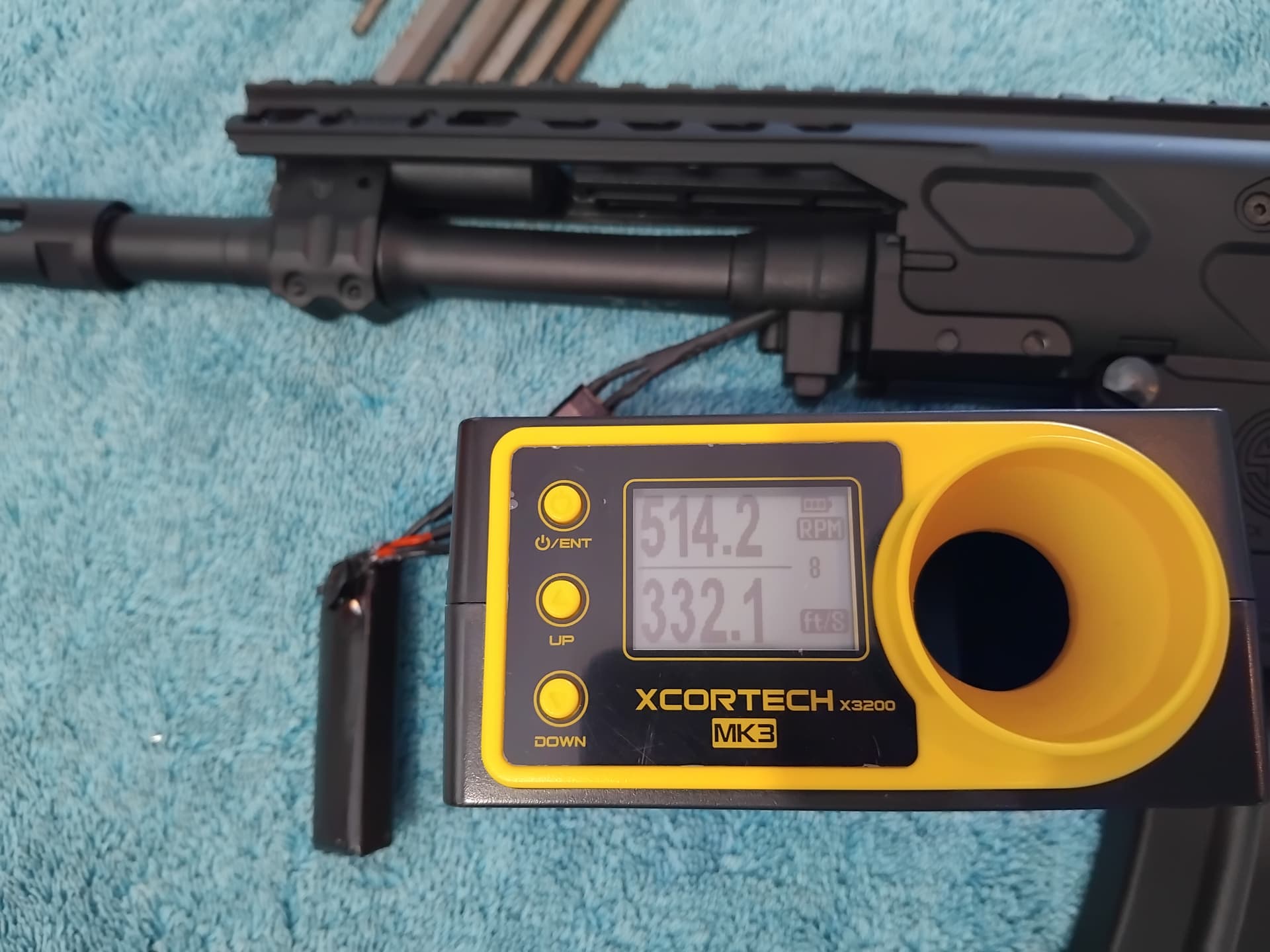

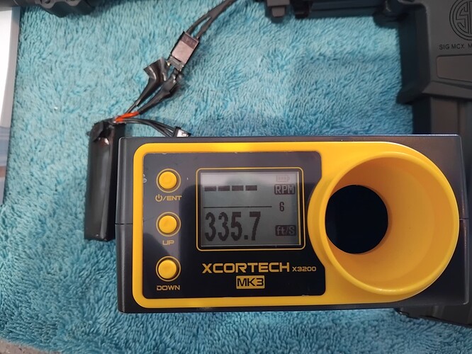

I tried using some smaller gels, hoping for lower fps…
Nope…just Increased the average…!!
This thing is a beast…!!
Im impressed, for a M95 from a short barrel…

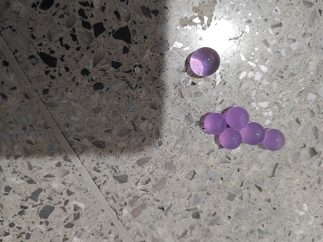

Also… gel drug testing…
"Before we send you off to compete, you need to submit to a drug test.
Anyone want to pull out…??! "
Its all due the mineralised water, i swear…!!
Always one freak…!

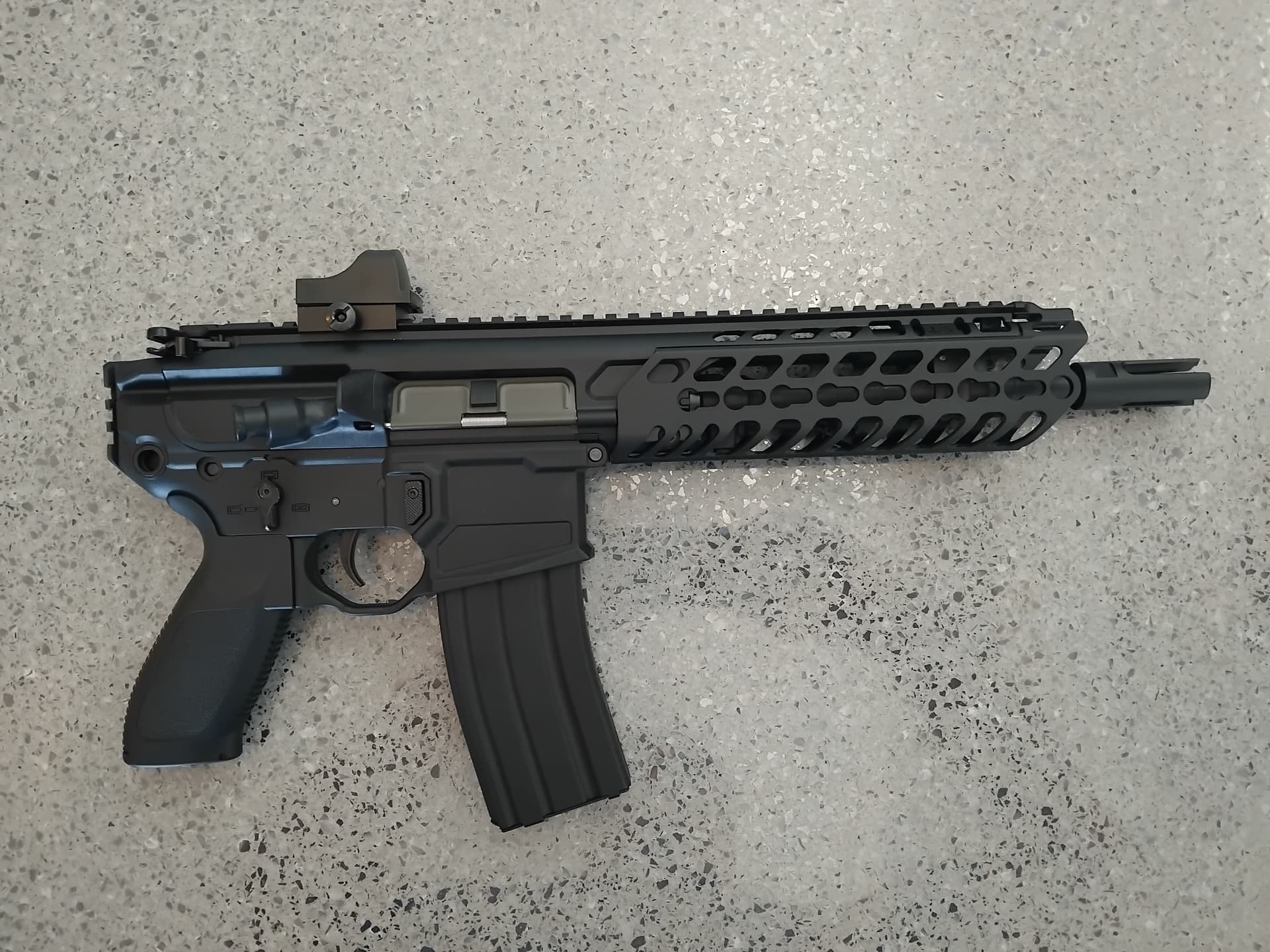

This was the LDT one I picked up second hand. Stock, has the bigrrr mosfet version ldx with tappetless head. Came with a bifrost tracer but not the stock muzzle and the sig Romeo. Good deal, very grateful I got on board 8 mins after it was posted for sale!
Does the expected 290-300fps you’d expect from the ldx equipped things.
But still more expensive than the LH which rocks out with just a spring!
And yes, not much battery space, and a pita the get in and out. I’ve added the grip that can pass through wires for a battery, just need to make an extension. Probably not going to do much with it, just bang it in the collection I think.
Looks the goods…!!
Much better equipment, mosfet, build quality etc etc…!!
I’m sure you’ll enjoy it.!
