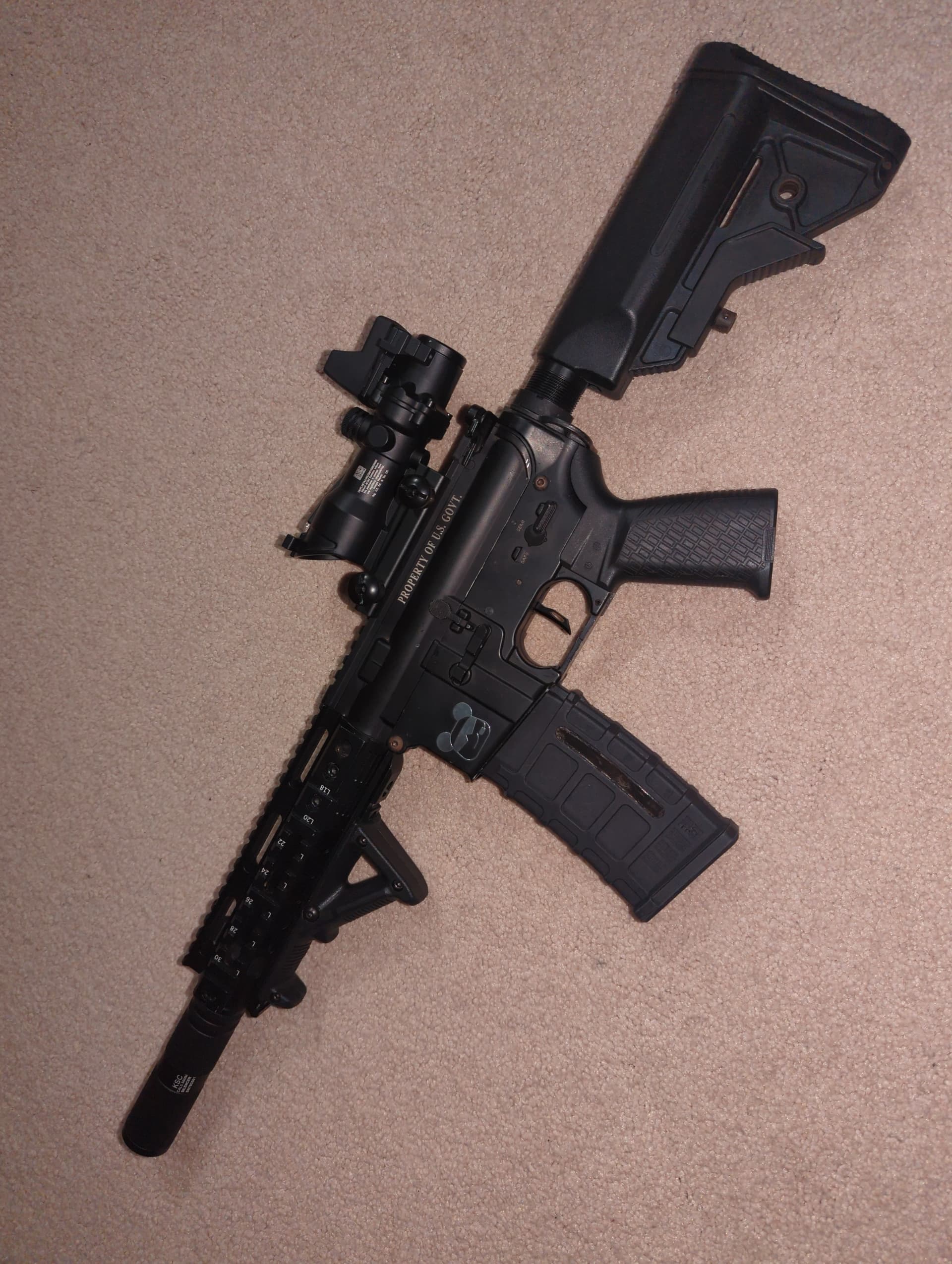

This is about as short as I can get an M4 and still keep it worth pulling the trigger.
Parts bin M4, CYMA metal box, chopped Noveske handguard. Xm177 moderator hiding a hopup, M4 buttstock, Aimpiont clone red dot, Inner barrel’s pretty short with the hopup finishing about halfway up the moderator vents so only hitting just over 230FPS as is with an M90 spring. Good enough for CQB and accurate.
Maybe slated for three teeth off the sector, cylinder porting, substantial spring upgrade, maybe M120 / M130, AOE correction / piston cushioning, should up the power a bit. I’ll be happy with 260ish.

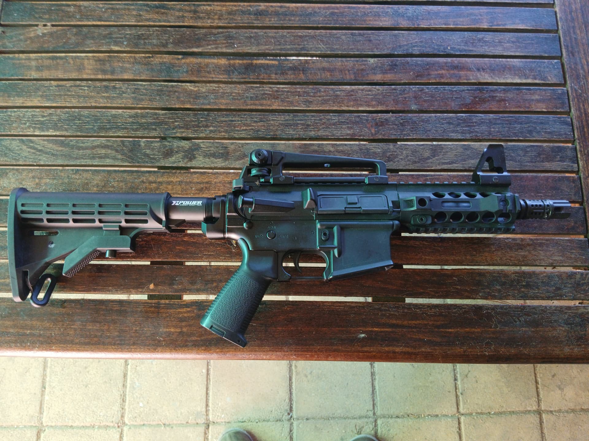

Unfortunately I don’t have any pictures of it, but built up a shortie M4 Gen8 that I forward wired and ran a PEQ Battery Box so I could run it sans Buttstock that ran an 110mm barrel… which was sorta restricted to what handguards were available at the time.
Was a fun little Machine Pistol basically and VERY short without any Stock fitted, but with the advantage of a decent sized Magazine capacity.:+1:
Ran around 230 FPS for memory.

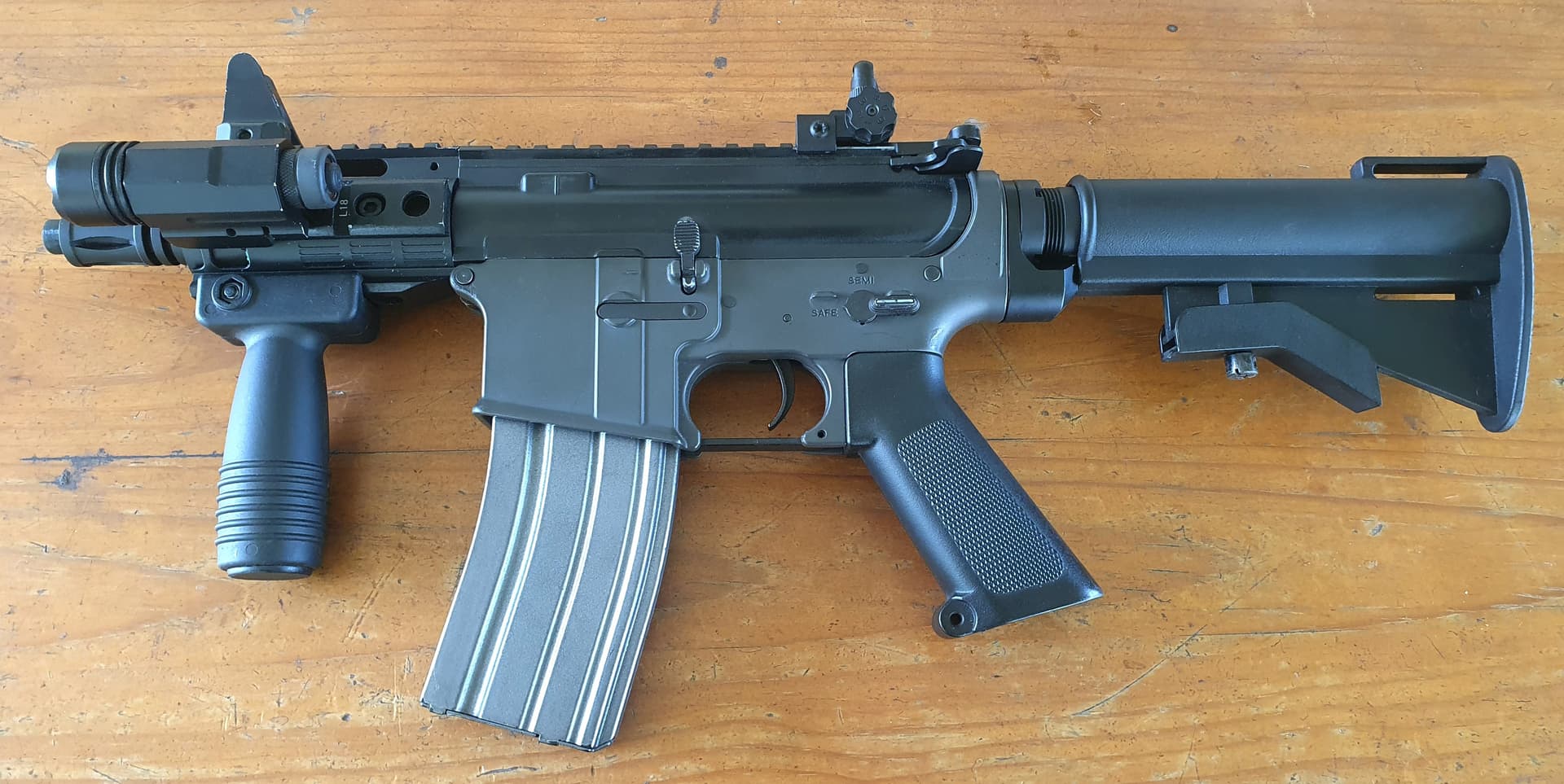

Nice. Everyones going to laugh but here’s my $90 Nylon Wells CQB.
Alloy head, 7.5mm brl, 1.18mm AG, o ring. Original gearbox. It’s done over 1.5M gel balls and still keeps soldering on with minimal maintence.
Changed a few asthetics to tickle my fancy, iron sights, stock, hop up, etc. 290fps all day fed by drum mags, stick mags too.
Nope… no laughing here. :thinking: good looking little unit. :+1:
It ain’t about the brand or brand reputation. If you built that up and it’s lasted as long as it has then it’s a good’un… period.

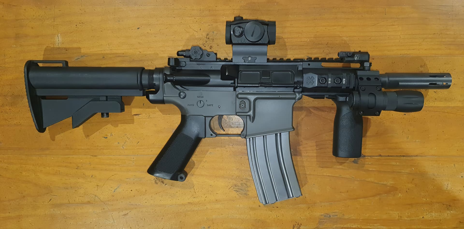

That’s a CYMA stanag hanging out of mine. Shitty, I know… but it’s not a high ROF blaster so the CYMA keeps up… no misfeeds.
I took the birdcage flash hider off it and put on an XM177 moderator. Lets me use a barrel about 140mm long and allows an 11mm hopup.
Gained about 20 or so FPS out of the longer inner. :+1:

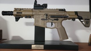

This one’s bought not built. Little SLR ION 4.25" model.
Has a few bits in it from AKgelblasterau. And a hopup printed by Rok. Does about 290 FPS with a 7.3mm barrel and weighs bugger all

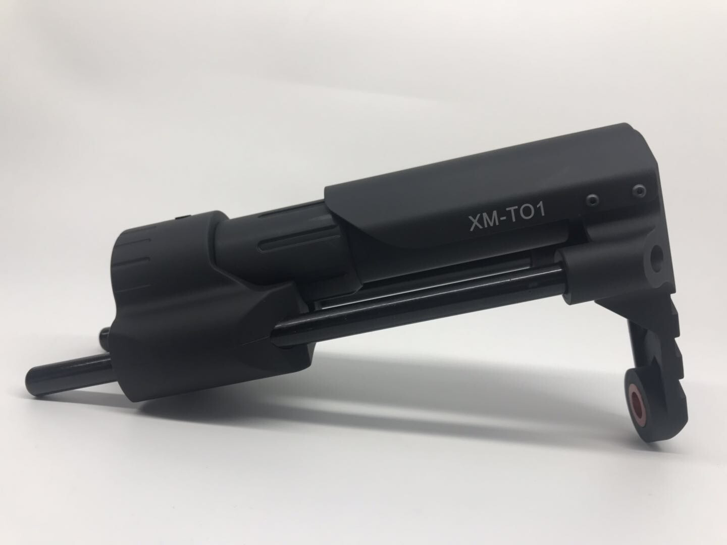

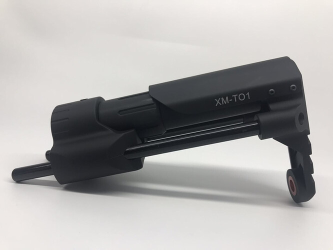

Thinking about a PDW style stock for my M4.
You could do the strike industries knock off from cybertrigger but it’s a $115.
I’ve got my shitty wells one you can have but it needs the molds in the receiver. Wobbly as fk. Why I fkd it off and changed it to what I use normally.
The PDW stock I have does not have the buffer tube. I can give it a good throw see if it lands your place but is honestly not worth the postage. It is shit.
Yeah… maybe don’t worry about it then. I wouldn’t want you to pull a hammie winding up for the big pitch. :laughing:
X-Force used to sell XM PDW stocks pretty cheap, if I’m remembering correctly. I’ll come up with something.
Appreciate the offer though, as usual. :+1:

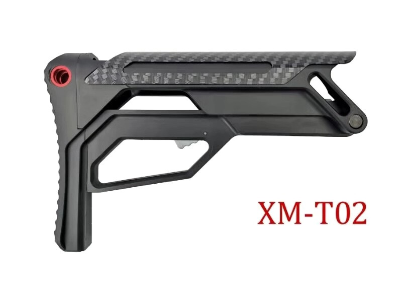

Like this one?
Pity shows out of stock, $60
Ah my bad be the T01 methinks.
$50 also out of stock.
Hmm iHobby have them by the looks. XM-T01 Stock Gel Blaster Stock (Colour: Black) - iHobby Online
Down the rabbit hole you go :rofl: :+1:
That’s the one alright. :+1:
