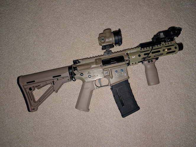

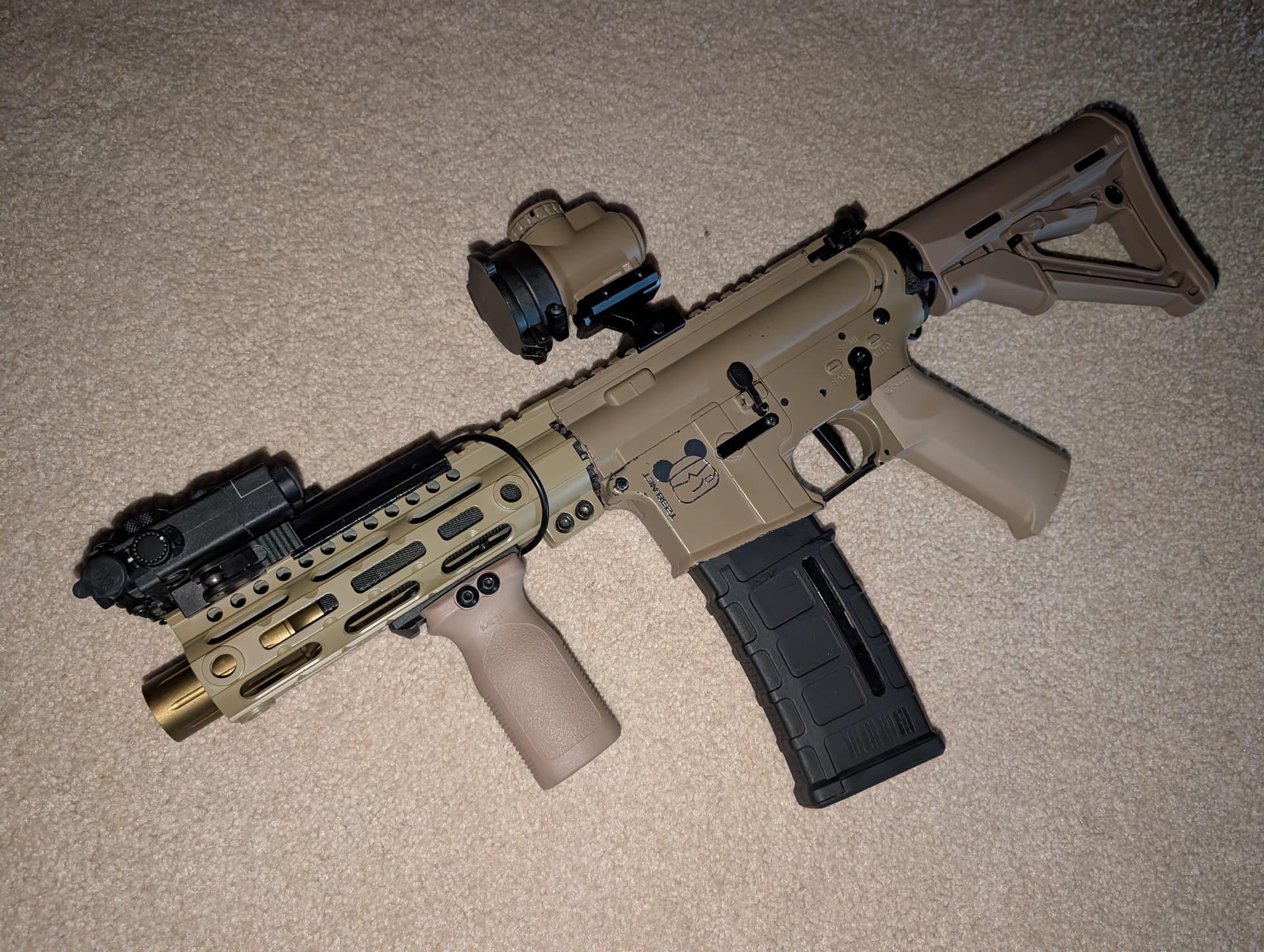

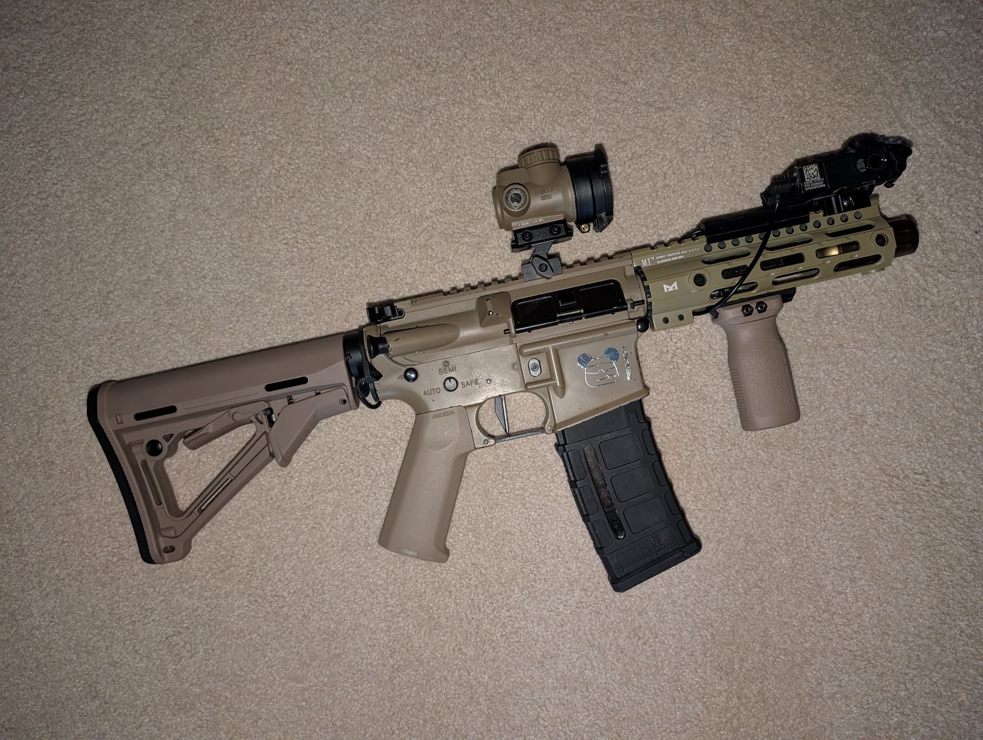

A couple more, why not!
First, is met first metal custom with every part brand new at the time of build.
It’s a fancy wells receiver, bought before the blasters containing it existed. Just looked cool so I bought it.
They are a very nice receiver. JG gearbox, with SLR nozzle and tpiece, m100, T238 optical ETU, SHS bushes, piston, 13:1 gears, aoe pad, and an X-Force high torque motor. Does a neat 340fps 30rps from a 24x7.5mm barrel, DK13 hopup hidden in the cherry bomb muzzle, awesome range and accuracy.
Has a metal SLR outer barrel adaptor that needed the receiver filed out to fit… it is so tight it is never coming out! I was worried the receiver was going to break belting it in!
One of my all time favourite M4s, been to countless skirmishes, never been serviced, always thrashed and just keeps going. Love it!

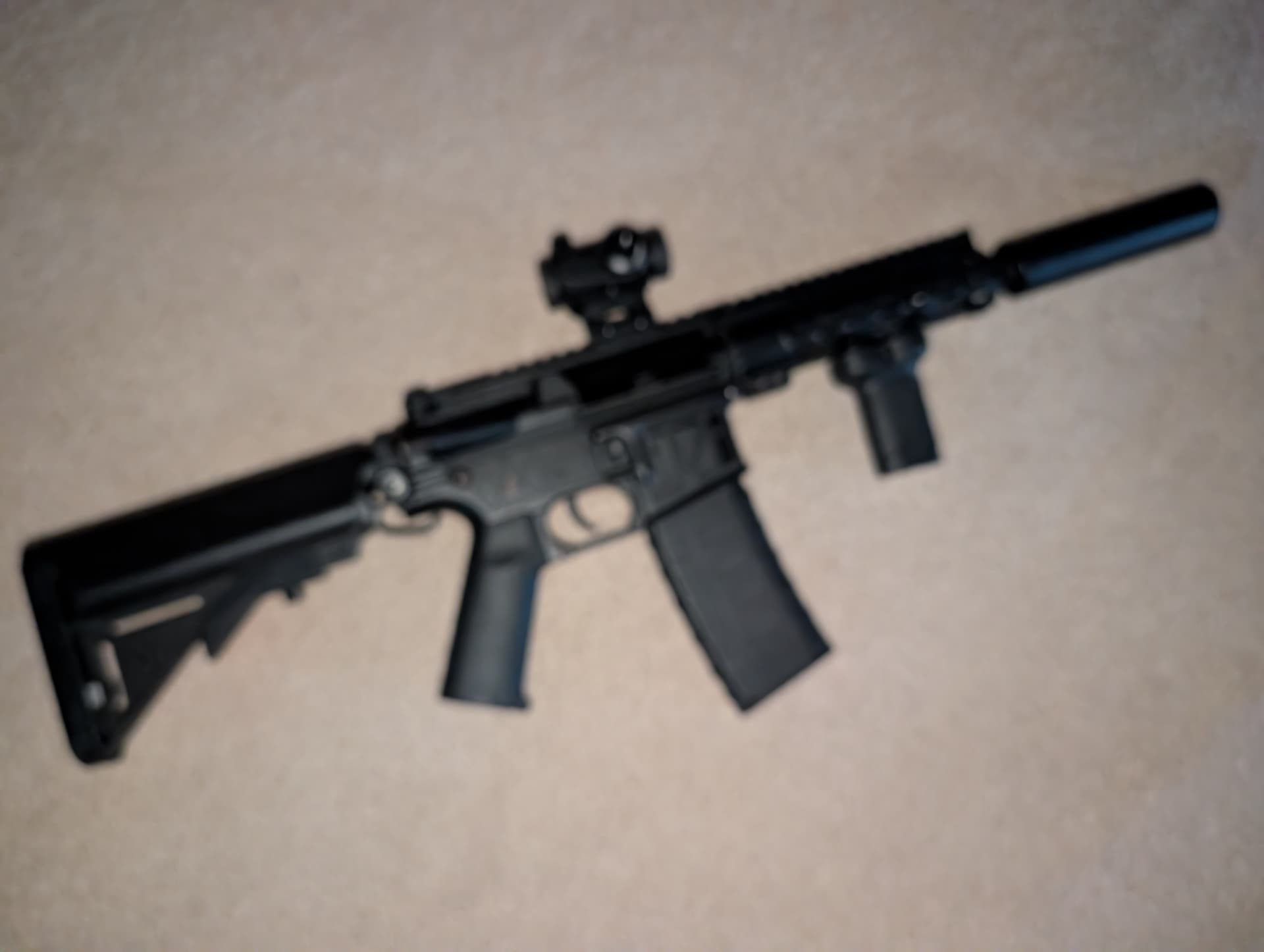

Second… my custom bitsa metal CYMA.
This was built around being a pure semi cqb blaster with mostly new parts and a few scavenged bits.
CYMA metal gearbox, 12:1 gears short 4 teeth, m100, t238 basic ETU and 28k brushless motor. A very consistent 285fps and 30rps, but a super snappy semi auto.
The t238 stickers because why not, DBAL is for the flashlight but laser works too. And there is an aka hopup hidden in the little miniature suppressor brake thing.
Shoots straight, semi response is bullshit good despite there being no precocking option, and the trigger travel is almost none but it does have enough so you can keep your finger on the trigger without it going off accidentally.
Best of all, the whole thing externally cost me almost nothing as it was all bargain bin spares from dead stock piles, resurrected with purpose!
