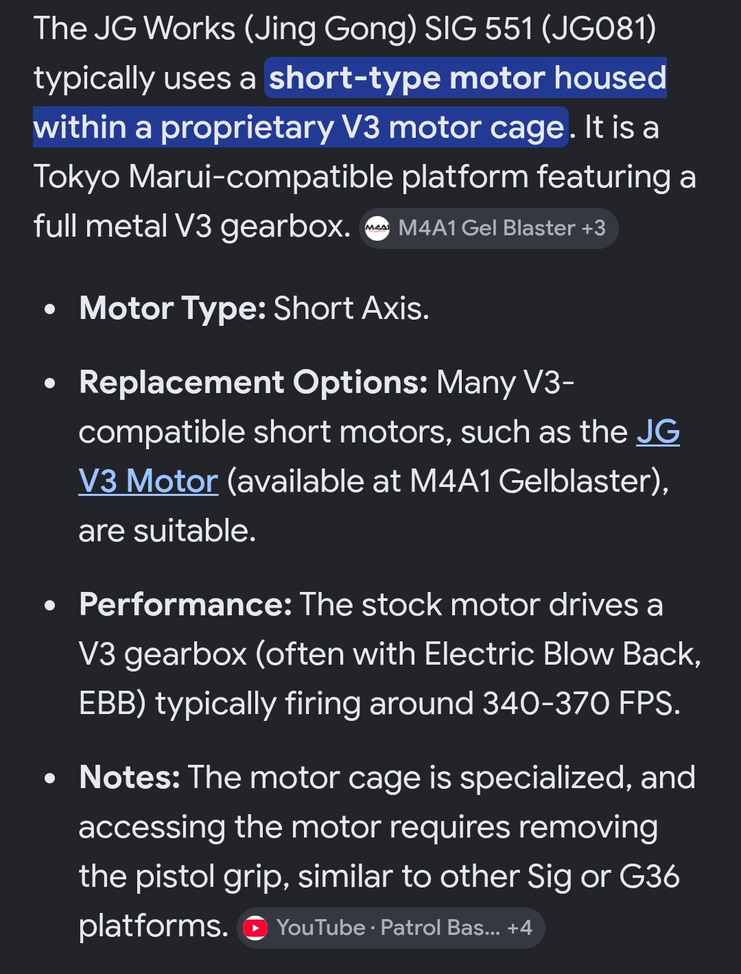

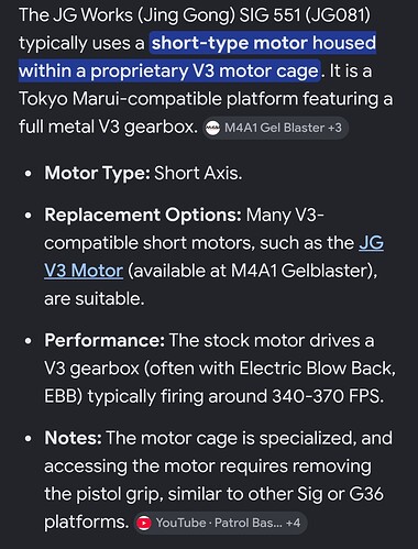

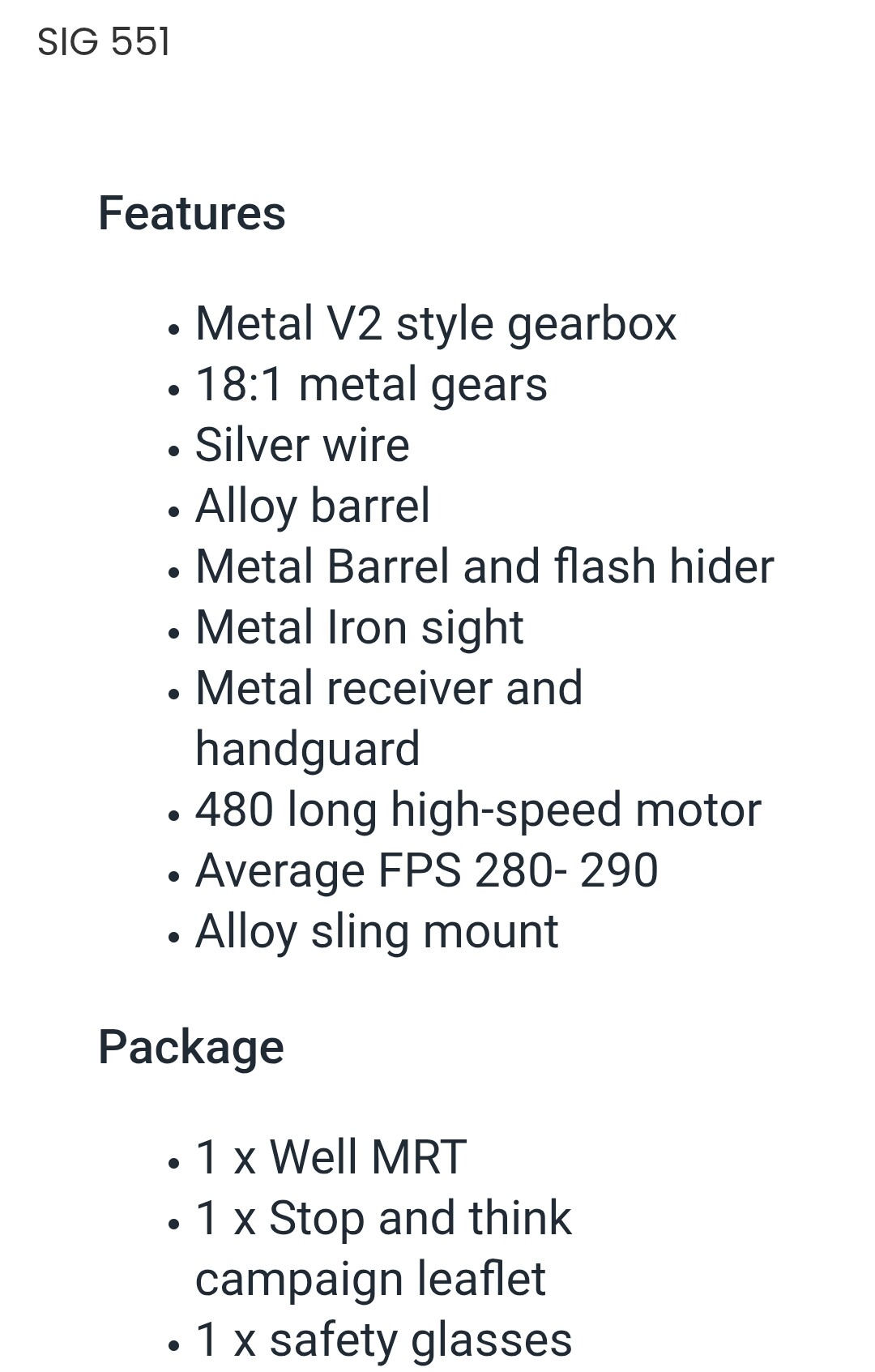

The problem in facing ATM is mixed information
Google says (provided by geltactical)
Yet their website listing for the sig 551 says 480 long :roll_eyes:
As does ausgel so it’s confusing, especially when they say it’s a V2 gearbox and have the wrong item listed in the package contents :roll_eyes:

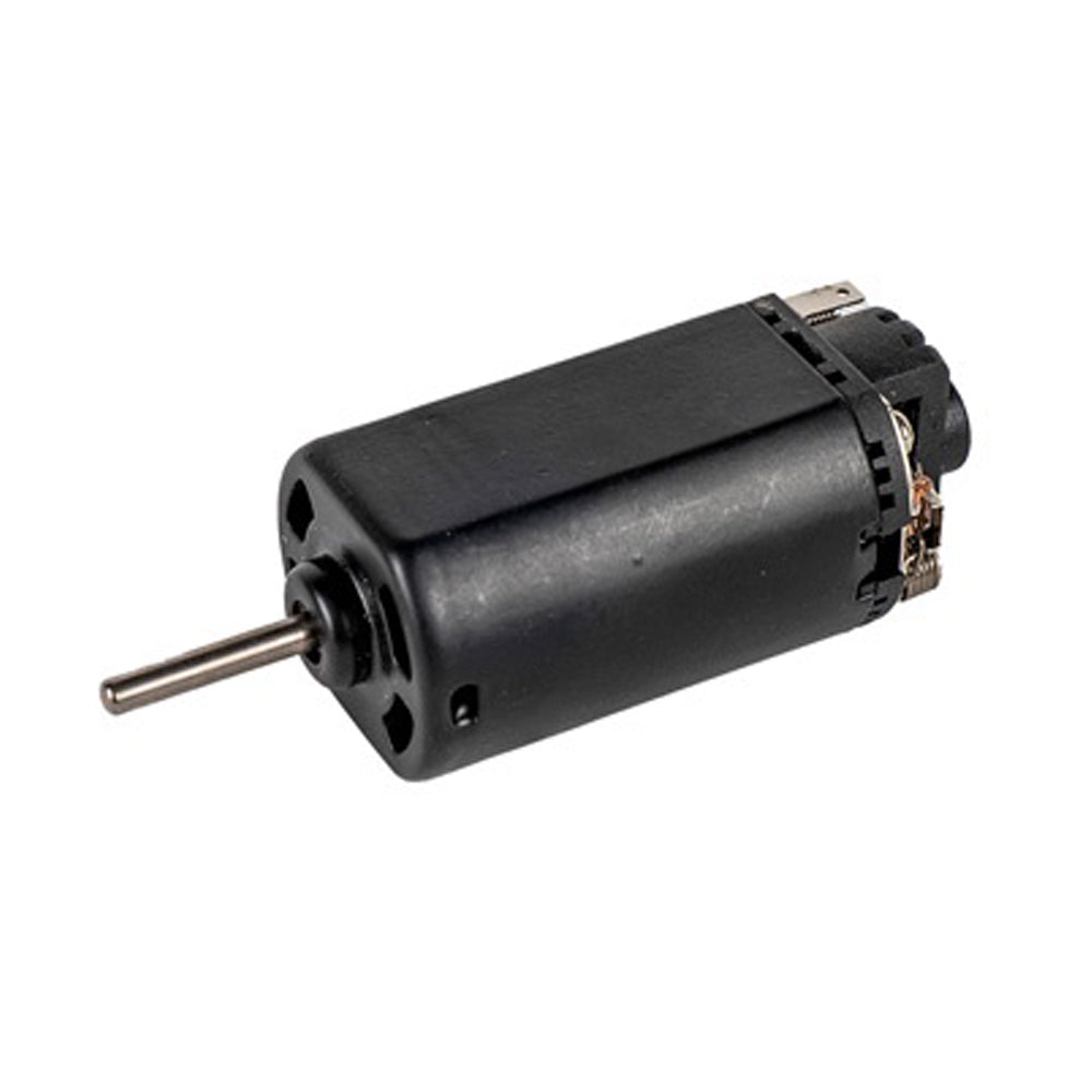

Ausgel have these but it’s a short motor

They are a mid length motor. It is very unlikely the motor is faulty as JG motors are typically pretty good.
