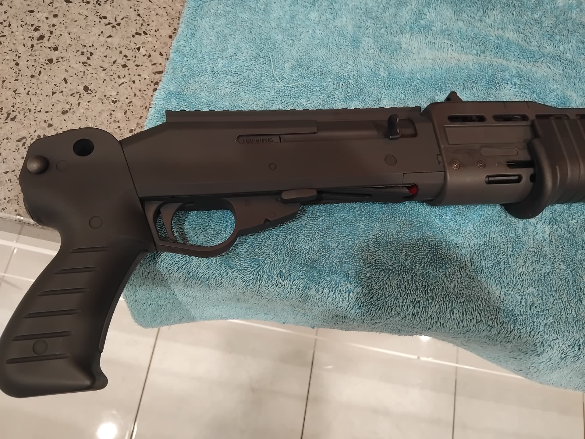

Overall, i’m quite happy with the result.
Looks so much better than the original, plasticy, shiny toy look…

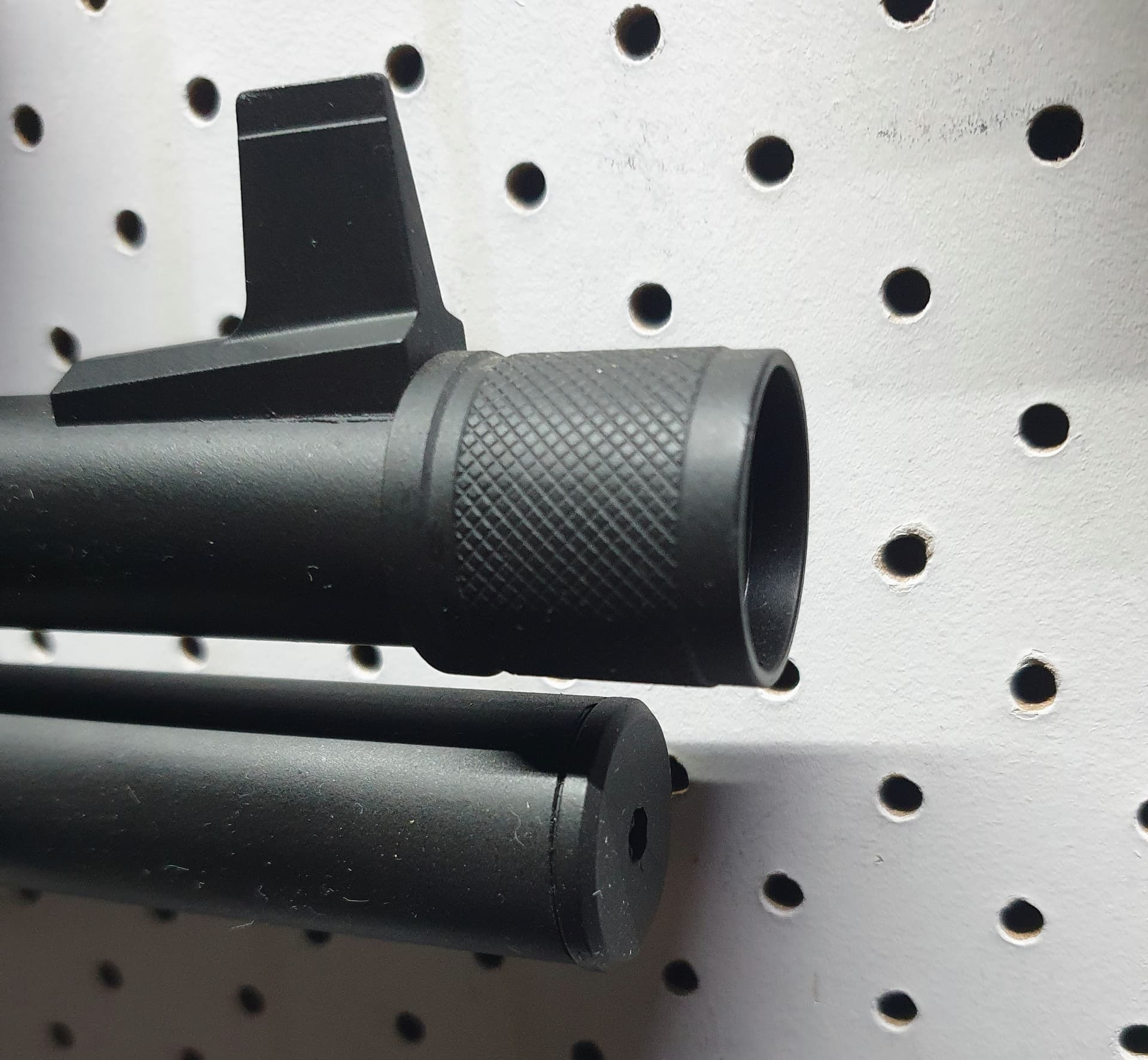

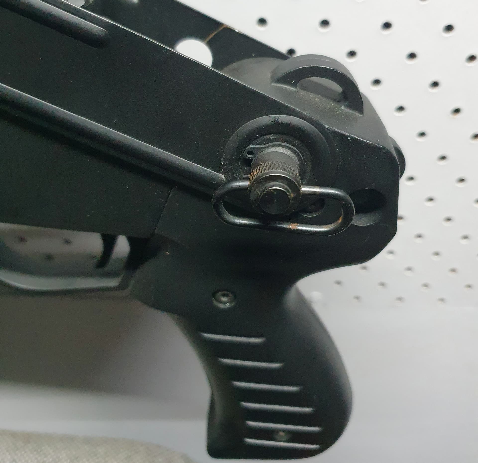

You should whack a cut down torch body on it to give it a knurled muzzle break.
Then add a HK416D sling plate on the front
And a Vector slingloop on the stock
They’re heavy little buggers… wouldn’t really want to hawk one around without a sling. ![]()

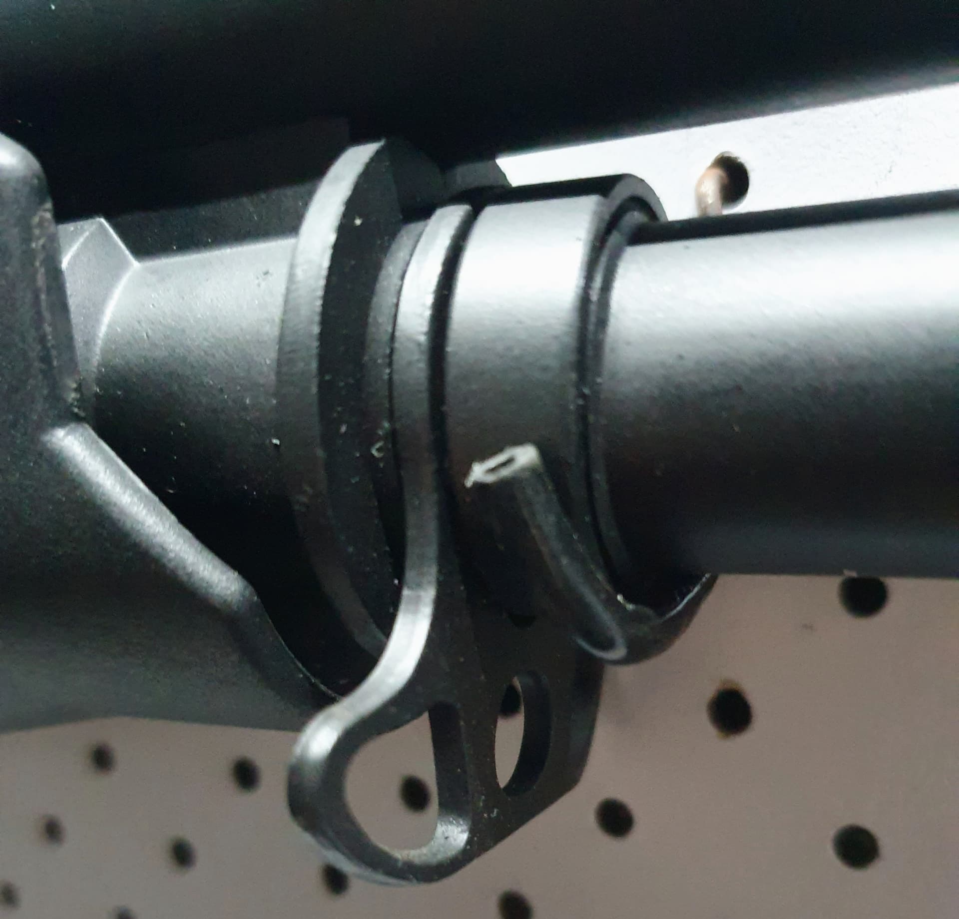

Uh oh… looks like that sling point needs a bit of Inox. ![]()

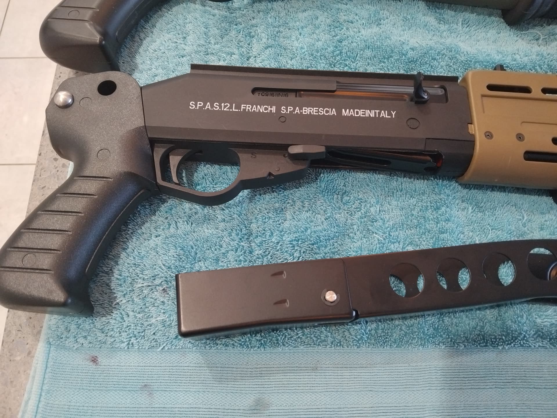

I had to rediscover, how i got the black, on my first SPAS.
The flat black was too dark, absorbing all light, no reflected light.
It lost all the contours, lines etc, and looked a bit muted…
BEFORE… ( pure Dymark Flat)
The trick was , to use
Rustoleum ULTRA MATTE… and followed by a coat of tamiya TS-80 flat clear coat.
The ultramatt gives it a bit of a reflective sheen, wihout being over the top.
The clear coat dulls it down a little further.
The finish looks comparable, to other “brand new blasters”.
Maybe, some weathering to follow…

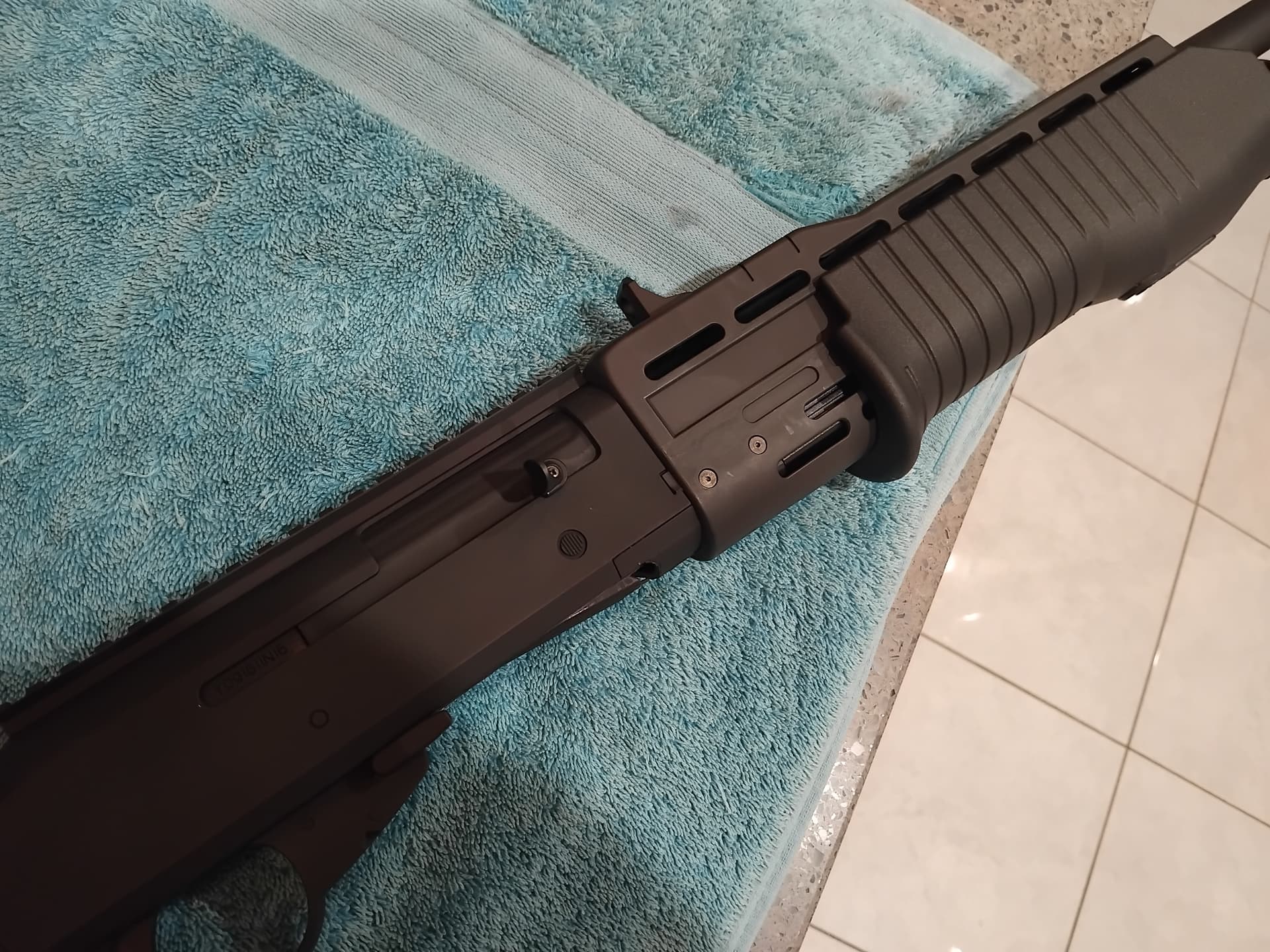

A bit more sheen noticeable.

One final bit of blurb, on painting black…reminder to future me…!
Should you wish to repaint a blaster back to “New blaster Black”
I used Rustoleum “Matte Black”, followed by a coat of TS-80 flat clear.
Rustoleum can spit, so hold at a distance, with several coats.
Final result photo…grip and receiver of SPAS ( painted) vs M4 Spectre (Factory paint)
Very, very similar results.
Notice the shade of black acheived, amount of gloss overall, and reflected gloss on the grips.
Pretty close, and smooth finish with the lacquer.!
