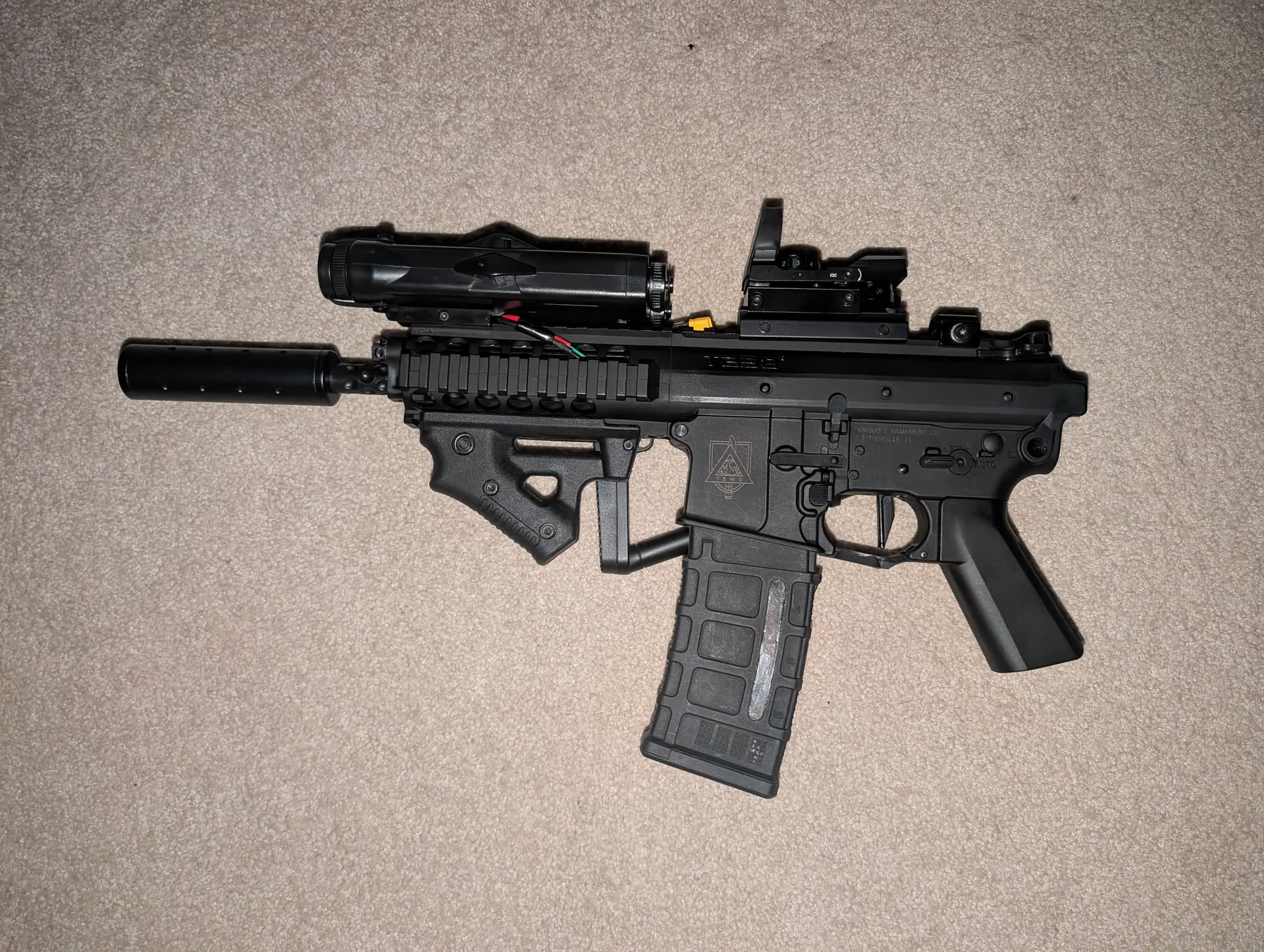

The HL Honey Badger is almost rebuilt. Just gotta sort the tpiece and barrel out.
MK V2m gearbox, DSG gears, M160, T238 EXP Bluetooth ETU, but the motor is currently a “frankentorque” slow motor so ONLY 35rps. I do have another motor that might be a bit quicker to try, another frankentorque thing. Be nice with a brushless… but jamming it together with only parts from my stuff was cheaper!
Best of all, whole thing almost completely built in the morning and just waiting for tpiece epoxy and the 3dprinted spacer adaptor thingy to cure till tomorrow!

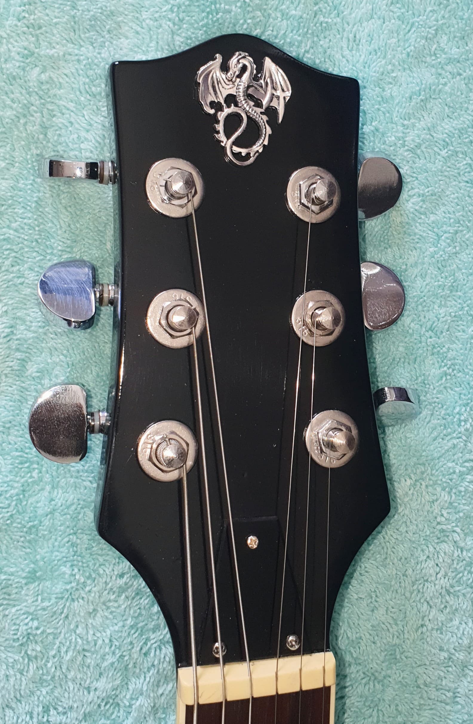

Headstock painted and refinished, rooted Kluson style machine heads replaced with Gotoh Grover style items.

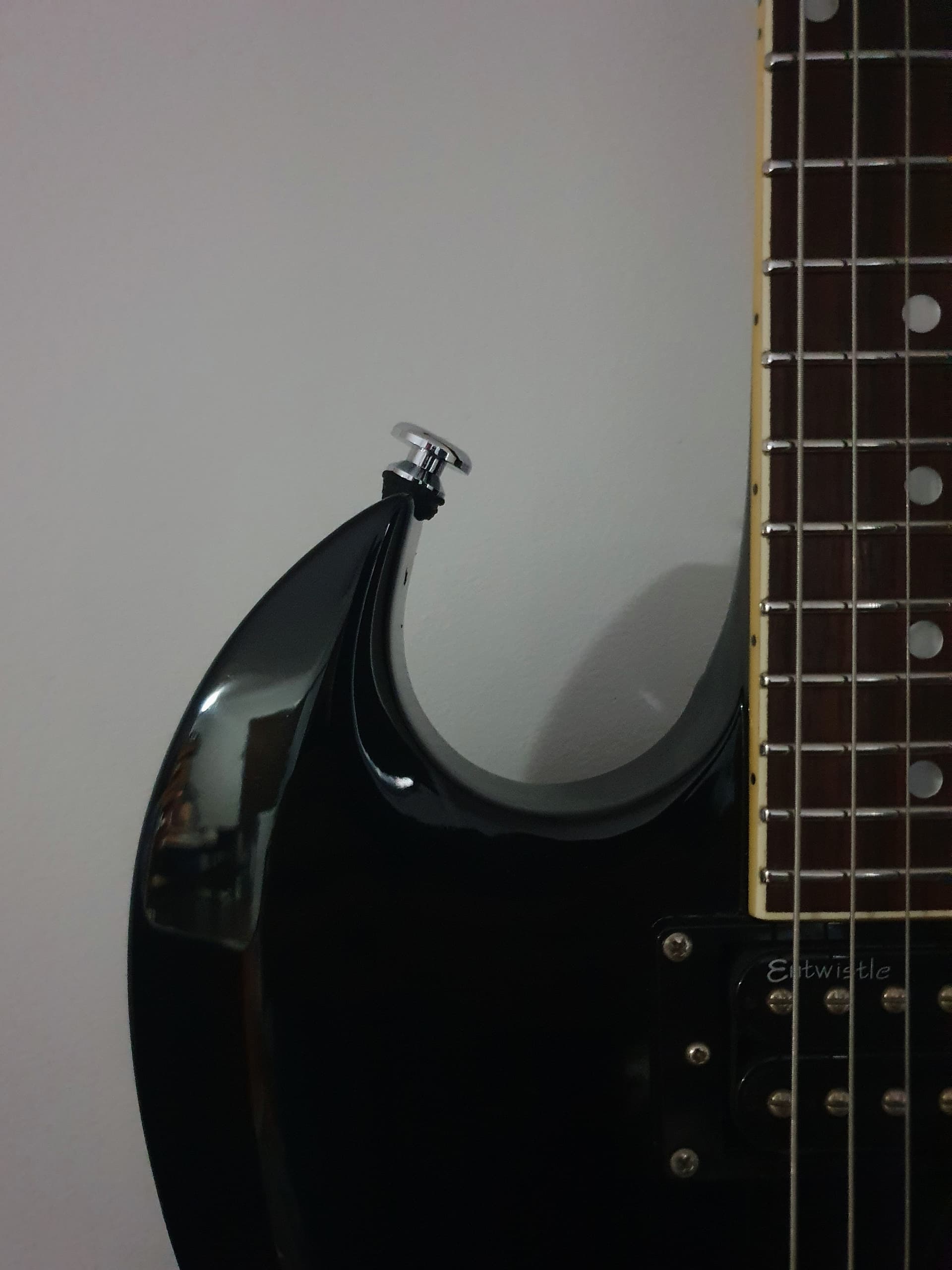

Rewired, finish cracks and flaws addressed and 95% invisible, relocated the front strap button to the upper bout to correct the infamous SG neck dive issue.

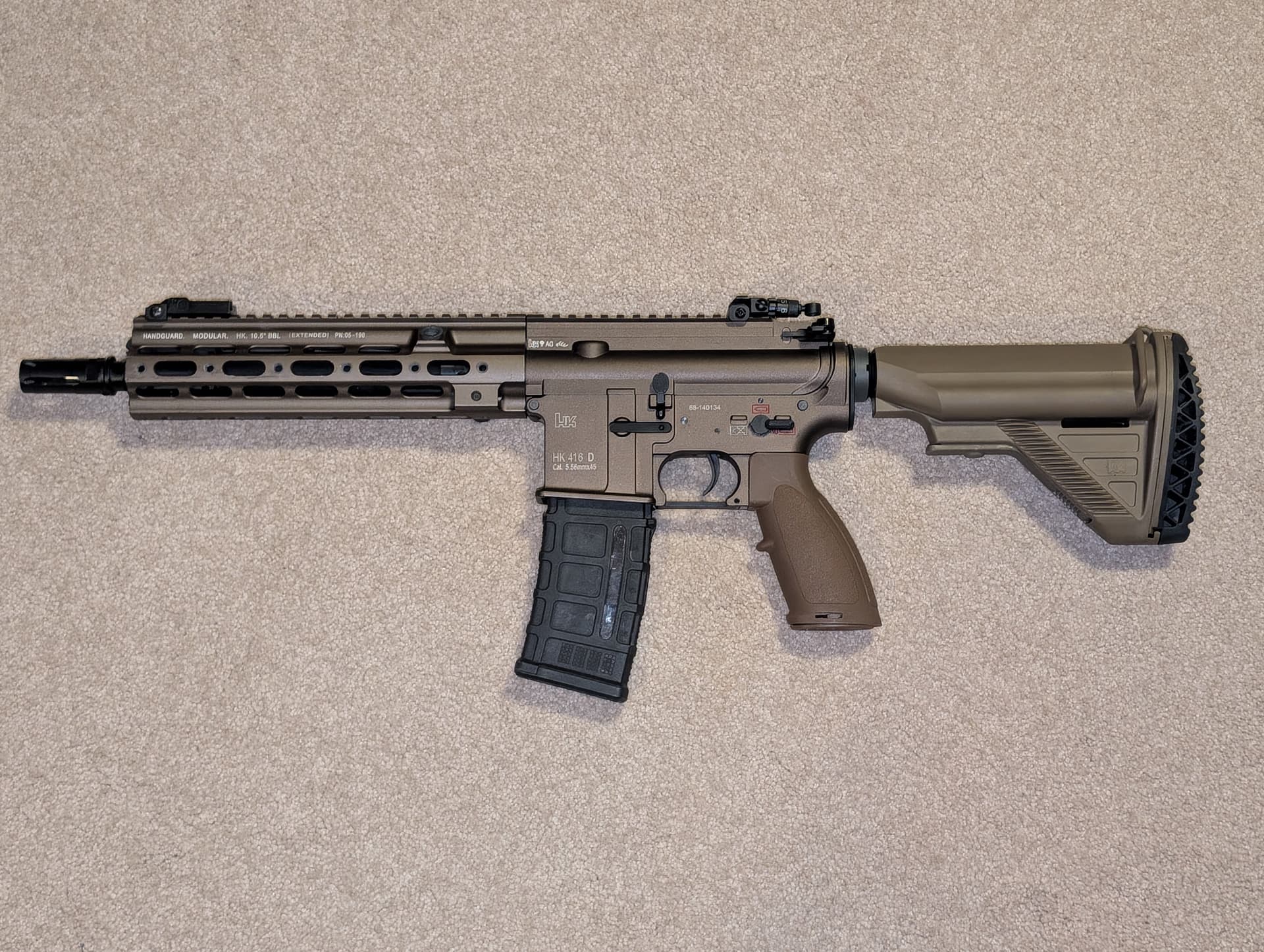

Picked up an EnC HK416D. Older LDX version.
Cheap. Not working, no mag or motor… testing with a motor didn’t get power to mag either.
Someone attempted to run 13:1s. Badly short stroked with stock LDX everything else. Guessing it didn’t go well!
On closer inspection all the wires were munted, covered in electrical tape but crushed in many spots…
Cleaned up the short stroking, new trigger block and full rewire. New piston and head, cylinder, cylinder head, nozzle, m110 spring, bevel gear, solid bushes hopup barrel, and a chihai “super motor” I had laying about.
No seal and the tappet plate was binding so a quick shave in some spots now it works sweet!
Now doing 320-330fps with 3 teeth off, at a handsome almost 30rps.
