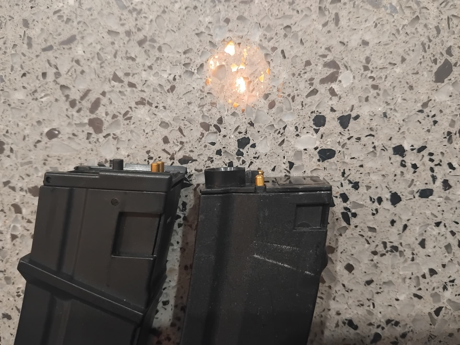

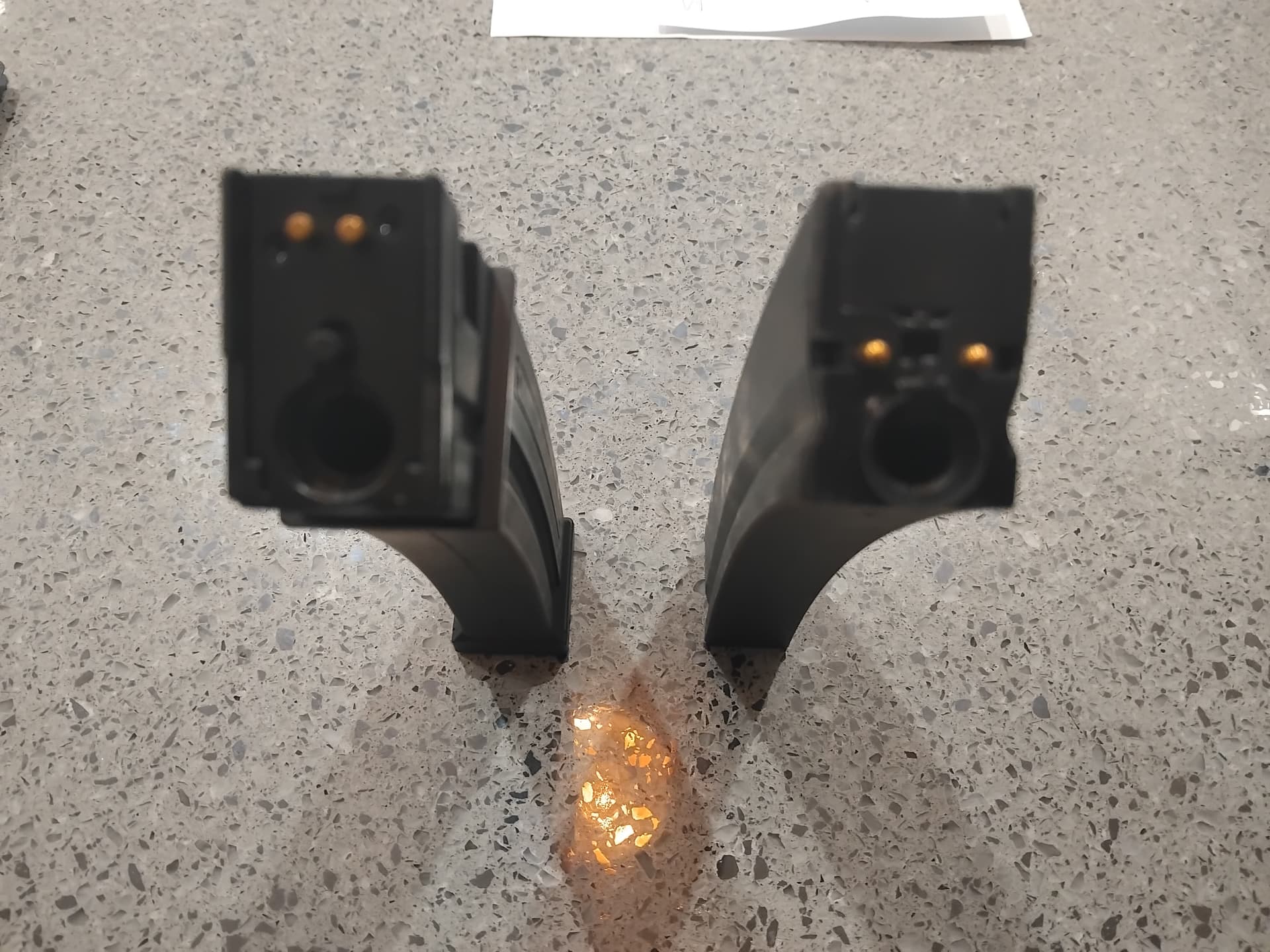

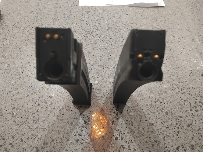

Out of curiosity, is the CYMA MP5 mag compatible with the K? :thinking:
Can’t really imagine why it wouldn’t be… :person_shrugging:
That would be too easy, wouldn’t it…?
Sadly…No.
Different terminal positioning.
And, JM has an extended feed tube.
So, proprietry it is…

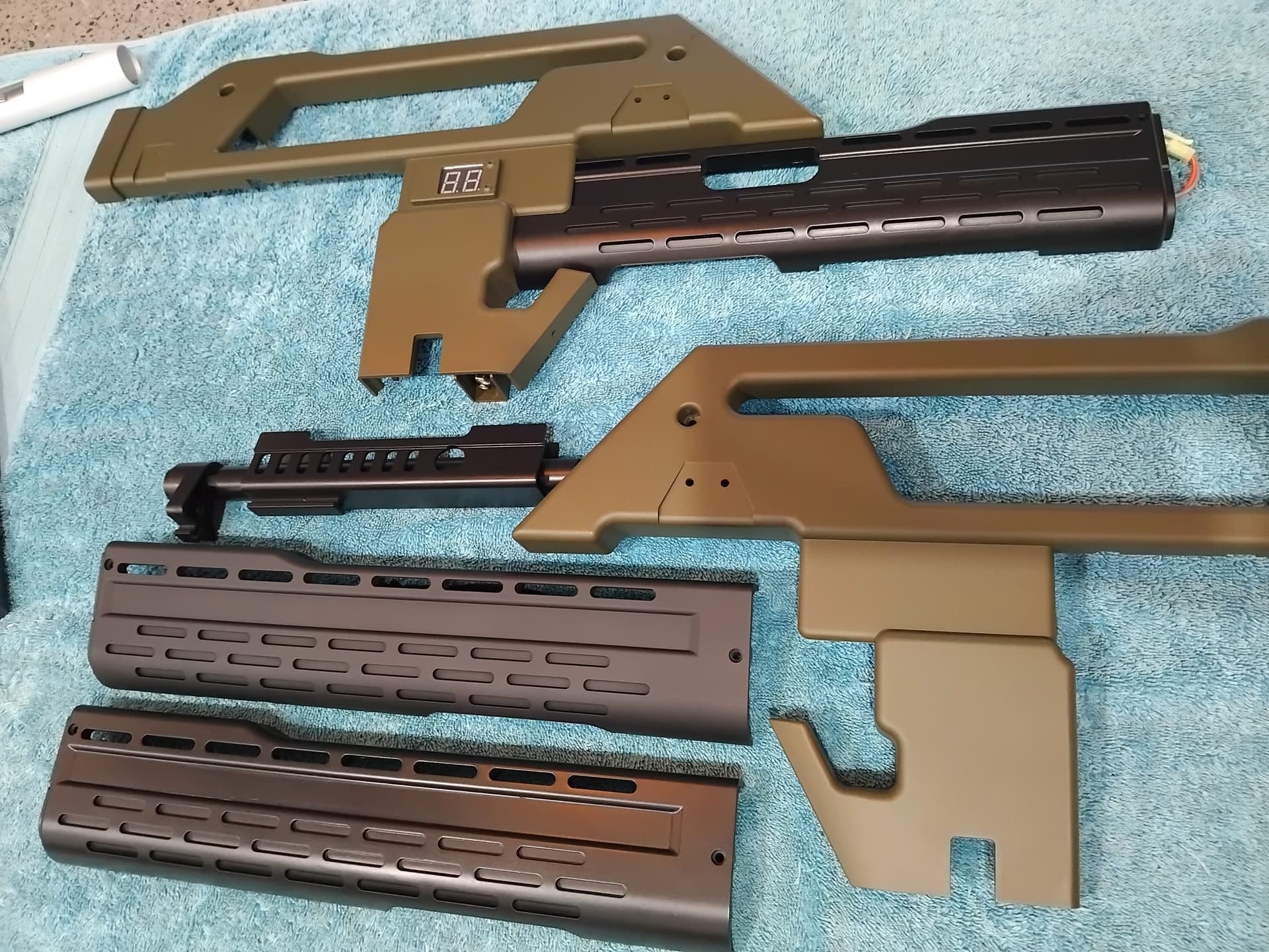

I bit the bullet, and decided to go for Dymark flat black / Tamiya Flat clear coat.
That is which was used, on the others…
Normally, it leaves a very deep flat black…but… these are "visually busy " pieces.
Lots of grooves / details etc, so its not as noticeable.
The middle shroud is Matte, all the rest are glossy…
So, the question remains…what to do with the glossy bits.?

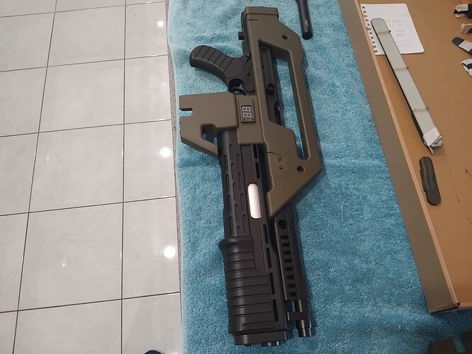

Bit of a brainstorm, before reassembly…
Tried one new rattle-can combo, i haven’t tried before.
Tamiya TS-29 Semi gloss black…Coated with TS-80 flat clear.
This works a treat…!
My other painted PR has Dymark flat black, with Tamiya flat clear.
Its a bit flat and muted.
The other was Dymark flat black, hit with semi gloss clear.
This was a bit too glossy.
My new combo straddles the gap.
The semi gloss paint has some gloss, but the flat coat drops the intensity.
Net result : the black a is bit darker than the All Flat combo, with less gloss overall than the semi gloss clear coat combo.
Phew…
At least i tried this, before reassembly…!!
Drying now, photos later…
So another 50 shades of black ?
giphy
I saved you the Bunnings spray aisle extravaganza…!!
I do requests , though….
:rofl::rofl::rofl::rofl:
I think it’s time to chill…
Sorry Busy on the blower to a Dubyay fella . Houston we have landed :rofl: :+1: Fuck your Aliens :rofl:

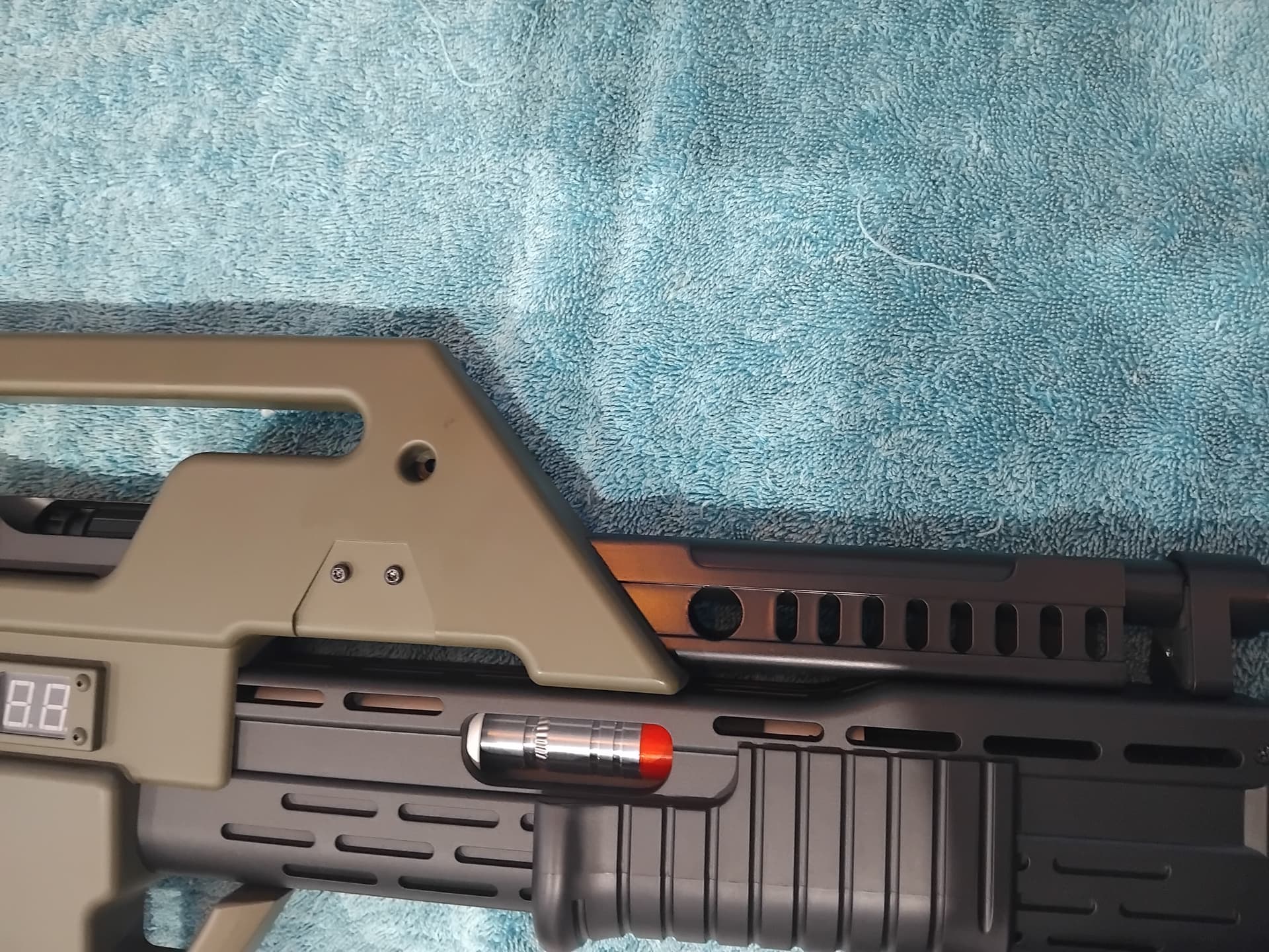

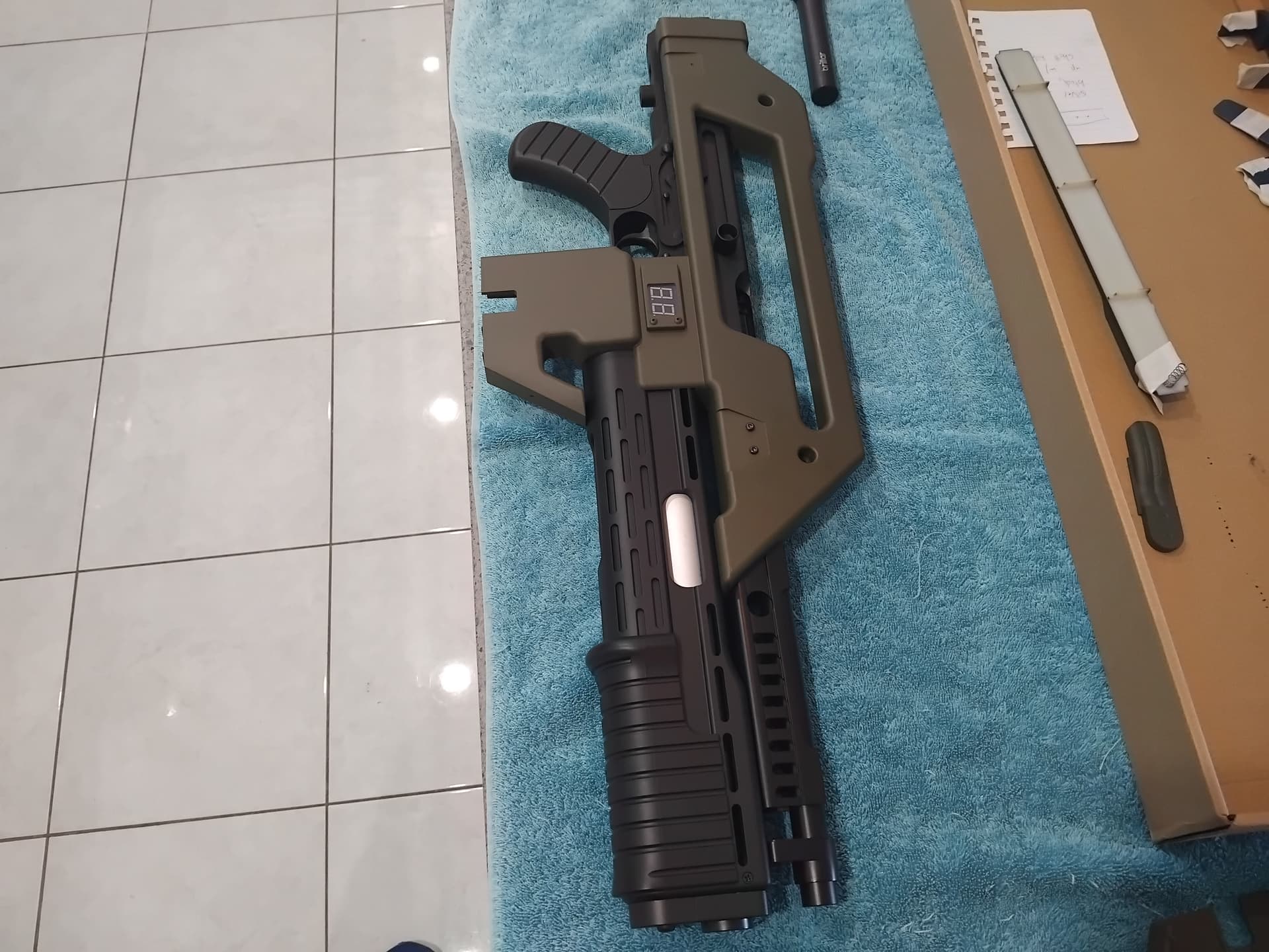

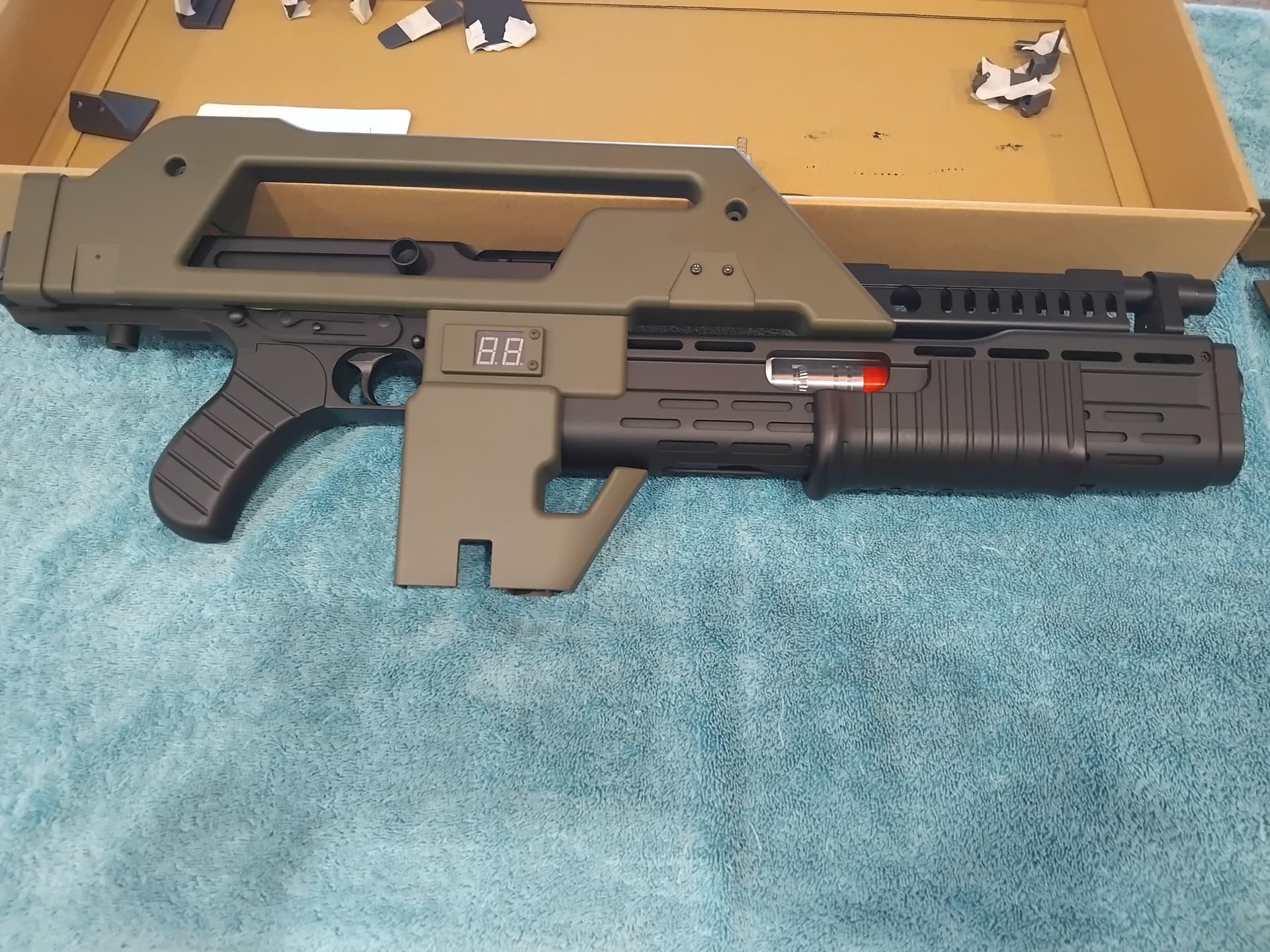

Getting it back together…
Went for the “glossy” up top…
Glossy barrel, glossy barrel vent, front triangle and grenade launcher battery cap.
Matte Spas cage.
A bit of gloss, without being over the top.

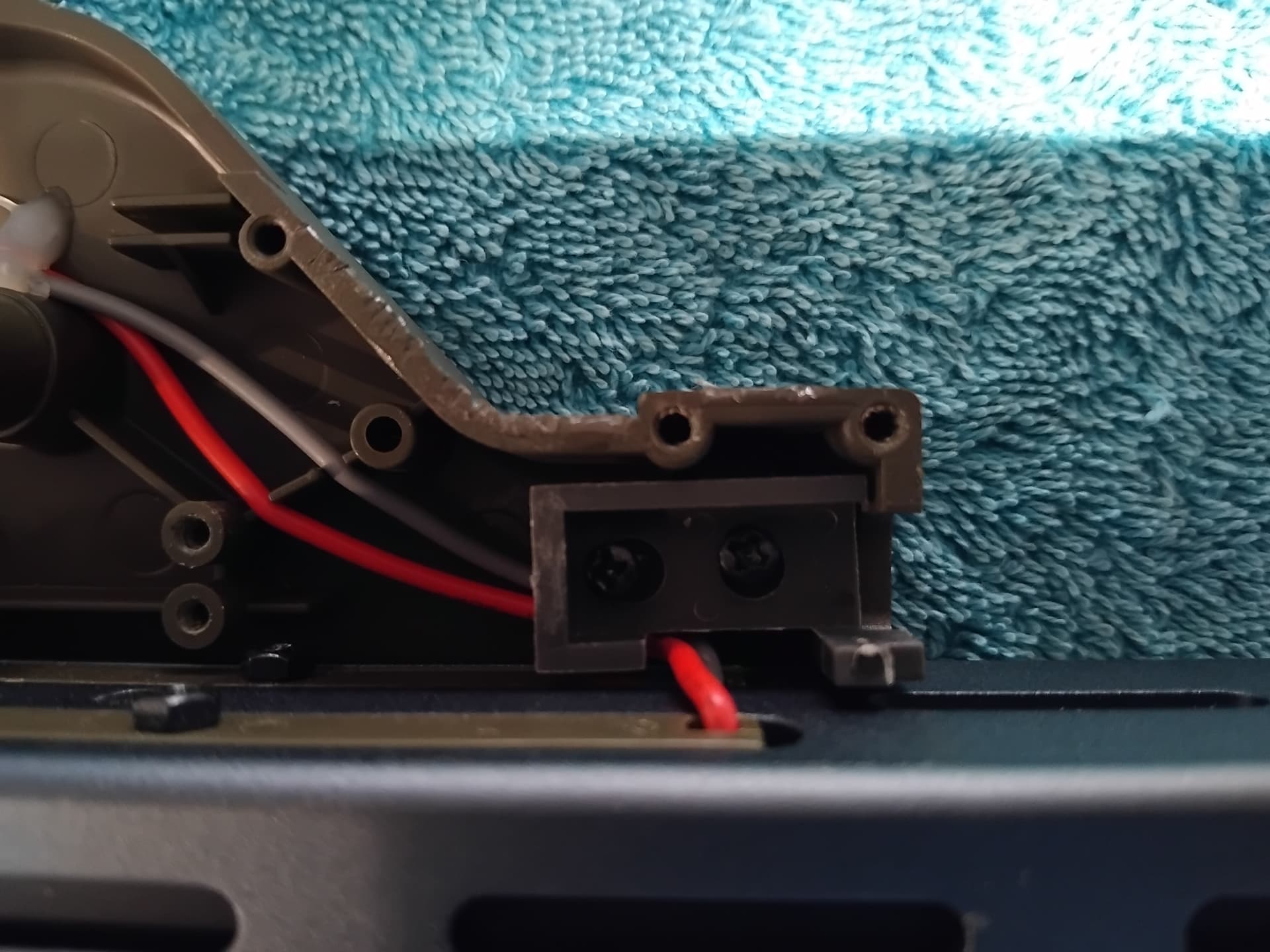

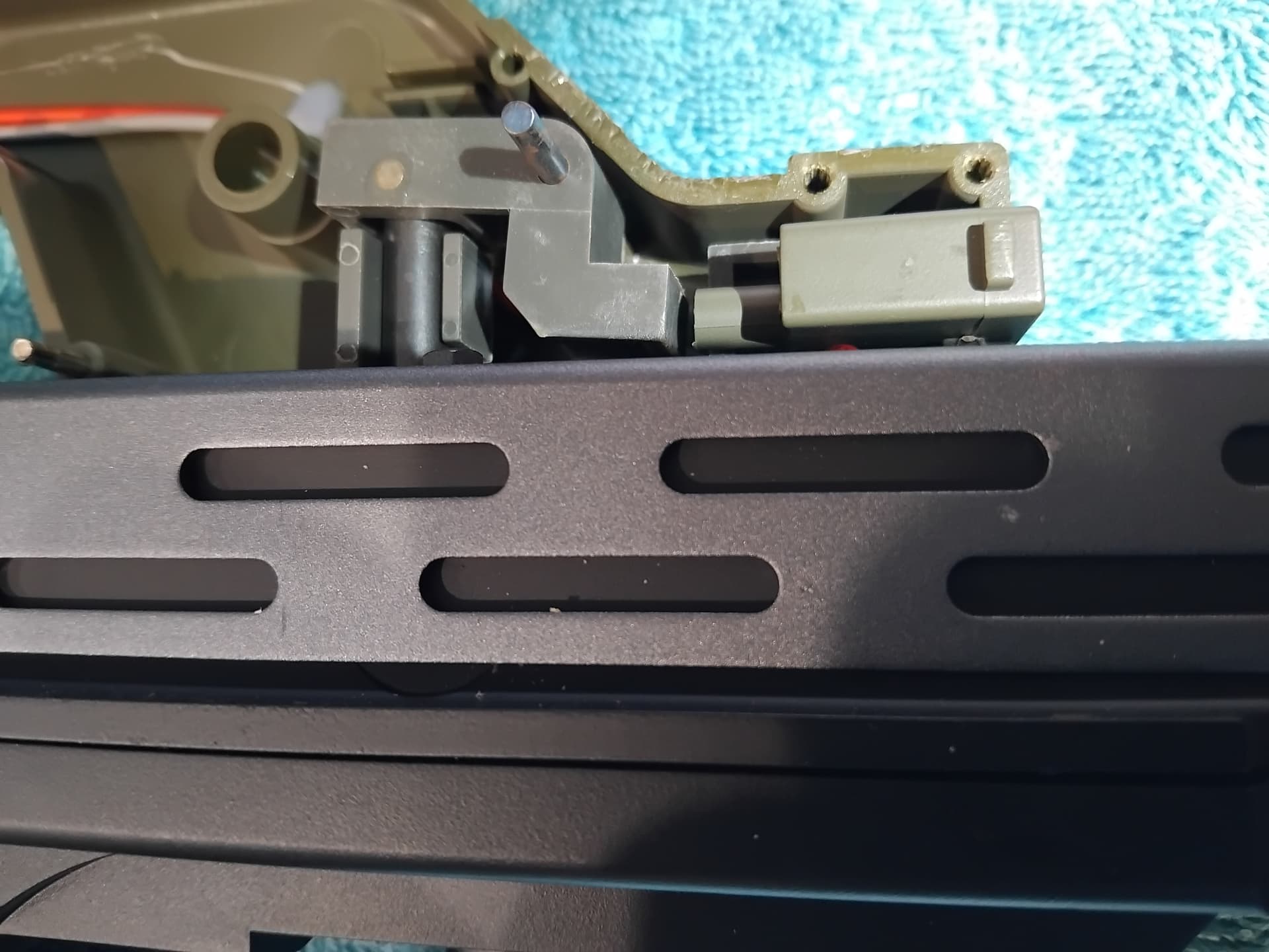

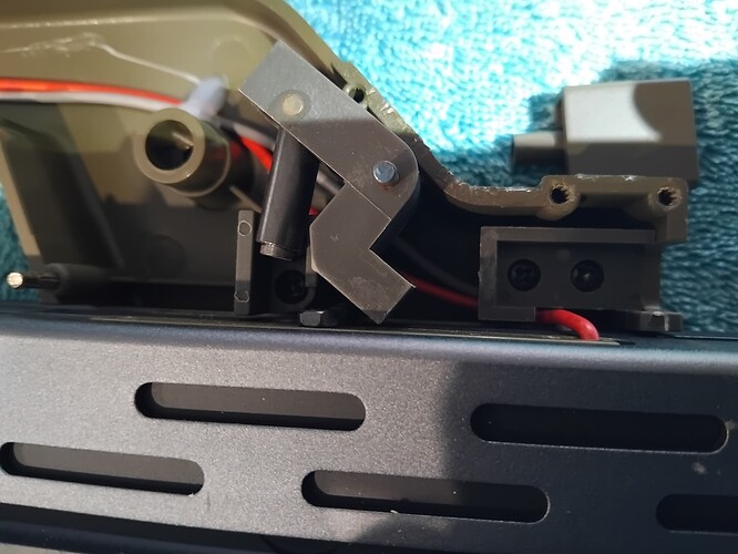

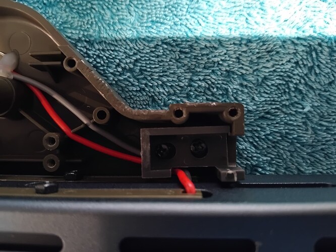

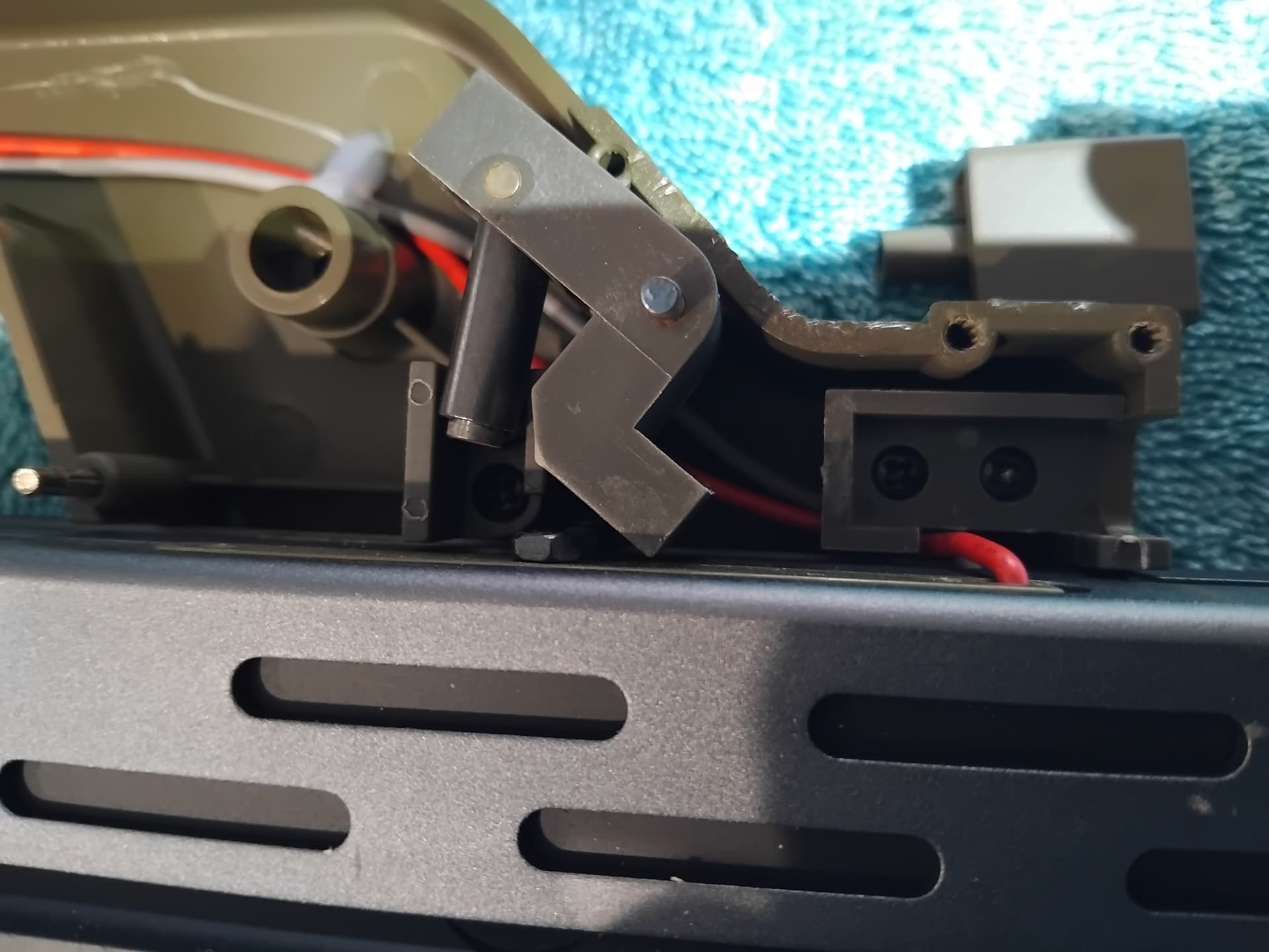

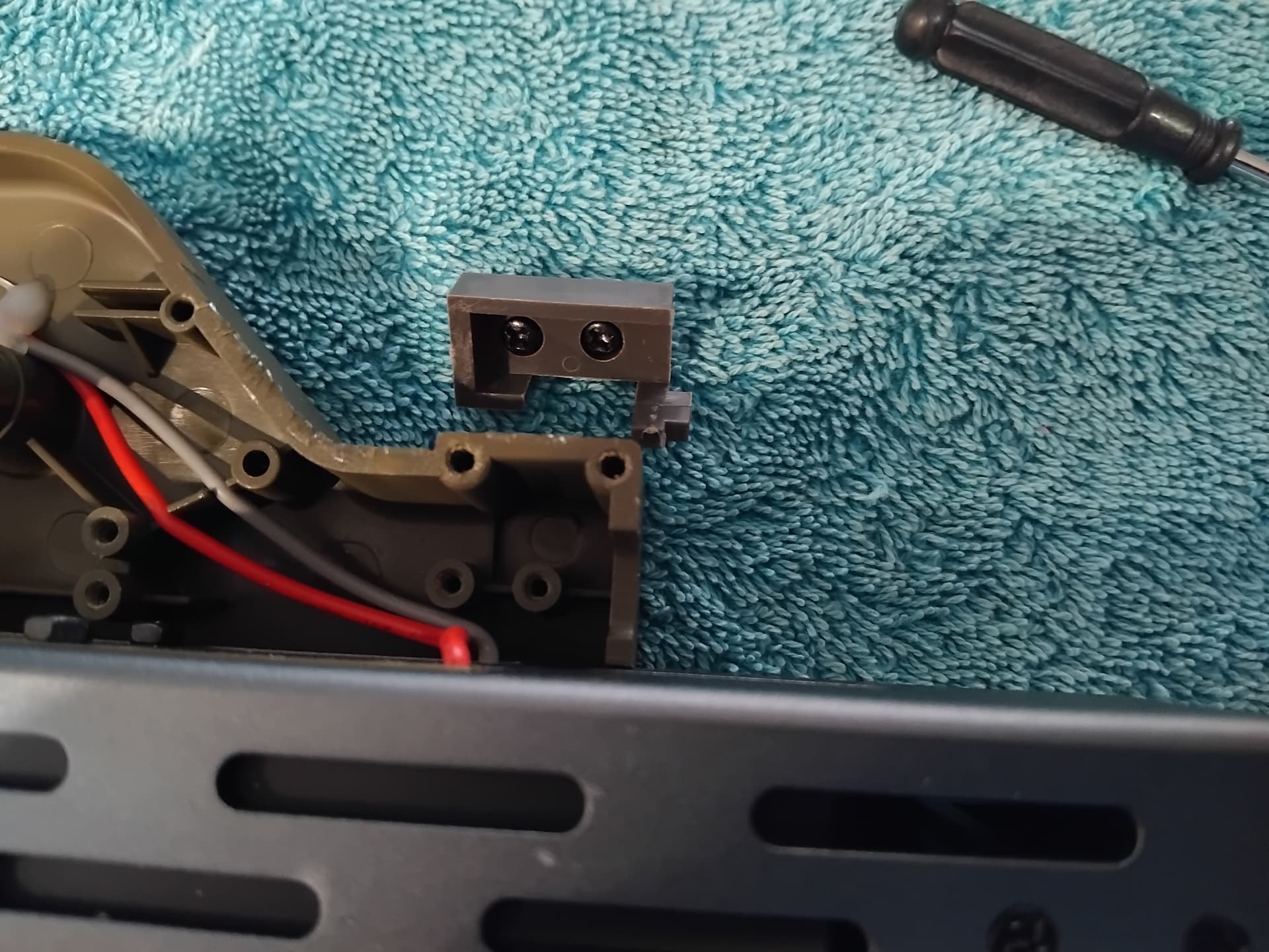

Doing the rear wires / stock / soldering…eeek.!
May need a bit of help, with that…
Sneaky , Naughty M-40…!!
(Betcha its the only gel PR in OZ with one !!!)
