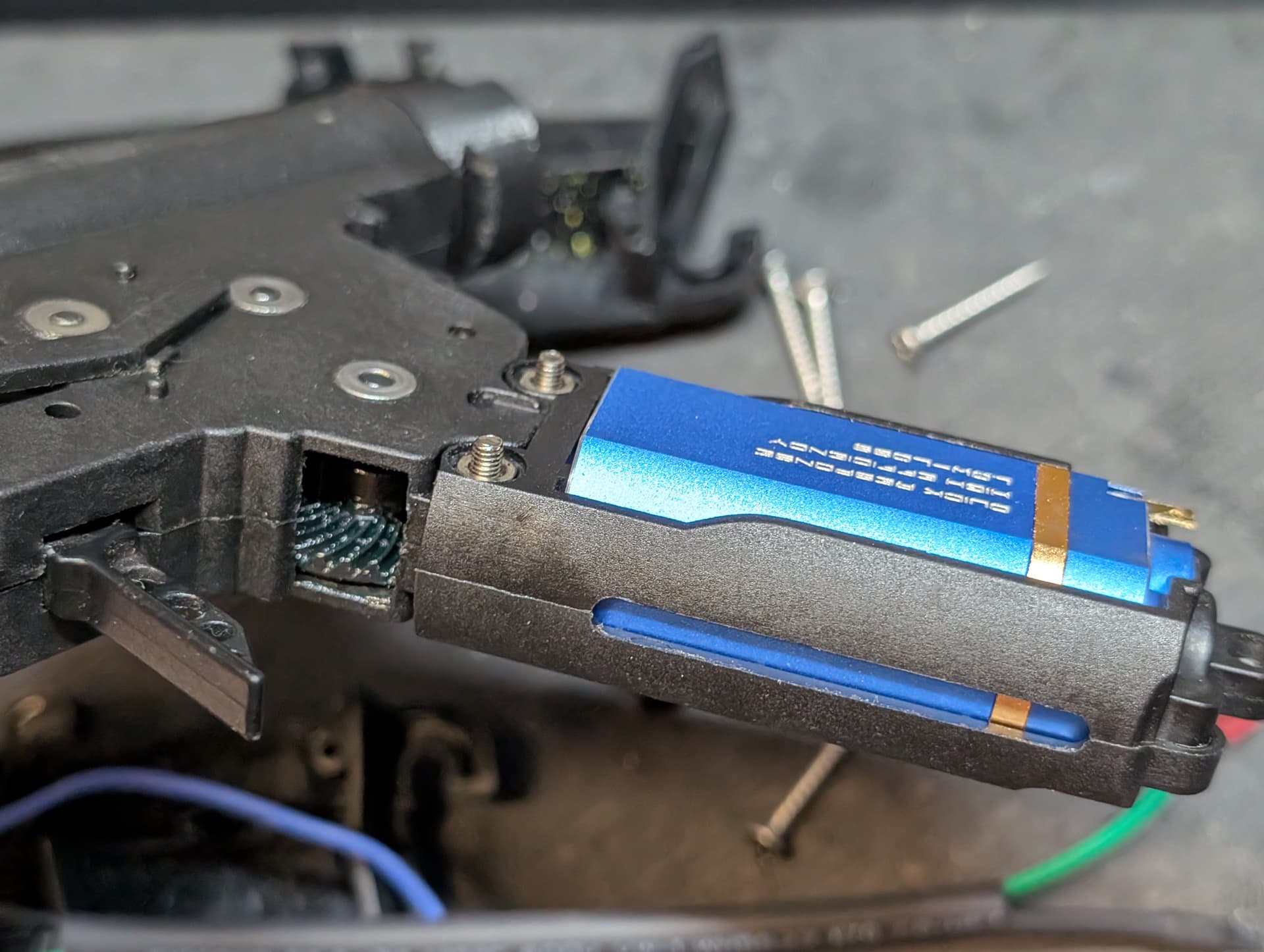

Started building a spare singularity box with a brushless motor… forgot how much nearly everything needs modifying to fit and work!
Pistons that fit and work… nope! every one of the the ones I have needs some shaving to slide freely.
Brushless motor needed grinding to get the pinion in the right spot, so far the only thing that fits and works surprisingly is gears thanks to my super slim bushes!

Yes… brushless 480 motor! 12:1 gears with a spiral pinion and bevel gear, and yes it runs.

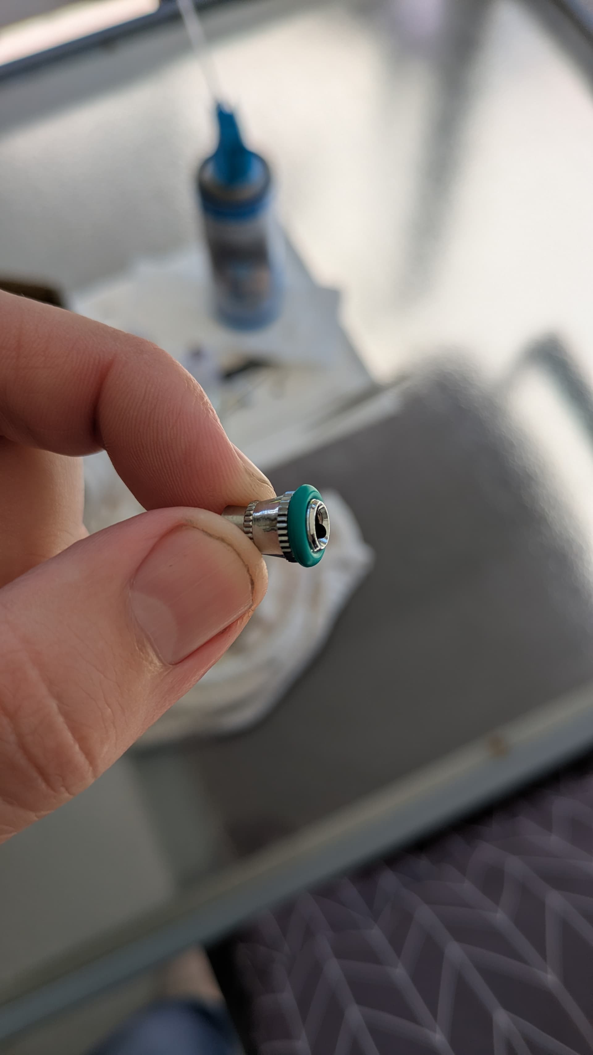

Note to self, don’t leave green o-rings in airbrush cleaner…
It swelled to like 5x it’s original thickness…

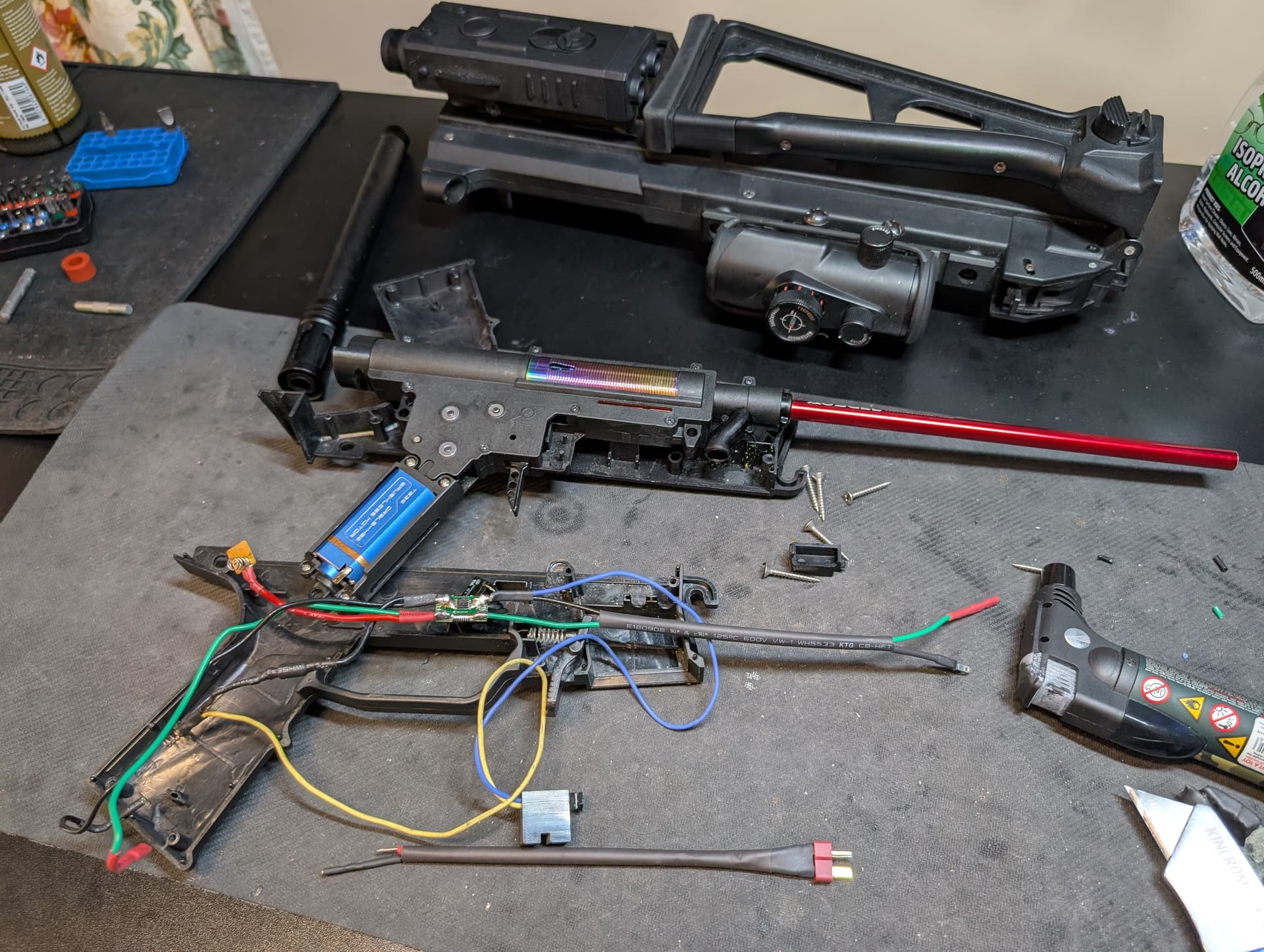

In other news, my gen8 UMP, now runs a spiral bevel an pinion gear with a brushless motor!
Cooked an easyfet in the process through my dumbarsery, gotta love overlooking the + and - things! So it now runs my last easyfet I have!

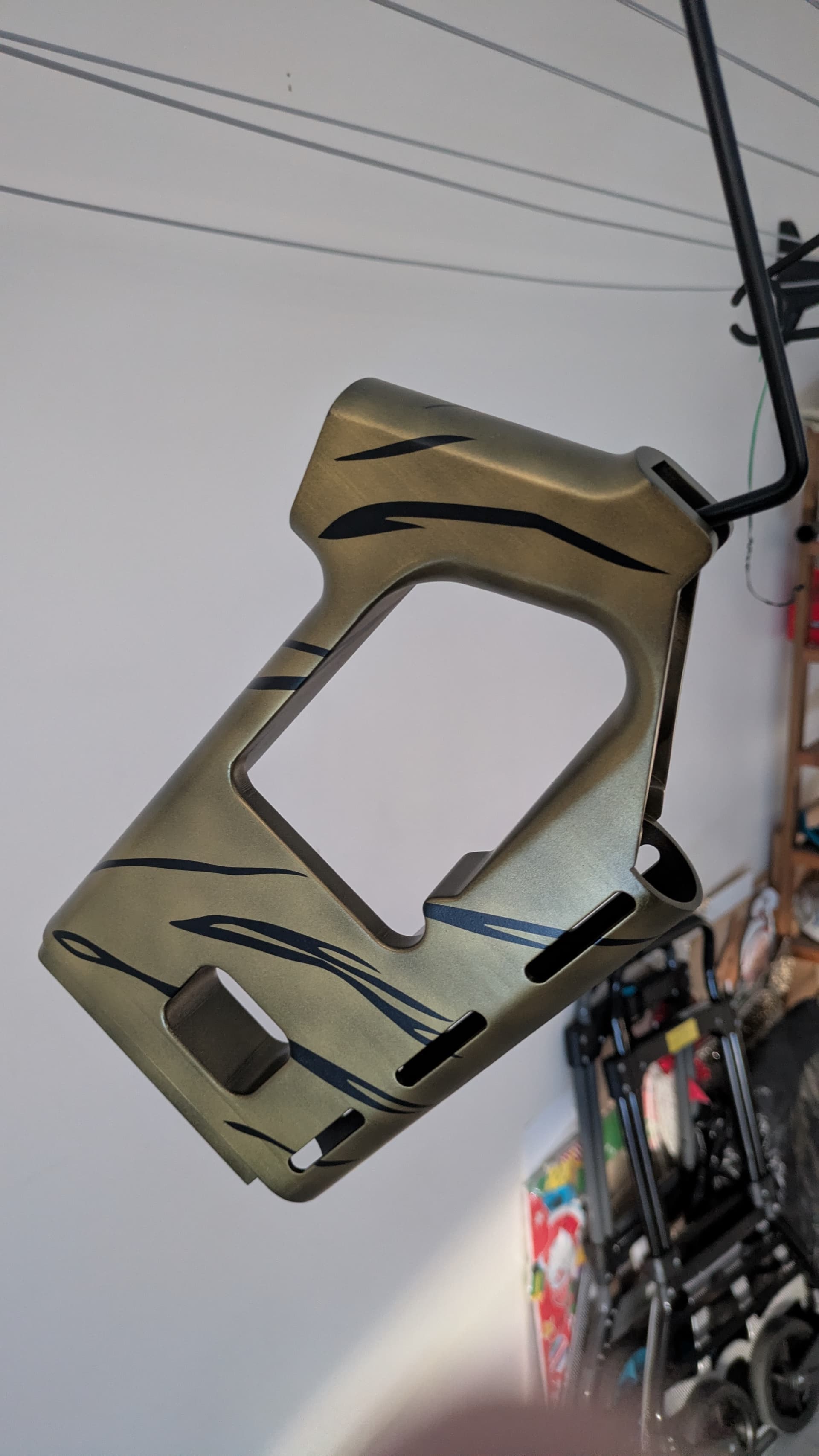

That looks awesome :sunglasses:
Yeah really impressive mate.
Also making me want to whip out the airbrush or rattle cans and paint something.

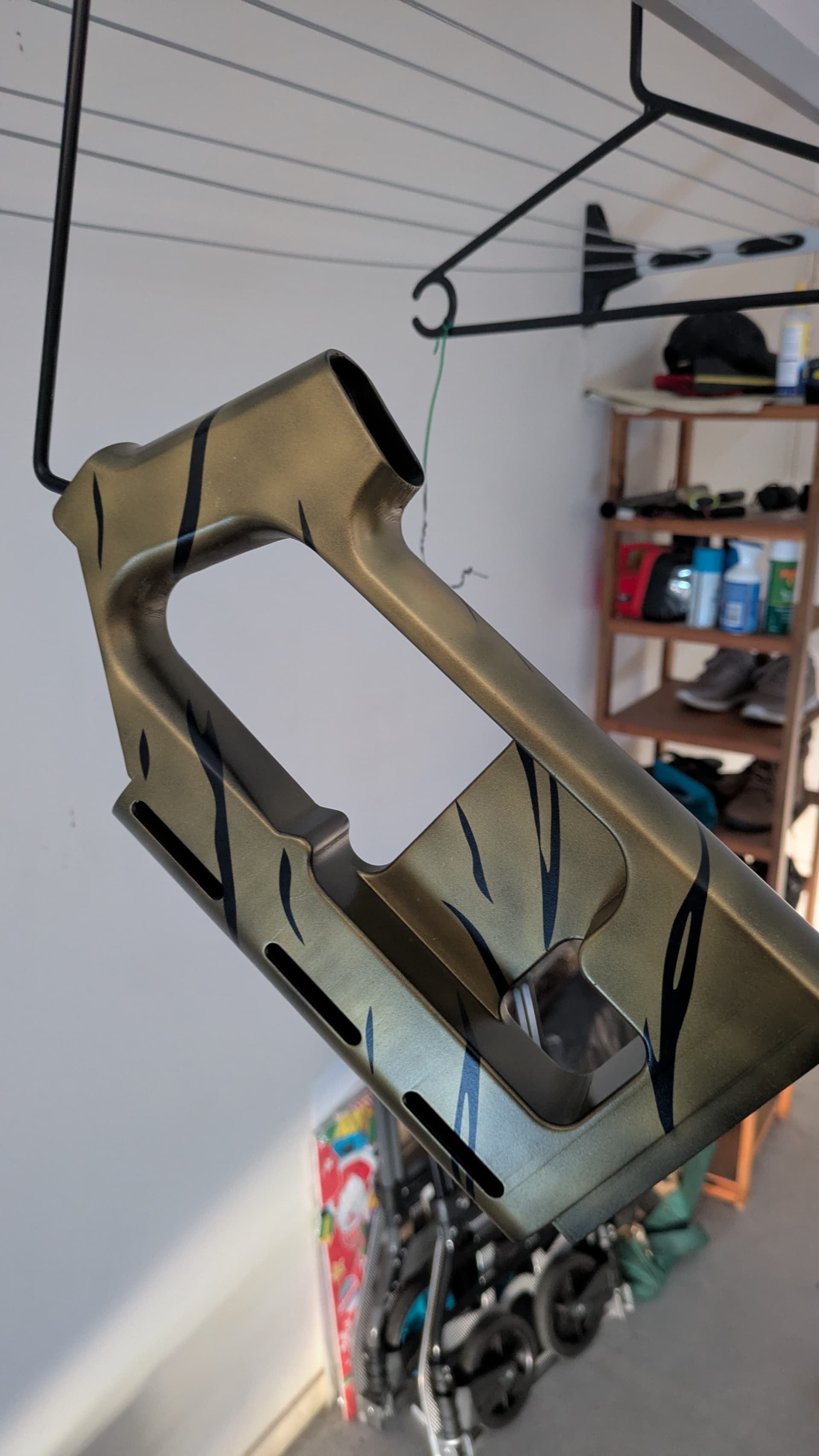

I was just doing it in the garage due to it being windy outside, but definitely needed a mask or respirator.
This was the first time using SMS paint, last time I used the airbrush you had to use thinner for them, came out pretty good thou I think, even thou the airbrush I used was a cheapy with a slightly bent needle. If I get a bit more involved I might invest in a proper compressor and airbrush but for now my little AIO from Jaycar does the job.
For this job I just used Rustoleum flat black as a base, what I typically use as a base, did two coats of the gold, giving a gentle rub with some sanding mesh to take any fur off between, then again with two coats of satin clear.
I’m not a fan of shiny glossy finishes so I don’t use them but I believe a glossy base closer will give a brighter top coat regardless if it metallic or not.
I usually leave overnight to dry just to be sure, depends on how thick of a coat you do, ambient temp, humidity etc etc.
Sometimes I’ll just hold the part with gloves on just be able to move it how I want, over also just used those thin green garden stakes before, turns out they’re just the right size to fit inside an outer barrel suppressors and sit form enough to be a me to rotate it etc.
Airbrush cleaner also doubles as weed killer too :wink:
