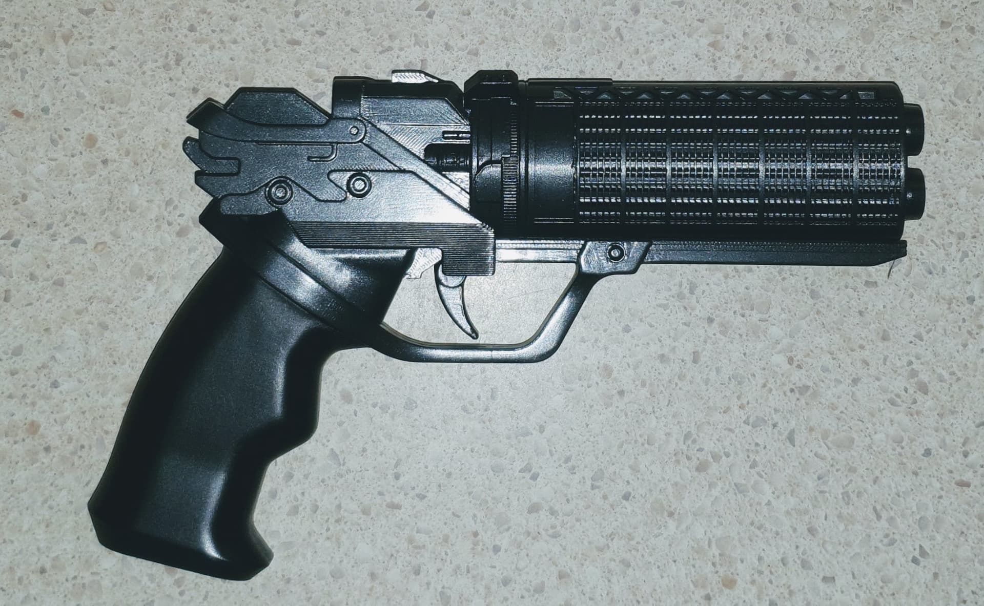

You’ve seen this already @BME , but for general consumption…
K’s pistol from Bladerunner 2049, 3D print.
Comes up alright sanded and painted… trigger guard’s tight so I think it’s scaled down a tad from the OG movie prop but print quality is pretty good. Not a lot of sanding required.
For the price of entry well worth it if, like me, you’re always looking for something to keep your hands busy. :person_shrugging:

looks Good…!!

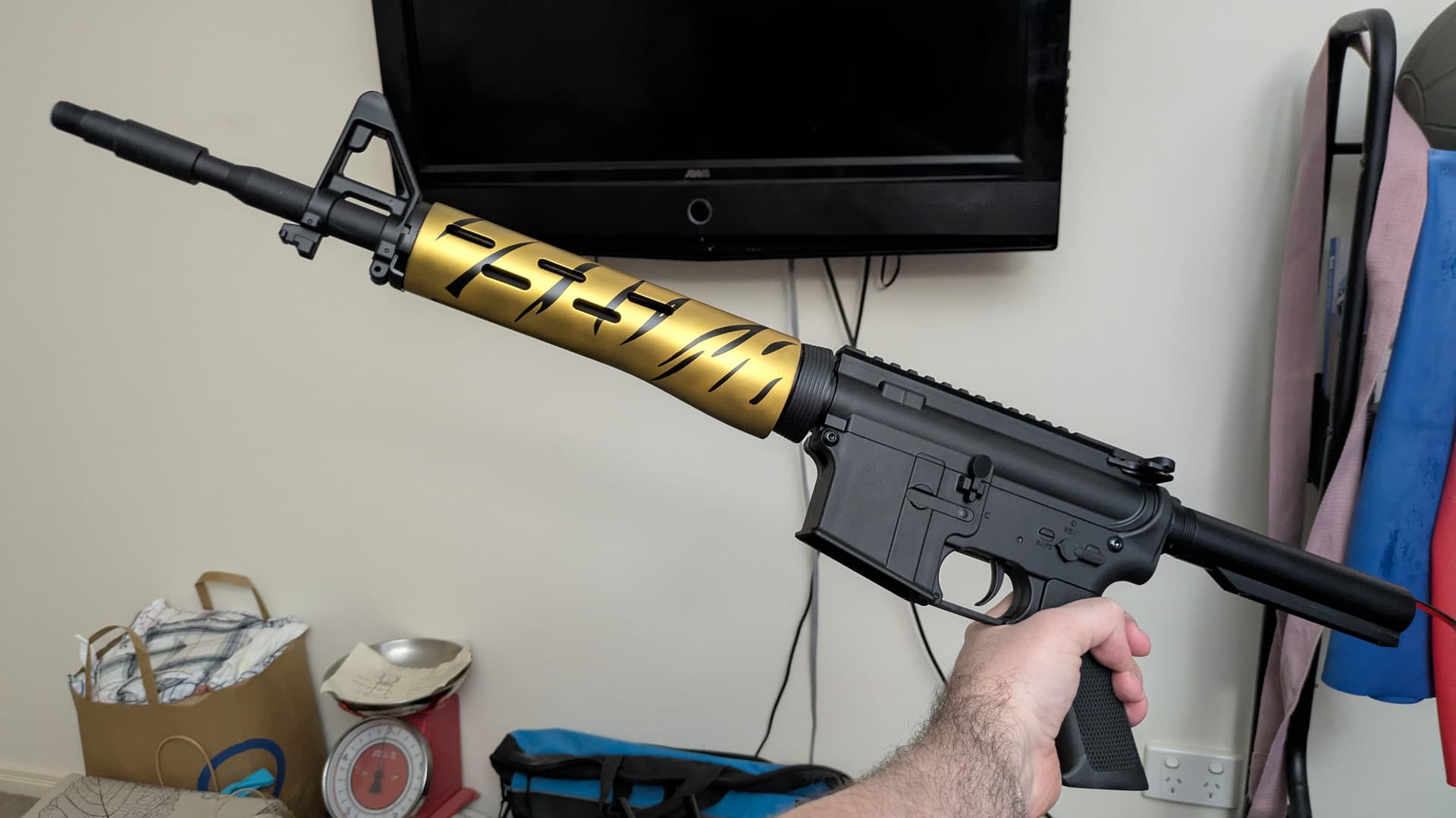

Now, just gotta find a MG-42 3D print file, that fits a v2 gearbox…!!
I’m just kidding…
It’ll need to fit a V2.5 gearbox…!!!
Fits but a bit looser than I thought it might be, will have to figure where and how to pack it out a bit so it’s not gonna wobble.

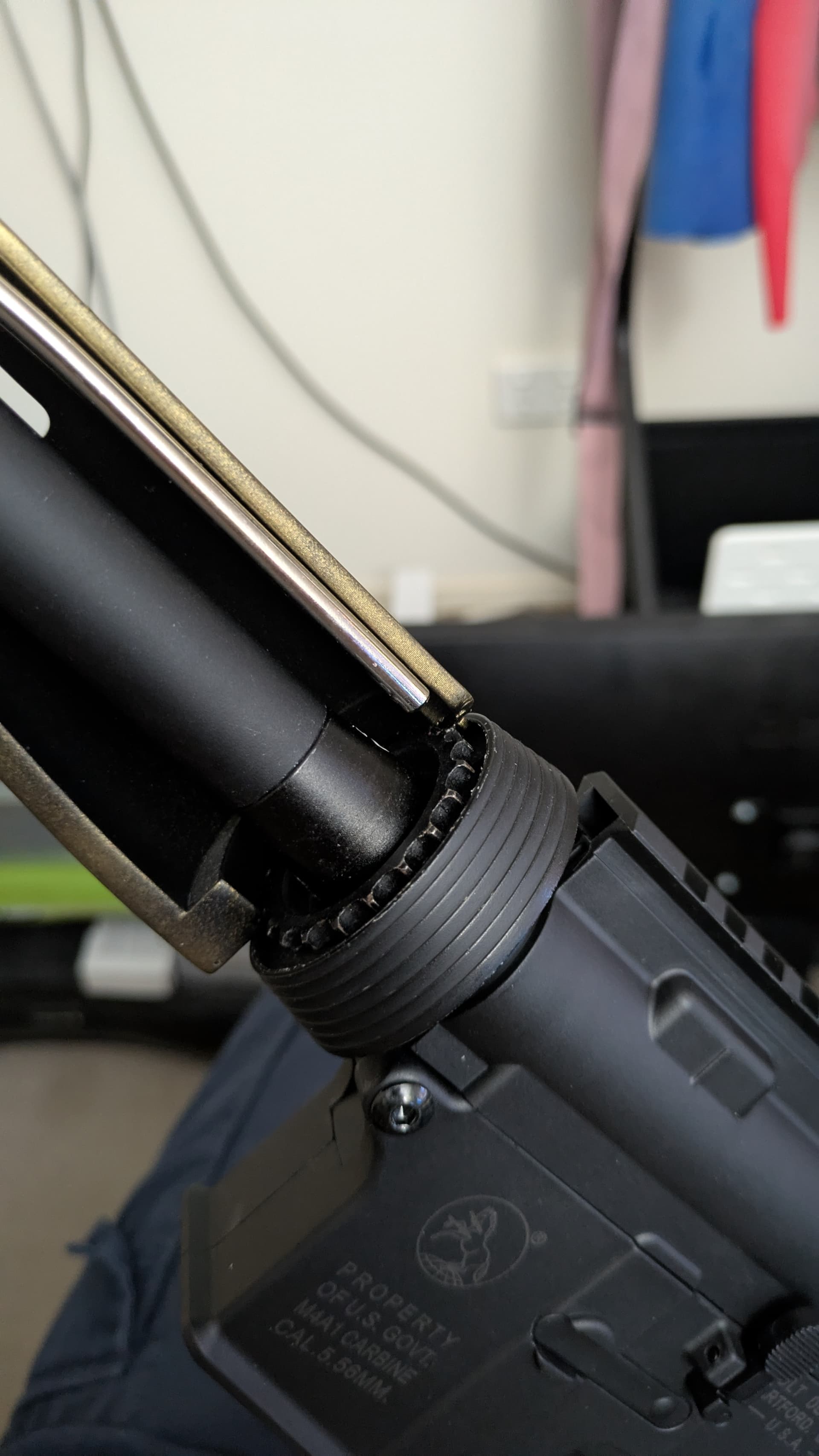

Had to replace the delta ring cause the stock one was all plastic and sheered some of the teeth off with the wrench getting it off, had a metal one on hand though.
Might try and extend the fake gas tube to help with keeping it aligned, a meer cm off…

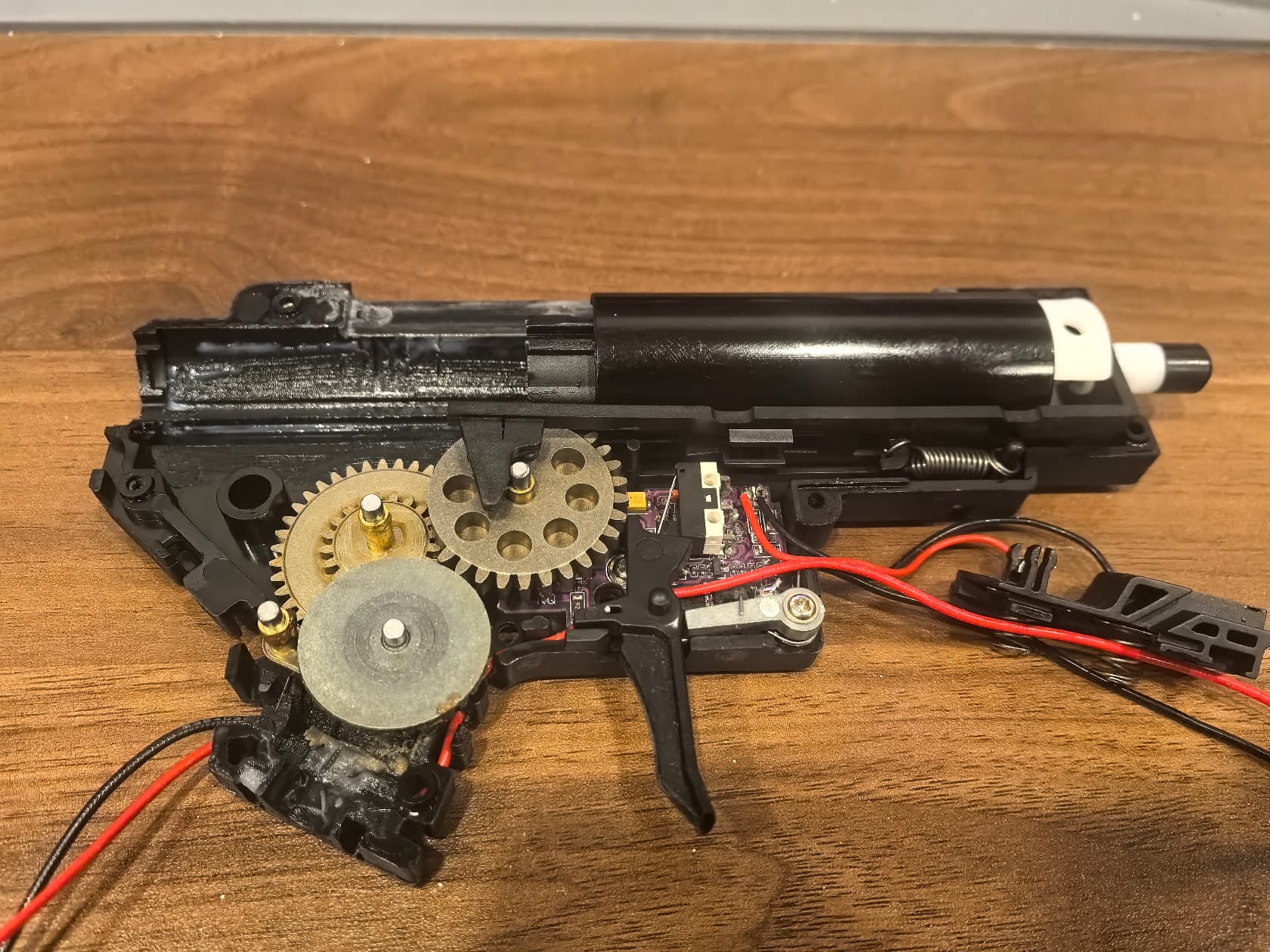

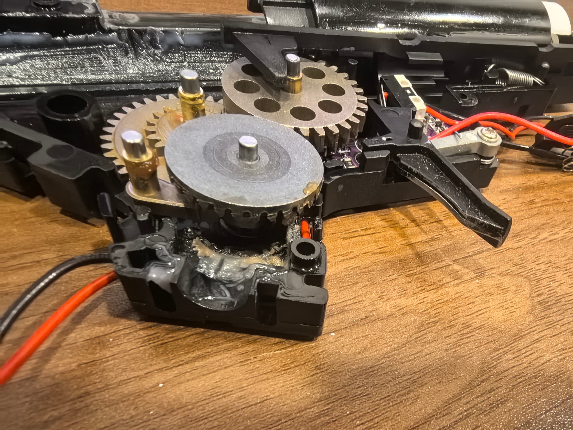

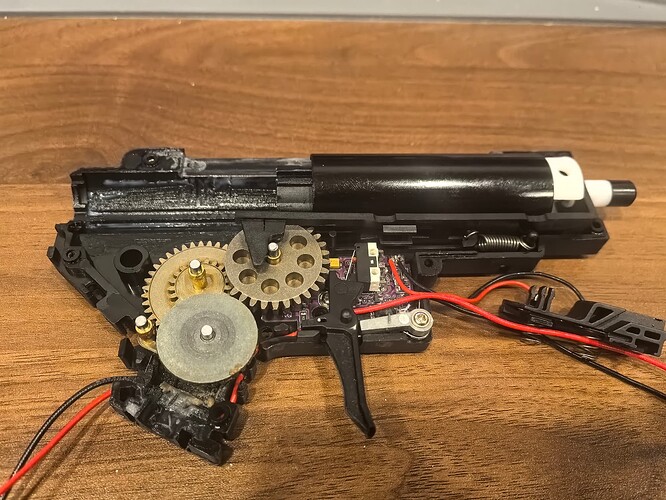

Welp, cracked open my ZY Sig 563 for a bit of modding, looks like the gearbox is actually very standard V2, but the LDT mosfet doesn’t fit… so just wiped down the inside and put the stock mosfet back in. I was scared of it being over powered so decided to go with 3 teeth short on 18 gears, but even with an M80 it was just around 65 to 70 mps. Might switch the cylinder and see if that helps a bit, ideally would like it around 75. Tpiece was annoyingly not standard, so had to grind the IFP tpiece like I was doing wood carving to finally make it work, but not sure on the air seal there.
Some interesting notes:
  1. The lube inside was orange, not the standard blue you usually see
  2. The cables for the motor went through a hole in the side of the pistol grip, not through the middle like it usually is, so switching grips would be a bit annoying
  3. Only one bearing on bevel gear, both spur and sector were bushings… couldn’t get them out though, was scared I was gonna snap the nylon gearbox

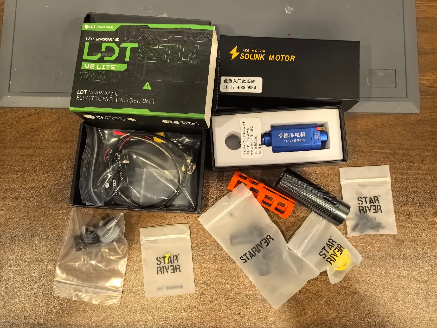

Still to do:
Glue the inner barrel to tpiece, I got lazy and just wrapped it with plumbers tape, but the back and forth fiddling has loosened it already. Might just get a new gearbox so I can use the LDT mosfet - chance to try the 20 RMB nylon gearboxes from XYZ lol. Either M90 spring or get new gears and piston. Could get a longer inner barrel since I’m using a suppressor, but that’s quite annoying.
