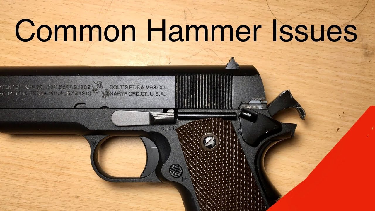

Great little bit of video for anyone with a Hi Capa. :+1: should be a big help.
They’re pretty simple, but it’s easy to see how %99 of the problems come from incorrect reassembly. Understandable that the first time you pull a trigger group out and everything just flops around can be a little intimidating for new players. :wink:
Most problems with 1911 and hicapa that are not seal issues are usually the tri-leaf spring related. Problems occur much faster with a blaster that is left cocked for longer periods. Always de-cock when not in use.
Also almost impossible to tell if the spring is shaped correctly visually, and a bit of trial and error is required. It is much easier to get a replacement, though sometimes you need to do a bit of bending to get it working too.
