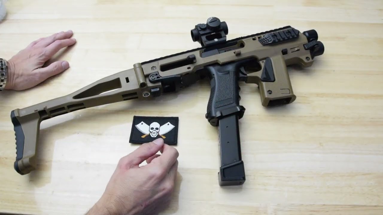

Little bit of blade scraping to get rid of the shitty flashing and I reckon it could be a fun little thing.
The one LG reviewed came with a G17, but X-Force are selling the carbine kit alone for $185.
Only problem is my G17 SAI is a Double Bell and 20 round mags aren’t available as far as I can see. :man_shrugging:
Bit cheaper than the $480 I saw the included one for.
Pity about the mags, speed reloads here we come :thinking: :joy:
