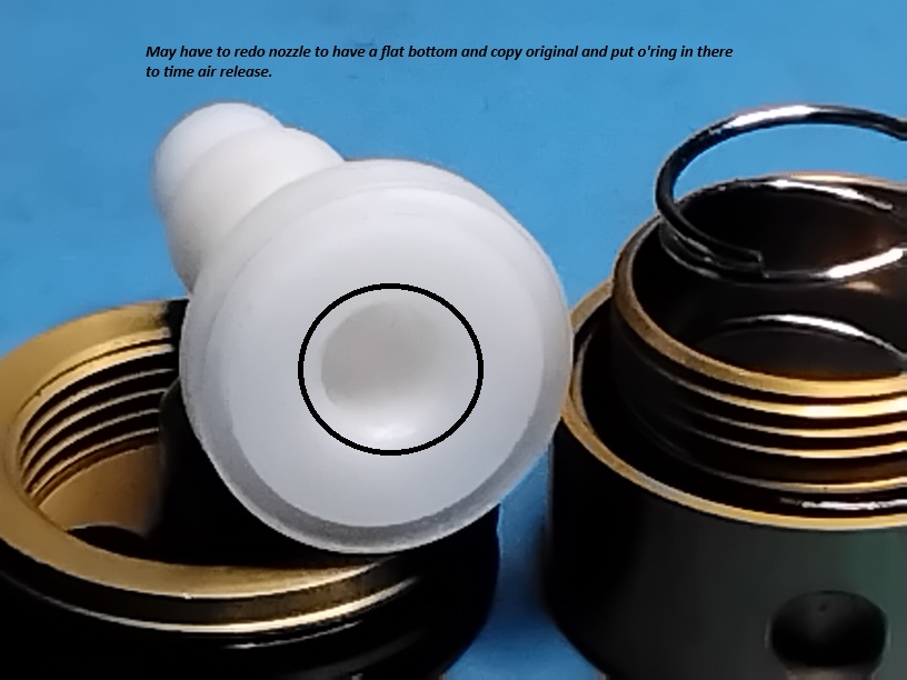

Little project today to eliminate o’rings.

I’ve always wondered how a well toleranced pom nozzle with matching alloy cylinder head would go, as the right tolerance would seal pretty well and require almost no lube (ouch)
