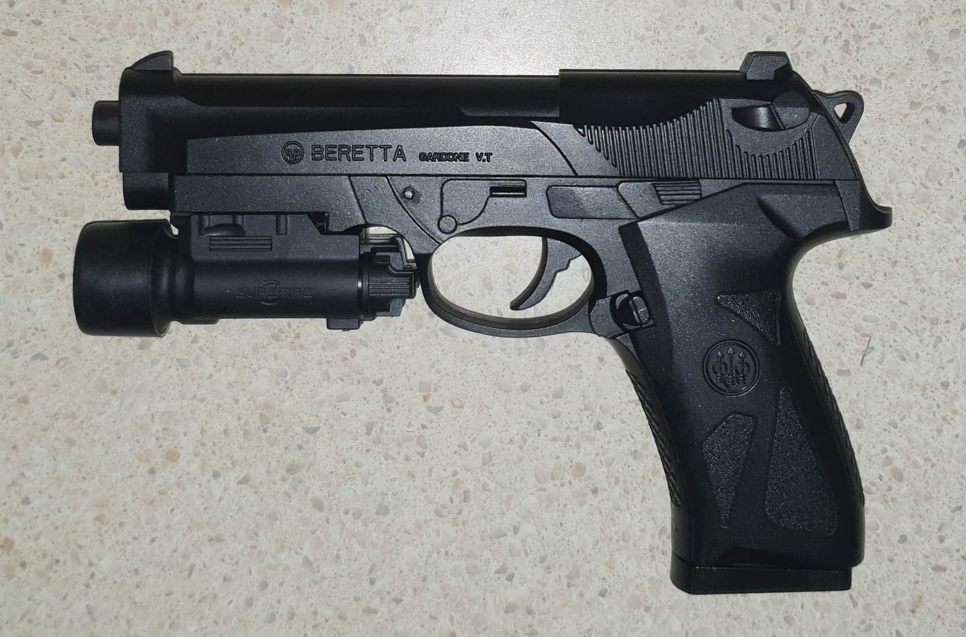

It’s been a day for electric pistols, that’s for sure :rofl:
This might very well be one of a very few fully functioning SKD Beretta M90TWOs around these days. Satisfying to dust off the cobwebs and see it choochin’ again on 14.8v :+1:
New MOSFET with a spare put away, on the hunt for new gears to have as a backup set… or two. Pretty shiteful performance at 140ishFPS but not bad for five years old… go too heavy on that spring and the gears will strip. :wink:

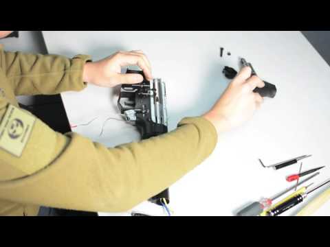

I couldn’t find a teardown vid…so i’ll just poke along and see how i go…
Thanks…!
Might get you started, Beemer…
Thanks for the vid…

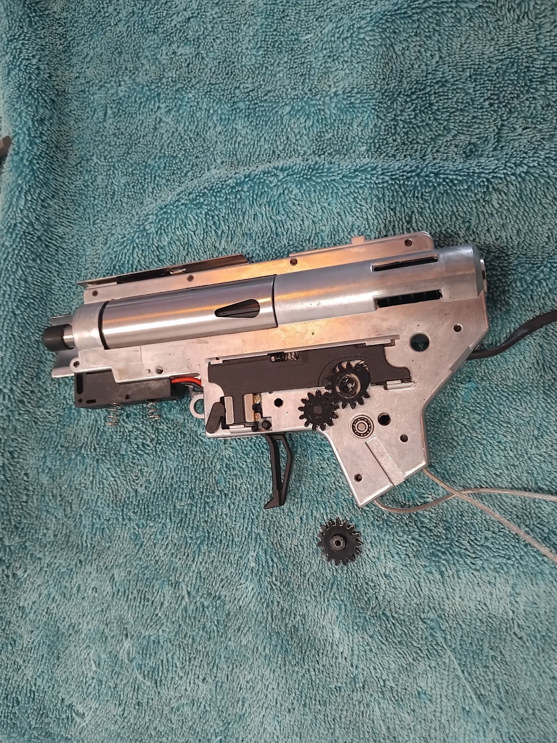

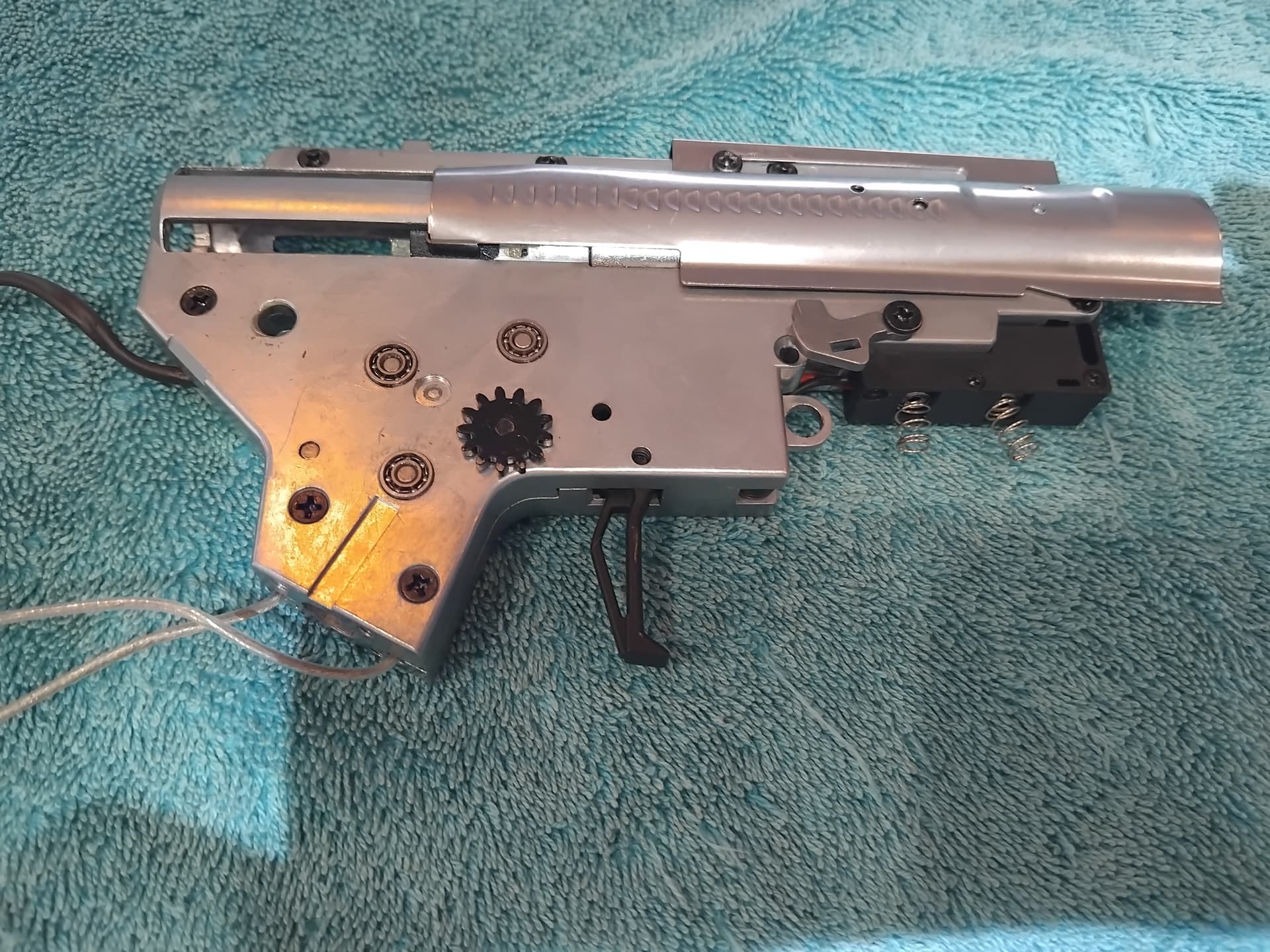

ok…got it pulled out, but not apart…
Question 1: where does this go.?
When i pulled it out, it fell out…unsure where it exactly goes…
it doesn’t seem to go on the other side…
Also, how do you get the remaining gears off.?
Ambi connection is holding the gearbox together…
That is the ambi through gear set.
I removed mine as it annoyed me as it did to you and fiddly to get back together.
You only need the selector plate on the left side to keep the left side selector.
Split the gearbox and pull all of those exterior gear sets out and line the bin up and bye bye headache. :joy: Flathead screwdriver from memory to pry the exterior gears off.
Loose ambi of course but for me the headache was not worth it. Put a standard SHS non ambi selector in to work with the selector plate, and selector plate too if needed.

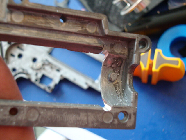

Yours looks exactly the same as mine. Where the cylinder sits, the cast box, those corners there are not radiused to lower the chance of cracking. Yours is not cracked I can see so that’s good.
The spring in mine was more like a M120/140 front kingswood coil spring. 1.4mm wire diameter.
Take photos as you go to reference on reassembly. You’ll be right tiger :+1:
This is a reference pic to radius the gearbox to reduce the chance of cracking. Out with the grinder yeehah :rofl: :+1:

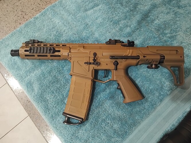

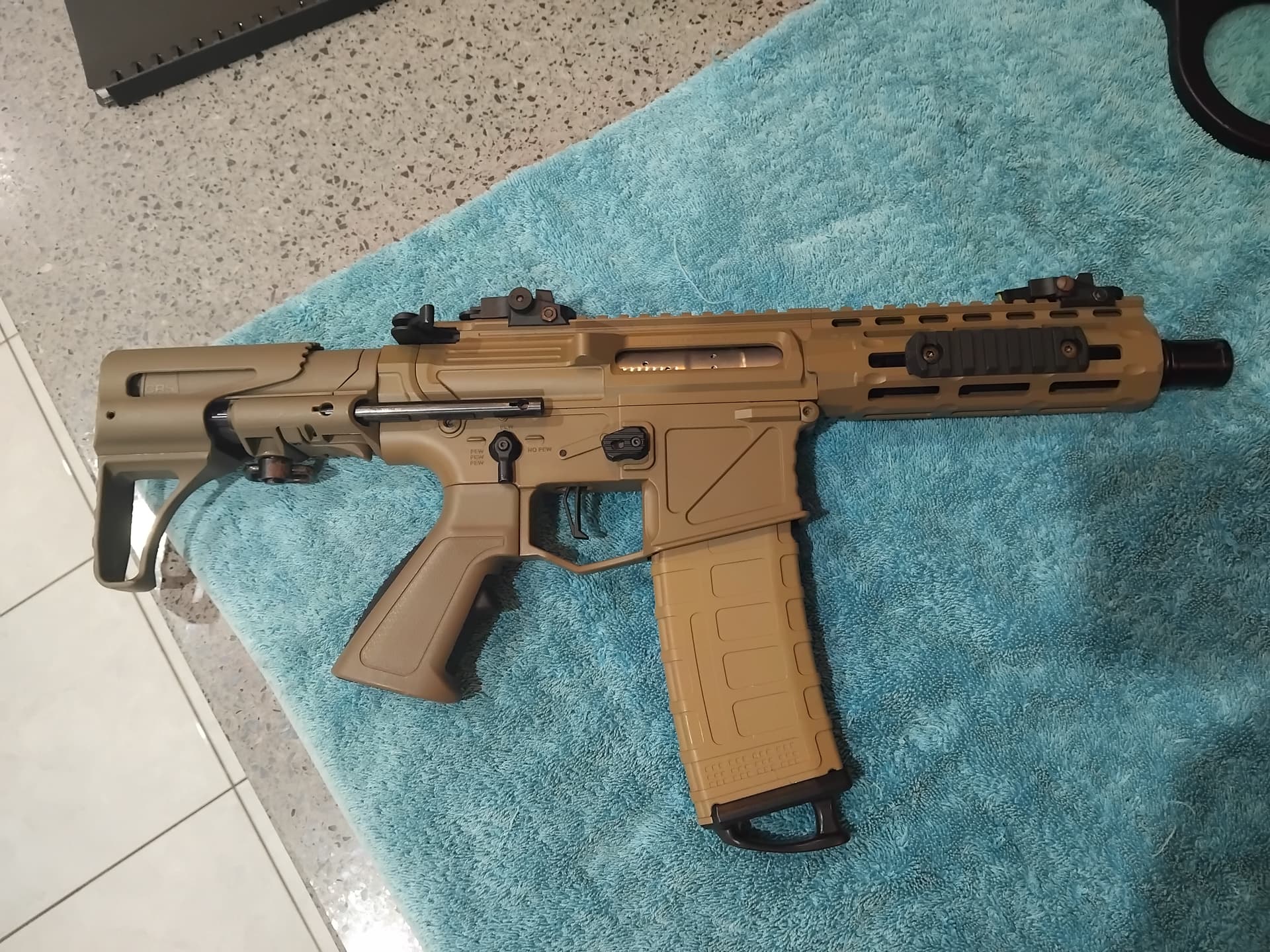

Tan APC-9k out of stock currently…
I was SCARless, before this…
it needed a minor fix.
Power wire connector, came adrift in the stock.
Easy job. to pop the stock off, and reconnect it.
Not a pin, just circular metal wire loop…careful not to deform it…

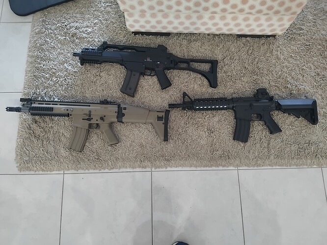

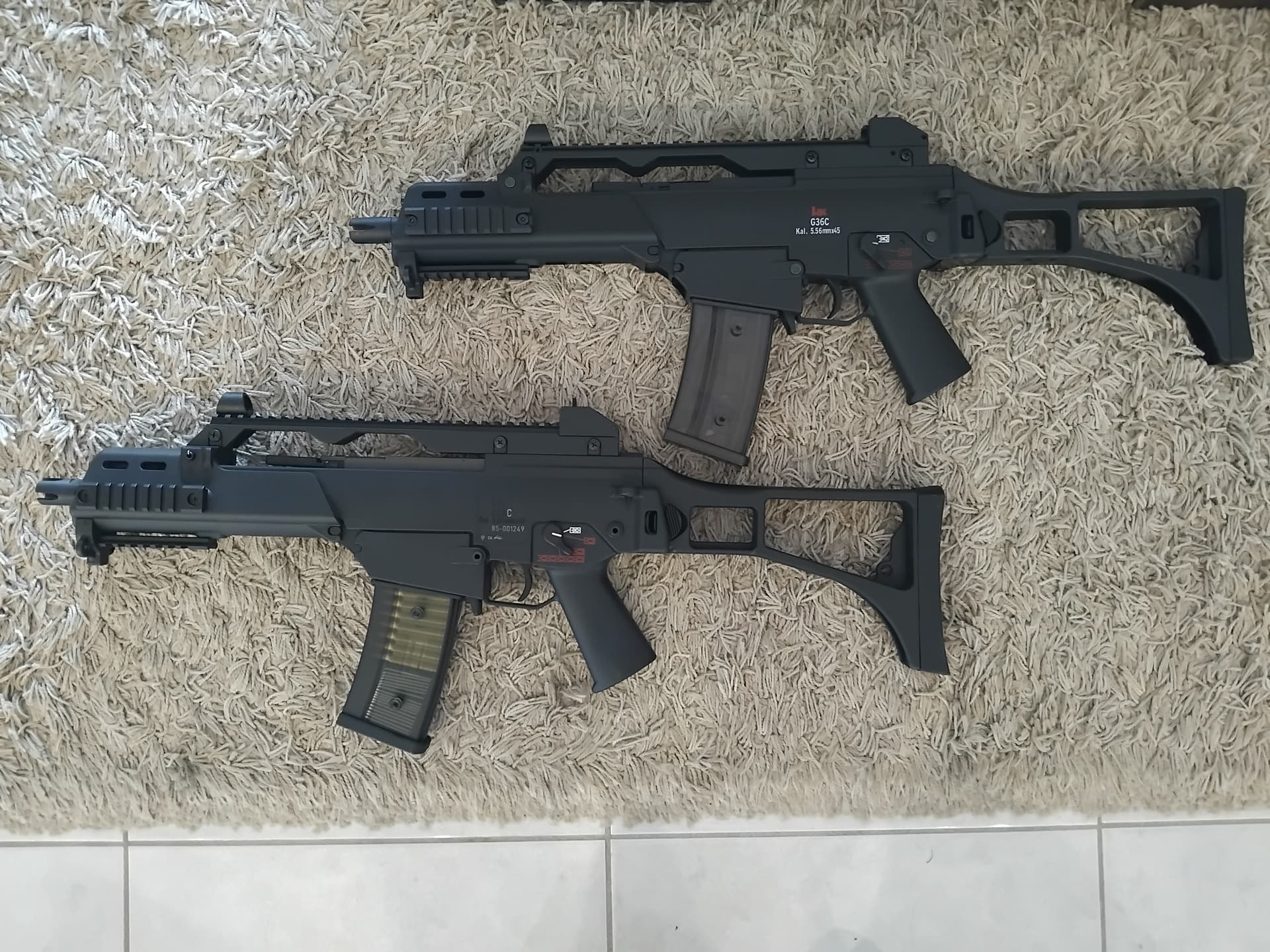

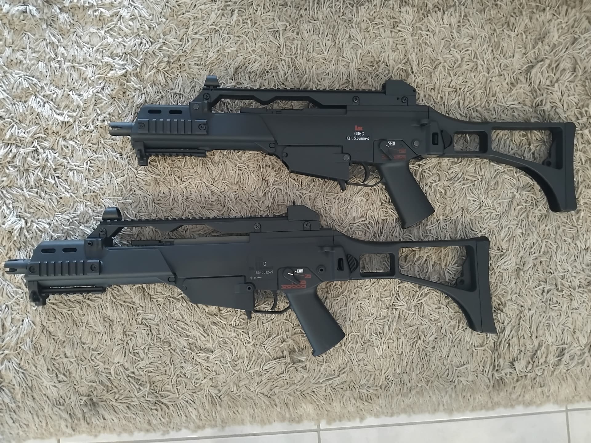

without mags, can you tell which is LDT, which is Cyma.??
the mags give it away…
And no, not compatible…
LDT is a 360 fps machine OOTB…
Reviews coming later…
LDT on bottom? The G36C labling near the FCG on the top model doesnt look as clean as my other LDTs.
