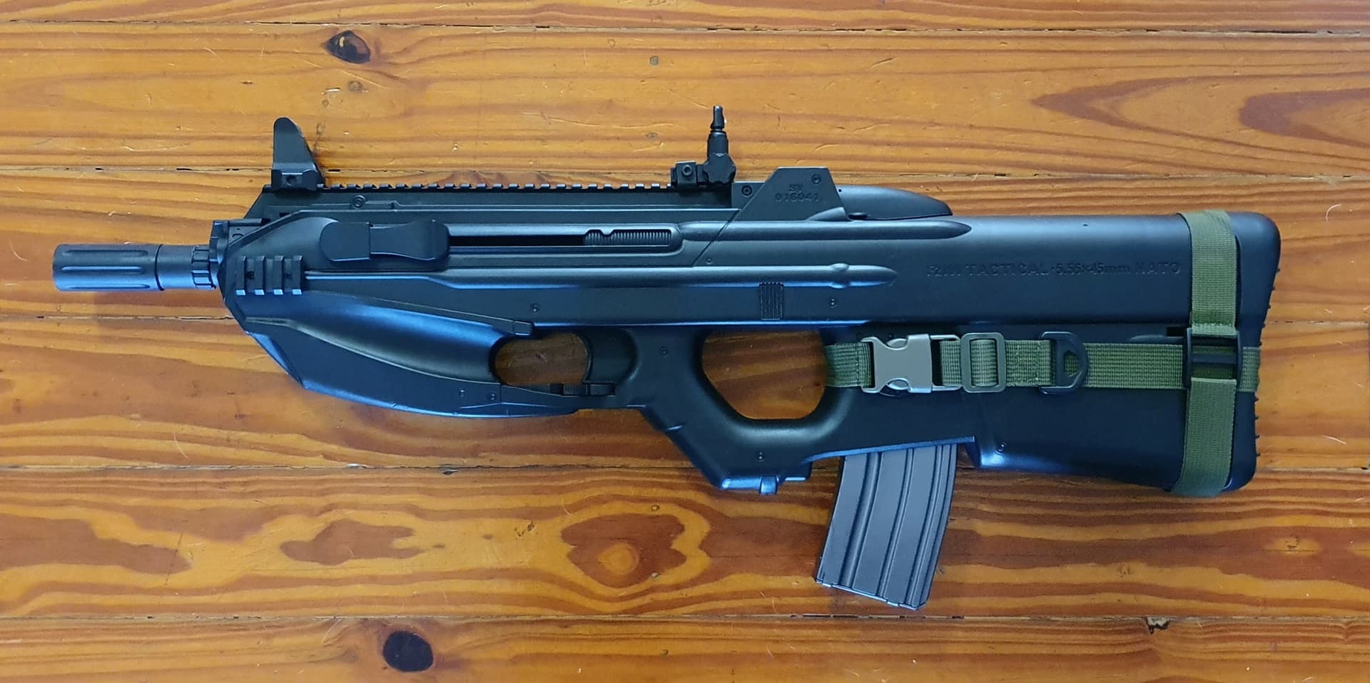

But you still don’t have an F2000… :grin::grin::grin:

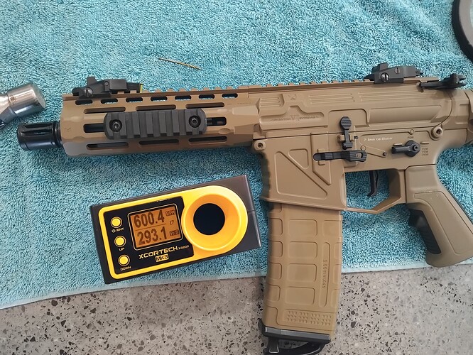

It would work intermittently. If the wires happened to touch.
It wanted to sit, in the touching position. Very Touching…!! They wanted to be together…!! :rofl: :rofl:
Easy enough to fix, stock off, and frimly reconnect.
They may get prised apart again, if the wires get caught as you extend the stock…
Well, that was worth the exercise…
And, preserved the ambi-select.!!
All still a bit nerve wracking every time you do it…but a bit less so each time.
Each blaster has its own unique little quirks…
Air seal was pathetic, o ring was more withered than squiddy’s tentacles after a hour in the rock pools, at low tide.
New o-ring, bit of grease on the gears, New M100 and all back together it goes.
I was a bit nervous to see if the semi was in the correct position / lined up properly…but it was.
Phew.
Cycles between semi and auto normally, and ambi function preserved.
I’ll call that a win, for today…
Still bloody loud though…
Yes the loudness is what we call piston hammering at the end of stroke at a good guess without laying hands on it. It’s what helps crack the front off.
Why the Wells V2 cylinder head is a good upgrade for the APS as it has a pad and 2mm extra stroke in the tappet/nozzle for the bigger gel ball.

Pull it apart again, radius the gearbox , and re-try…

I agree with @Maiphut on the ambi select. Ditch it.
I’ve disabled the ambi fire select on nearly all of my blasters because I ain’t a lefty.
I’d much rather have a crisp and positive right handed fire select that works than a janky amby setup that’s about as positive as Albanese when he’s being questioned about US tarrifs.
today, was about seeing if i could…
one step at a time…!!
It’s easy.
You have to take off the ambi to get the box out anyway, just don’t put it back on. :wink:
Ambi is normally fine if you don’t use it, they just aren’t designed to last for lefties.
Basically applies to all ambi blasters even those with metal cogs.
