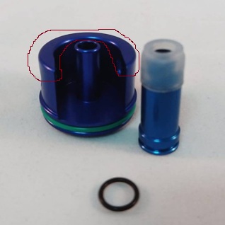

Before I forget @BME if you ever do go the wells cylinder head in that APS Phantom extremis(most places have them X-force etc) you’ll need to file the front face down to get it to fit on the location pins.
This area…
WELLS
That I very expertly highlighted in red. :joy:
I used a flat file, try not to score the nozzle and file a bit and test, file a bit test, wash, rinse and repeat until it gets in like Mrs Marsh :joy:
But you have great results from a bit of maintenance so I wouldn’t bother for now. :+1: Maybe if you get bored one day :+1:
I used to attack them with another method, elongating the locating holes with a small round Jewellers File to get them to locate into the dowels. :grin:
You can do it that way but then you’ll have to trim your cylinder down on the APS iirc. :thinking:
To fit an aftermarket 72mm cylinder. The standard APS cylinder with the teardrop port is 70mm.

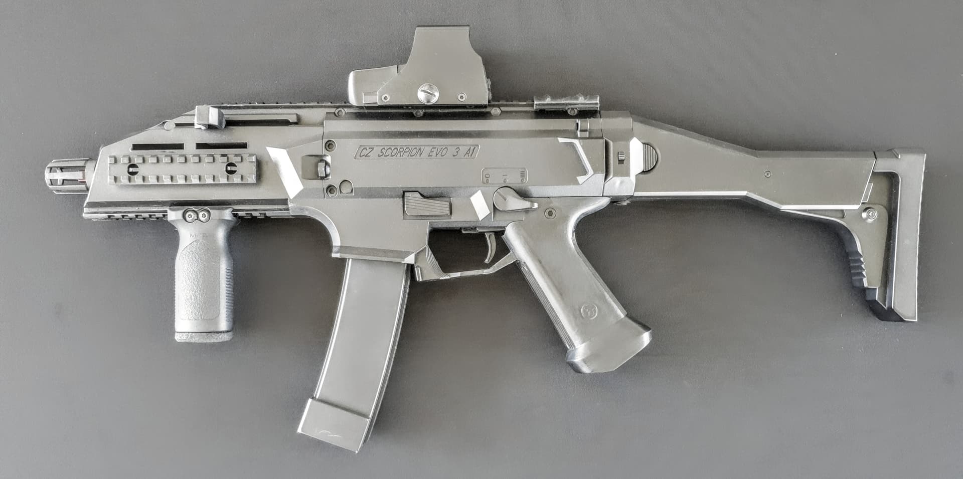

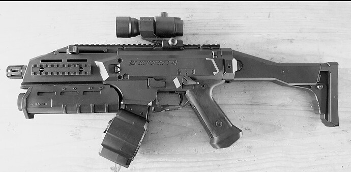

Time to freshen up the EVO3
Revisited the forward wiring, the battery now resides in the MOE vert grip, gives a cleaner Scorpion look. Much better aesthetic than the Magpul slide previously used.
Building up a full bore Singularity box for it, target FPS around 350, easily acheived with a Gen 8.
It may be old, it may not be high quality, but it’s one of my favourite SMG platforms… and I have a ton of stick mags for it… and a drum mag :wink:
An oldie but a goodie! I also love my older gel blasters, especially my gen 8 SCAR :star_struck:…can’t go wrong with a gen 8!
I agree :100:
Despite the latest Gucchi offerings I still like my old school units. Must just be the nostalgia… :wink:

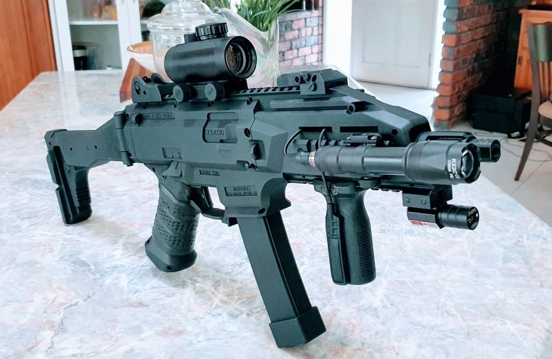

Soooo……
Nice primer.
You gonna paint it black??!?
What shade.??
Inquiring minds, and all that…
:rofl::rofl::rofl::rofl::rofl:
It is black…
That’s just the way it looks on the Table Of Refractionary Wonder. :rofl:
That black enough for you? Inside photo…
Couldn’t resist…!!!
Oohh fuck yea, now we are talking :wink:
You need to get your eyes checked or something. :rofl:
