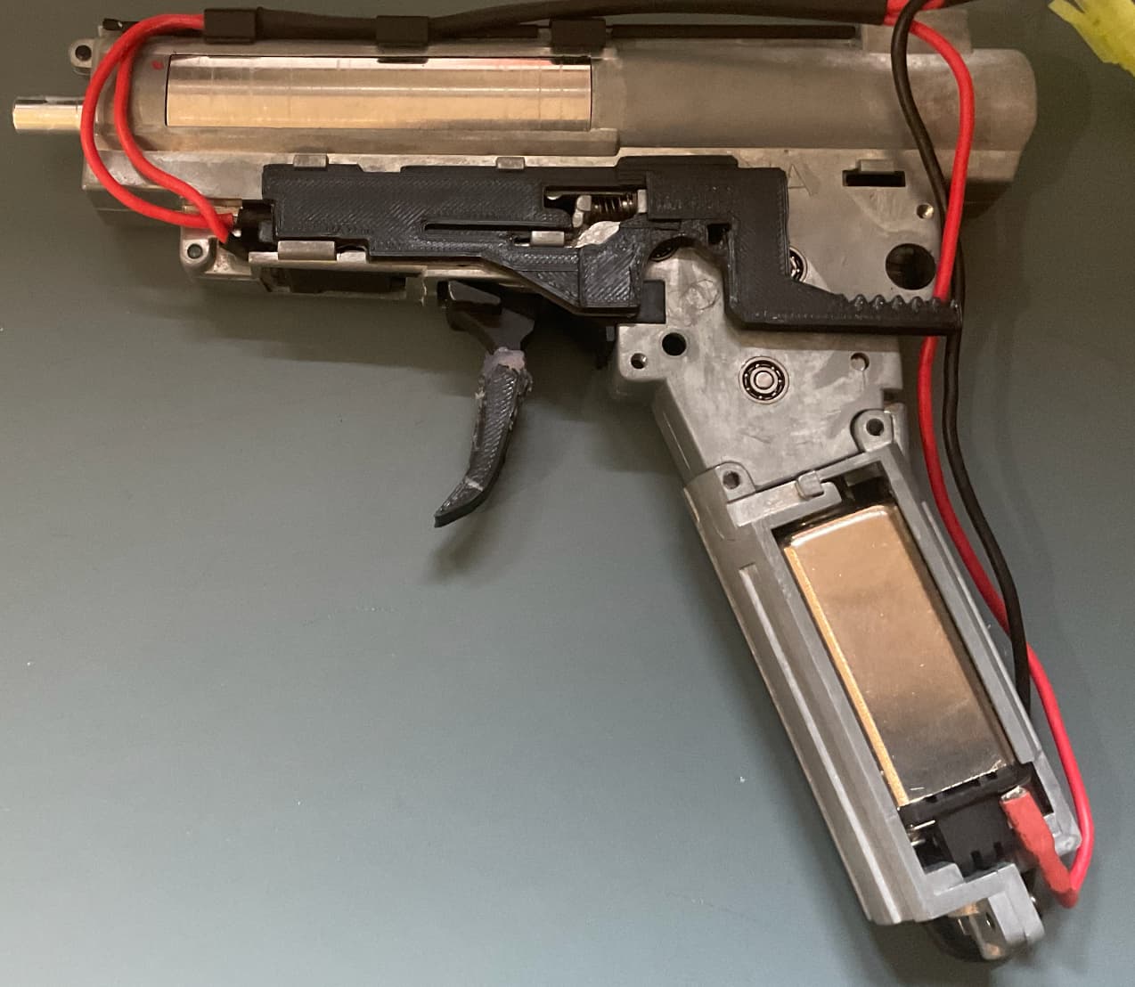

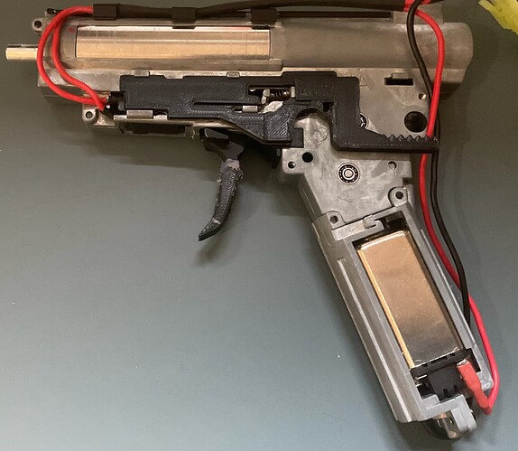

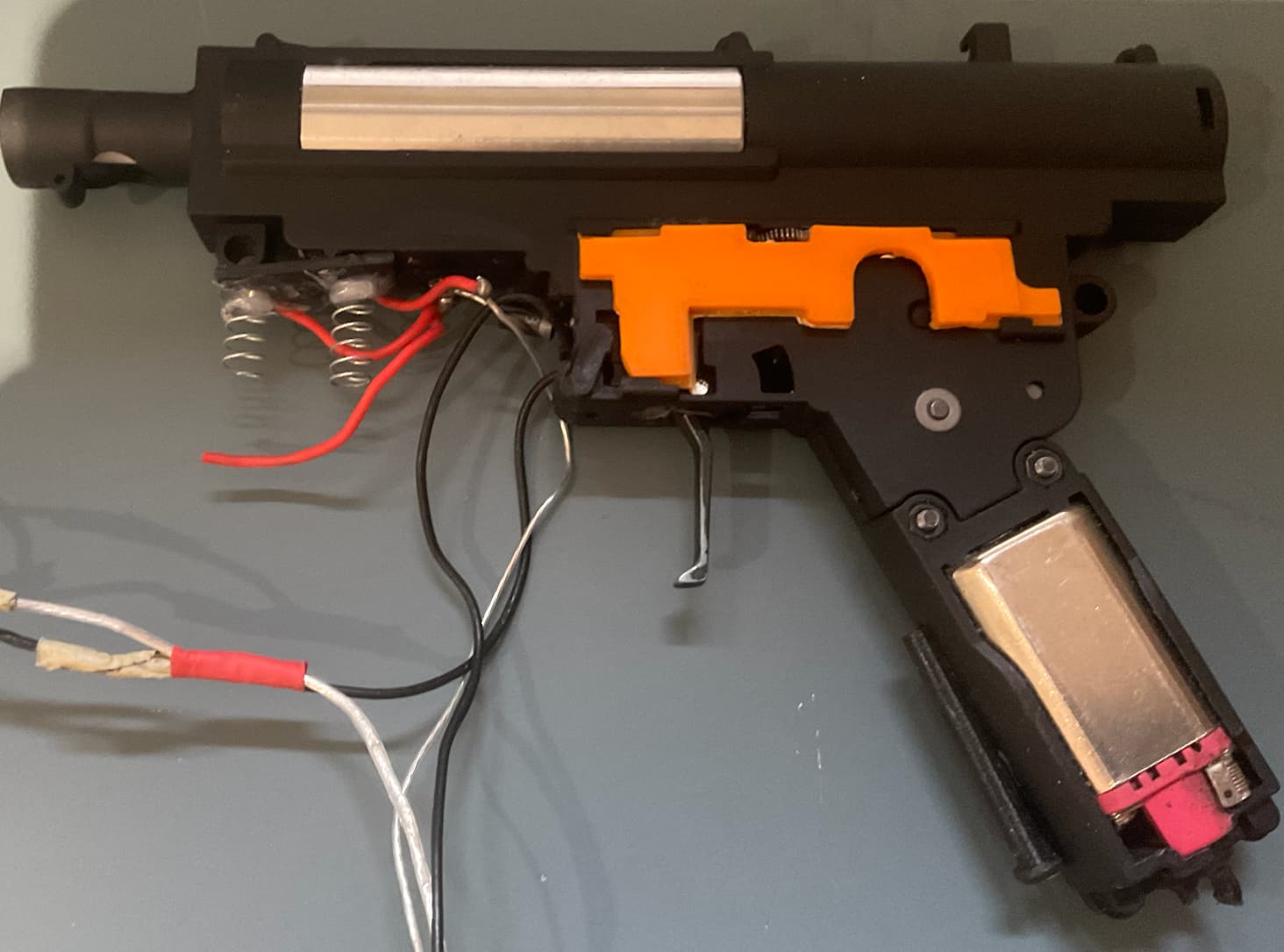

I just decided to do yet another gearbox change to my SCAR gen8. Yes, I could just get a different, better quality SCAR, but the gen(not so 8 :rofl:) SCAR is a classic. Before, I had put in that unknown nylon gen8/9 hybrid gearbox. With the help of hundreds of 3d printed prototypes, I had finally got semi on my gen8. Now, a nylon gearbox is not enough, and my SCAR must go through another long and painful gender change :rofl:. I’m putting a steel v3 AK airsoft gearbox, since I don’t have access to steel gel blaster gearboxes. This project will be taking a couple weeks, if not months (if it even works out), so wish me luck :sweat_smile:.
2nd Gearbox (nylon gen8/9)
(and yes, i know it looks like a piece of shit, but it works :rofl:)
3rd gearbox (airsoft AK)
(and no, that 3d printed trigger is not permanent :face_vomiting:)
As you can see, I’m on prototype 13 of the tappet plate. I have fire select completed, but safety is the real challenge, since its on the other side. I really hope this is not the end of my beloved SCAR :rofl: :rofl: :sleepy:
