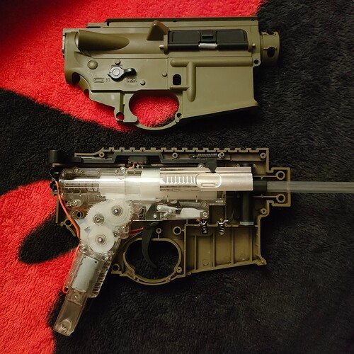

With a little help from @RokSolid @Friendly_Fire and Low Guido’s review video, I decided to pop my teardown cherry and pull it apart to trouble shoot

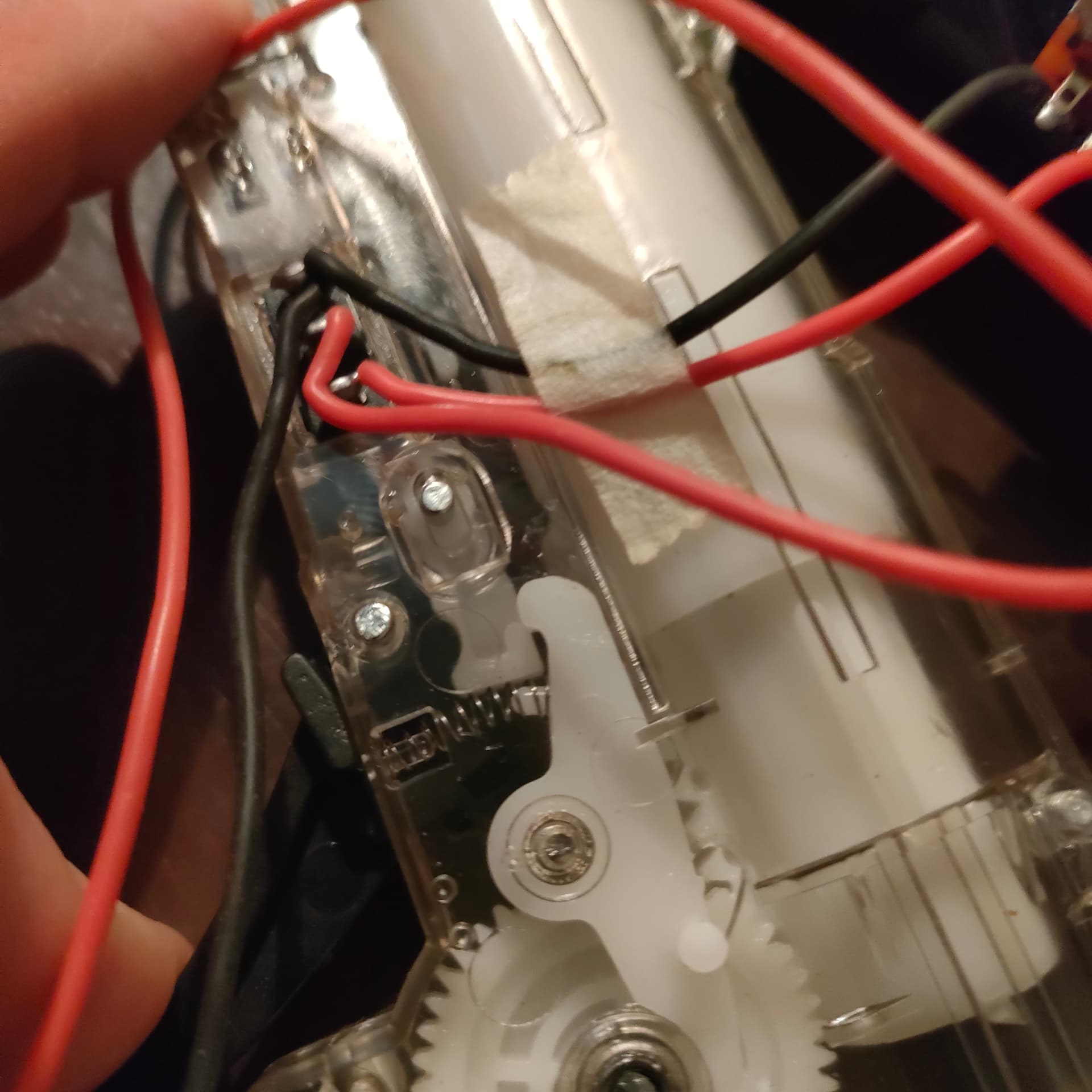

Bit of exposed wire from the battery to the motor, nothing a little electrical tape won’t fix
Long story short, turned out the mag catch wasn’t broken, just not seated correctly, rectified that issue easily
Receiver terminal leafs were back to front, very tight fit to swap them back around the correct way but got it done with a little effort, not much but did have to take care
Was not ready to pull the gearbox apart :sweat_smile: baby steps again lol, but that will be my next venture
Tested the mag prime and mag catch while it was apart, quick test fire
Gels flying out the barrel across my room, success :+1:t2::joy:
Reassembled, gave it another test fire, working like it should. Happy days :call_me_hand:t2:

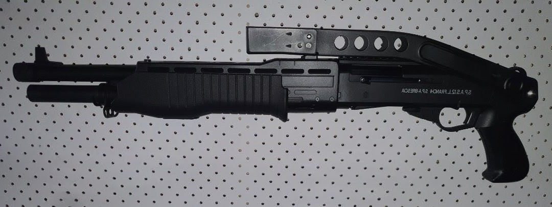

AA12 shottie shell ejector
SPAS12 shottie shell ejector
Neither one are particularly well know for stellar performance in gel form… have to see what we can do about that. :person_shrugging:
The All gel Spas aint bad….

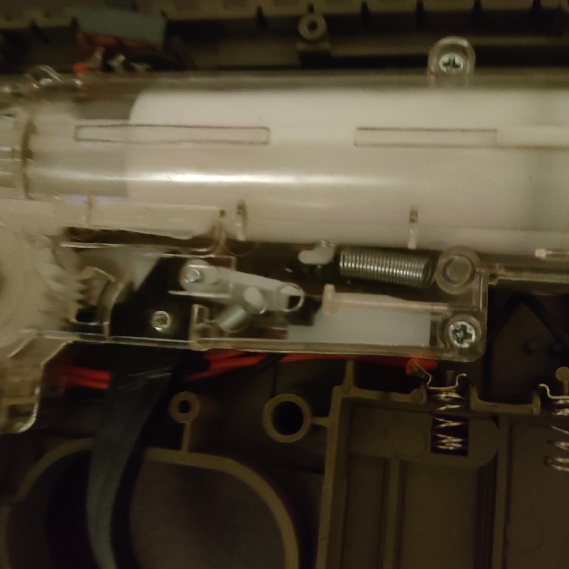

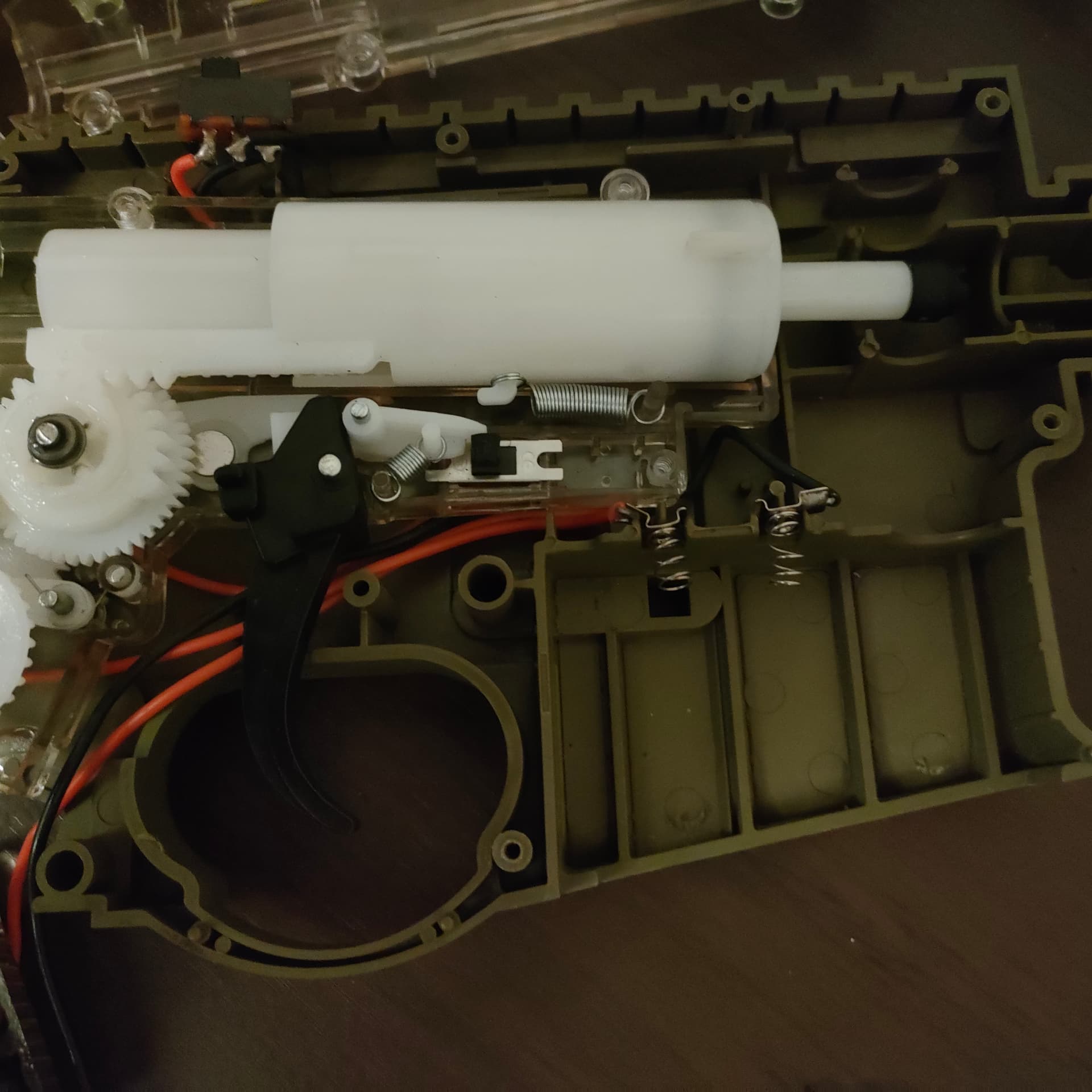

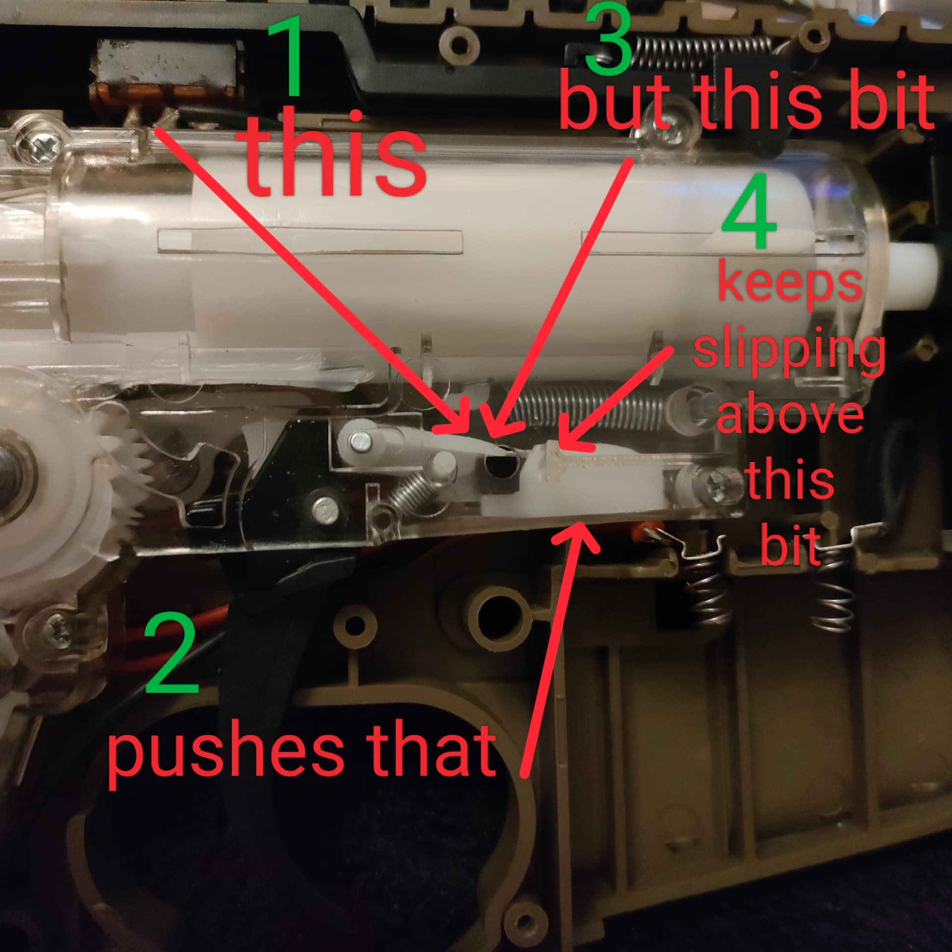

The young fellas LH HK416

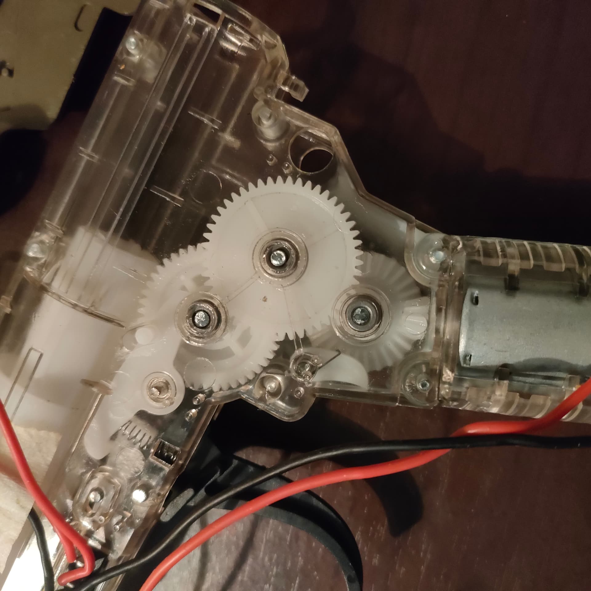

It’s having trigger response issues, firing but not feeding and sending gels… then trigger stops working.
I can see where the problem is but no idea how to correct it, looks like I’ll be opening the box to fix it but still not sure what will fix it. Everything seems to be there, doesn’t appear anything is missing, I think it’s just misaligned
I managed to get it to start firing again but then the trigger mechanism slips off of alignment and becomes unresponsive again so it’s unreliable ATM and has to be opened up again to correct it, needs a permanent fix
Any help would be appreciated, cheers

Good candidate for a gen8 conversion maybe?
This :100:% :point_up: IF you’re okay with a bit of creative fettling. It’s an identical gearbox to the boxes in the Le Hui Scorpion EVO3, pre V2. My EVO’s got a Gen 8 in it, but it does take a little creative effort. Worth it though.
Horrible trigger system, touchy on disassembly, things go boing and even worse on reassembly. But definitely acheivable if you keep your wits about you.
Easiest and cheapest fix is to strip it, get some heat into that push bar and give it a slightly more downward curve, might be a little more positive and not slip over the trigger trolley . If you do that, don’t bend it too much or it won’t clear the trolley when it’s in safe. Maybe want to give it a tickle with a file to square up the end of it too where it’s undoubtedly worn.
Totally proprietry, not really upgradeable. The good news is a Gen 8 will fit that receiver but you might have to do a bit of work clearing the shell, lose a screw post or two in the grip. The angle of the motor is slightly different and the motor is wider and sits lower but that may or may not be a problem with the 416 grip. That’s why my EVO gets a wrap of squash grip tape around the grip to keep it together, I had to lose the centre screw post to make it fit.
If your son’s loving the 416 platform, it miight be easier to look around for a good used LDT H&K 416D. It’ll be a better shell but it’ll have a War Interest V2 in it, which is a whole lot of other issues. I went to the trouble of coverting my EVO because I had no other option, if a better quality V2 or V3 EVO was available I would have just bought that. :person_shrugging:

Be happy to look at it for you, it’ll be repairable for sure, no parts needed. Gottsa lottsa miles on the clock with those gearboxes… something to do with my obsession with CZ Scorpions. :roll_eyes:
It’d be a shame to have it sitting around not working. :person_shrugging:

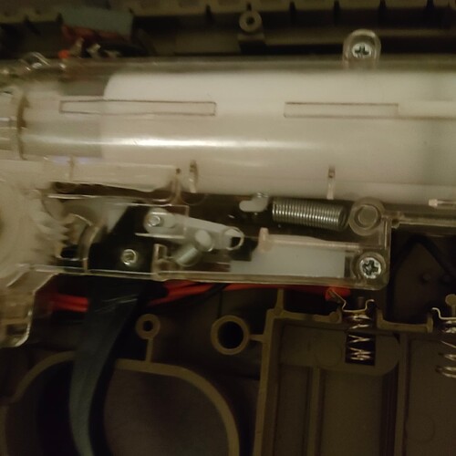

Managed to get the piece that was sitting too high to sit lower and appear to function correctly on the trolley and it’s pushing the piece it wasn’t before properly now but now it seems the switch it activates has stopped working, trigger pull activates the trolley system “properly” but it’s like the piece that activates that switch has either become misaligned or the switch itself has shat itself…
I’m thinking it’ll probably be better off just going for the gen 8 gearbox upgrade, could use a beef up anyway as well as steel or aluminium barrel but no idea where to start in looking for a suitable cheap gen 8 complete gearbox setup that everything will line up properly for
Would also be nice to not have to run the bulky asf double drum mag as well but we’ll see what happens.

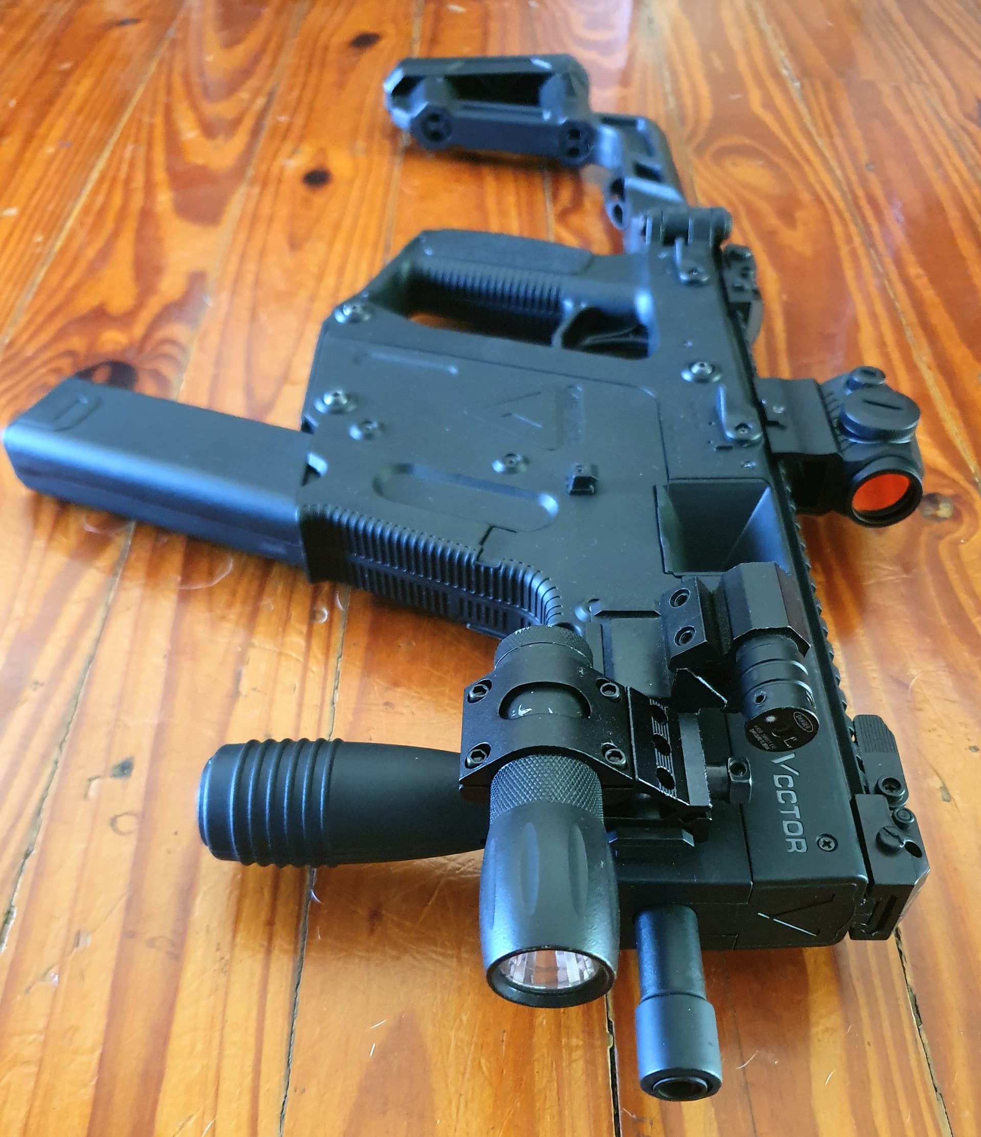

Rok’s upcoming Vector Youtube content sparked a bit of love for the ol’ girl. :wink:

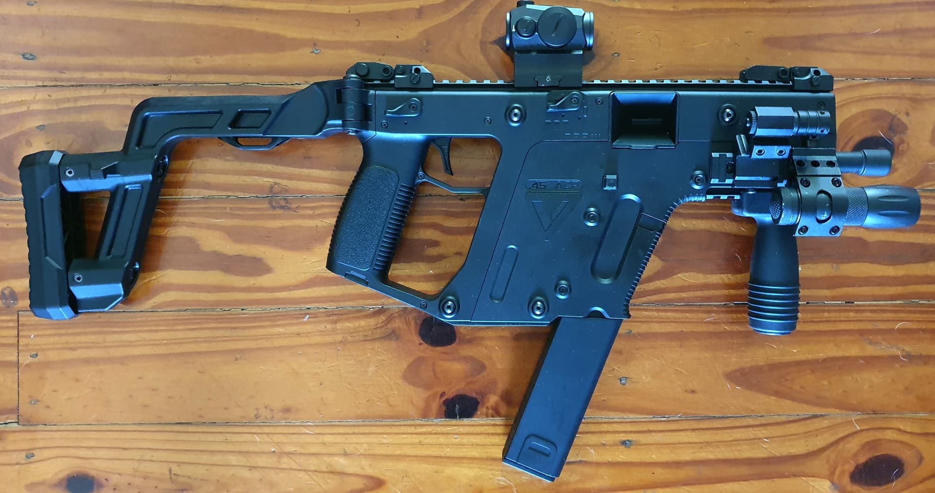

Fresh o ring, new 1.18 unequal spring, 70% cylinder, alloy barrel shortened by a couple of centimetres, integrated hop up and a few tactical accessories like a vert grip, momentary flashlight, laser and a Sig Romeo5 red dot sight to make it look more tacticool.
Solid 280FPS on a 7.4v lipo. :+1:
I’m wondering if the shorty barrels that Rok’s got with the brass hop ups would be a viable option for a Vector? Can’t see why they wouldn’t be a good fit, they work really well with the APC9Ks.

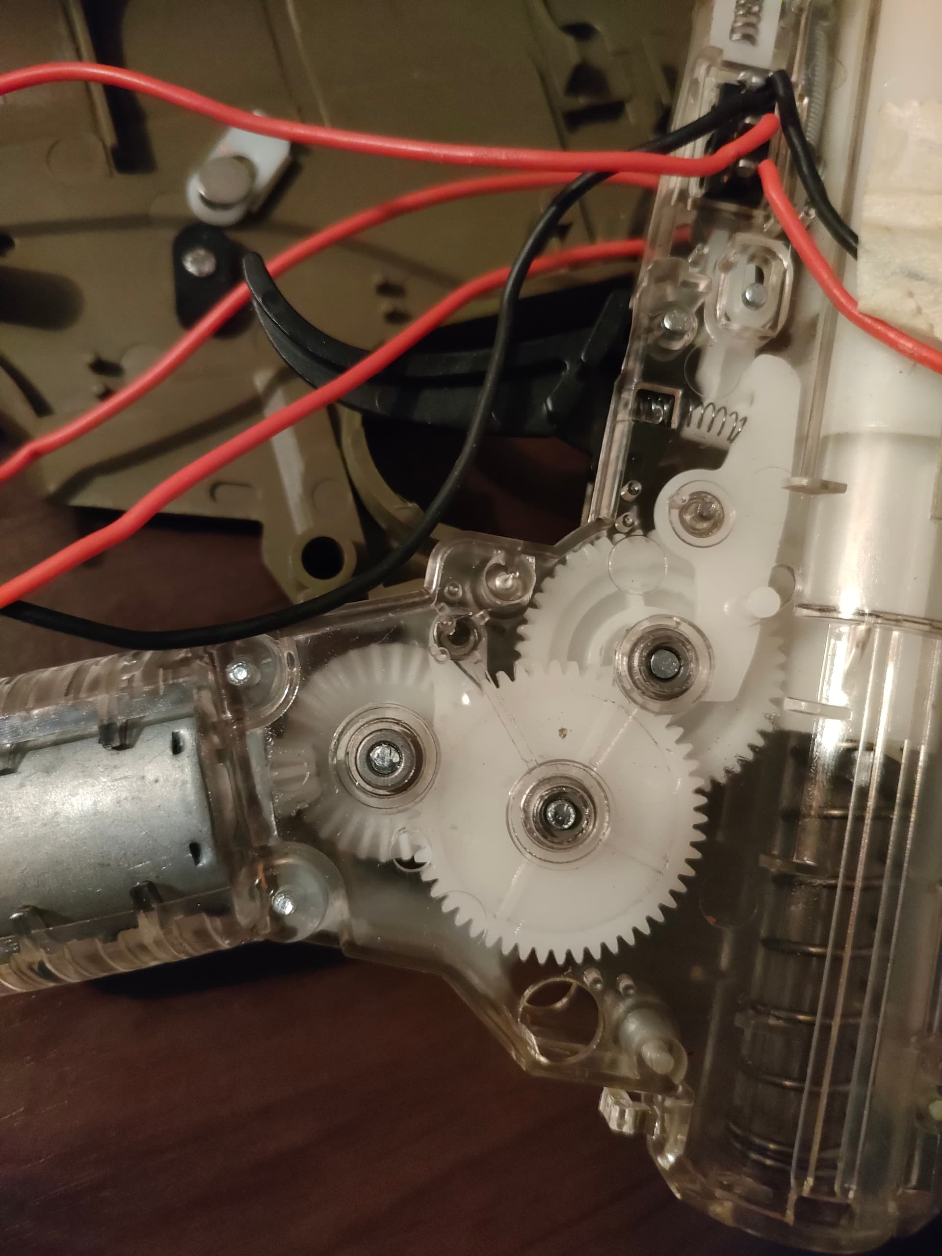

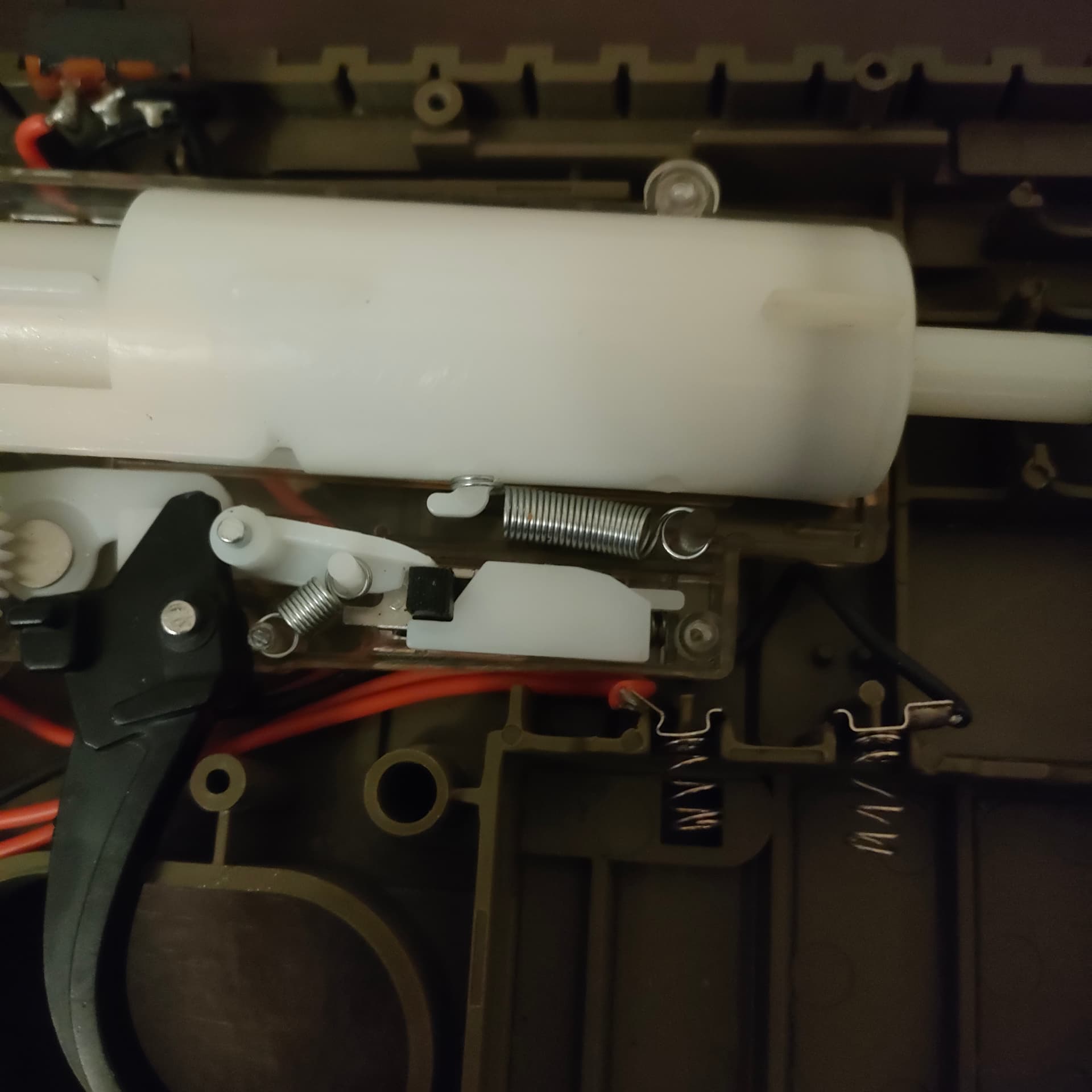

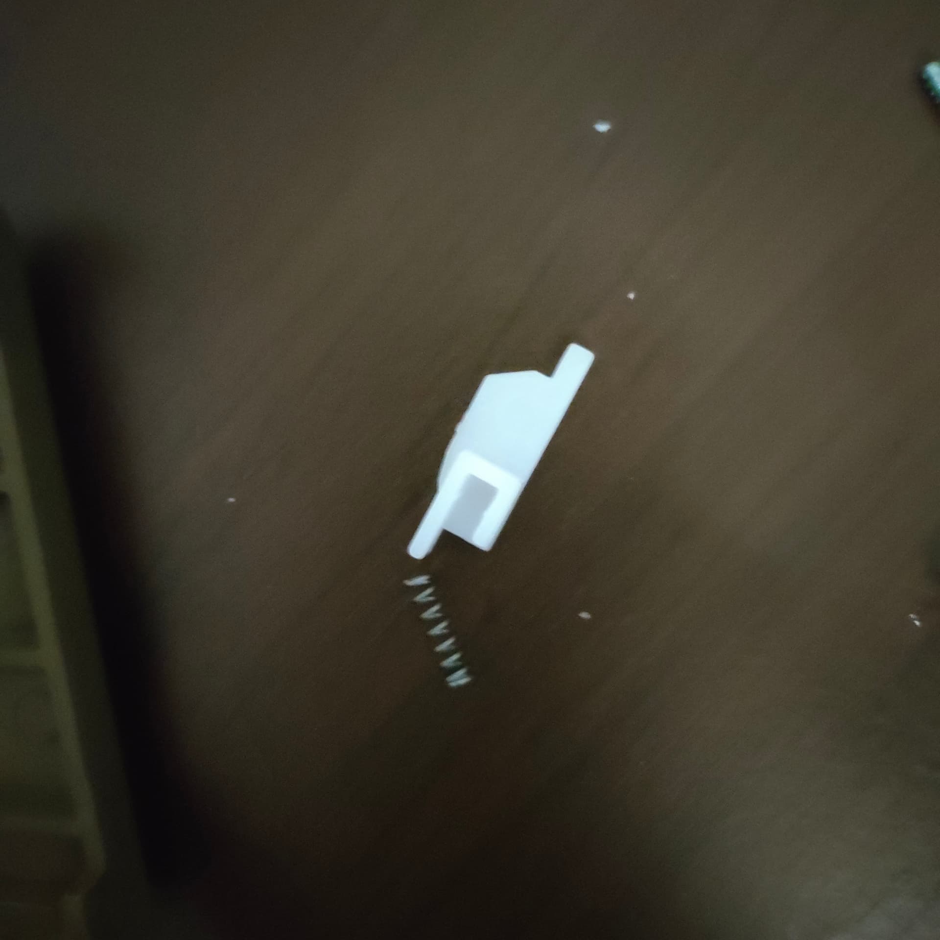

This piece, is a pain in the ass

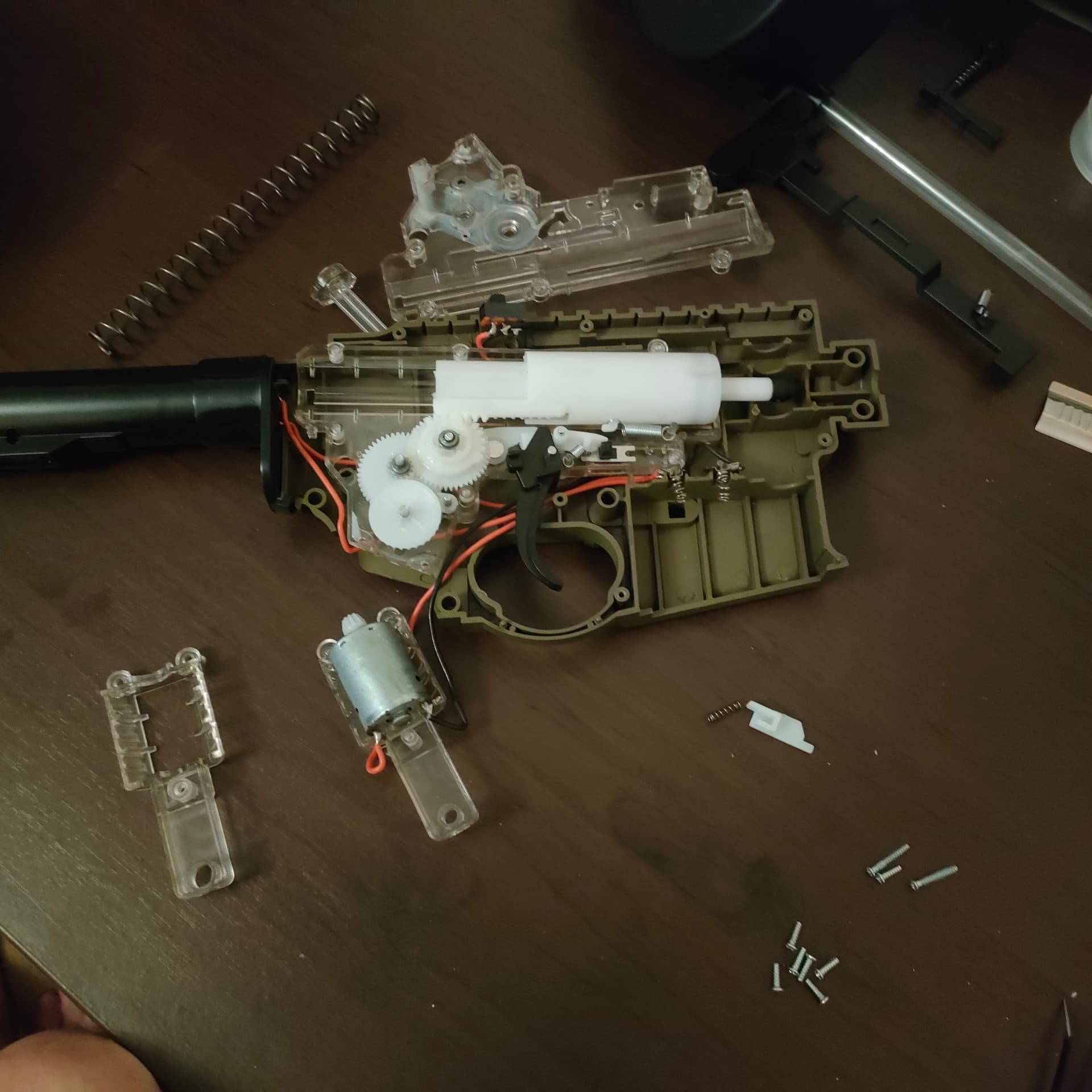

Back in

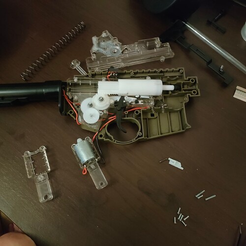

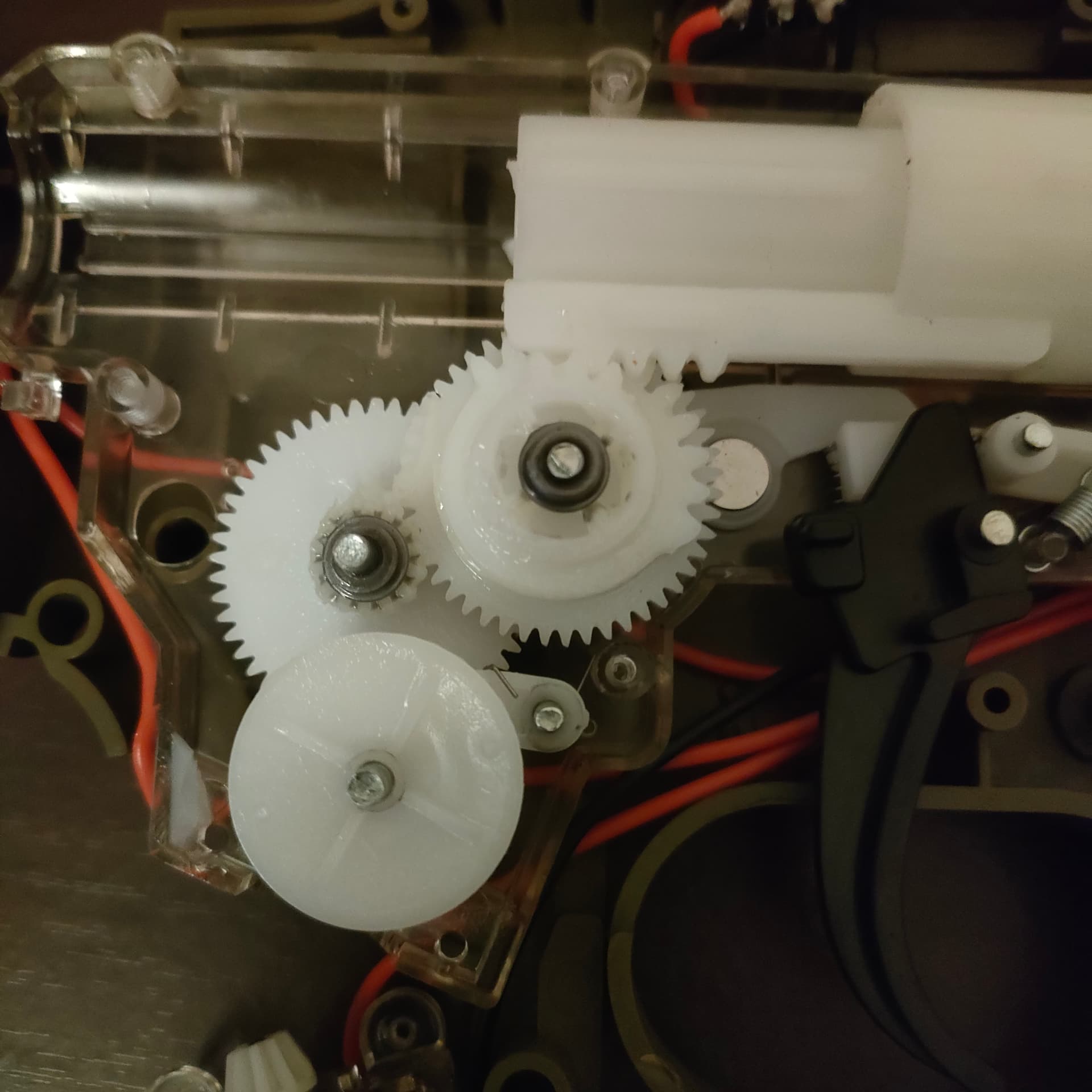

Something must’ve been wrong, single test fire and this was the result
After correcting, which took ages with my fiddle fingers
Wrong alignment of the cogs so that failed :sweat_smile:
Need to open it back up again and try and get the gears lined up properly, would help if I watch a gearbox tear down video, just kinda fumbling around winging it at this point :grimacing::joy:
I’m not sure if it’s the anti reverse latch not setup properly or if I just lined it up poorly, but I’ll be trying again shortly I guess
Happy days :sweat_smile::sob::joy:

Do you get now why Jin Ming changed the game with the Gen 8? :thinking:
I don’t know…
Is it because they are “easy” to work on, upgrade etc?

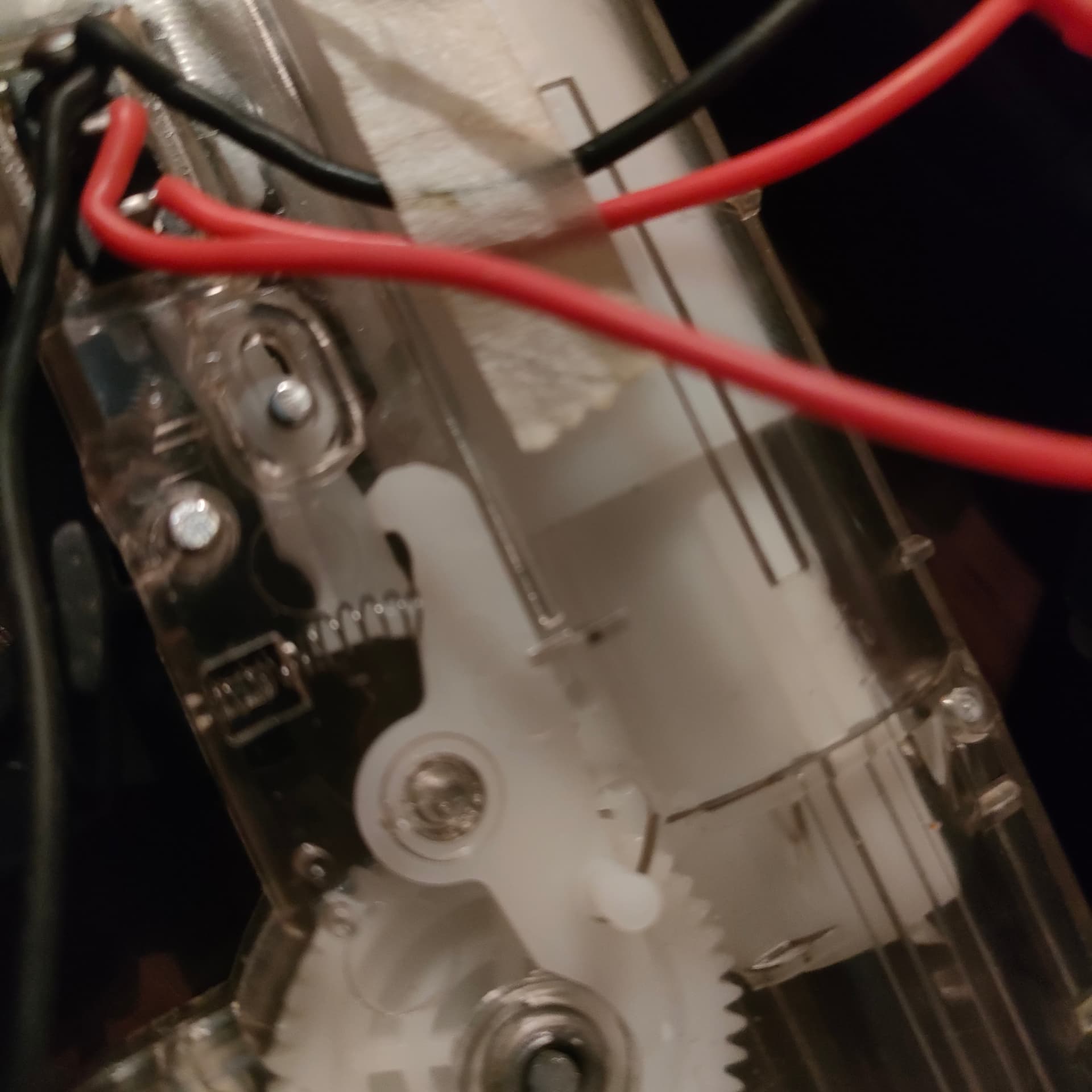

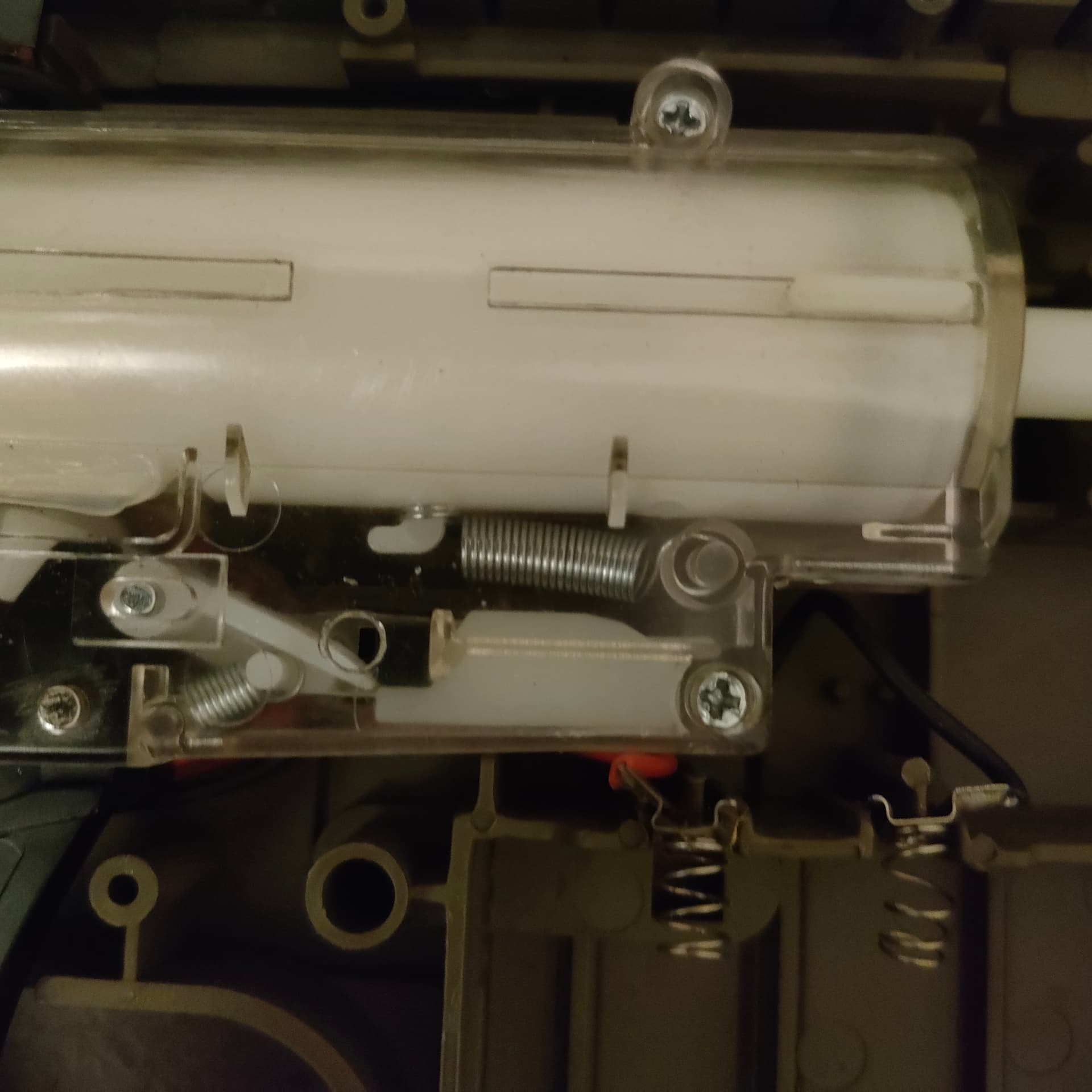

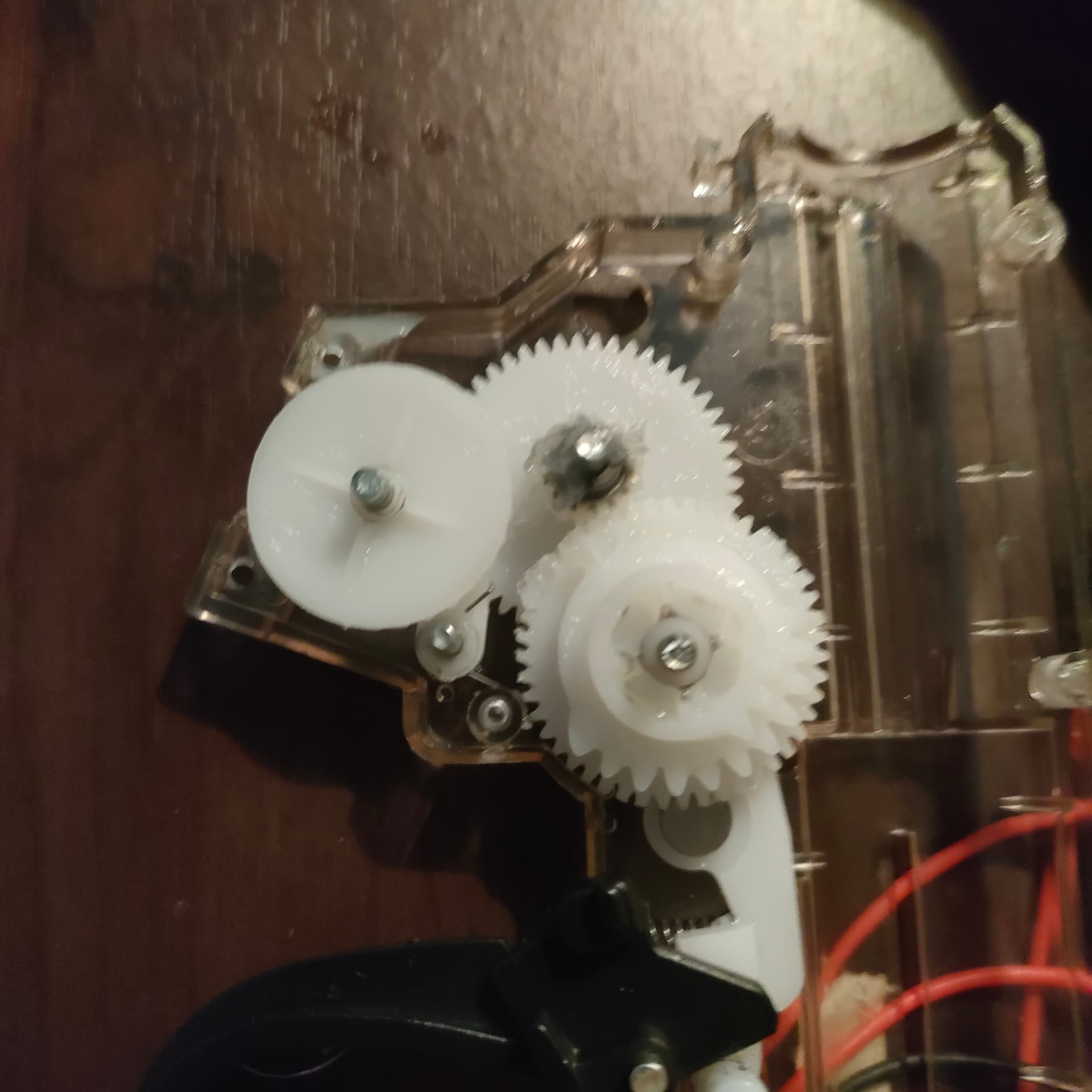

Got the anti reverse latch corrected I believe, but now that switch on the trigger trolley still isn’t activating.
Wonder if it’s to do with this lever at the back not engaging?
As far as I can tell it’s the only part not appearing to make contact when pulling the trigger
So at this stage it’s back together but still not firing despite everything being lined up properly as far as I can tell
Really stretching my memory here, but…
I do remember there was defintely a lever that had to be pushed from the outside through a gap in the shell while the two halves were clipped together. Can’t recall just looking at your photos. :person_shrugging:
Probably not much help to you… Damn, it’s been a long time since I looked at the insides of an old pre-V2 Le Hui. :rofl:
