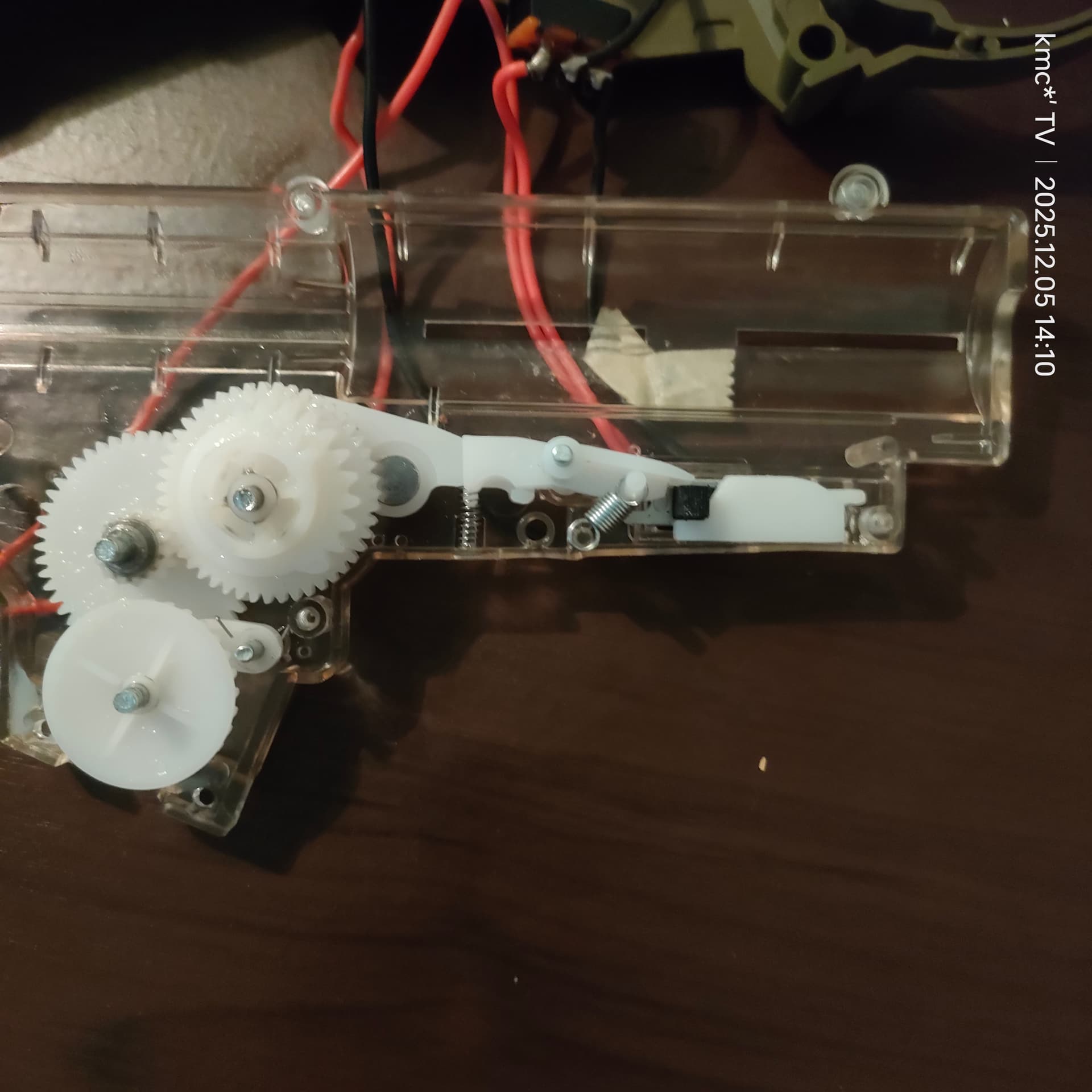

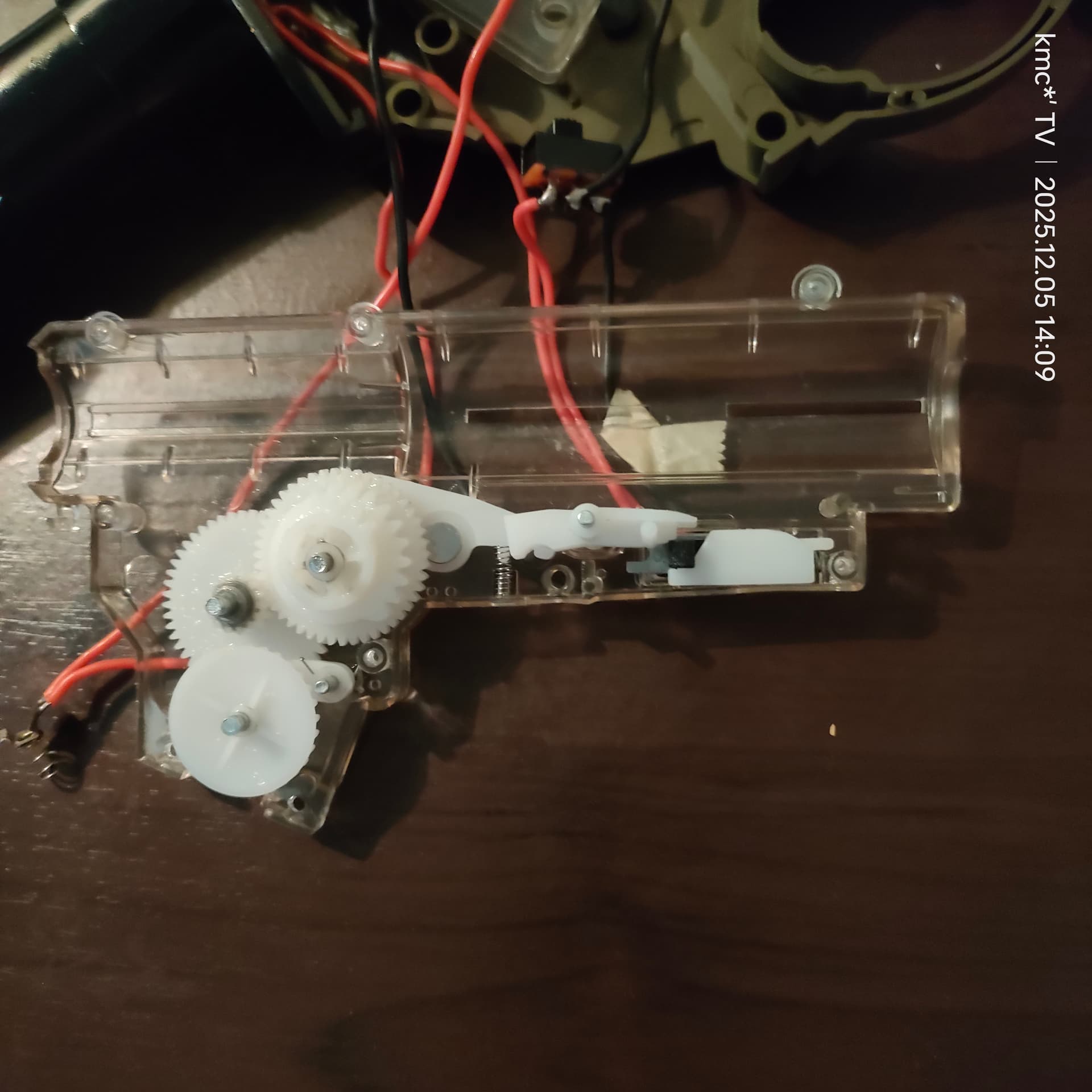

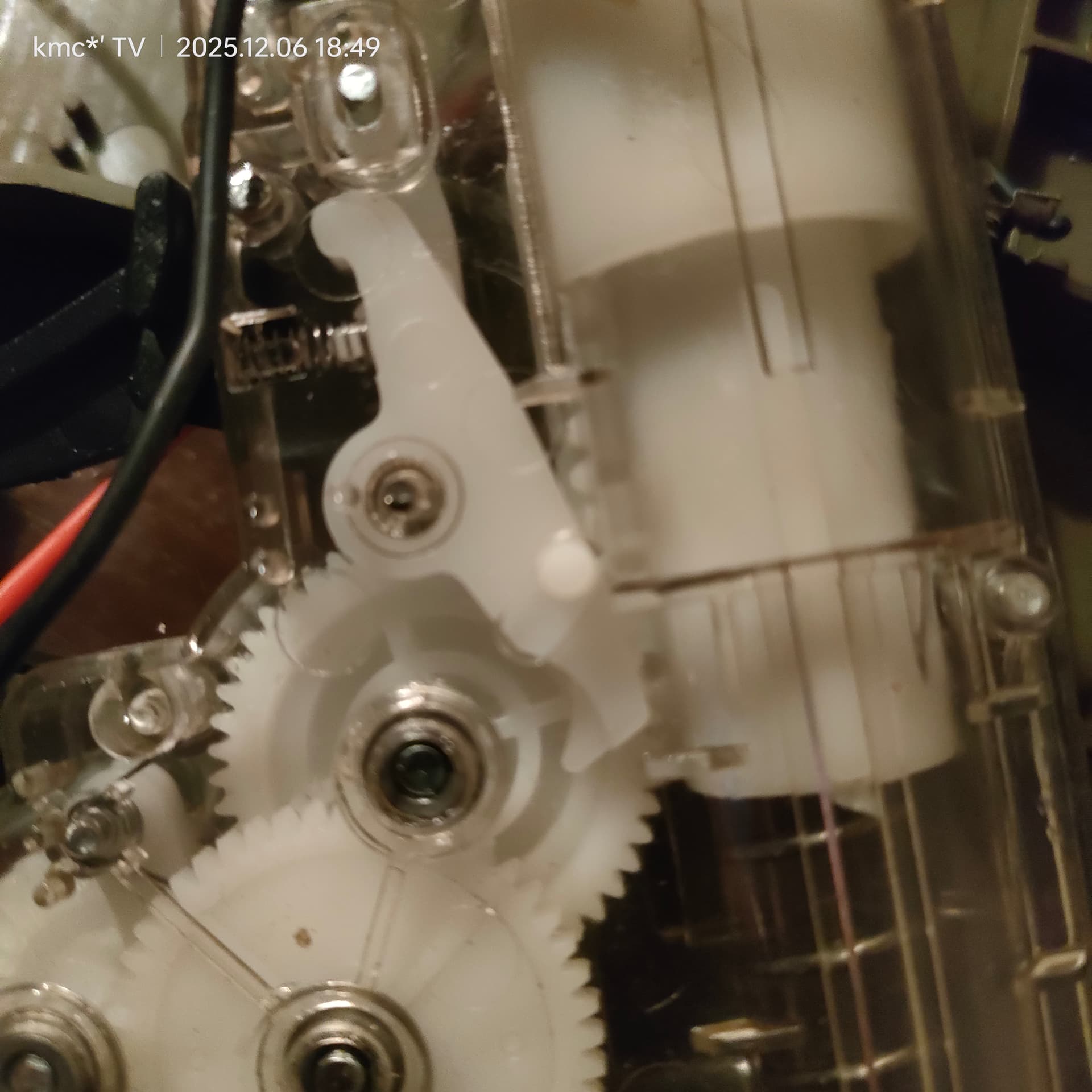

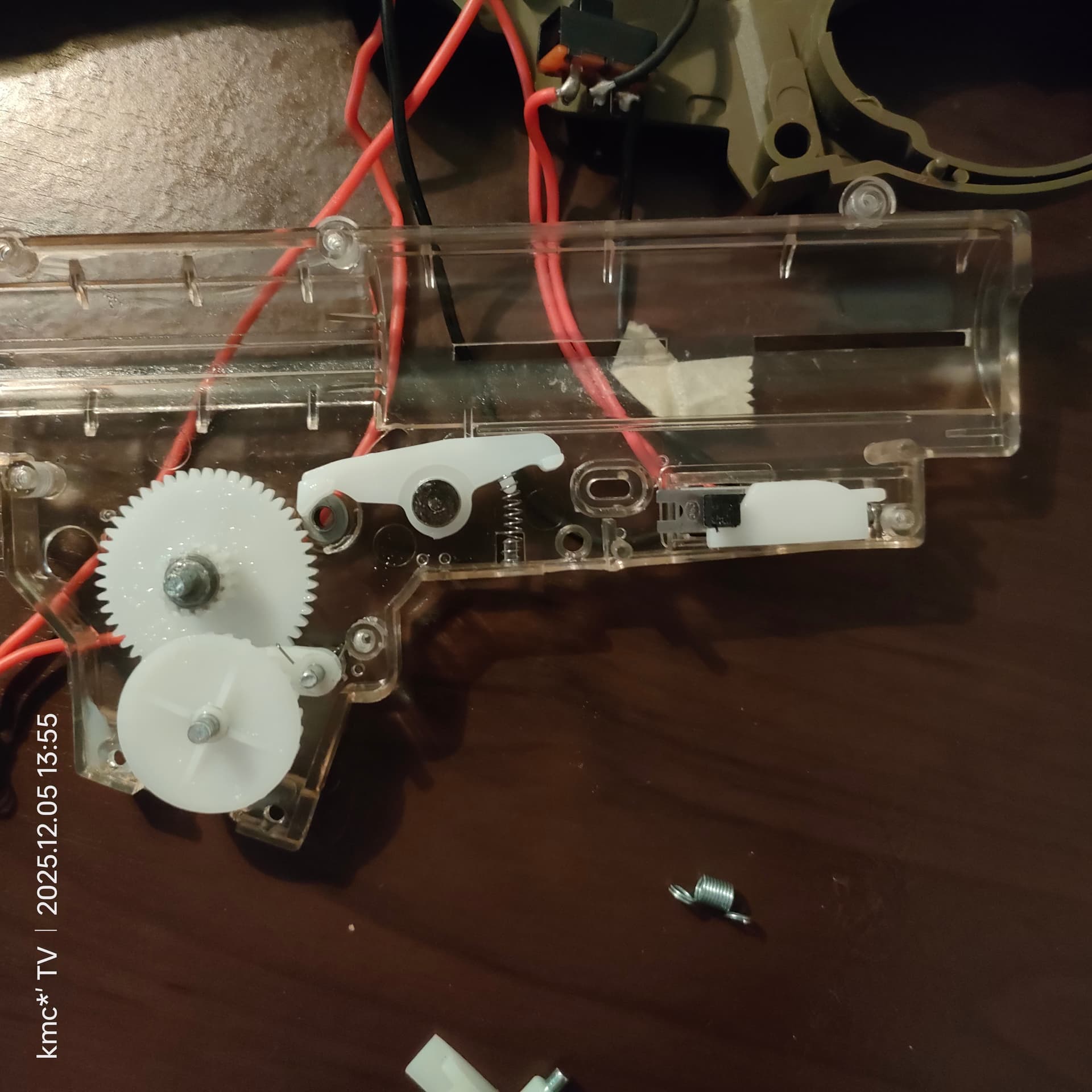

This LH Hk416 gearbox is a pain in the ass, so fiddly and with my fiddle fingers it’s an absolute headache
I’ve managed to get it aligned how it needs to be, but as soon as I put the trigger spring in, it comes out of alignment and fails if I continue as is.
For the life of me I just can’t get it to stay how it needs to in order for it to function correctly
Notice how it’s not sitting correctly as soon as the spring goes in
Any tips would be greatly appreciated, cheers
That bottom photo is correct. That’s where the lever needs to be to push the trigger trolley.
Pretty sure you need to push that lever up into the safety position above the trolley as you snap the two shell halves together. There’ll be an audible click.

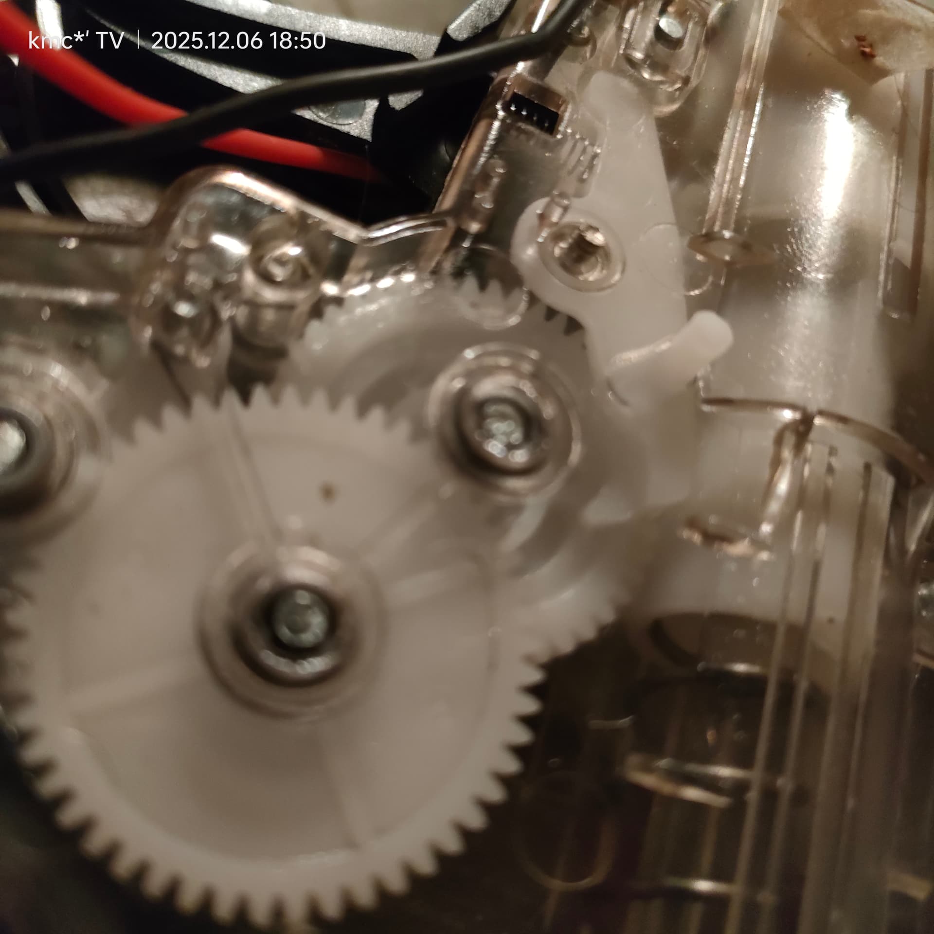

When I have that piece in this position
It doesn’t engage this cog at the back
Like the lever at the back isn’t making contact with the cogs to release the gears or whatever it’s purpose is, it’s not contacting anything else and hence its still not firing
Getting over pulling the gearbox apart. Done it around ten times now, no luck :face_with_symbols_over_mouth:
If I had the thing in front of me it’d be sorted, no problem. Just been so long the photos aren’t sparking anything in my melon memorywise. :rofl:

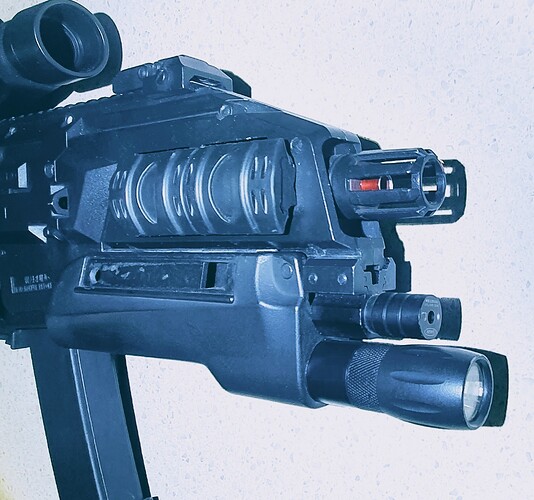

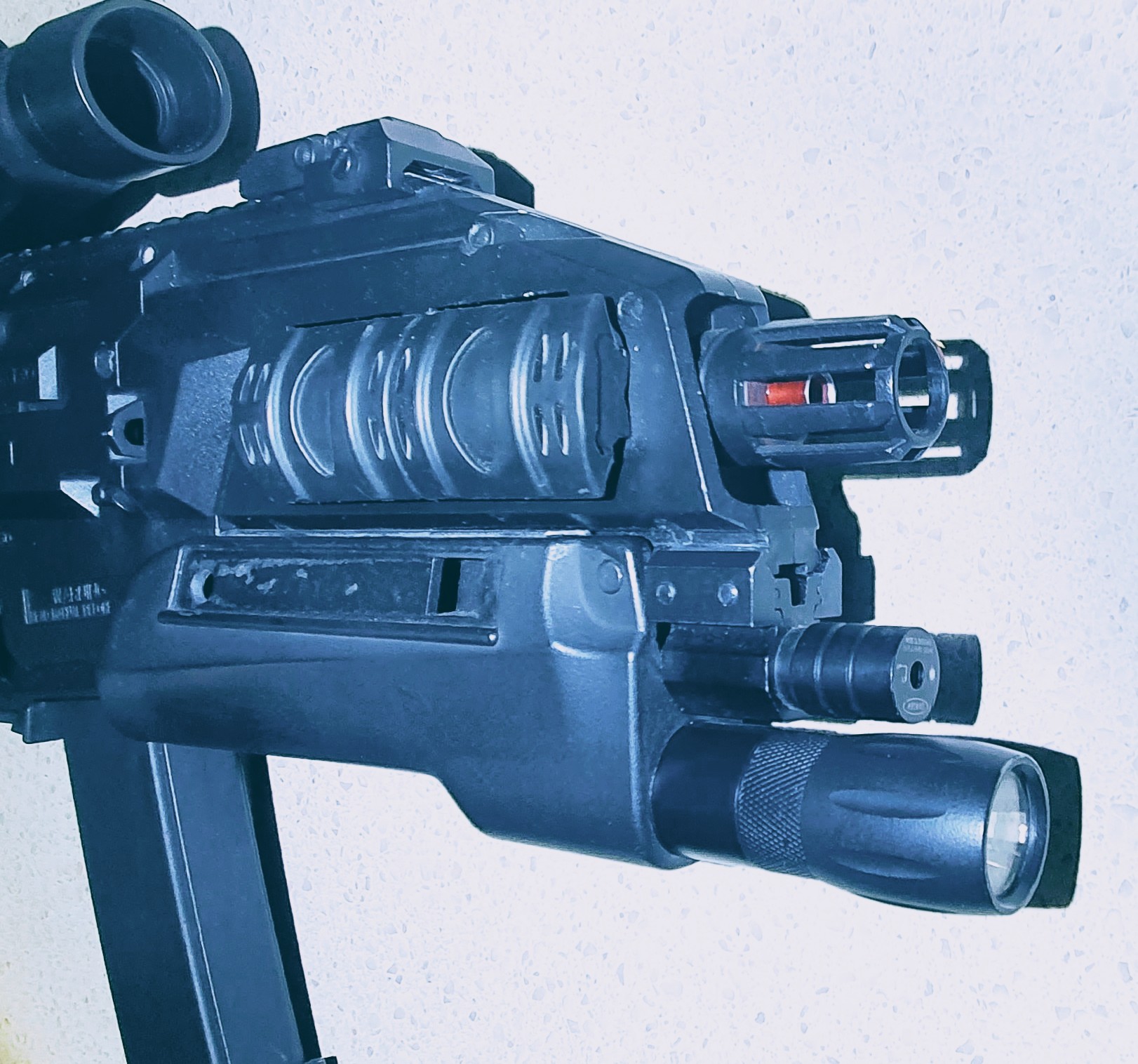

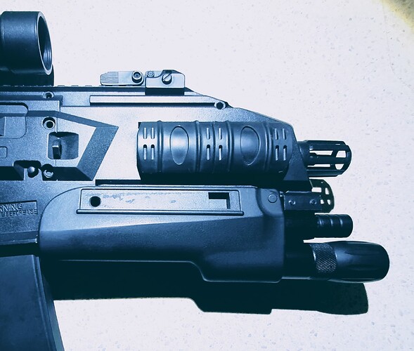

Modified a BigRRR MP5 handguard to fit my Scorpion EVO. Better looking than the previous Magpul unit.
Still have to sort the torch out with a pressure pad and the laser is non-functional and will stay that way, also need to clear a little away to allow fitment of the drum mag. But the sucker will house a huge brick of a lipo comfortably and looks pretty tacticool, IMO. :+1:

Update on the young fellas LH HK416
Must’ve pulled the fkn thing apart and put it back together 15 times in total, trying to realign everything n get it going again
Finally managed to get it going again and shooting properly :confetti_ball::tada::fireworks:
Only hitch is the safety wasn’t done properly :man_facepalming:t2: a job for another day I guess but for now, I’m just happy it’s shooting again, nothing wrong with full auto :sweat_smile::joy:
