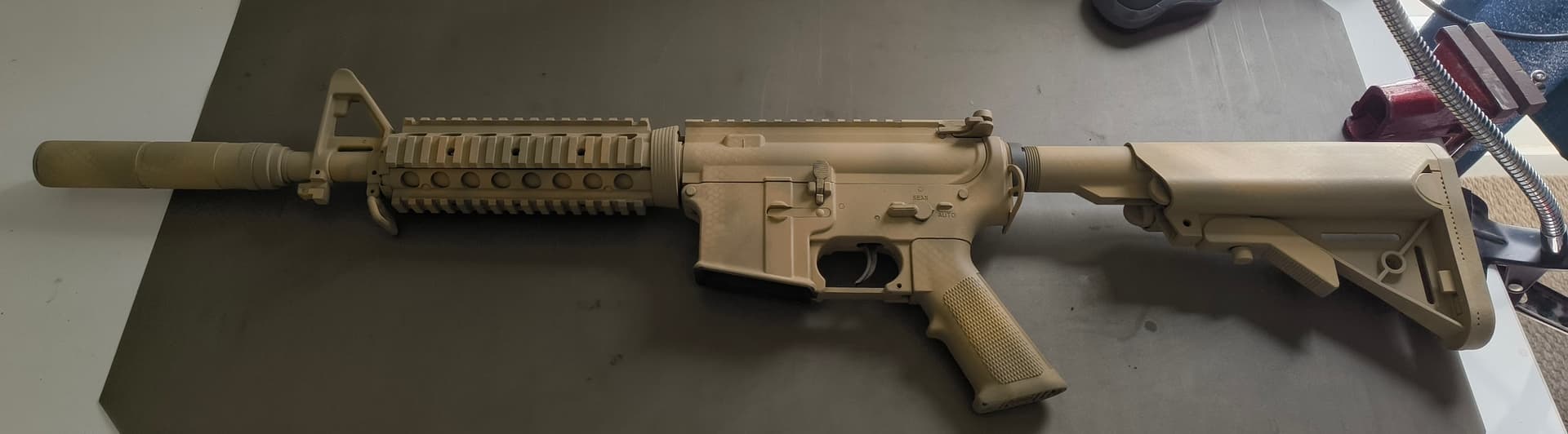

This was the first blaster I purchased on moving to the sunny state. E&C Value line M4. Some of the fit and finish was a bit rough but a good metal v2 gearbox. Fitted an Optac hop up barrel which is hidden in the suppressor. OAL of inner barrel is ~37cm so it also got a full cylinder and SHS M100. I’ve only tried some over grown Ausgel Ultra elite V2s but it was putting out 330-340. Need to grow some fresh gels and tune the hop up.

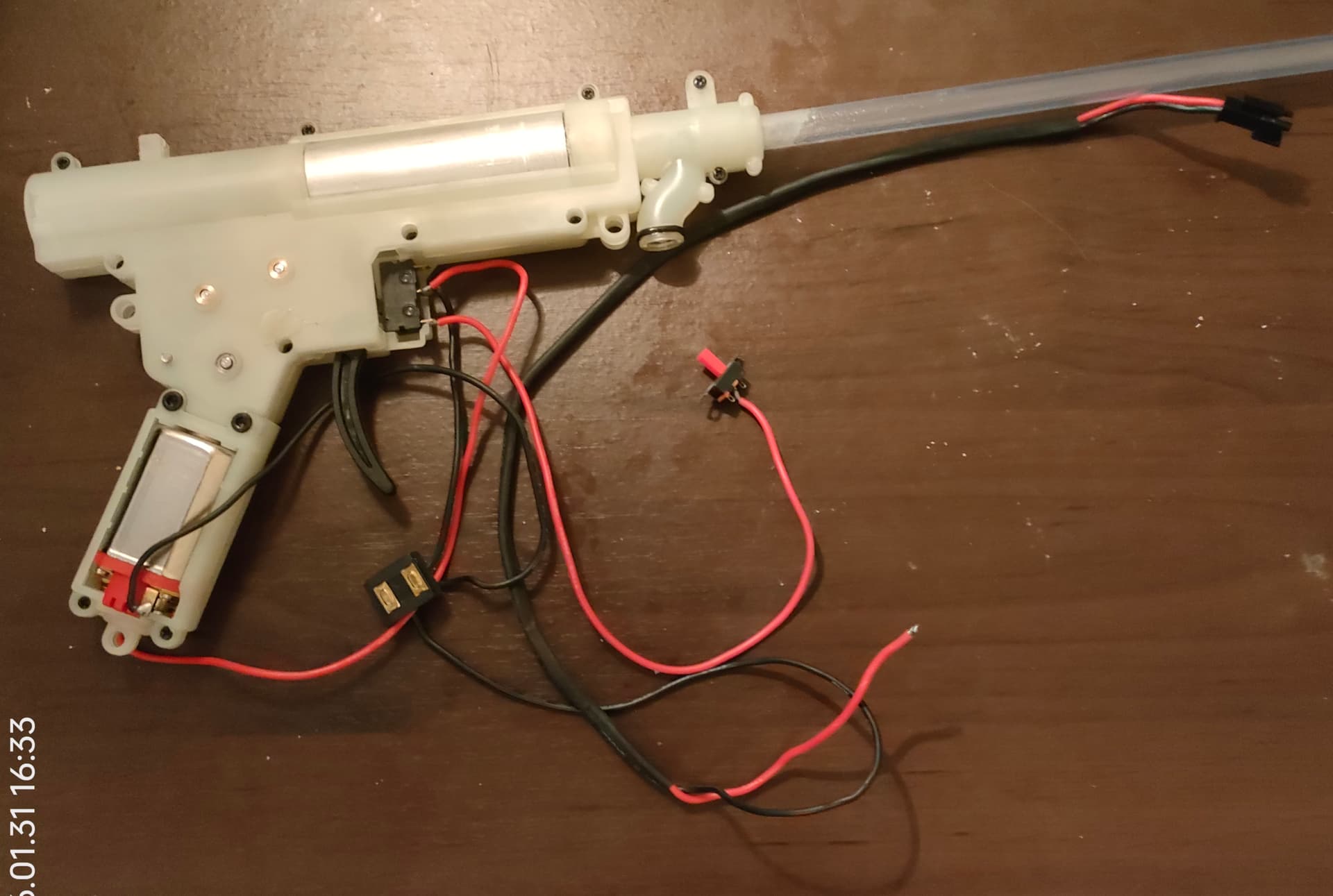

Pulled the gearbox apart again for my ZH m249 and upon putting it back together and testing resulted in a harsh grinding noise, only did a split second trigger pull and immediately released as soon the grinding noise started which was immediately
The only part I think I may have wrong is the anti reverse latch, I think I may have installed it upside down
Does this sound right?
AR latches can generally only go in one way… usually spring down and with the spring leg braced against either the gearbox shell or a moulded post.
Been a while since I spannered a gen 8 but I can’t see how you could put an AR latch in upside down. :person_shrugging: Either way, sounds like you’re pulling it down again.
It’s always a good practice to hold all the gears in place and wind them by hand with the piston in and spring out to make sure everything’s working before you close up the box.
Then when the box is closed, wind it again in a free state and make sure that AR latch is doing what it should. :+1:

Yeah I was hand winding it to line the piston and gears back up and thought I had everything lined up and held in place whilst putting the shell back on etc
Definitely something going on, I’ll just have to keep trying until I get it right
First thing that comes to mind for a grinding noise is the motor height, or in this case has the pinion gear come loose and moved on the motor shaft. I’ve had that happen to a couple of V2’s.
Possibly the piston jumped out of it’s track on reassembly too… that locks up your gearing nicely.

Pulled the ZH M249 gearbox apart again today, reassembled and test fired, appears to be cycling but still sounds a little grindy in my opinion
As far as I could tell there was no issue with the motor cog heights, appears to line up perfectly, as do appear all of the gears
may be the little white spacer/shim whatever it is that came out from god knows where buy I think I put it back where it was supposed to go under the first/main cog that interacts with the tappet plate, may have installed it upside down as there’s a bit of a divot in it where it curves

May have also been the battery as it was half flat and sounding sluggish so it may have just been that. Charging the battery again to retest before reassembly of the entire blaster…

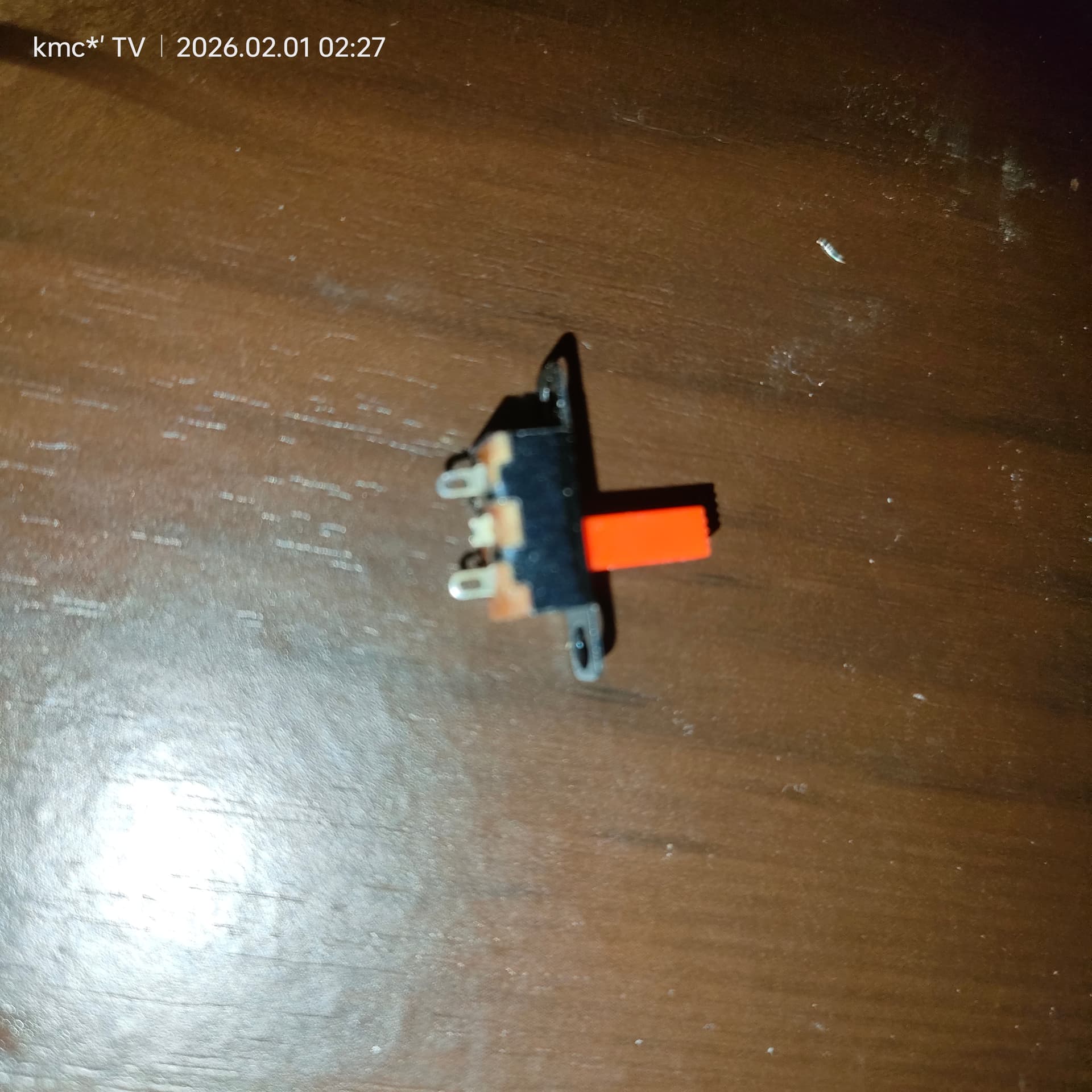

Whilst trying to solder the switch wire back on the other snapped off at the terminal

Looks like there’s enough there to get a wire on though… :thinking:
Or maybe a replacement switch from Jaycar? :person_shrugging:

Yeah I think there’s enough room but will definitely be an extremely fiddly task for myself, was hard enough for me just trying to solder the wires back on after wrapping the wire through the hole of the first one that broke to solder it back on cuz I have shit solder and I couldn’t get it done because the solder wouldn’t stick

Stick it in a parcel envelope, mail it to me, I’ll sort it and mail it back to you. Gratis :person_shrugging:
So what I did on mine, find a big weatherproof on/off push button from an auto shop, drill out the rectangular hole into a nice round hole, and… Boom! Easy to mount it, you can solder or use crimped terminals, and no shortage of amp capacity.
In my case, the blaster came alive after doing this, as it had 13:1s with a slower high torque motor and m100. those 460 motors do like the extra amp capacity.
