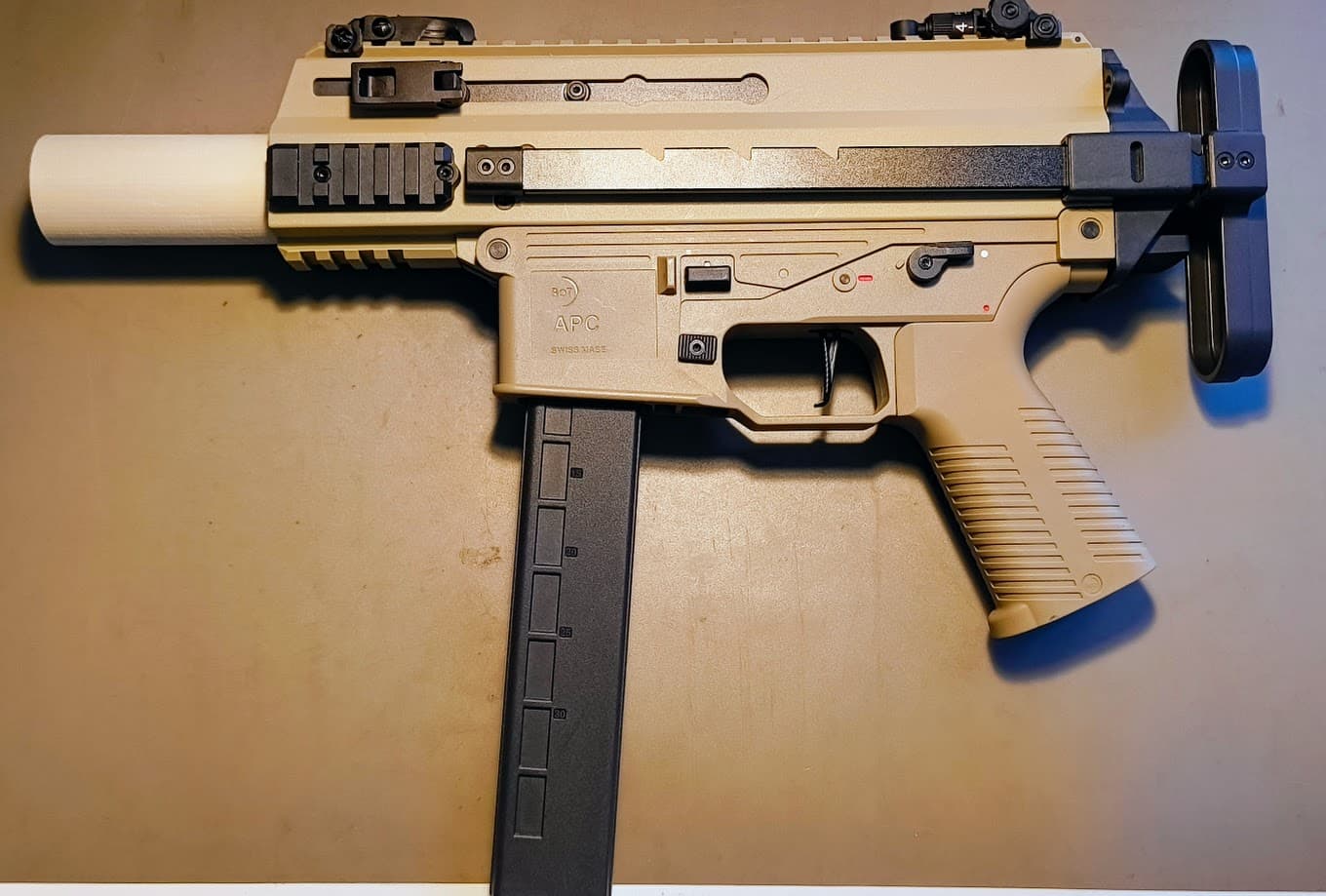

Looking good :+1:
As for colour matching, just give it to @BME !:stuck_out_tongue_winking_eye::joy:
Classic black.
50 shades of….
Rustoleum is a decent go to spray can…
Finish can be a little rough, at times though…

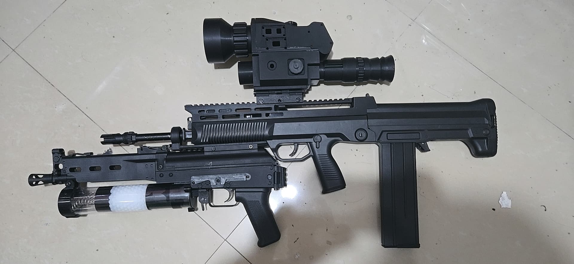

Hmmmmmm🤔
He uses a standard TM gbbr nozzle but it shouldn’t be hard to modify it to fit one for gel.
He’s got quite a few projects there that are interesting and almost entirely 3D printed and use standard parts, and the files aren’t that expensive either.

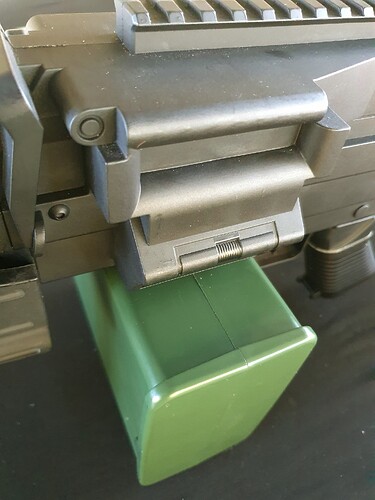

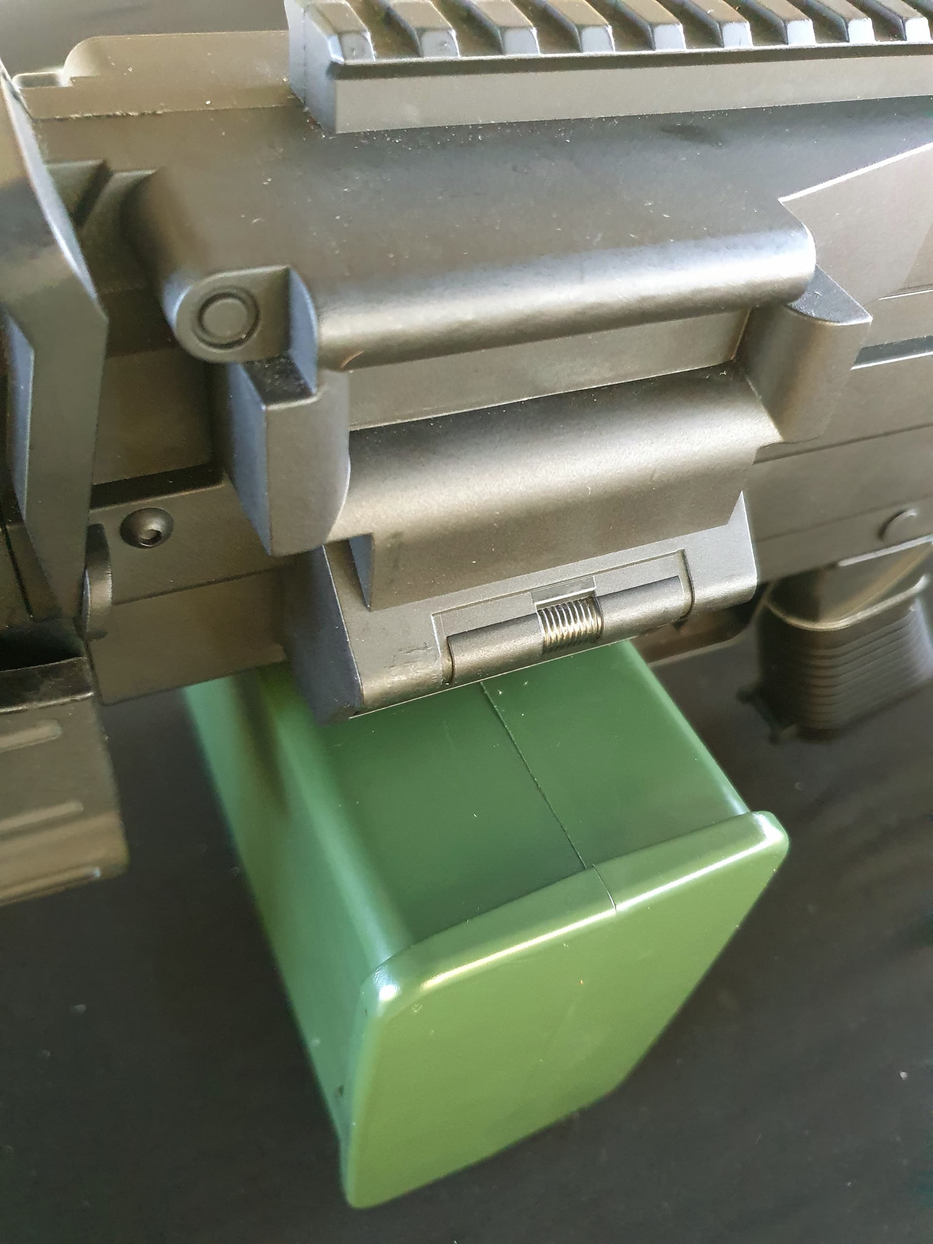

Haven’t dabbled much lately, but the ol’ venerable Ze Hua M249 SAW got the treatment yesterday.
Out with the ZH gearbox and in with the Singularity box with upgrade Ausgel motor. Improved airseal thanks to the usual alloy upgrades. Chooches along nicely with a very SAW-like rate of fire.

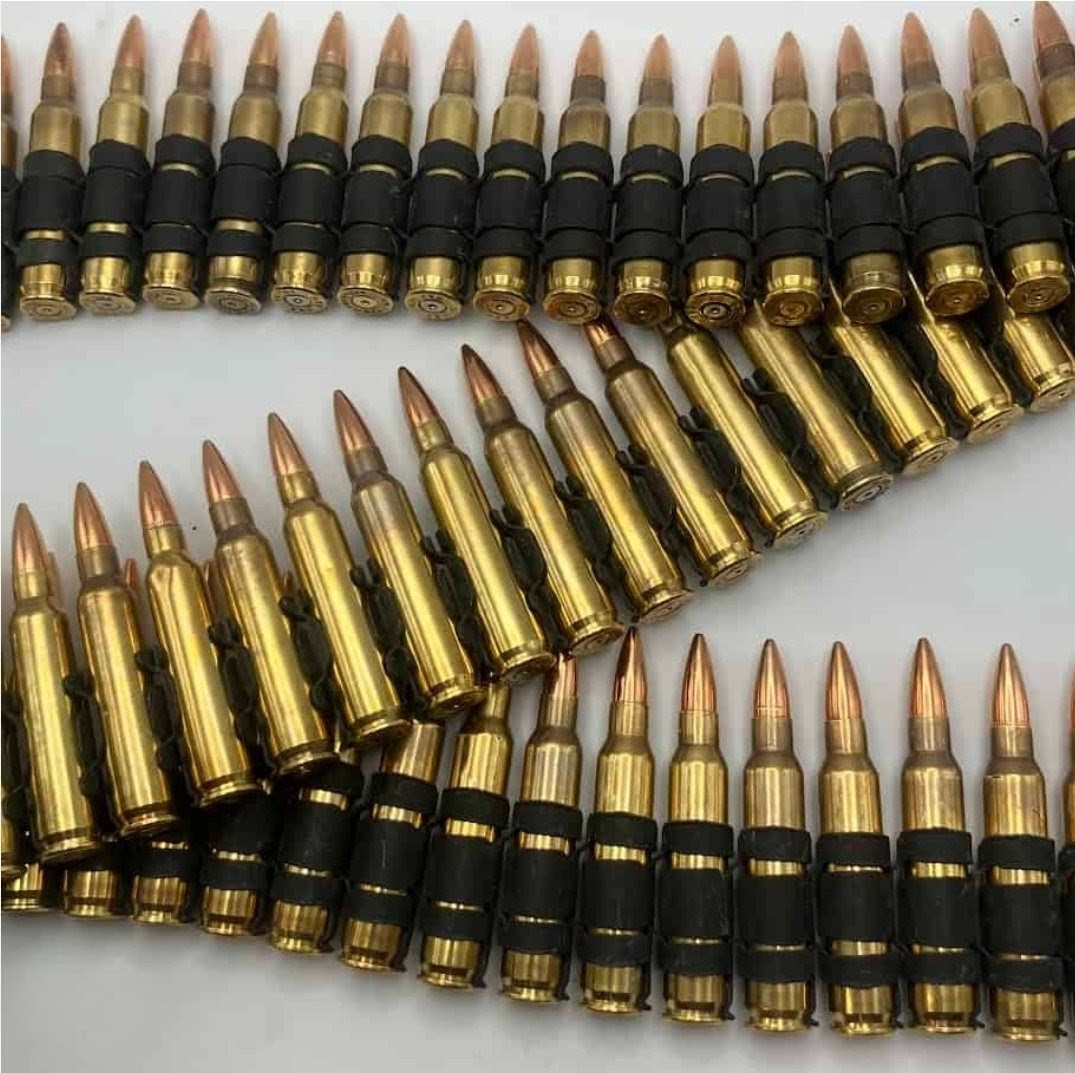

Cosmetically, I’m on the hunt for faux 5.56 link, figure I can run a short length from the box mag to the fake ejection port, permanently attached to the mag.
Anyone know where I can get that 5.56 link from a supplier that isn’t airsoft? :person_shrugging:
Tried here…
A&K M249/MK46 Gel Blaster Display Dummy Rounds Belt – WAT INT

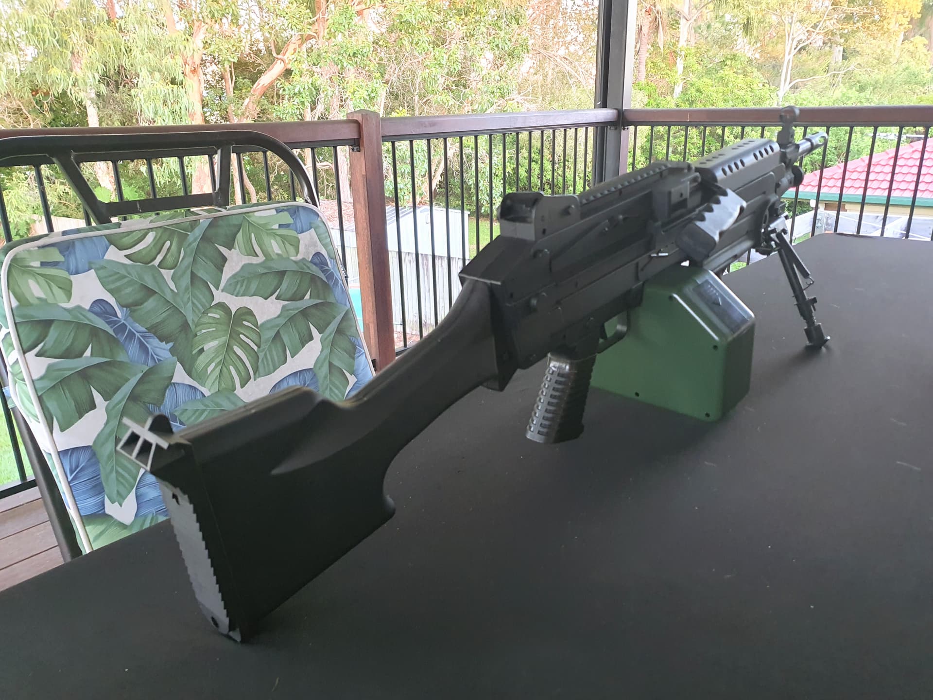

The Minimi may have been choochin nicely… but it wasn’t impressing much on the chrono. Best it would do was about 200. :roll_eyes:
It’s been apart together, apart together, apart together all friggin’ day and the last iteration showed 150. And of course, in ABS components like the grip that means stripped screws or broken screw posts :face_with_symbols_over_mouth: where’s that gaffer tape. :person_shrugging:
Defintely airseal issues at the t piece… great compression at the cylinder head. Past that… no bueno. The Ze Hua unit was horrendous, about a .5mm gap all around. Pulling it apart, cleaning it and resealing it around the IB did precisely jack shit for FPS. Adding an o ring to the nozzle upped it temprarily but presented feeding issues.
So I’ll shitcan the project until I find a decent Gen 8 t piece and new inner barrel. I used to have shit tons of them lying around but for the life of me I can’t find one. :rofl:
The other option is throwing it at the wall in disgust.
Try this one should fix it :rofl: :v: :+1:
Gen 8 Jin Ming tpiece is the go, just need to trim a mm or two off the bottom to fit it in.
Yep… cheers for that, @RokSolid
JM t piece, 2mm filed of the length of the feedtube at the bottom, 270FPS. For a nylon geared Gen 8, good enough. :+1:

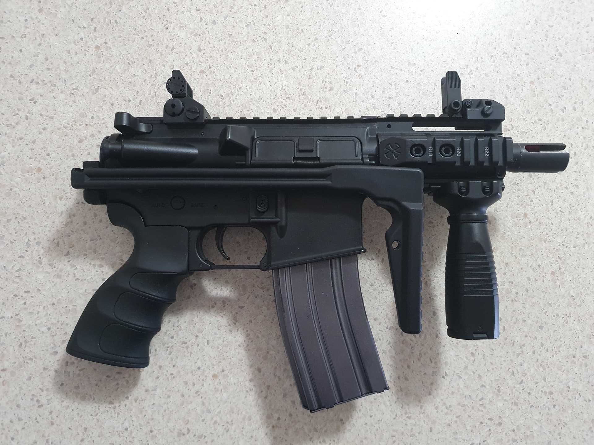

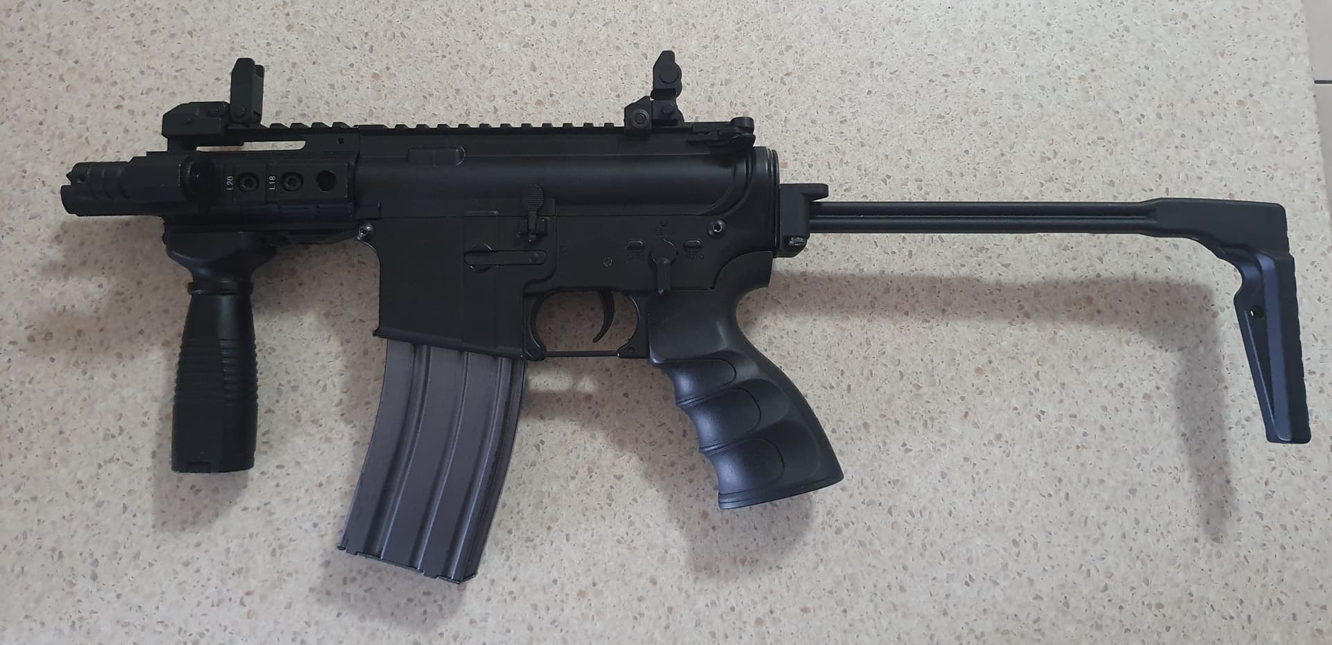

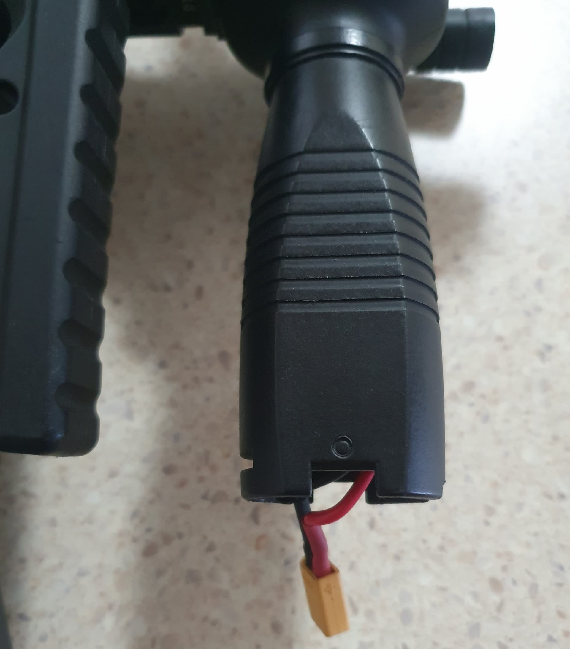

CYMA M4, forward wired through to the foregrip, shortened Noveske handguard, zero rear buffer tube, MP9 folding stock.
Doesn’t get much shorter than that. :joy:
So the reality of the uber-SBR M4 gel blaster is… it’s shite. :rofl:
That 10cm barrel combined with the forward wiring made this little hoover a blaster that wasn’t just underpowered (around 200FPS) but also an absolute pain in the arse to tear down for service. :person_shrugging:
I’ve got other short units that fulfill that role much better i.e. APC9K, MP5K, MP9, etc.
So today it was back on with a buffer tube, rear wiring and a barrel length of just under 30cm which, with an 80% ported cylinder, seems to be behaving itself nicely producing around 270… my sweetspot FPS and not too shabby for a shortie. :+1:
