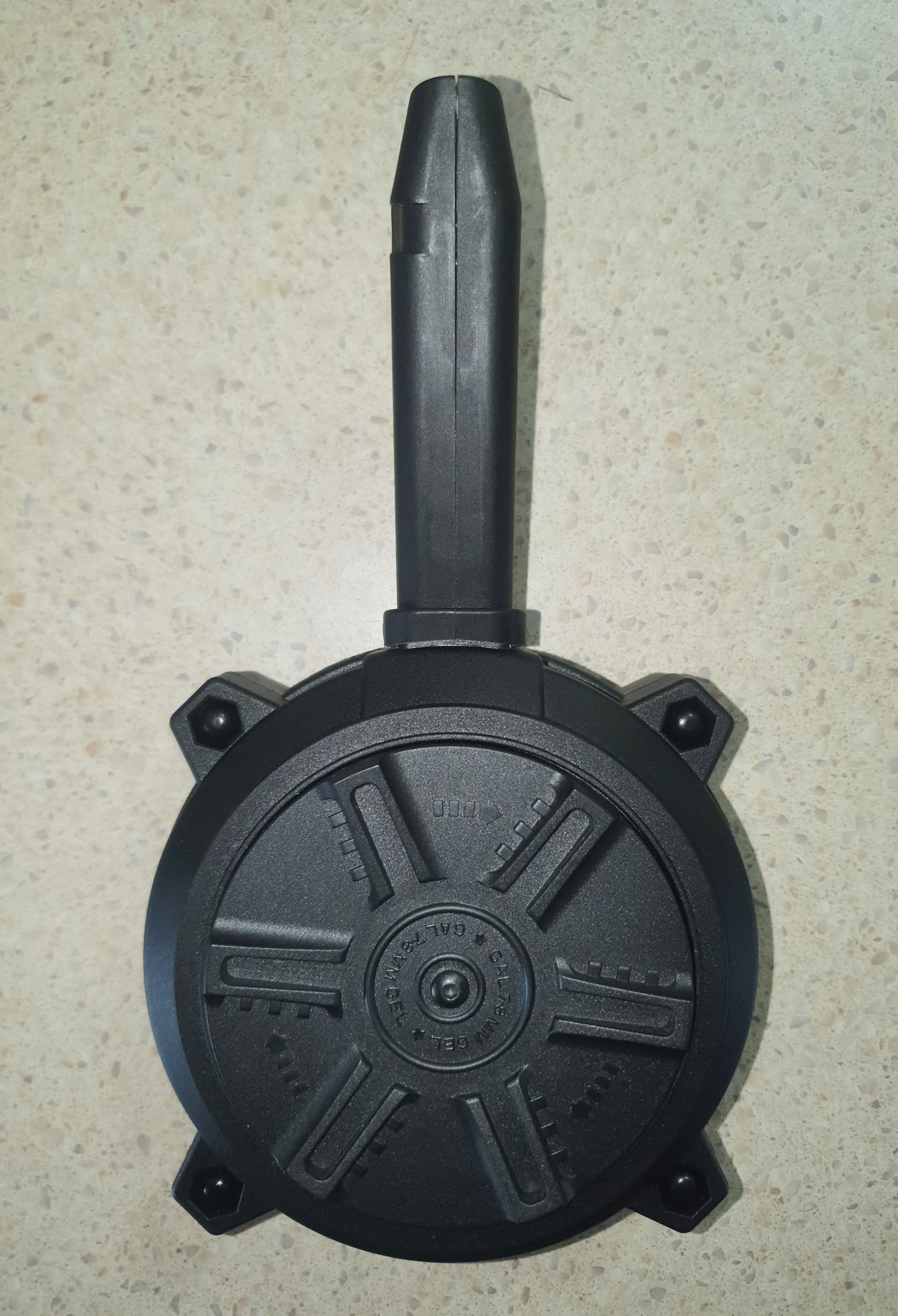

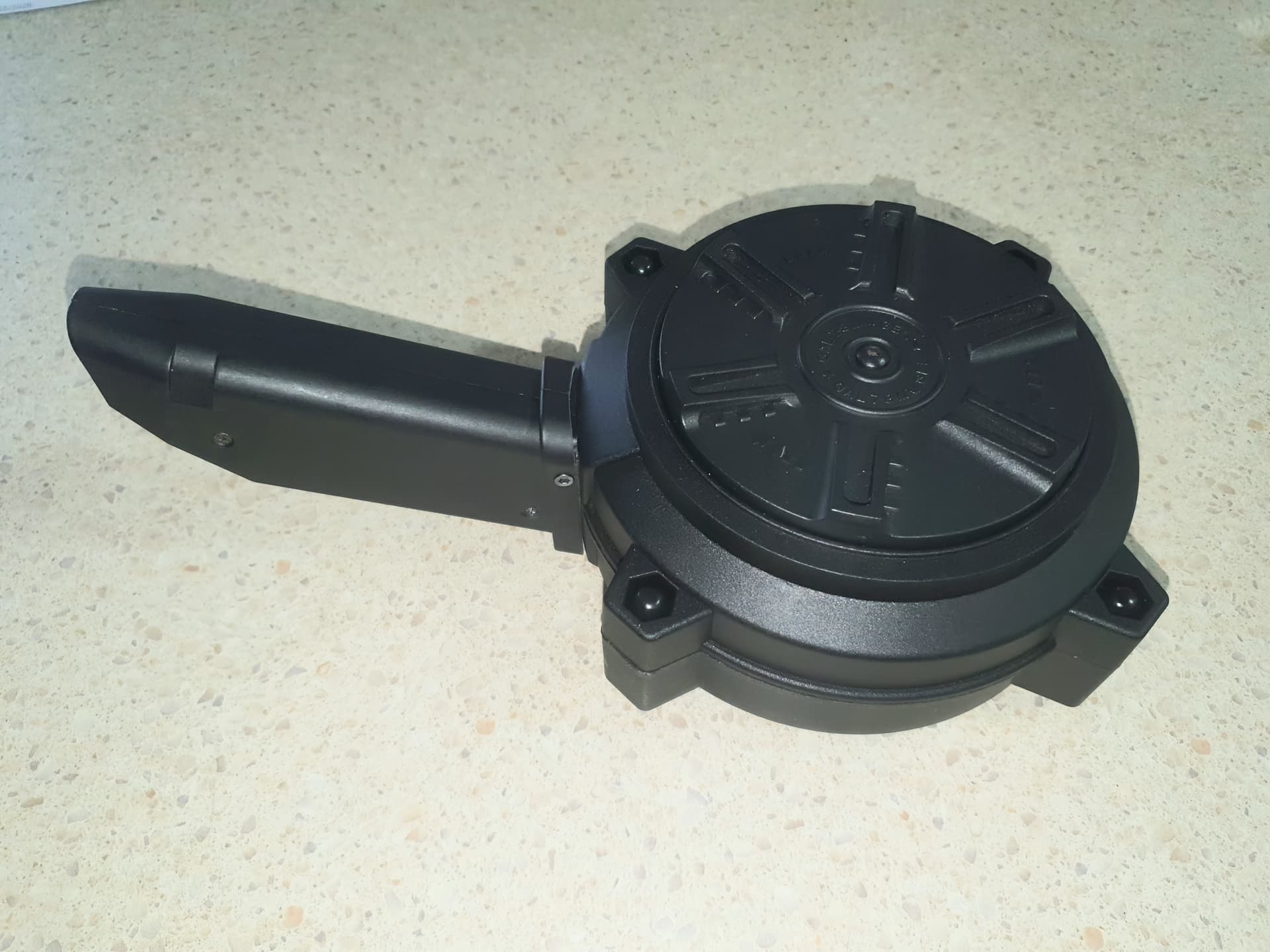

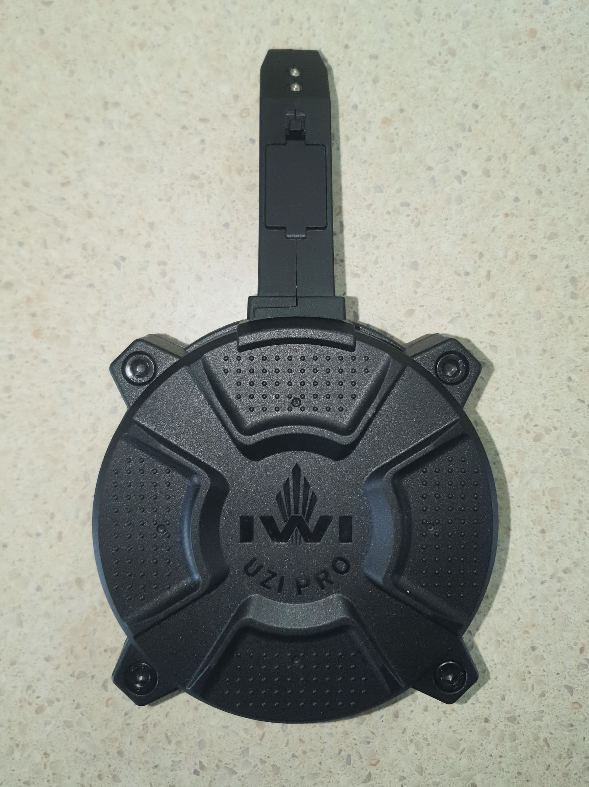

Decided that the drum mag for the UZI was pretty superfluous… not a fan of drum mags at the best of times, but bigarse drums on small SMGs really do my head in. :joy:
So out with the handtools, a lot of hacksawing, filing, drilling, head scratching, a shitload of lateral thinking and the UZI mag is now a Vector drum mag. It came out much better than expected.
Obviously lost a stick mag in the process but no biggie… they’re readily available, single drums are not. It’s not as tucked in as the OG double drum (not a fan of those, too wide for mine) but still retains all it’s functions, primes, feeds flawlessly and fitment is solid as a rock…
I may go back in and remove the motor and gearing that drives the rotating plate… or I might not. It does look cool on three round burst seeing that plate spinning up. :wink:
Also considering taking advantage of all the internal room and wiring switchable UV LEDs into it to light up tracer gels.
Very professional looking, I would have thought it was a shop bought jobby if you hadn’t mentioned using half the tools in the garage :+1:

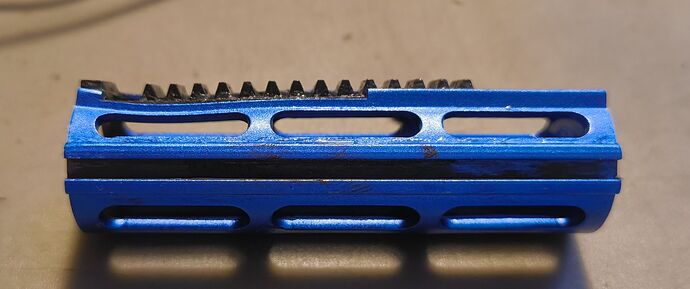

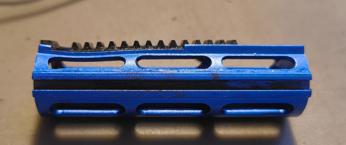

Alloy pistons have no place in gel blasters… every time I’ve seen one it has done far more damage than it’s worth :grimacing:
Amazingly the sector gear is undamaged. Bevel is toast.

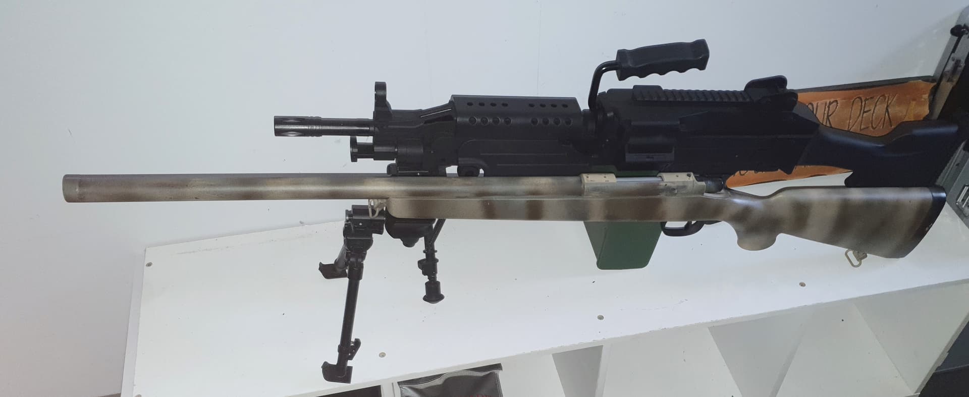

A pretty full day on the bench working out issues with the Senyu M24 springer…
Well overdue for a service and only hitting around 120FPS… significant drop considering I had it up over 330 a year or so ago… when it was new it was 300. :rofl:
Fitted o rings in place of the crapped out nylon gland packers, with a bit of oil the bolt action’s smoother than a pornstar’s livelihood. Took a lot of play out of it too so much better seal at the shnozzle, for shizzle. :+1:
The piston spring’s tired and the seal’s knackered… any 11mm spring will fit it so any replacement sniper spring should fit. Maybe an M130 to give it some zing. The seal’s a different story but I’ll figure that out. Never say die, I say. :wink:

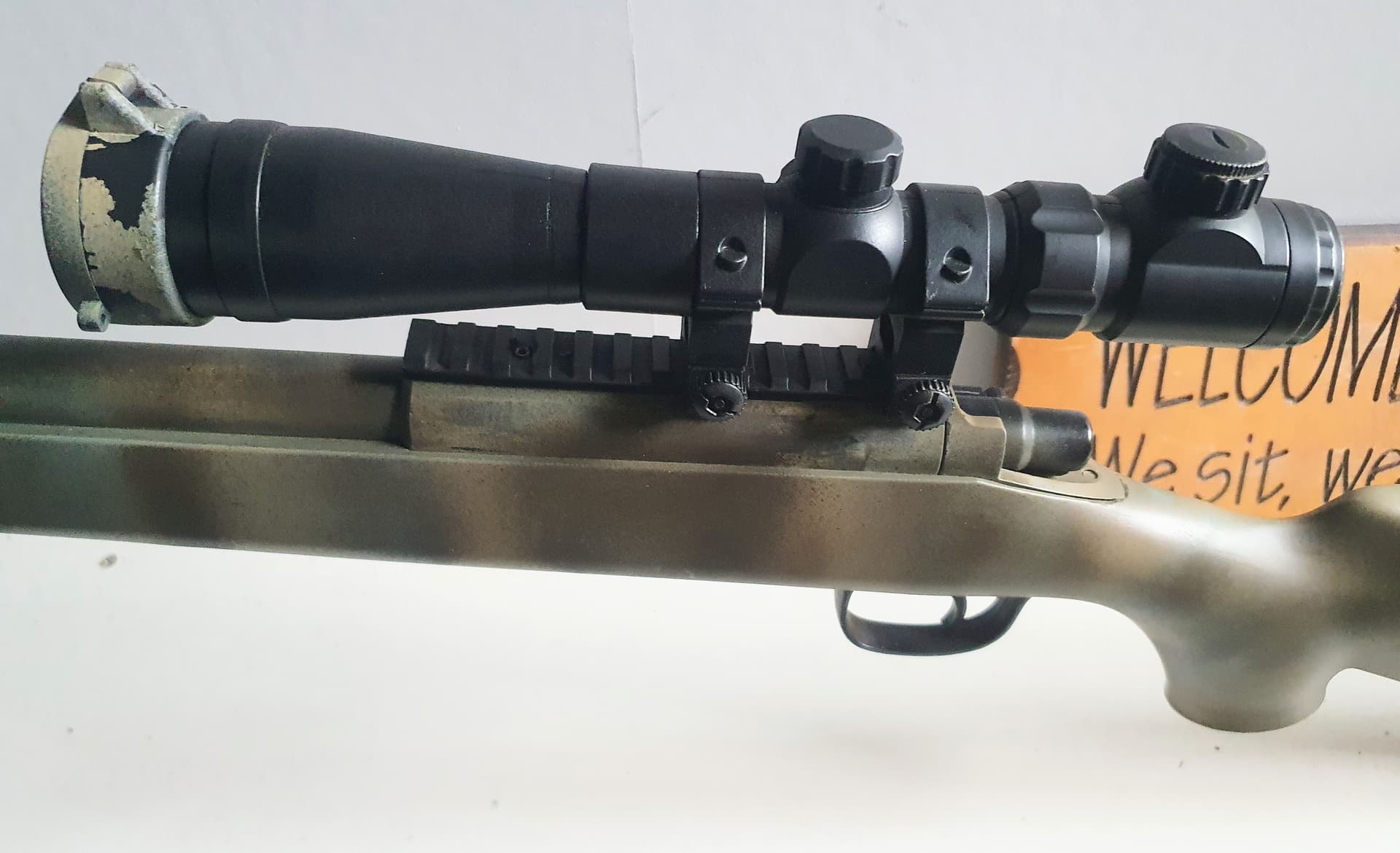

As it is now it’s hitting back up around 260FPS and it can only get better from there so worth grafting a pic rail onto the top for a faux scope. The original rail ended up under the handguard of Shadow’s ACR, I believe. :joy:
I see some screw holes on the action look reminiscent of Remington mounts… I wonder is it the same :thinking: :man_shrugging:
It’s supposed to be based on a Remington 700, so quite possibly. :+1:
But, you know… China :rofl:
I did have a spare but the 9" got to it and repurposed for a blaster. As I upgraded optics and mounts.
Pic rail’s on… cos… fuckit, I’m too impatient to sit around and can’t wait for shit. :joy:
Hacked the top pic rail off a clapped out nylon M4 receiver upper and attached it using the existing M3 mounting holes. Good enough for the plastic scope that’s on it… and free. :+1:
Just have to paint it up to match the M24 now. Friday’s job… good times. :ok_hand:

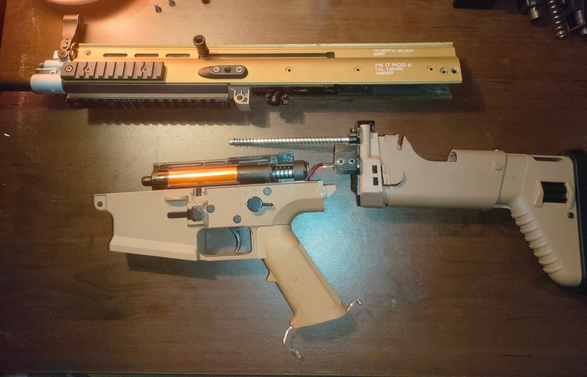

Finally cracking open the BF Scar V2 for trouble shooting after it seized and died :skull_and_crossbones:
Low guido’s review video definitely coming in handy :+1:t2:, thanks @LowGuido for the vid and @Friendly_Fire for recommending it
Havnt got to the nitty gritty yet but as soon as I opened the smell of electrical burn wafted through the air :roll_eyes:
Motors still good, tested with 9v battery after removing it, doesn’t seem overly fast spinning but it’s working, so assuming it’s not an issue
Further investigation required
That’d be right, can’t find my long phillips head screwdriver :screwdriver:…
Found it but the screws to separate the shell under the motor are done up so tight it’s almost like Loctite was involved and it feels like I’ll strip the screws if I’m not careful
Proceed with caution or I’ll be F’d
Delays expected :face_with_symbols_over_mouth:
You will find that a normal 9V battery can’t provide the amperage required to get the motor to spin at any great speed.
If you jumped a 7V Lipo Battery onto the terminals, the thing should jump off the bench and fly across the floor!:joy:
