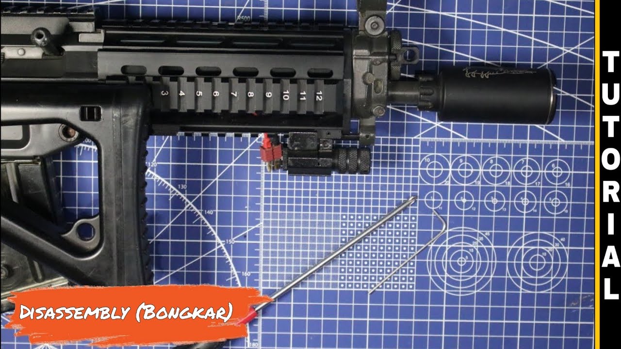

Oh man… you’re gonna hate tearing that down… complex, lots to take off to get to the gearbox.
When you *do tackle it, this might help. :person_shrugging:

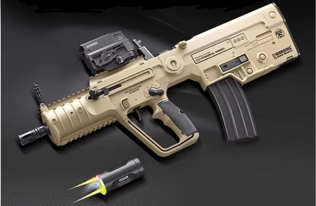

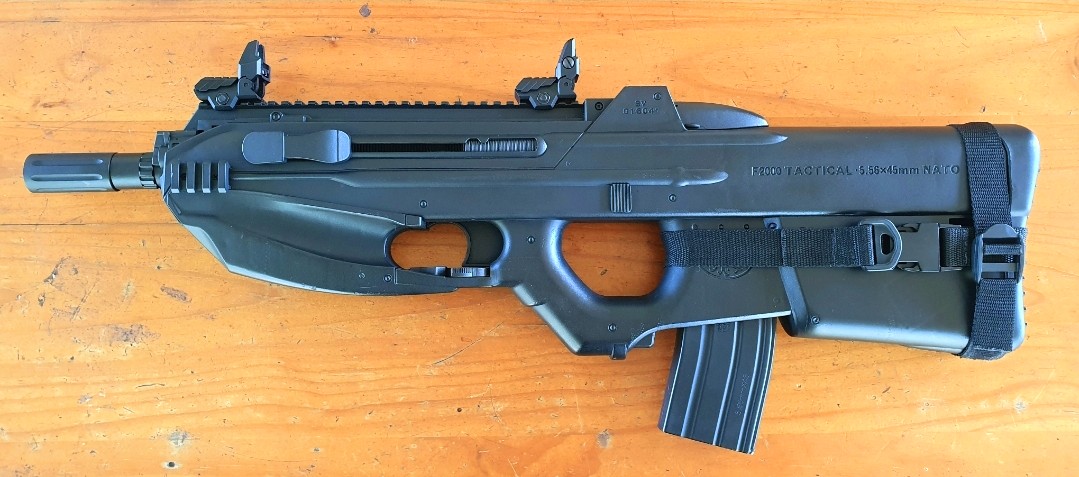

Decided to pass on the dodgy unknown blaster and go with a known quantity. My F2000, a bullpup I already know I can get up in the high 200s with easily. The tactical tuna’s been decommissioned for too long.
So new Gen 8 box is on the way, upgrade parts to be ordered soon and once it’s pimped out to my liking it’ll slot right in to the already modified FN shell.
Plus, it takes most stanag mags (of which I already have plenty) with minimal modification to the mags. :wink:
BULLPUPS RULE!! :+1:

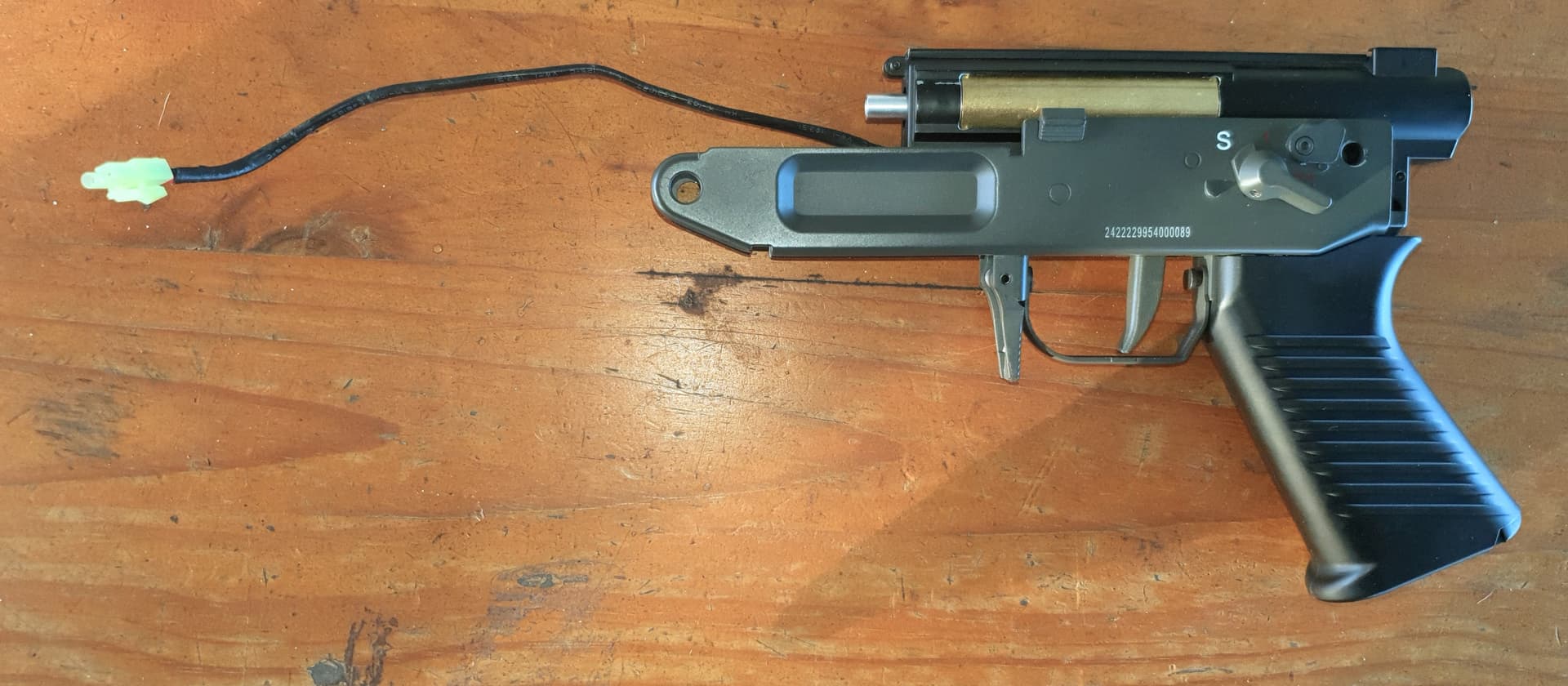

Bit of a trap to watch out for…
New Gen 8 gearbox came in from iHobby for the tactical tuna. Problem is, it’s the new version that features a V2 style trigger block and selector plate… mag prime too.
Easy to see the problems with a gearbox like that going into a bullpup… I need the old school Gen 8 trigger arrangement on a remote relocatable microswitch. :roll_eyes:
Fortunately I have a few Gen 8 shells and the necessary gubbins to cobble together a working unit for this bullpup application.
And I guess at least I have this newer Gen 8 for another custom build.
Although unless it’s going into an M4 receiver I’ll be struggling to make the selector plate functional. :person_shrugging:
Still have a few of the aftermarket Singularity Gen8 gearbox kits here if required mate, and can wait for the mailman to do his lap of Australia?
Worth checking is the V2 style often had a 480 motor and cage. That with a singularity box would be mint!
Good ol fish gunšŸ˜Ž
Love emšŸ‘
Yeah, it would… but…
The F2000 being a bullpup rules out a conventional V2 style box. The OG Gen 8 is perfect because relocating the trigger switch and extending the wires to the original F2000 trigger is a doddle.
I do have a Singularity box already, but I went with the original Gen 8 shell that first went into it. Thanks for the offer though.

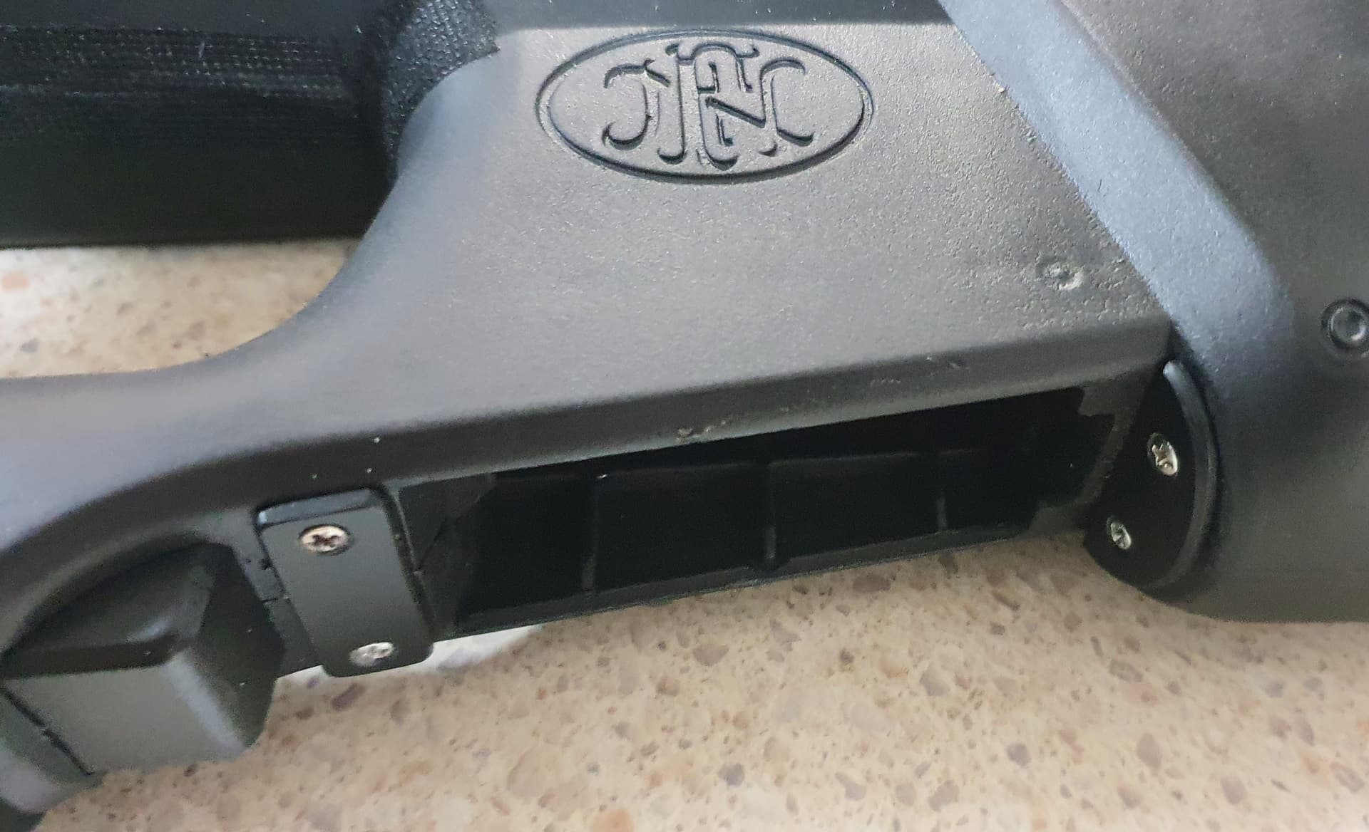

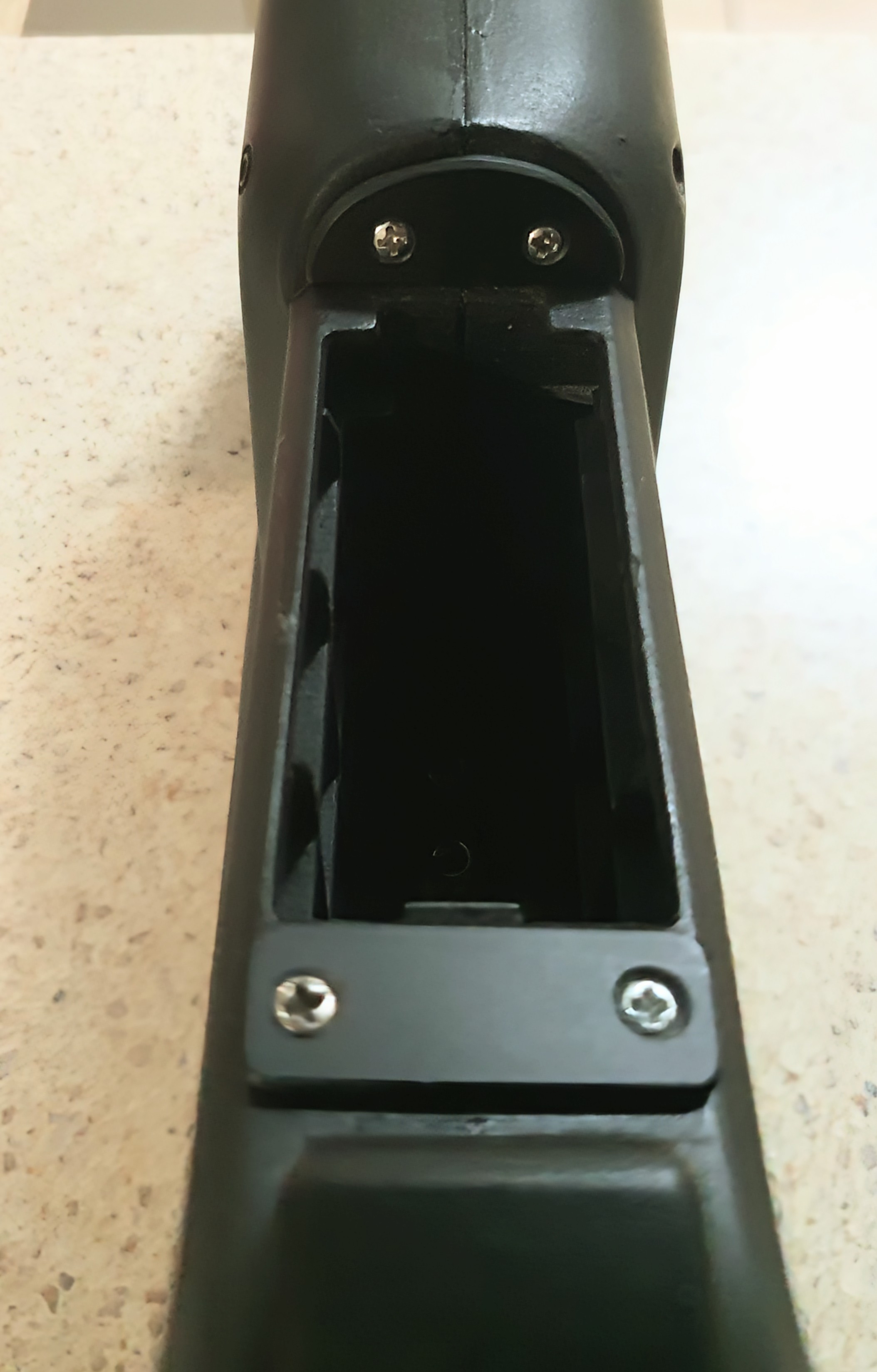

The sad thing is I whacked it all back together today, and with so many broken screw posts and shell fractures it a job and a half closing up the shell and keeping it secured. Especially when you pull the trigger.
I’m not giving up on it yet! Never say die! :thinking:

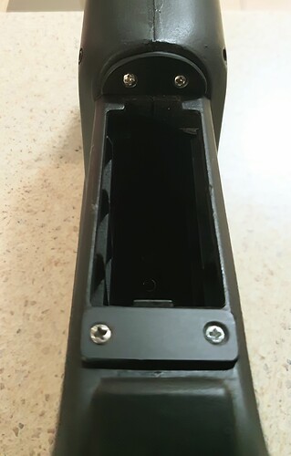

P.S. Shell dramas sorted… a couple of sneaky splice plates screwed either side of the magwell fixes the problem of the shell flexing and opening up during use. Pretty inconspicuous too. So there are enough screws holding this dinosaur together securely enough to keep it viable. :+1:

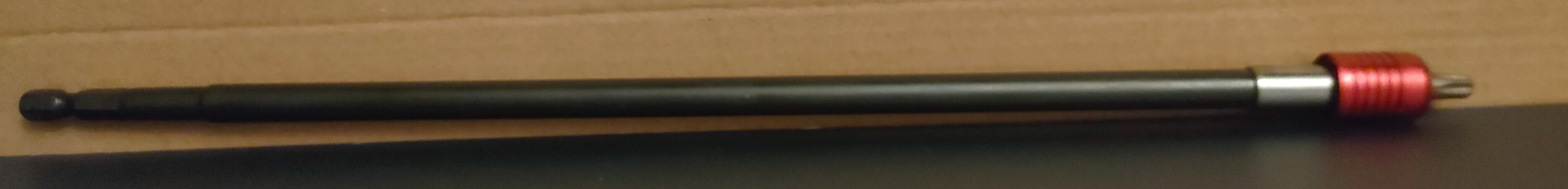

Finally got around to ordering one of these extensions to tighten up my JG works M16A1’s butt stock
Then had to stumble around trying to find the right size hex to get the job done
Now it’s tighter than a dolphins butt

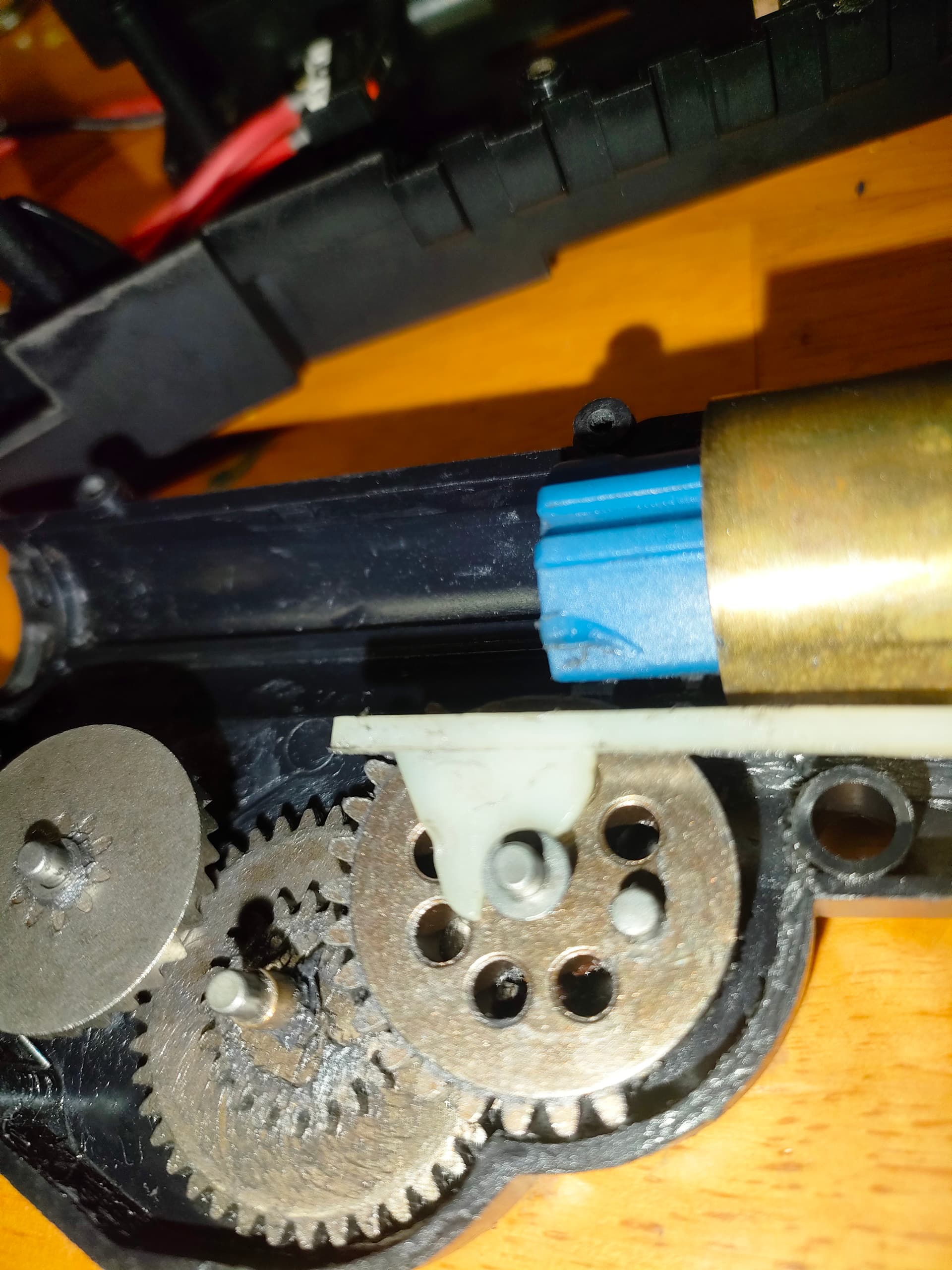

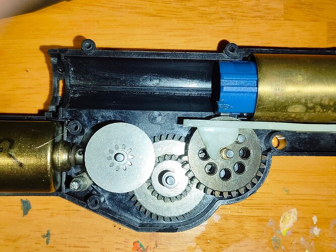

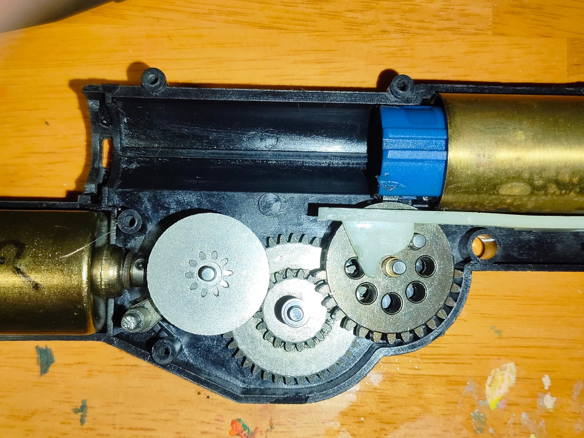

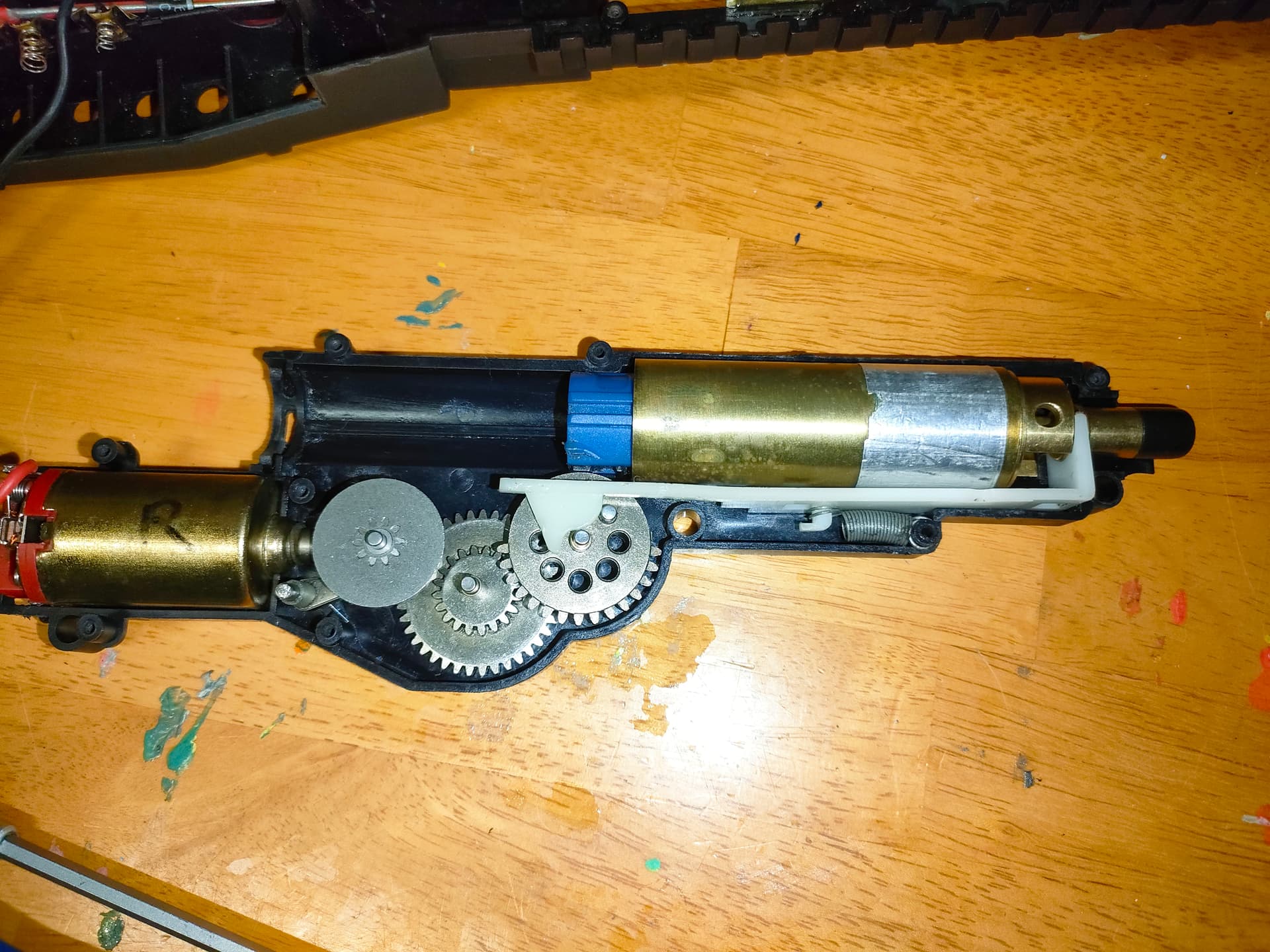

Working on this bad boy BF Mk14 with metal gears
Ceased up after putting a new barrel in it

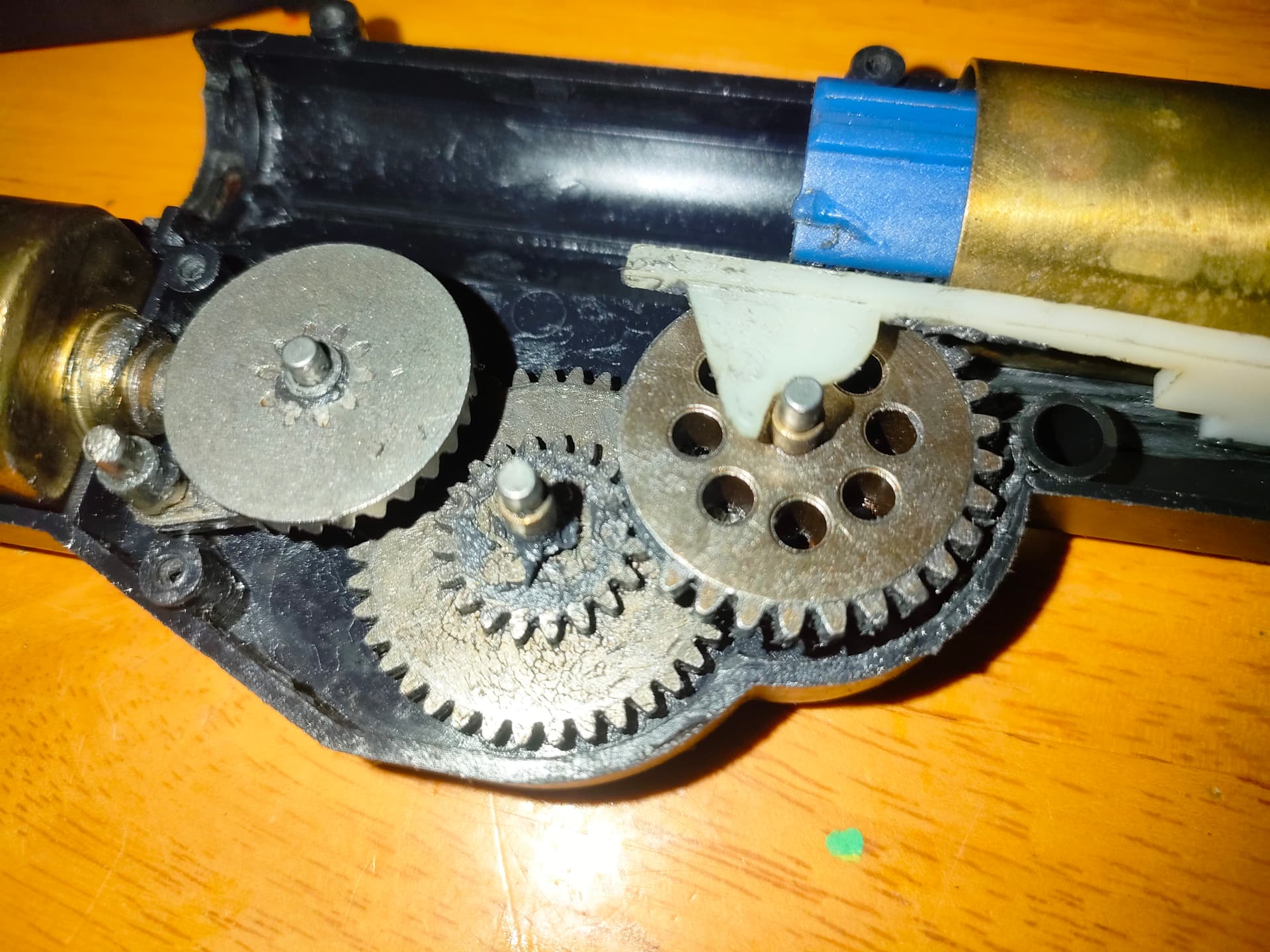

Gears jumped and grinded into the piston

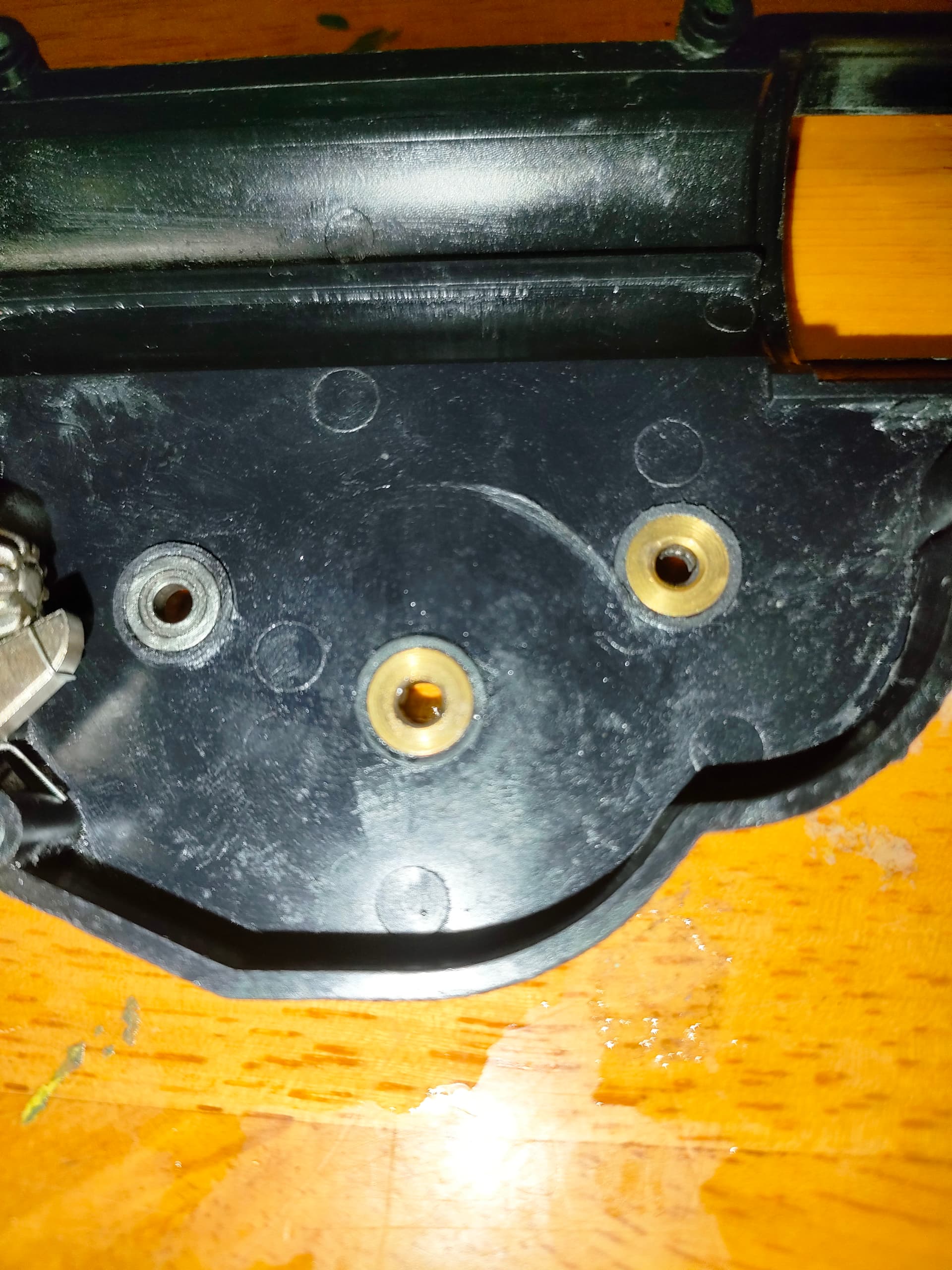

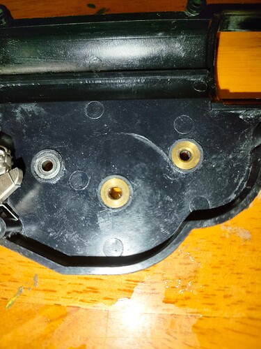

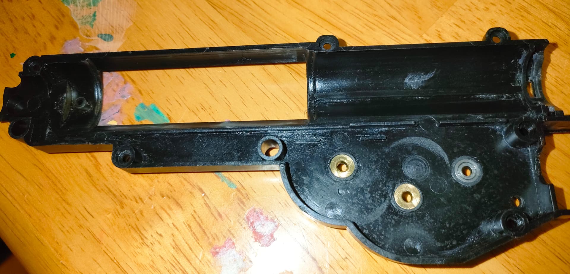

Noticed it’s grinded the top and bottom of the gearbox casing as well, knew I should’ve order that shs shim kit :face_with_symbols_over_mouth:

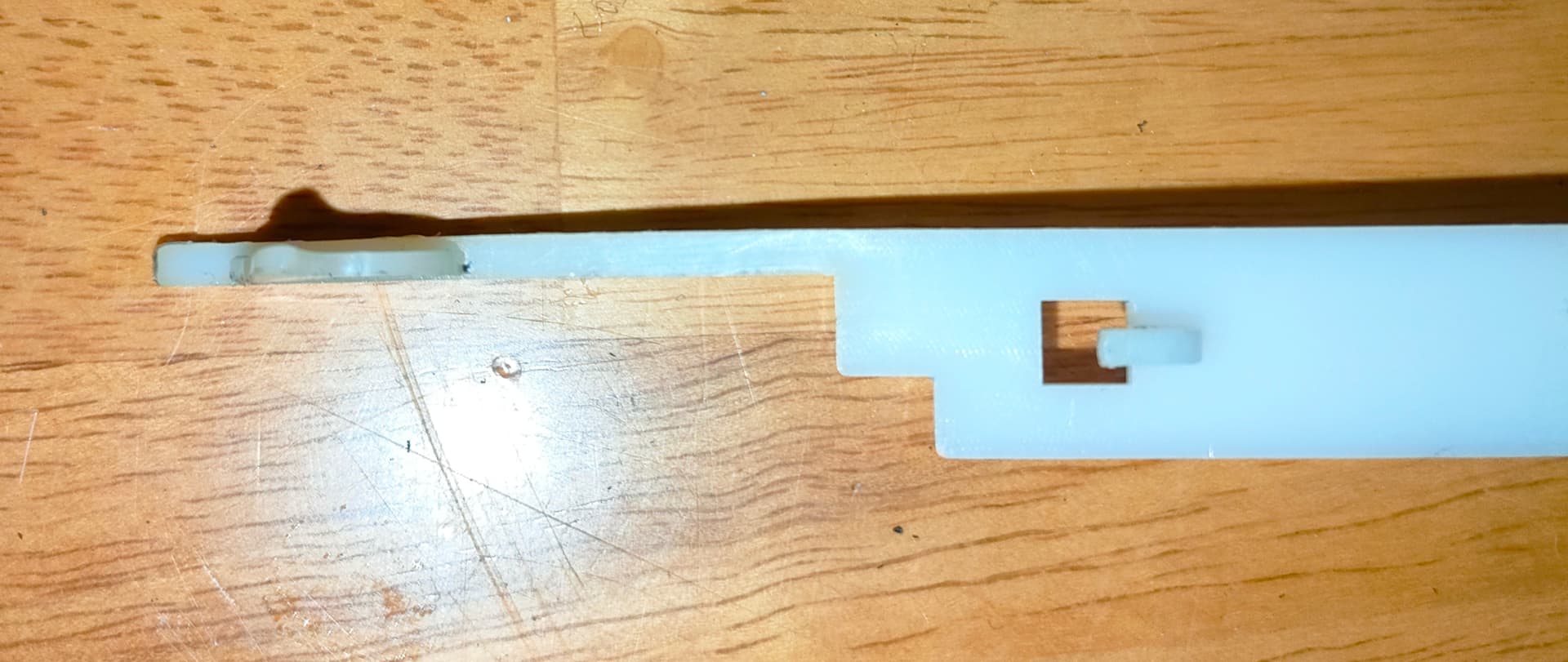

Hard to tell from this angle and lighting but the tappet plate looks a little skewed/bent
Cleaned up, attempting to realign everything before greasing it up again and taking it for a test drive
Will definitely be a challenge for me getting the heights right but since the rains got me canned for work tonight, a challenge it is
Does anyone know if there’s a tappet plate available that is compatible with the BF mk14?
Edit: I think a gen 8 tappet plate will fit if my google search is correct?
Pretty sure the tappet plate’s just a Gen 8. I’ve got a million of 'em. I know all the upgrade parts that BigMuthaDrums put into that were Gen 8. Rok might be able to confirm that.
Pity that when we upgrade gearboxes we get stuck with the OEM tappet plates… no upgrade options available for them.
You might want to check the bushes before you get too far into it… that ground in wear mark in the side of the box shell and piston body may be due to worn gear bushes. If they’re flogged out the gears can wobble around a bit and rub where they shouldn’t.
