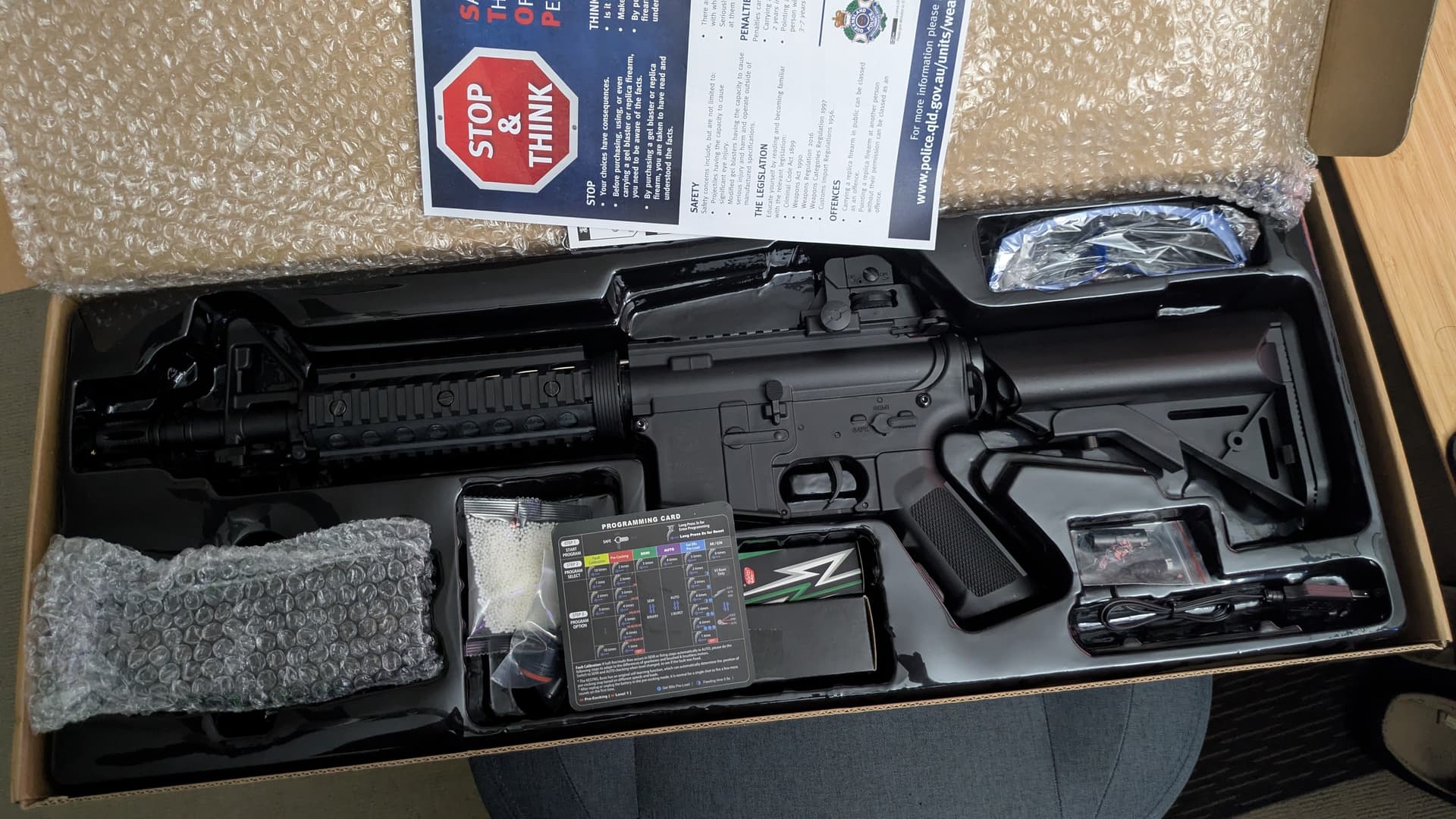

Not yet, that was going to be my next project but had a request from a mate to make his GF something.
Pretty much
(The kit)
And
Is what they want…
Can’t wait to see how it turns out, and glad I can help facilitate the base blaster for it :slight_smile:

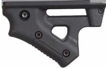

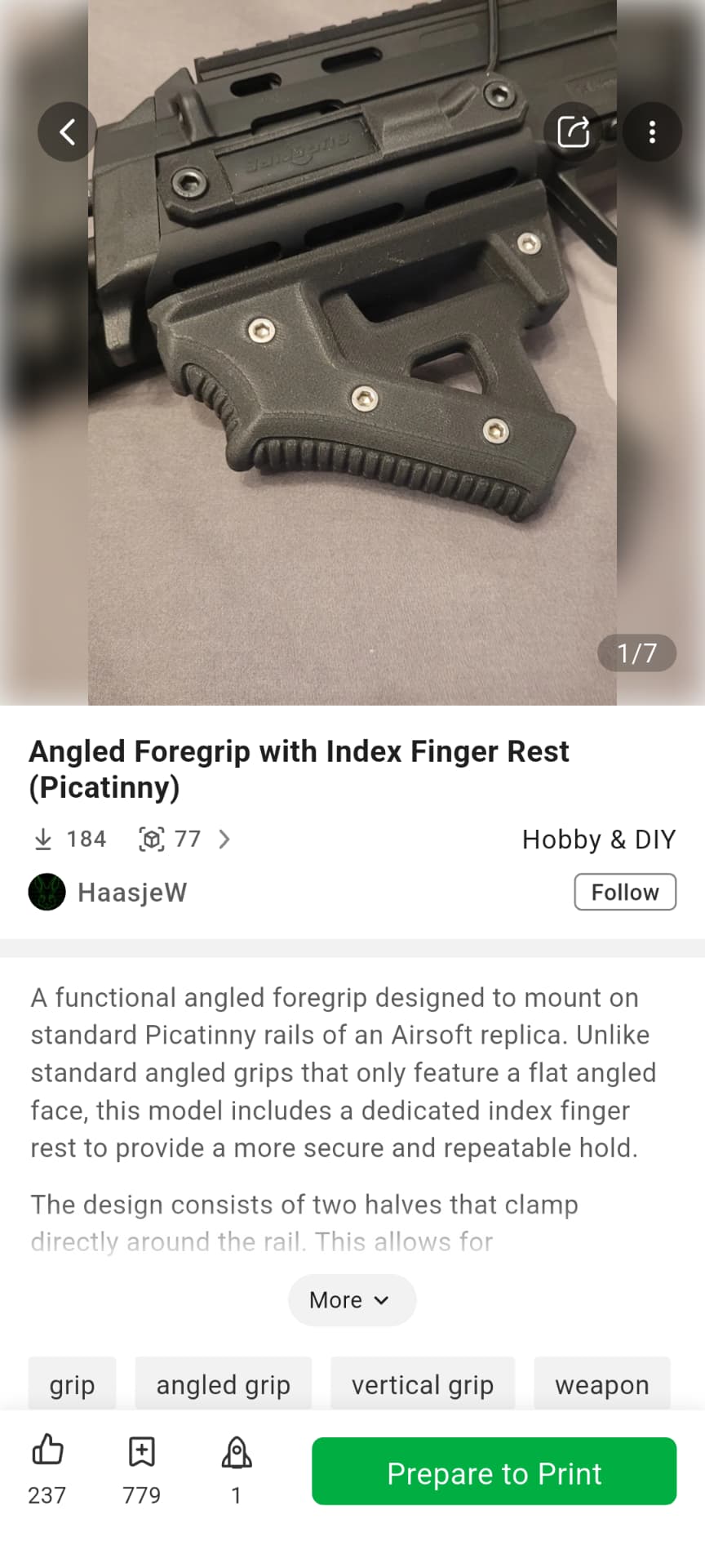

Looking for one of these foregrips for an SLR build. . They fit nicely with SLR handguard. Looks like it might be too old
Think I’ve seen them at Xforce, more specifically the North Lakes store
thanks. I’ll give them a call. They are out of stock at Meadowbrook
Pretty sure I had seen them on Ausgel too before their site went down, so Vas probably has them now if there were any left. Been a bit slow getting that stuff up on the website l.
Worst case one can be printed :wink:

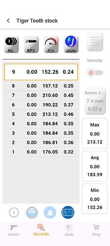

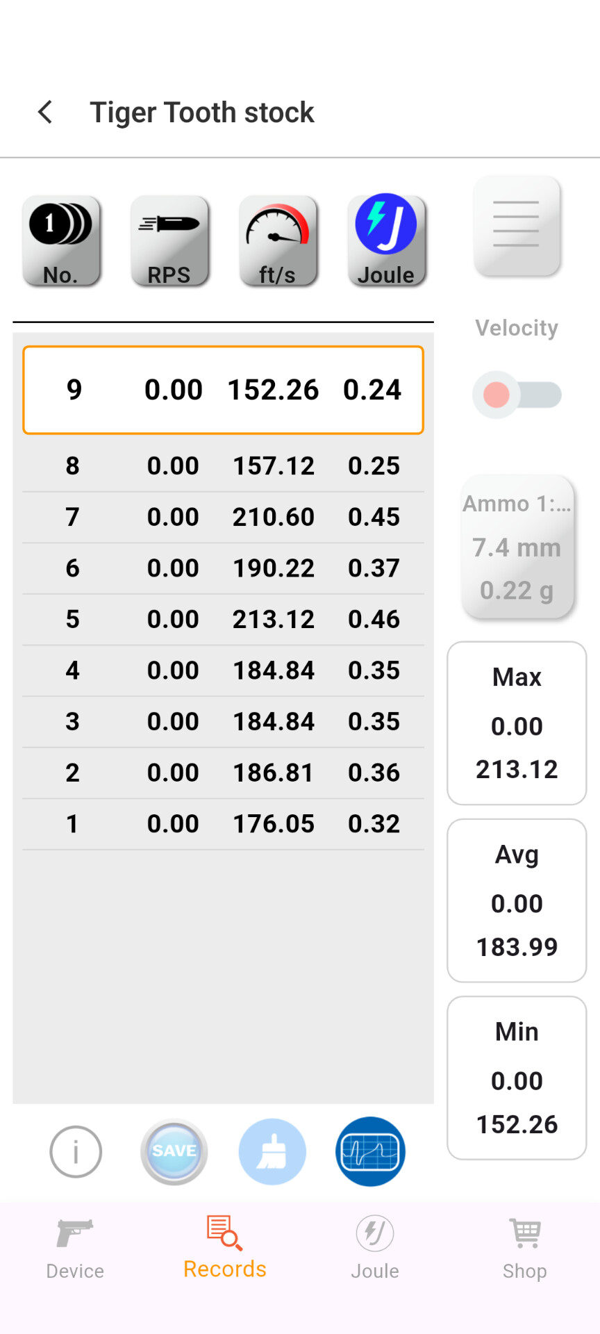

Test fired the base today and pretty low numbers for what it is stock, could be partly the gels cause they’re a little old and had a pretty decent jam on the first half of the mag before it started chugging along nicely, still pretty accurate even without the hop-up though.
Rok was nice enough to include a new cylinder head, nozzle and o-ring and I found my tin of springs.
Will need to get a longer barrel and probably replace the cylinder if its ported too.
The seals in them are very ordinary. It has a cylinder that is about right for it’s stock barrel once the seals are done. Definitely recommend the cylinder head, nozzle, and o-ring, then m90 or m100 to suit taste and they go well. Stock motor is the best cyma offered for a blaster.

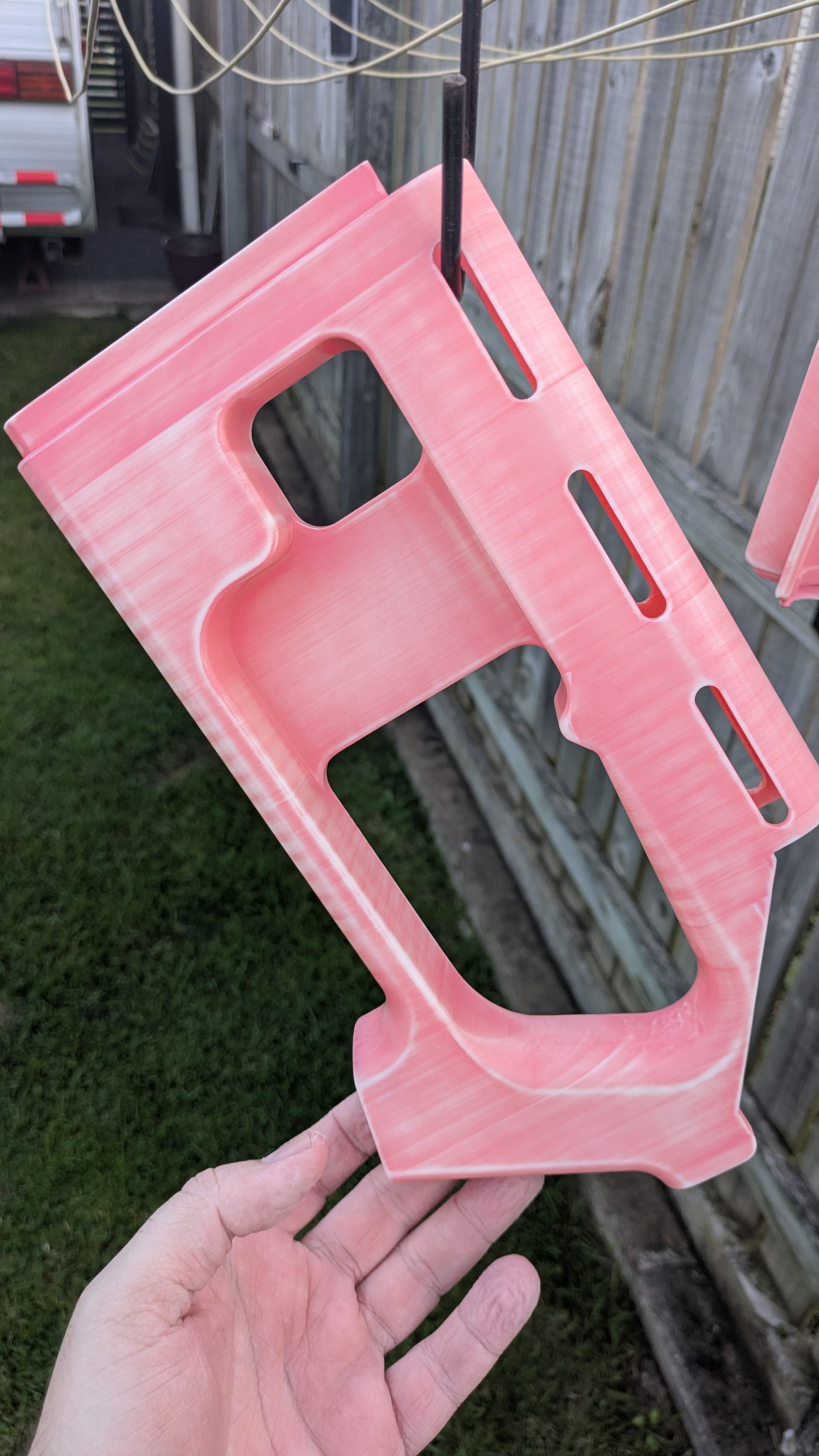

Got the first primer coat down, just gotta wet sand it and a 2nd coat to try and smooth it out a bit better, need to find my airbrush too…

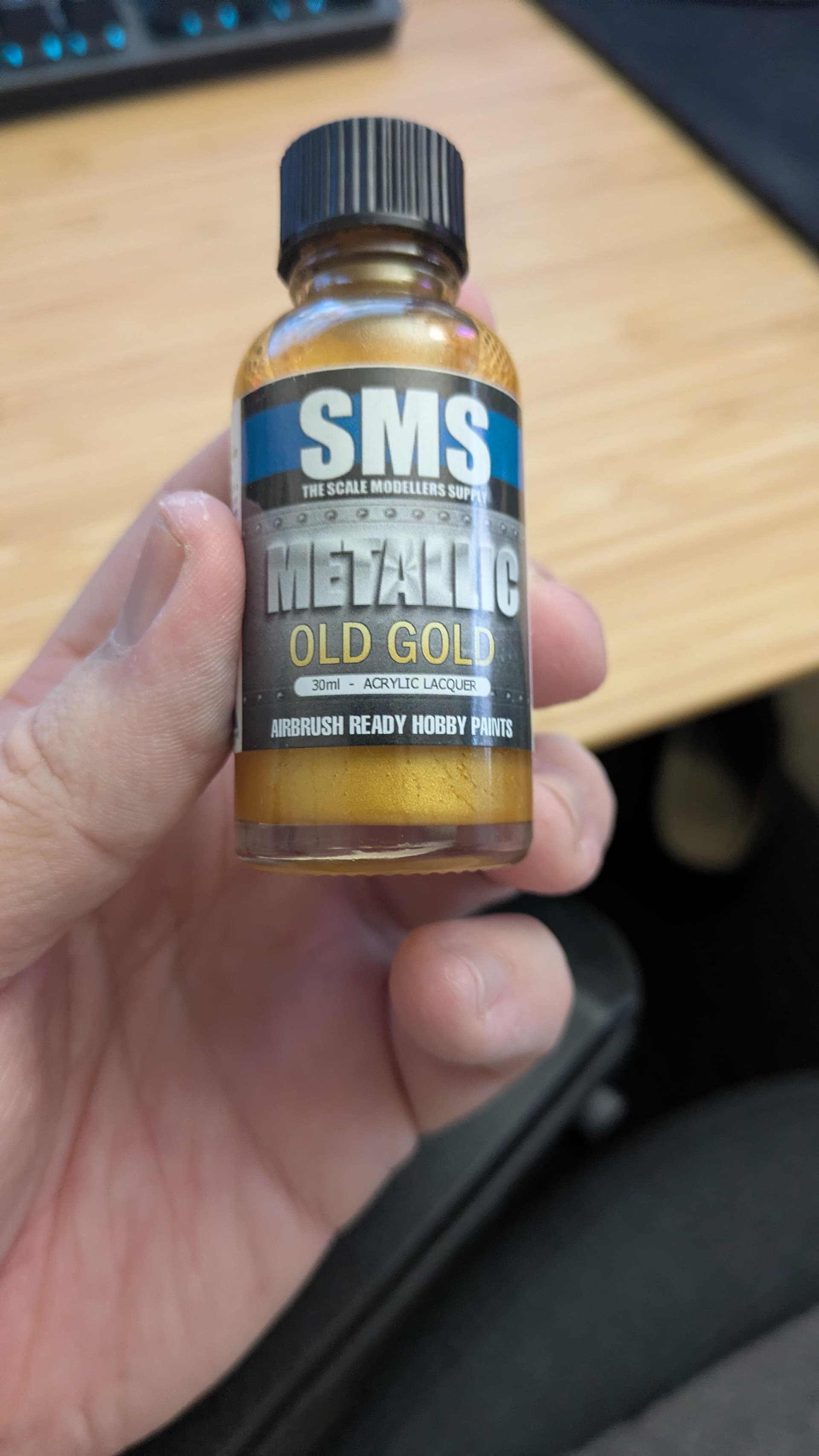

First wet sand done, probably give it another light coat of primer and sand just for good measure then a base coate of flat black, found my airbrush so got some SMS gold that I think matches the shade of gold at least.
