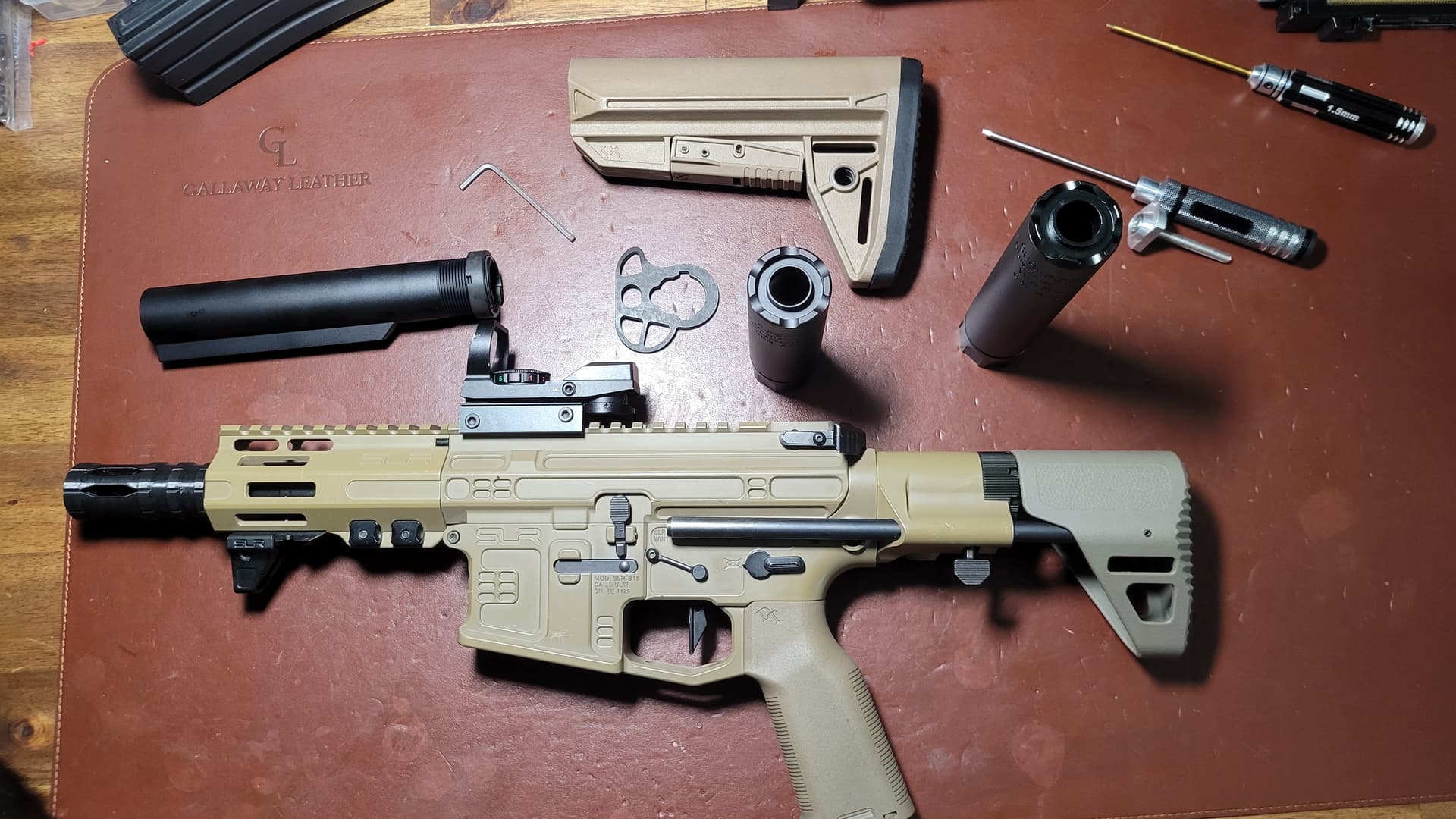

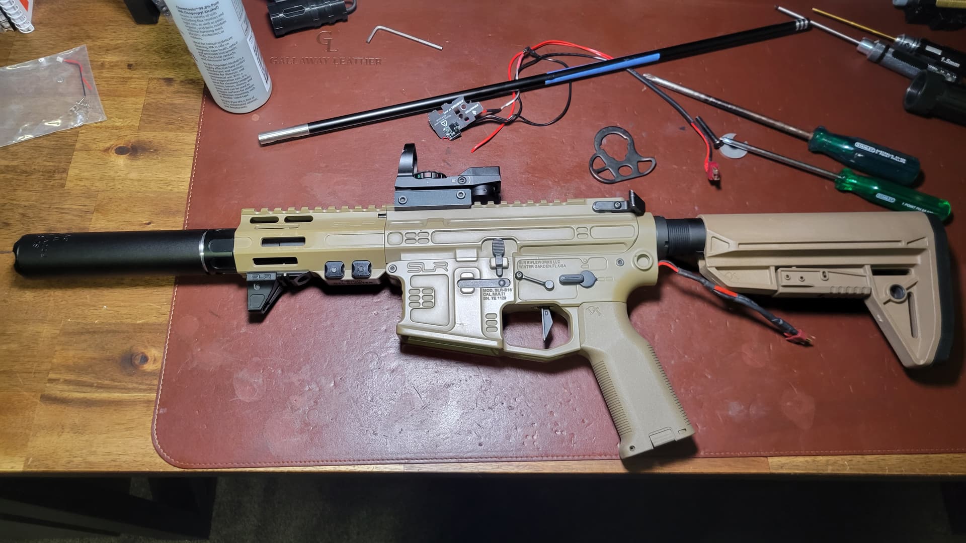

Adding buffer tube, buttstock, longer hop barrel and suppressor to our little 4.25" SLR ION.
Was lucky to find an original buttstock for $5 during a Tac edge sale

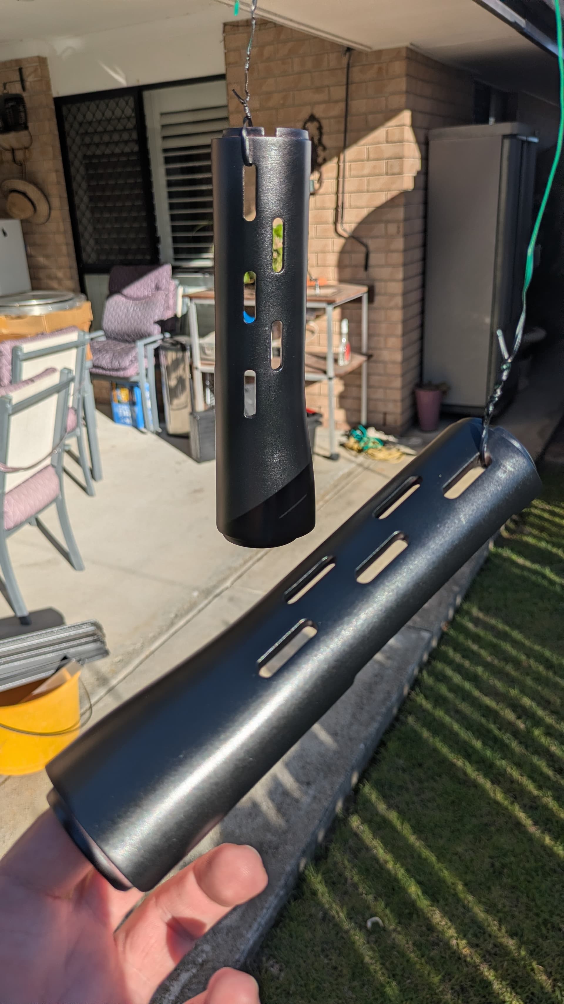

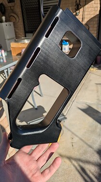

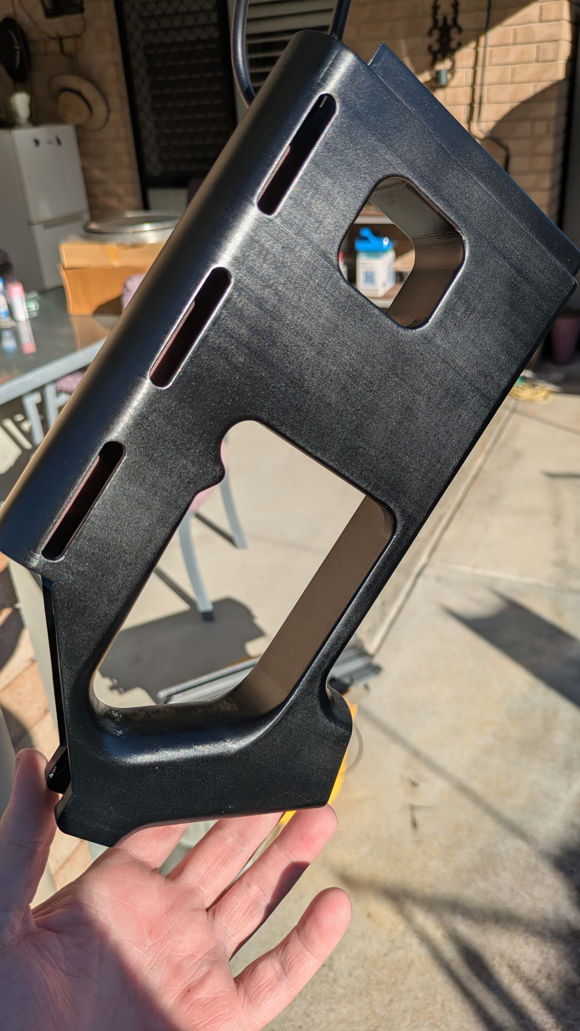

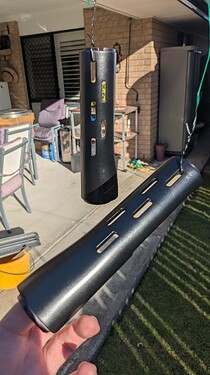

Base coat down, probably give it a light wet sand just to get rid of any fur. Just gotta cut the stencils now.
Don’t think I’ll use that Tamiya primer for printed stuff again, seems to only fill the lightest of layer lines, even after 2 coats. There’s a filler primer I get from Supercheap that works good but is VERY dusty sanding.
