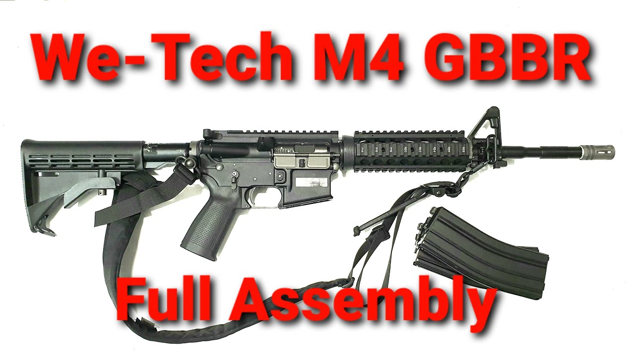

Hey @Clyde ….
Not GE, but might be a handy reference for you……at least much more detail than anything that the manufacturer instructions would cover.
Cheers , docBob , I’ve noticed that a few times I’ll check it out ![]()
