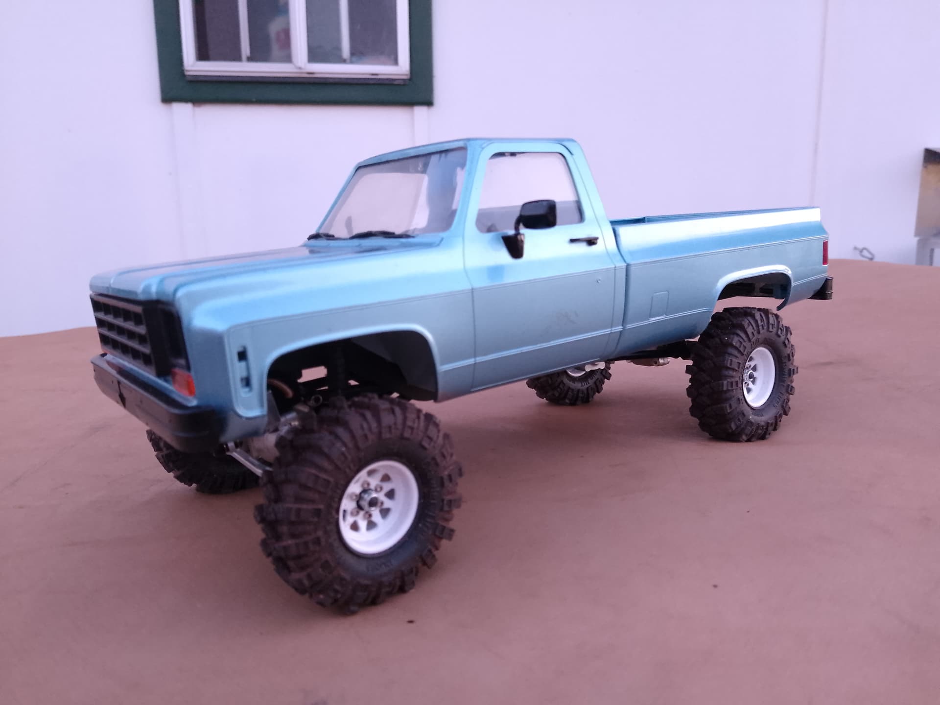

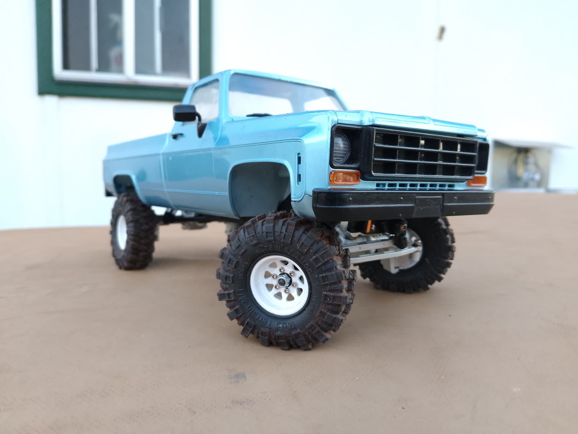

Anyrate, Glacier with metal portal axles and another set of better looking 15x10 style Sunraysia Rims and Injora tyres for a more realistic look by keeping the tyres/rims under the guards. :+1:
Might not look like it, but it took a LOT of modifications to be able to fit these axles to this particular 1/16 scale model, because I specifically ordered them from a completely different 1/24 scale model to achieve the correct track width I was chasing. :ok_hand:
Also modified the steering servo to attach to the front diff housing instead of its original location high up in the body under the hood. :sunglasses:
These wheels/axles are only temporary anyway, as I’m still measuring and researching what parts I will need to achieve the correct “Monster Truck” scale looking results that I’m chasing. :ok_hand:

That looks so good
I love it, awesome work. Really looks good :ok_hand:

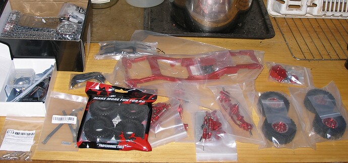

Just had a pile of all sorts of different stuff roll up at my mates place while I was away this afternoon. :+1:
Lotsa random stuff to the uninitiated, but everything has a reason for myself and what I’m looking to achieve with several different builds for the fleet that I already have, along with even more stuff that I haven’t let onto yet! :stuck_out_tongue_winking_eye:
RX/TX/ESC Combo’s to add to particular vehicles that I want to improve their stock performance…
RX/TX 2440 4000KV Brushless Combo
Along with another 2435 4500KV Combo…
A couple of 80 turn high torque tiny little 180 motors to replace the Gelbaster Mag Motor sized motors in a couple of these things! :flushed:
Also a small pile of MN/WPL compatible 5-7mm and 5-12mm adaptors to allow me to fit some of my larger “Monster Truck” type rims and tyres.

Just doing a stock take :wink:
Doctor I think I have to make an appointment
Bloody hell…did ya have to hook up ya trailer to collect all that stuff! :joy:
That’s gonna keep you busy for a while!
Waiting for you to make an RC SCUD launcher or an RC HIMARS that launches RC rockets.
Haha yea that’s why I had to stop at the one. I was going overboard, yet again. I dunno finger slipped :rofl:
