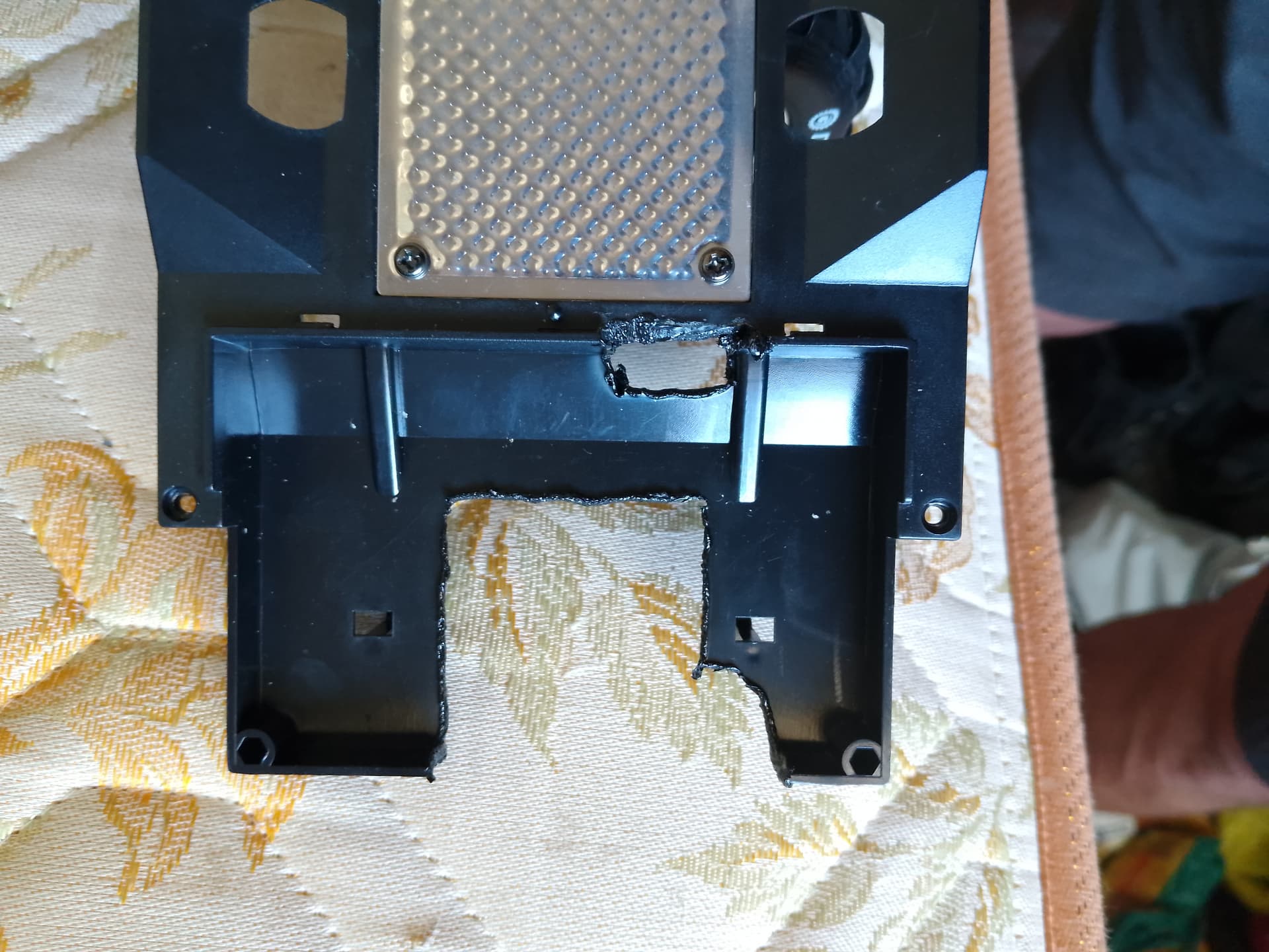

Taken a LOT of chopping and fiddling around, but determined to get all this fully modified equipment to fit inside a standard looking C-14 HILUX single cab body! :flushed:

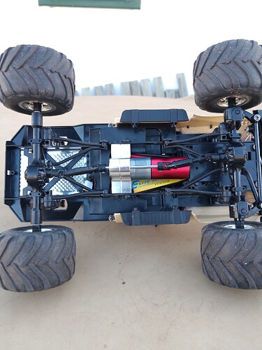

Clearanced everything that got in the way of me being able to fit not only the Brushless system and Alloy gearbox, but also to be able to fit and run my many leftover Gelblaster batteries and Deans connectors.
Had the whole bodywork off several times to be able to keep trial fitting the batteries and then stripping apart to chop out even more plastics until I could get everything bolted together and clearing everything.

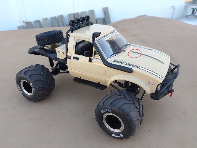

Results are worth it I reckon, looking like a bog standard C-14 if I bolted the original rims back onto it, but like my Gelblasters, standard looking on the outside and pretty wild modified stuff underneath. :raised_hands:
Got the 3S Gelbaster battery to fit and able to plug in/run with the standard body/rear box in place, unlike 90% of builds online that simply cable tie an external battery onto the rear tray! :roll_eyes:
This gives a good indication as to the tasks involved fitting these Lipo batteries into such a limited space! :hushed:
and yet still can barely see any evidence of where I chopped everything out inside the interior to get everything to fit. :ok_hand:
A bit of black paint on the interior panels and won’t be able to see shit, along with a set of Portal Axles to raise this to suit the rims/tyres and that’ll be job DONE for this particular build. :+1:
Only issue was that the combined RX/TX/ESC doesn’t come with an external on/off switch, and has a digitally controlled contact button to turn on/off.
Only solution was to drill a small hole in the top centre of the bonnet to be able to operate by poking through a small screwdriver/pin to access the tiny button located underneath… but doesn’t stand out too much and working just fine so far!
Extra added bonus is that the new Brushless system has a higher BEC output, so even though I’m running my bush mechanics reversed original WPL steering servo, it no longer has any issues steering these bigger tyres. :ok_hand:
