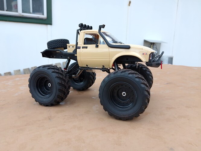

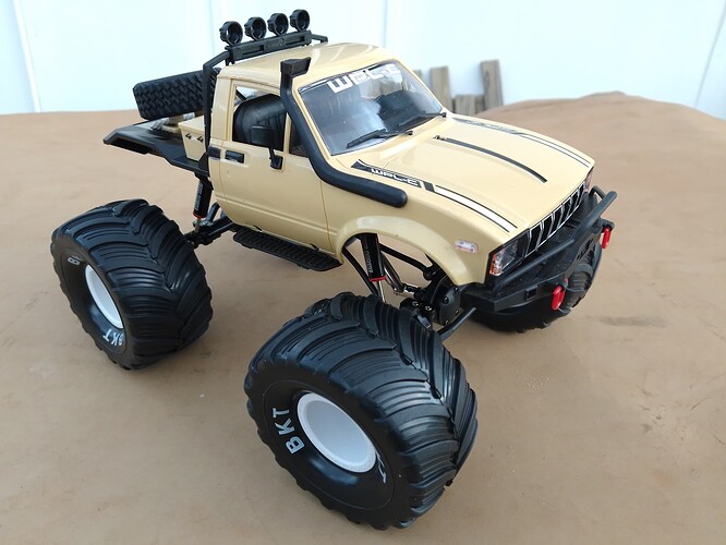

I spent the arvo dicking around with the Tan C-14 trialling out different rims/tyres and shock positions, but have since taken them all off again and got a few more different sized bits in my Shopping Carts to suit what I’m chasing. :sunglasses:
Just for shits’n’giggles…
Waiting on some long adjustable link arms for the suspension to stretch out the wheelbase a bit to get rid of the SWB stumpy toy look that’s created by lifting the diffs, as well as fitting a set of chassis plates to lower the gearbox to ease the angles on the driveshafts.
Also have a couple of sets of 12mm axle extensions in the post to widen the wheel track, as the tyres are still tucked in under the bodywork pretty tight and the fronts are catching on the outside edges of the front bullbar under full steering lock and full upper suspension travel. :confused:
Hard to see in the pics, but my favourite black rims/tyres the body comes all the way out to the centre of the tread, and the MKT silly looking white Monster Truck Wheels have the bodywork around 1/3rd over the inside of the tyres. :confused:
Don’t matter anyrate, because those big white MKT Monster Truck Wheels were ordered specifically for my FMS Chevy C10 Longbed pickup anyways!
Those black rims and tyres are from a 1/10 scale high speed all wheel drive car type track racing vehicle, NOT intended for a low speed 1/18th scale 4WD Hilux rock crawler, but they just look cool for their size and design on this rig!:stuck_out_tongue_closed_eyes:
I’m loving the fact that these replicate more of a ā€œRedneck Swamp Buggyā€ look more than a proper scaled ā€œMonster Truckā€ when you look at the Hilux body/wheel arch size in comparison.
Compare the size of the original spare rim/tyre on the back tray, and they’re actually not much bigger despite their looks! :flushed:
But that’s the whole point, take measurements and order whatever crap suits what you are chasing no matter what the original purposes are designed for!
So I now have stock 1/10 scale speed/performance track rims and tyres on a crawler speed 1/18th scale offroader!
Will keep mucking around until I get it looking and functioning as I want it to be. :wink:

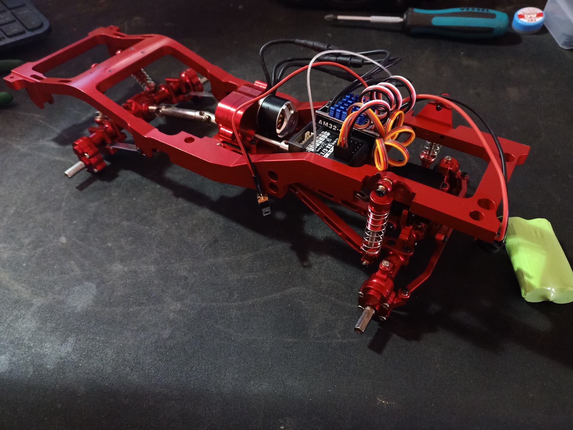

Setup all the elec gear, centered the steering servo and bolted that up.
Dry run on the bench seems good. Man that brushless outrunner has some awesome slow speed by the looks, no cogging.
Tie all the elec gear in, hog out the inside of the body for clearance and be time for a shakedown run. Getting closer :metal:
Shakedown completed, not too bad but needs a lot of correcting.
Shocks are too stiff lifts wheels and rears too short squats in the bum. Tyres are too hard next to no grip should be rectified when new rims arrive and put sticky tyres on. Steering has bound up will attack that when screws arrive.
Not a bad first run, impressed with the motor, super smooth crawl speed and plenty of zap for the size model.
