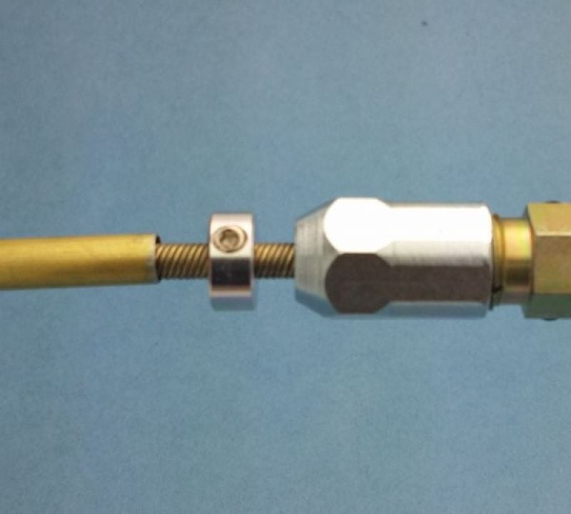

But the poor little 3mm flex cable obviously didn’t think so. ![]()
Oh well, was looking to get a 4mm cable anyrate, because all the performance props run the bigger cables anyways.
Might be time to invest a few few these cable savers as well. ![]()
Flex cable saver for .150 or .187 diameter cable.

Much better cable, as has full diameter drive end, whereas the original cable was crimped down to a smaller diameter square drive, exactly the same as a Speedo drive cable in older vehicles… which is what caused it to disappear off the back of the motor in the first place.![]()
Kit comes with everything except the Prop, but luckily the boat came with a spare 36mm Prop to be able to finish the job, or else it was gonna have to try and survive with the larger high rake 40mm spare Prop until I could order another. ![]()
Much more confident with this cable though, as even had to spread the jaws on the motor cable mount to get it to slide in, so obviously much more clamping force than the original. ![]()
