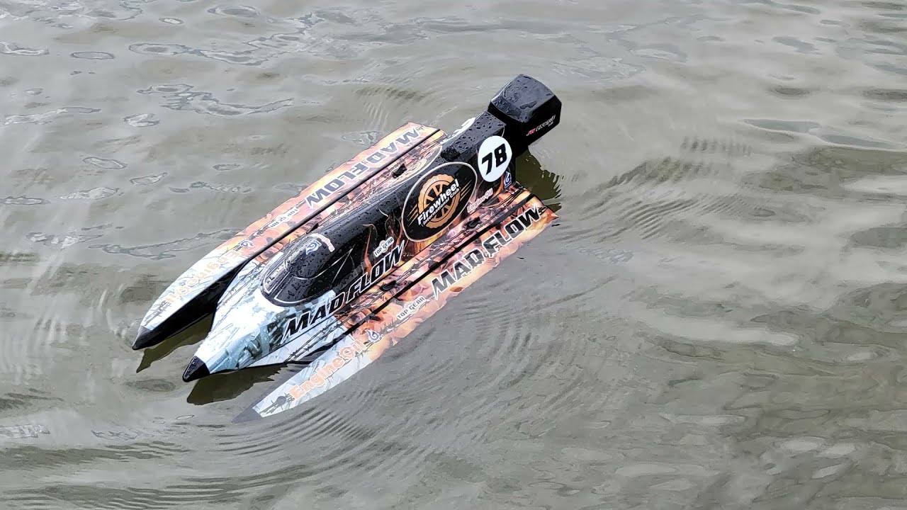

Heading home after only a few runs, too windy and choppy again. :face_with_diagonal_mouth:
I took a video of a large Hawk that was chasing and dive bombing the boat up and down the Weir for a good 10 minutes, which was a bit of fun!
Didn’t get much time on the water, but at least I gave the local wildlife something to do! :stuck_out_tongue_winking_eye:

I was wanting to stay longer simply to run down all the battery packs I had with me, because discharging them back to storage state has taken all afternoon, and I’m still going, with only 4 out of 12 packs done so far. :face_exhaling:
Problem is that the wind picked up even harder not long after I took that video of the Hawk, and the waves actually started White capping.
Dickhead me thought ā€œjust take it easy and she’ll be rightā€ā€¦ famous last words as I lost the Hatch to the TYLOSAURUS AGAIN, even though it was taped, it went deep under a wave and eventually resurfaced without it. :face_with_diagonal_mouth:
Luckily I had only just added sticky back foam to the hatch lids the day prior, so at least they would float and eventually the wind and waves would push them onshore.
Which worked a treat today, even though I had to go for a long walk to find it and wade out in the freezing water to retrieve it, at least I still got it back again. :raised_hands:
Back home and adding extra foam to both Hatch covers.
But also snapped off the LHR bottom hatch lock and the tongue at the front where it clips into the Hull… because the battery had wedged itself under the hatch lock mechanism and I couldn’t get it undone until I pried open the opposite side to provide a small gap to be able to move the battery out of the way.
Not surprising that the battery moved though, as multiple high speed flips, barrel rolls and deep sea diving will do that!
All glued back together now, and definitely going to be staying off the water when the conditions are so rough, its simply not worth the damage and losing parts for. :disappointed_relieved:
It was probably the scaled down equivalent of taking a 5 metre runabout out in a 1.5 metre swell. :laughing:

Tore apart my home made 4S battery pack, as I came up with a plan to be able to run the two individual high capacity 2S batteries in the psychopath Mad Flow Boat either side of the hull, rather than the heavy single 4S packs up front upsetting the CG and handling capabilities, to allow me to move each pack fore and aft to fine tune the CG as required. :ok_hand:
By splitting these two packs, I can now safely run what totals to be 14.8V, 5200mAh at 50C ratings. :ok_hand:
Also got stuck into the UDIRC ARROW, removing the battery tray and chopping out the mounting points inside the hull, exactly the same as I did with the TYLOSAURUS, along with checking out a good placement for the aftermarket SKYCOLOR 150A ESC and dual batteries in each side of the Hull for either 4S or 6S applications.
Picked up another couple of packets of Velcro strips to fit into both the ARROW and Mad Flow boats to allow shuffling of different components to be able to get the weights and balances right. :ok_hand:
Plenty of aftermarket performance spare parts already in my collection, and only a matter of testing and tuning to see what works the best.
So yeah, just another rainy day and got plenty of gear to muck around with, but will be a while before getting back on the water to test out the modifications.
