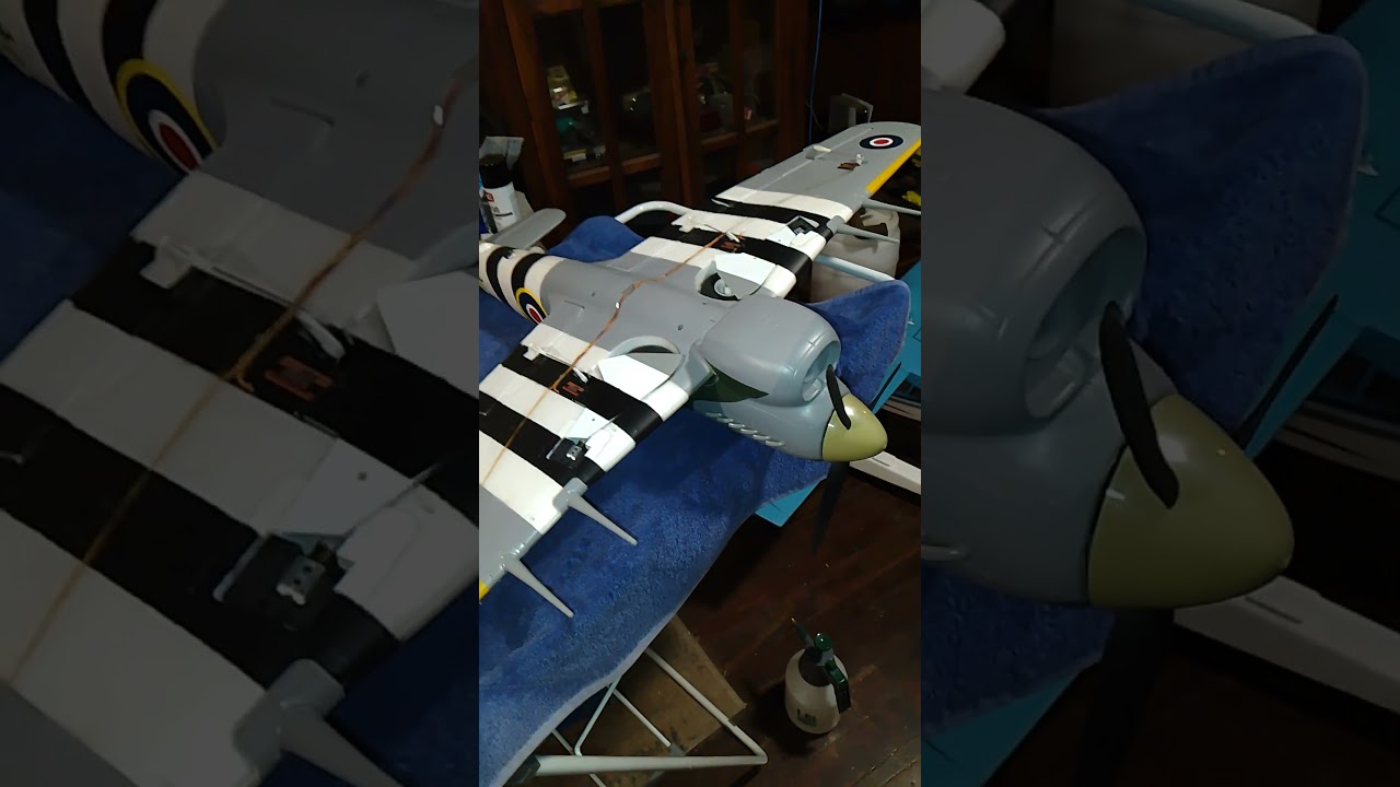

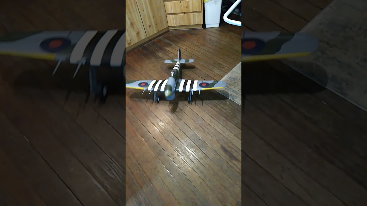

Sorry I got a bit sidetracked, working out that I could use my 6CH to get the TYPHOON set up for now once I removed the Reflex Gyro channel to run it as a dumb plane for the time being.:stuck_out_tongue_winking_eye::+1:

BTW: The new 10CH receiver turned up a few days ago, so I might bring the Typhoon back up bush here and get it all set up to give me something else to do whilst sitting around camp! :sunglasses:

The Warbirds look great but the physics just doesn’t scale. Give me a wing or talon thanks.
Test flight ended up being 200kph+ speed runs :smiley:
https://www.youtube.com/watch?v=rz9cx3QFUJU
You are 100% right about the physics and scale, where the lightweight foam replicas are a bitch to achieve correct CG making them a handful to fly.:roll_eyes:
I have the Warbirds mainly as great replicas of my favourite WW2 Aircraft, not for use as daily flyers, that’s what all my other Float Planes are for.

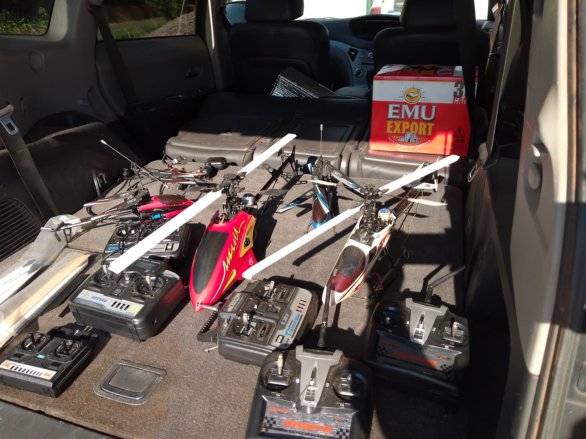

A nice old fella came up to me at the Weir yesterday as I was out flying a few of my Float Planes, and asked if I’d be interested in some RC Helicopters that he’s had collecting dust in his shed, as he now has drones and no longer flies Helis.
I naturally accepted his kind offer and did a pick up on the way back from the grog shop! :sunglasses:
Two 350mm Twin Rotors and two 700mm single Rotors running belt driven Tail Rotors.
Pretty old stuff, especially all of the electronics, with one FM Radio Transmitter still fitted with the old Frequency Crystal in it!:open_mouth:
I’ve already started removing the old FM receivers/ESC’s and Gyros to replace with modern electronics that can bind to the already extensive collection of spare Transmitters I have laying around, and get rid of that old ridiculously long yellow FM antenna wire.:+1: (YES, it’s looped around the tail to the front of the Skid and back!)
Will leave the old Gyro on one of them to see how it performs, and has fine adjustment controls easily accessible.
This is the older White model with full plastic chassis and metal alloy in critical areas, whereas the other Red one is a bit more ā€œmodernā€ with metal frame, plenty of alloy parts, slightly newer electronics and more complex Rotor Head controls.
Looks like there’s gonna be an influx of boxes from China again in the not too distant future.:stuck_out_tongue_winking_eye:
Been a few days researching what the hell these Beetle Bopters are, and as far as I have found out, the white one is 20 years old and the Red one is a V2 version only 16 years old!:open_mouth:
No wonder that they still ran old FM RX/TX electronics and wildly complicated Flybar Rotor Heads!
Surprisingly though, they were the very first introduction of Collective Pitch 3D Helicopters to be released onto the market, making them the OG models that spawned the insane 3D CP Helicopter Hobby that has taken off worldwide today.
Fortunately for me, because they are a good quality well known brand, parts are STILL readily available online for very cheap prices, including more modern updated Alloy and Stainless upgrades for these same old machines, including parts to adapt them into more modern Flybar Less Heads with Modern Gyros to match the modifications.:ok_hand:
I’ve already ordered around 40-50 bits and pieces, mainly updated Electronics and parts that I have already found broken or damaged.
Still toying with the idea to restore the old White girl with ALL of its original components, just as a tribute to the days gone by.
Would be hilarious to be the only one on the field holding an old FM Radio Transmitter with its 3 ft telescopic arial extended with a white ribbon flapping in the breeze and battling with a Piezo Gyro and 4 ft antenna wire trailing behind the Heli!:stuck_out_tongue_winking_eye:
Amazing how the little details first caught my attention, in the sense that the 2 Transmitters had every single Trim control tab maxed out left right, up down and beyond.
That told me straight away that the basic mechanical settings must have been all janked up, which on closer inspection, everything was 100% way out of whack.:confused:
Servo arm locations, ball link rod lengths, Swash plate angle, pitches between the Flybar paddles and main Rotor Head, Tail Rotor pitch settings etc etc etc are ALL OVER THE PLACE!
But that’s where you come to realise that all of these models, the same as my Rock Crawlers/Speedboats/Aircraft, all come in a Kit form and are only as good as the person who first assembles them.
There’s a reason why I spend weeks on setting up my Models to the very last millimetre of mechanical settings, then many more days testing and adjusting the electronics before I even send them off on a maiden voyage.
Sure enough you can ā€œtrimā€ certain things ā€œon the goā€ with the TX to a small degree, but if the mechanical physics have been neglected, no amount of trimming is going to save you from crashing out within seconds!
So now as a part of this CP Helicopter ownership, many of the bits that I’ve ordered are mostly things like Pitch Gauges and everything else technically related to actually setting up the mechanical physics properly before I even get into the electronics side of things.
